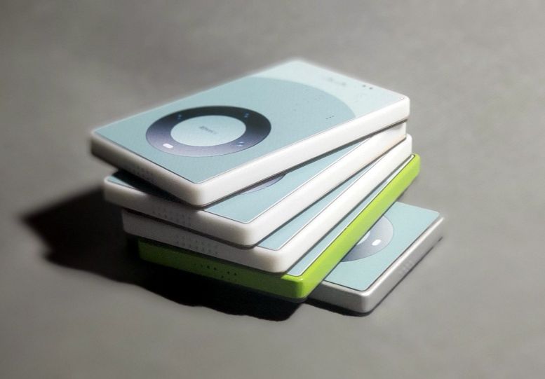

The Mate 60 mini
version project aims for simplification, based on the Mate 60, but scaled down to a card-sized form factor
. Screens are too big now, too small for small hands, and you're afraid of dropping it and breaking it.
It supports Type-C charging
, touch recognition on the back with three independent sections
, no buttons on the sides for a minimalist look,
speaker holes
at the bottom and top, and physical in-screen buttons for a real tactile experience, not a motor-simulated design. It also features
four built-in magnets for easy attachment.

Details:
This project mainly uses JLCPCB's color PCB, 3D printing + painting, and JLCPCB's panel printing service.
Components mainly use large solder pads for easy soldering and replication.
The battery is a 302530 lithium battery
. Speaker thickness should not exceed 4.3mm. 0.5W 8-ohm
magnets: four, round, 6mm diameter, 2mm thickness.
PCB thickness: 1.6mm .
Panel thickness: 1.0mm. Adhesive backing.
A touch switch on the front for easy pressing, and three touch buttons on the back for audio switching.
After plugging into a computer, a USB flash drive appears with internal files; simply replace them. No programming knowledge required.
Quickly transfer your favorite music or other files, use it as a music card, or a prank tool!
