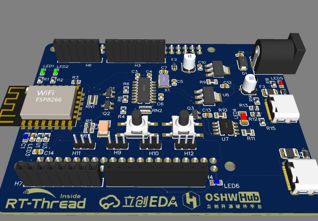

As shown in the picture, map the power pin and Reset pin according to the pin arrangement of Arduino UNO. picture.png
Use several pins of the STM32H750 as A0~A5; lead the GPIO of the ESP-12F module to the general-purpose pins on the right, keep the RX and TX pins of the UART connected to the corresponding UART pins of the STM32 and lead them to 0 of the corresponding Arduino UNO , Pin 1; Pins 12, 13, 14, and 15 of ESP-12F are GPIOs that support SPI multiplexing. They are lead out as IO12, 13, 14, and 15 here, and can be connected to the SPI pins of STM32 through jumpers. Switch to SPI communication mode; especially, lead out the ADC pin of ESP-12F separately.

This expansion board can also be used to connect ART-Pi and Arduino expansion boards. The effect is as shown below (connect this expansion board and SEA-S7 expansion board to ART-Pi, and you can use the FPGA computing acceleration function of SEA-S7). Powered by any USB-typec interface IMG_20210227_124808.jpg
Sample project
Based on RT-Thread, use RT-Thread Studio to program ART-Pi. Develop firmware for spi communication between stm32 and ESP12-F. When ESP12-F sends an IAP burning command to stm32, stm32 sends a request to the cloud through the onboard AP6212 and performs IAP burning through the serial port. The physical picture is shown in the attachment. U1 and U3 do not have components on hand, so they are replaced by resistors with the same resistance value. ;The red indicator light turns on after powering on, and the green indicator light flashes when ESP12-F is programmed, which is consistent with the Arduino programming method.
