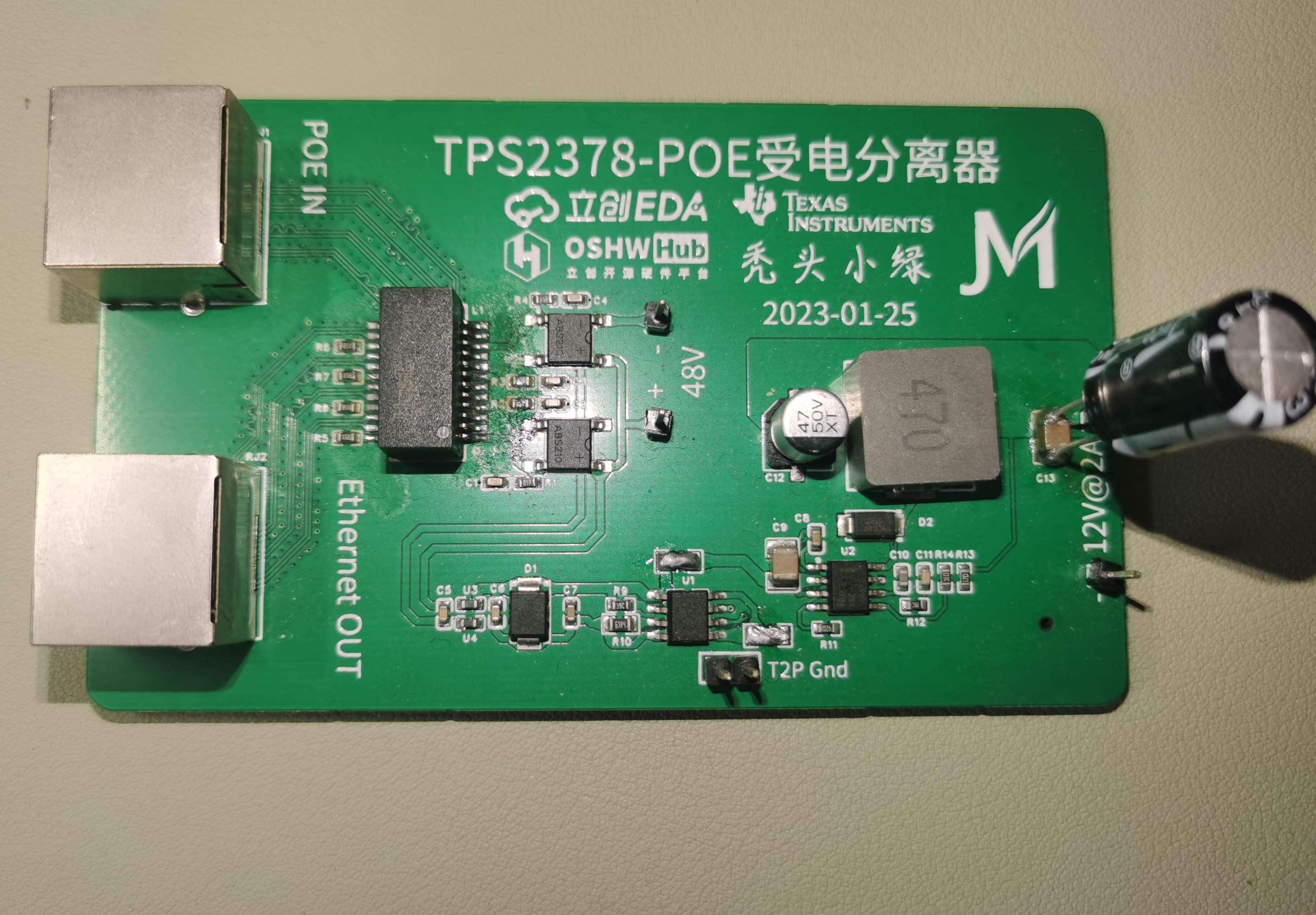

2023.01.11 Project created! Second PoE PD power receiving end project on the OSHWHub open source platform (the first PD project was also mine: MP8007H (whispering))
2023.01.20 TPS2378 - Schematic 1.0 completed
2023.02 SMT+PCB arrived
2024.02 Verification completed

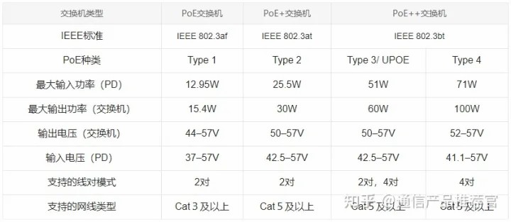

Currently, PoE has three standards: IEEE 802.3AF, IEEE 802.3AT, and IEEE 802.3BT.

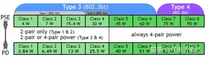

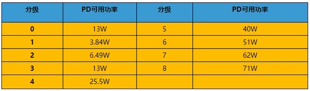

Power classification is a process where the PSE and PD negotiate the amount of power the PSE will allocate to the PD. During this process, the PSE and PD identify each other, determine the type of device they are connected to, and then the PD requests the power it needs. The PSE allocates the required power to the PD; if the PSE cannot meet the demand, it will reduce the power output. 802.3bt is backward compatible with 802.3at and 802.3af. A lower-power 802.3at or 802.3af PD can be connected to a higher-power 802.3bt PSE without any problems. However, when a higher-power 802.3bt PD is connected to a lower-power 802.3at or 802.3af PSE, the PD only needs to operate in the lower-power mode. The PD in this project is a Class 4 device under the 802.3AT protocol.

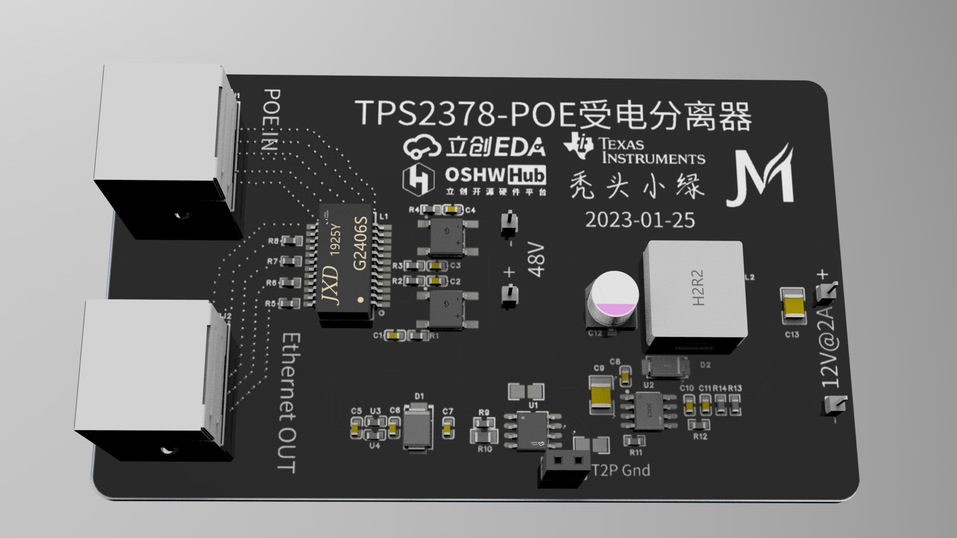

No physical sample is currently available. TPS2378-1.0-3D rendering (February 2023).

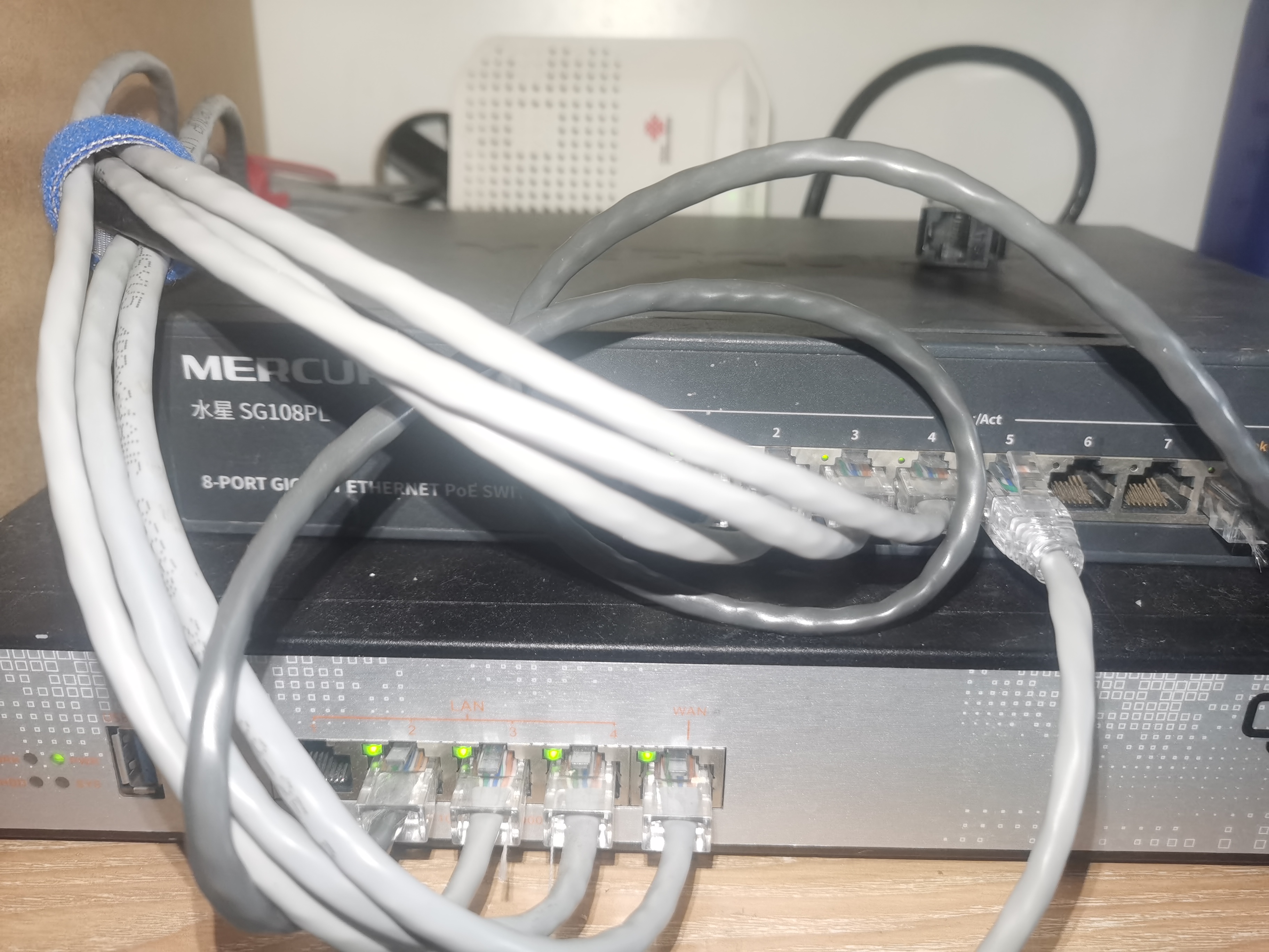

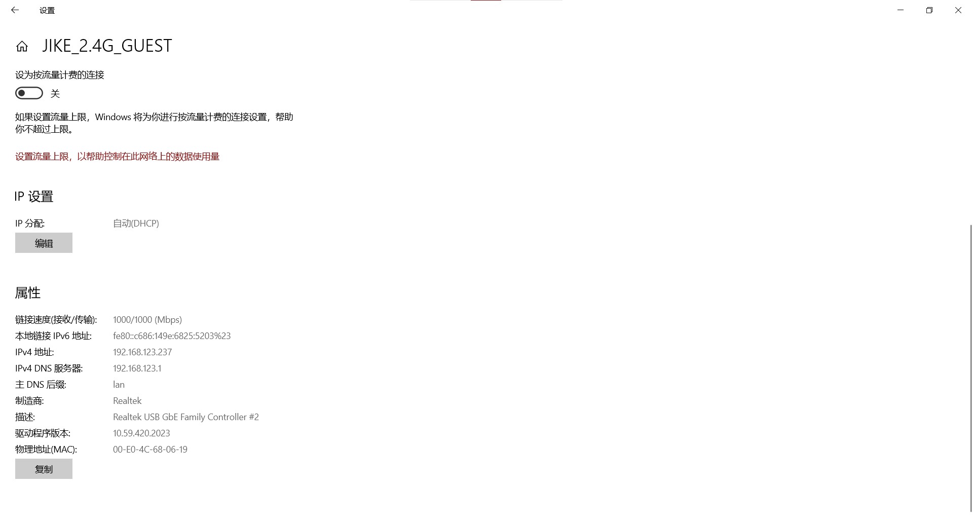

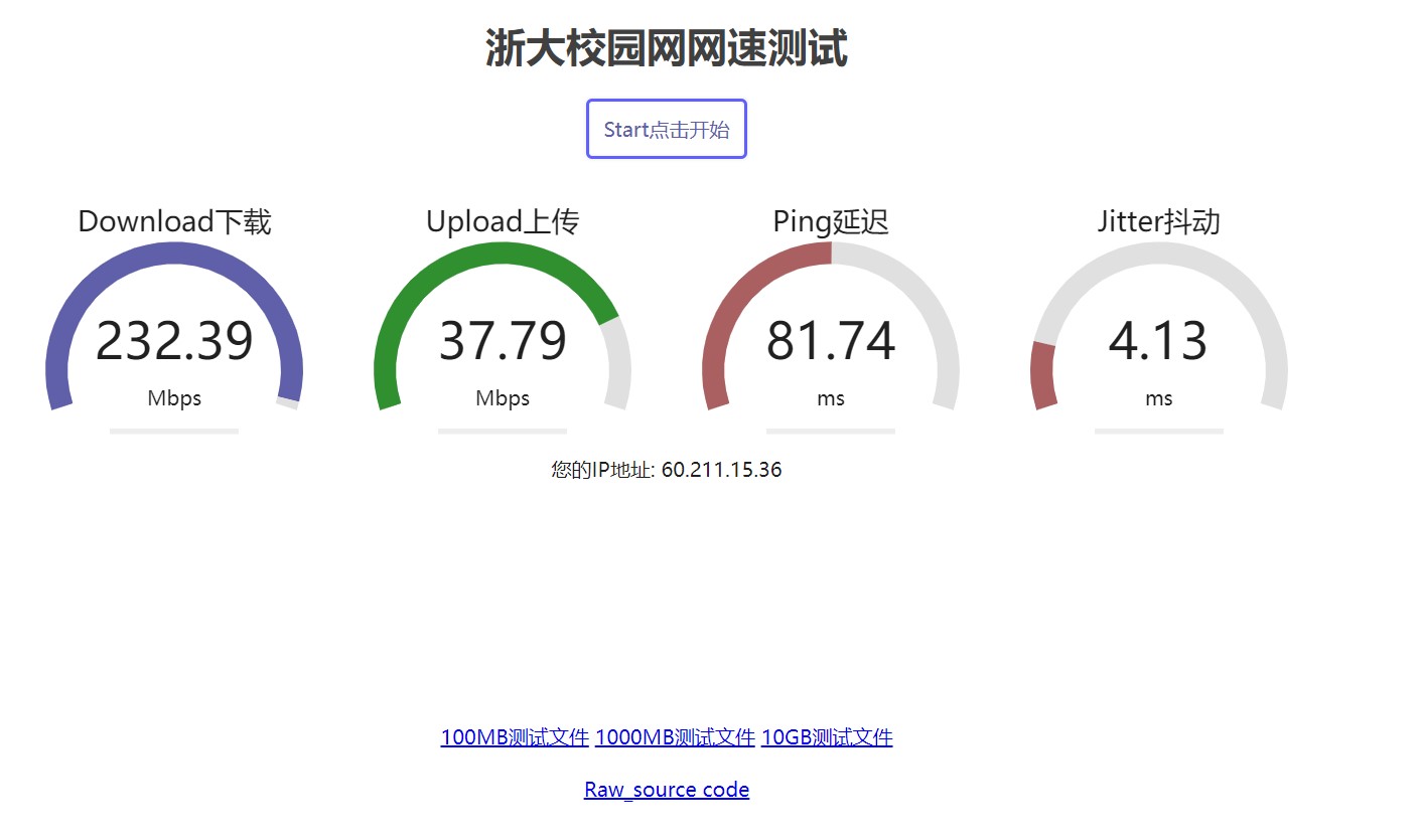

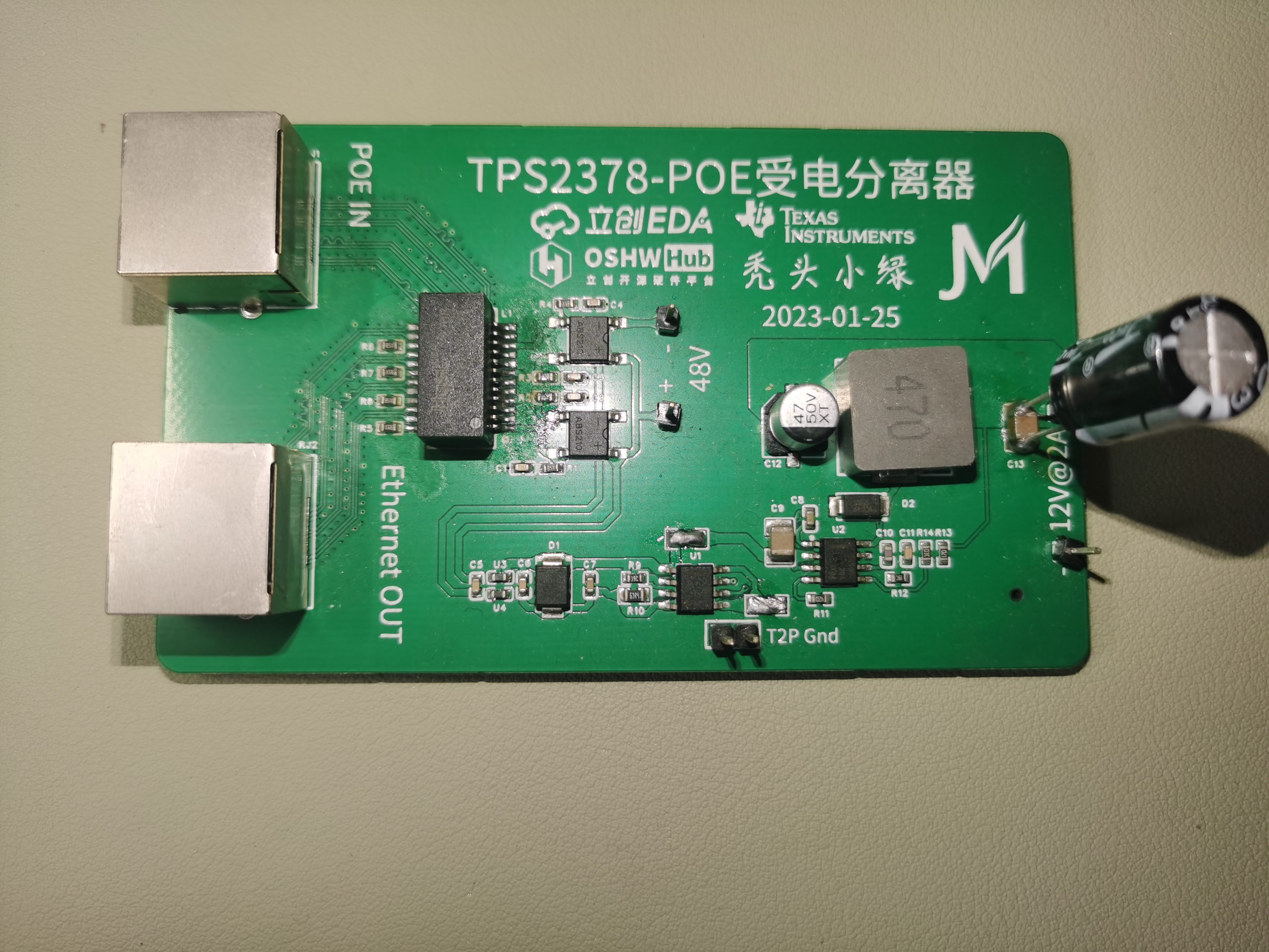

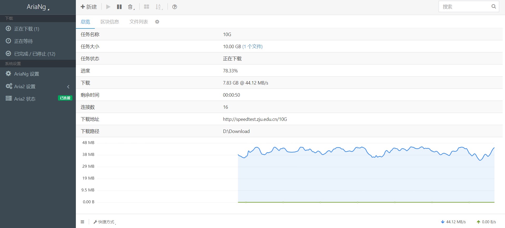

TPS2378 physical sample image (ignore the added 220uF electrolytic capacitor) (This differs from the final PCB design; the final PCB has been modified!). Design Notes : All model numbers are subject to the schematic! All model numbers are subject to the schematic! All model numbers are subject to the schematic! Please refer to the text descriptions in the schematic and compare them with the BOM! Other physical verifications: Test platform: Mercury SG108PL gigabit PoE switch, China Unicom home 300 Mbps broadband, USB 3.0 RTL8152B gigabit network card , electronic load tester as shown in the picture. SG108PL 5-port - PoE splitter input, PoE splitter output - USB network card - Computer negotiation speed recognition normal - gigabit speed test: (load 12V 2.1A) 1. Zhejiang University campus network speed test 2. Zhejiang University campus network speed test - 10GB large file download Postscript: Perhaps careful observers will notice that the webpage link for this project says PoE-power-system, but there is actually only one PoE splitter. Why is that? Perhaps you will also notice that the PCB and verification were separated by a year... Why is that? Actually, the original plan was for the system to include both PSE power supply and PD power receiver, but since a year ago, I have become increasingly busy and have less and less time... In the end, only the PD power receiver was completed...
