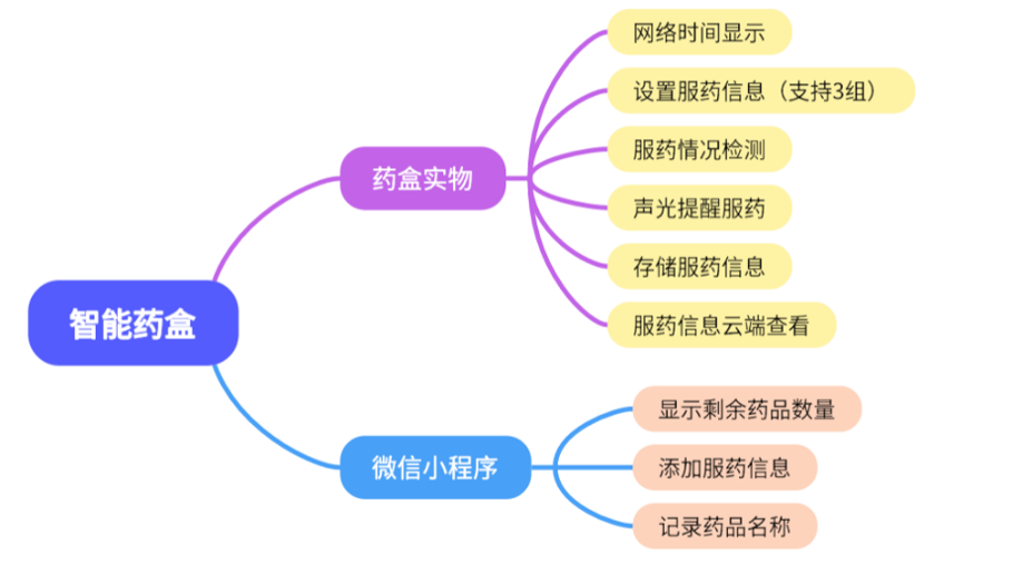

Project-related functions:
The project mainly includes embedded hardware and software design and WeChat mini-program design.

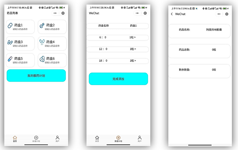

Key code in WeChat Mini Program

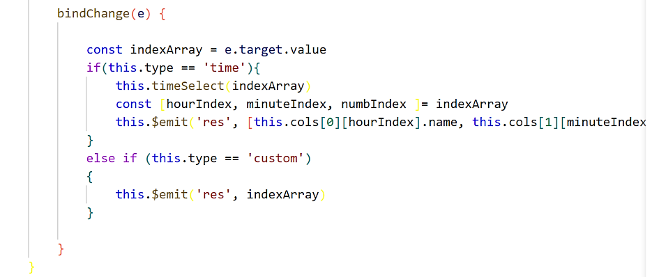

uses picker-view The component implements a scrolling category selection function.
A `scrollSelecter.vue` file is created to write the selector style, and the function is imported into the "Add Medication Plan" interface.
A `bindChange(e)` event is created to store the set time in an array for easy display and distribution to the smart pillbox.
The `getSelectRes(res)` function in the "Add Medication Plan" interface retrieves the set medication time and other information.

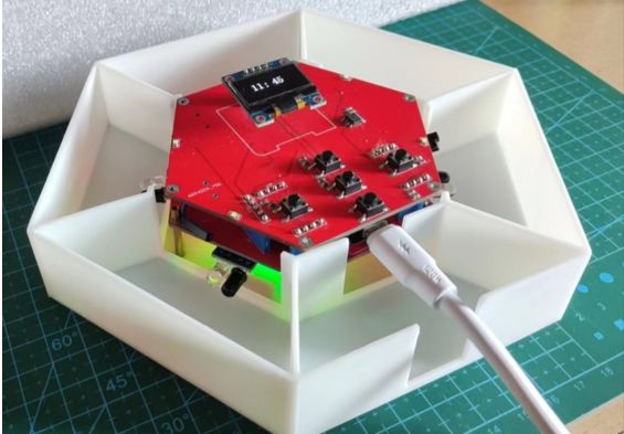

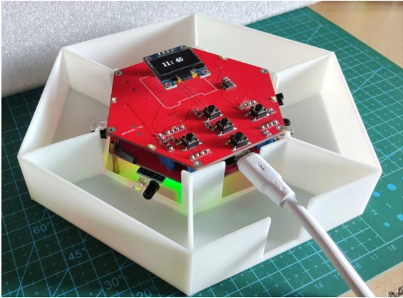

A physical demonstration shows
a 3D-printed monkey resin shell, fabricated on a JLCPCB, powered by Type-C. The main control unit consists of two stacked PCBs connected by copper pillars. The bottom PCB houses the infrared detection module and the network module. The top PCB contains the AIR32 main controller and the OLED display. Overall control is achieved via buttons or a WeChat mini-program.
WeChat mini-program display
