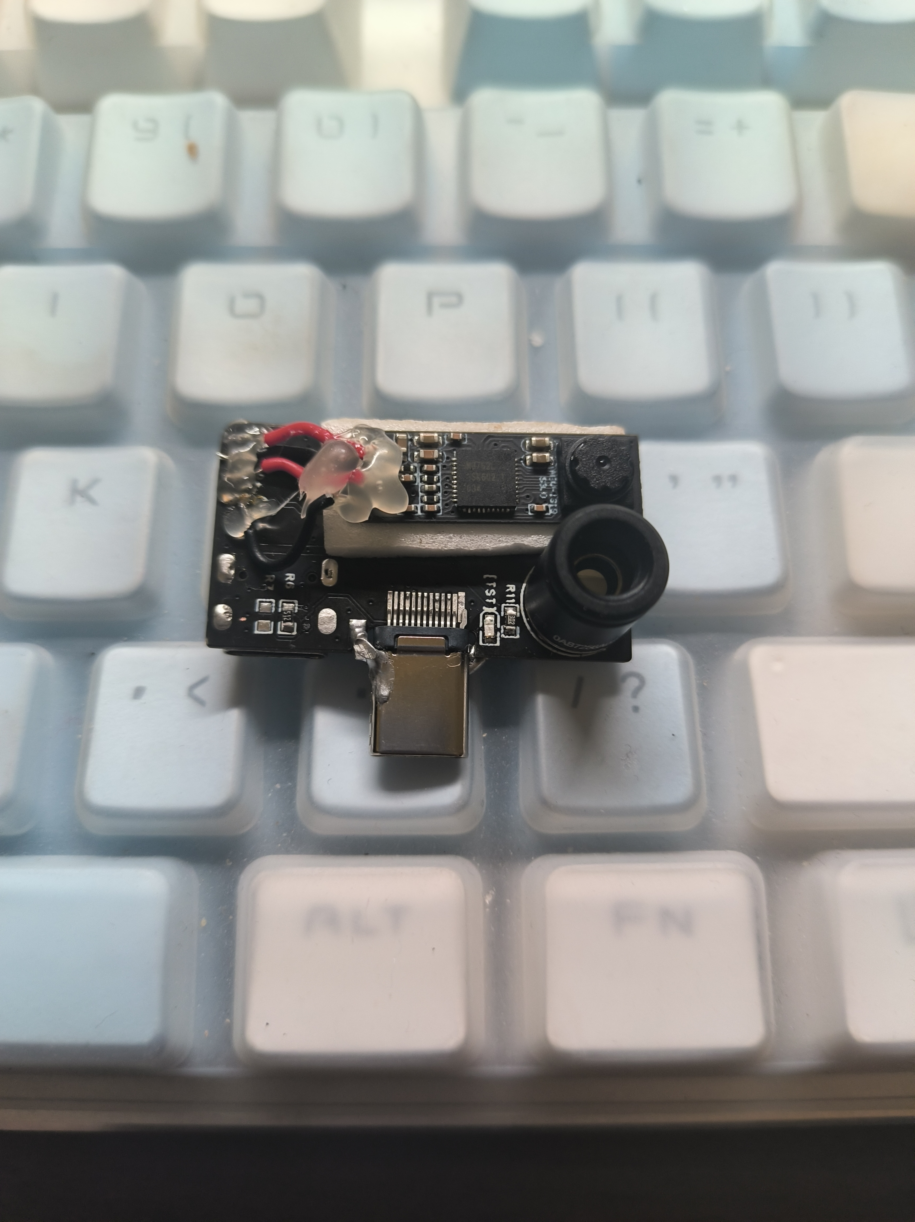

Binocular mobile thermal imager v2
Project Description:
Visible light cameras offer high resolution and frame rate, while thermal imaging sensors measure temperature distribution but suffer from low resolution and frame rate. Visible light images are used to compensate for thermal imaging images, resulting in higher-quality heat distribution maps. The device consists of a standard visible light camera and a thermal imaging sensor. After being read by an MCU, the data is transmitted to a mobile phone via USB. The phone's powerful computing capabilities enable image processing and fusion, displaying the final image on the screen (excerpt from a binocular mobile thermal imager).
This project replicates a binocular mobile thermal imager, but with lower costs (excluding the camera, costs can be controlled to around 10 RMB). It is compatible with Android apps, although refresh rate control is not yet implemented. The hardware uses AT32F415KBU7 and CH334R, making it more compact than the original project. The project is
licensed under
the MIT license, which grants the right to use, copy, modify, merge, publish, distribute, sublicense, and sell the software and copies thereof. Licensees may modify the license terms as needed for the program. The software and all copies thereof must include a copyright notice and license notice, but the original author assumes no risk of use and has no obligation to provide technical support.
Advantages:
The AT32F415 has a built-in crystal oscillator, so USB does not require an external crystal oscillator (saving 0.5 yuan). Although I soldered a crystal oscillator in the picture, it is not actually needed, so please do not solder it.
The AT32F415 is 2.5 yuan with free shipping on Taobao, which is cheaper than the STMF411 which costs over 10 yuan.
The CH334R hub chip supports MTT mode, theoretically offering more stable speeds. It is 1.5 yuan with free shipping on Taobao.
It supports both direct-plug and female interfaces, making it more convenient to connect to mobile phones via dual-port Type-C.
It has buttons and a BootLoader (which needs to be downloaded the first time), allowing for upgrades via USB flash drive.
A programmable fuse has been added to prevent short circuits (I haven't tested it myself).
Note that
the AT32F415 is relatively small; be careful when soldering to avoid cold solder joints.
R6 and R7 are CC pull-down resistors; if direct-plug functionality is required, only R6 should be soldered.
The crystal oscillator circuit on top of the AT32F415 does not need to be soldered; soldering it won't help.
For the first bootloader download, you can use DFU mode. You can search online for instructions on how to enter this mode. I recommend using download tools like Daplink (e.g., Pwlink).
The camera's current might be a bit high; I recommend soldering a resistor under 10kΩ to R10. The maximum current calculation formula is 6800/RA.
G is GND, V is 3.3V, C is SWCLK, and D is SWDIO.
The board mounting thickness must be 0.8mm or 1.0mm.
Type-C is a clamp-type
BootLoader.
The BootLoader occupies space 0x800000-0x8006000 and is driven by buttons. If this is the first time downloading a program, it will automatically enter USB mode upon powering on. Drag the .bin file into the USB drive to download.
In BootLoader mode, the LED will flash for 0.5 seconds, indicating that it is in BootLoader mode
. If ready.txt appears in the USB drive, you can drag it in; if success.txt appears, the download is successful.
In BootLoader mode, if the download is successful, you can click the button to enter the downloaded program, or double-click the button in any mode to force entry to the app location at 0x8006000.
There are two ways to enter BootLoader :
press and hold the button while powering on
, or long-press the button in the user program.
Other notes:
The program is currently incomplete and only supports basic functions, but the phone cannot yet control the hardware. The
casing has problems, so replicating the casing is not recommended.

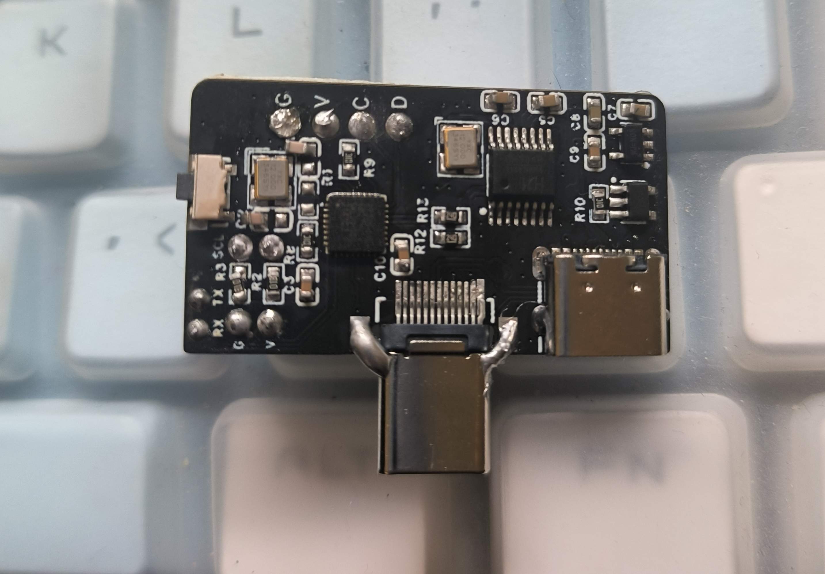

USB Keyboard Prankster
This is a prank device implemented using the CH9329 based on the ESP32 S3 and WCH. The ESP32 S3 is responsible for the USB host to parse the USB keyboard data, and the CH9329 is responsible for reporting the device as a keyboard device to the host computer.
This is a device that allows you to prank others. After connecting it between the other party's USB keyboard and the host computer, you can connect to this device via Bluetooth using Blinker on your phone. The information output in Blinker will then appear on the other party's computer.

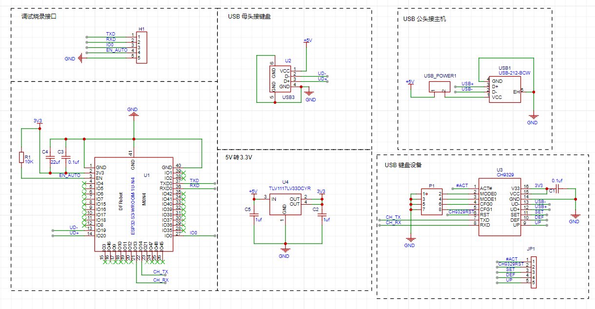

The hardware design is as follows:
The upper left corner is a reserved debugging and programming interface, through which you can program the device and send debug information to the PC.
The lower left corner is the core of this design, an ESP32-S3 chip, which enables USB host and Bluetooth communication.
The ESP32-S3 operates at 3.3V, and a TLV1117 is used here. This chip only requires two 1uf capacitors.
The lower right corner is the CH9329 chip, an HID to serial port chip used in this design to implement the USB keyboard function.
The CH9326 is a driverless HID to serial port chip. The CH9326 supports bidirectional data transmission, used to receive serial port data and, according to the HID class device specification, package the data and upload it to the computer via USB, or receive USB data packets compliant with HID class devices from the computer and send them via serial port. The provided host computer software allows users to configure the chip's VID, PID, and various string descriptors. The chip is in an SOP16 package, making it easy to solder.
The basic design idea is that the ESP32-S3 parses USB keyboard data to obtain key information. This information is then sent to the CH9326 via serial port, and the CH9326 simulates key presses on the PC. As you can see, this device is transparent to the PC. Afterwards, the Blinker's Bluetooth function can be used to connect the phone and this device, allowing characters to be sent from the phone to the PC.
The PCB design is as follows:
A computer screen shot of a circuit board<br>Description automatically generatedThe finished product is as follows (color silkscreen printing, gold plating process, and a QR code on the back):
The Arduino code is as follows:

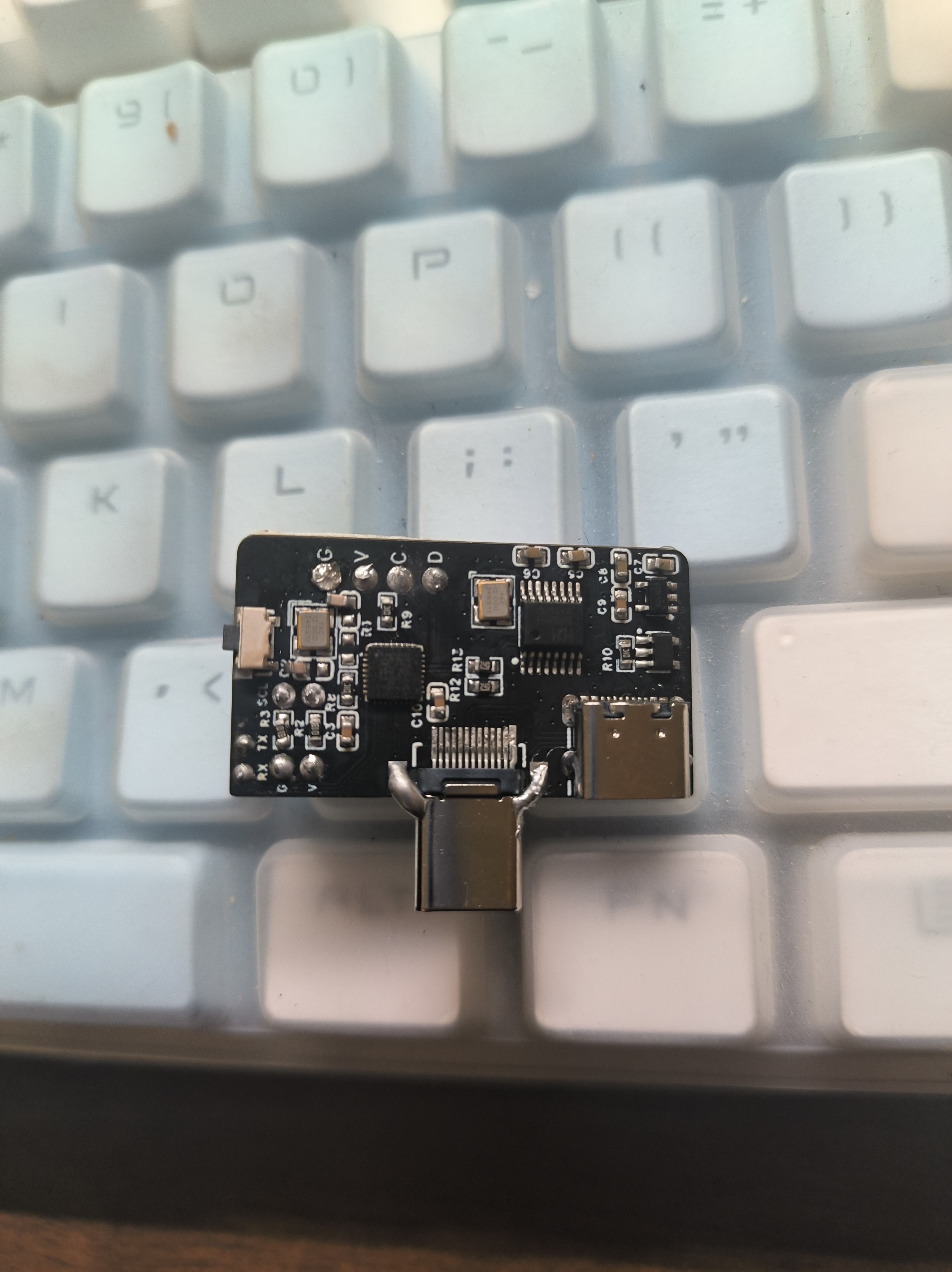

Photo of the board after it has been installed in the casing:
