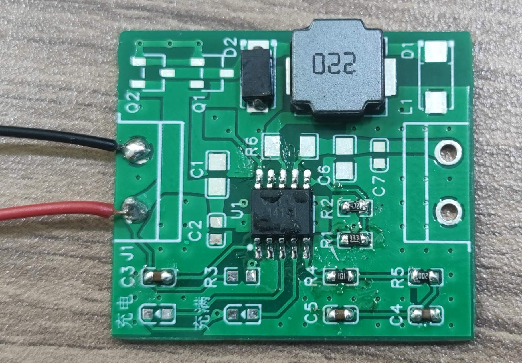

  Now that the weather is getting hotter and I’m looking at the bright sun, I’ve been wanting to take advantage of it. Although I know I can’t save on electricity bills, I like the fun of DIY.
The explanation on the schematic diagram is based on the specification and another engineer, and I have verified both.
There are no terminals on the physical board. I bought them originally but couldn't find them when I used them. Isn't that annoying?
The PCBA is not the smallest one. The main consideration is that it has to be soldered by hand, which is inconvenient. Compared with Taobao, the PCB area is much larger, but the performance is better. I sacrificed area for efficiency.
I have been using it at home for the past few days. The effect still needs time to be verified. I have to go to work during the day and there is no measurement data. Is it working? Whether it works well or not needs further verification.
Also, take a look and see if there are any flaws. Please give me advice.
