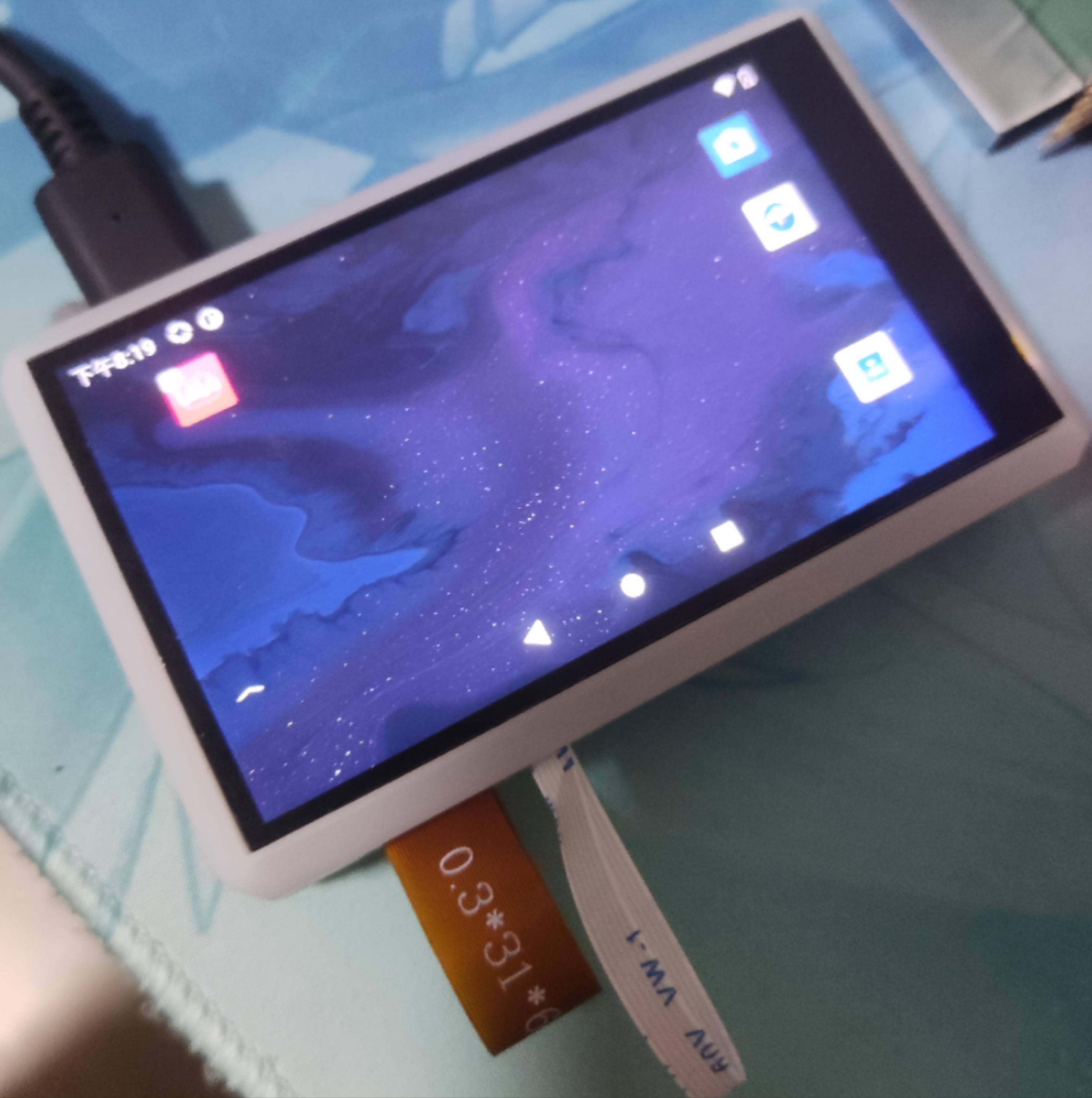

Mobile project based on Taishanpai development board
   First, I'd like to thank Mr. Wu, the development team, and LCSC for providing this opportunity. They offered a lot of help and very detailed tutorials, enabling me to replicate my first small mobile phone. Finally, I'd also like to thank the members of the LCSC Taishanpai Development Board Exchange Group for their help; there are many excellent experts there.
This project schematic analysis
    and design extension is based on the Taishanpai "Fat Girl" mobile phone replication tutorial .
     [Fat Girl Mobile Phone] Project Outline - Feishu Cloud Documents (feishu.cn).

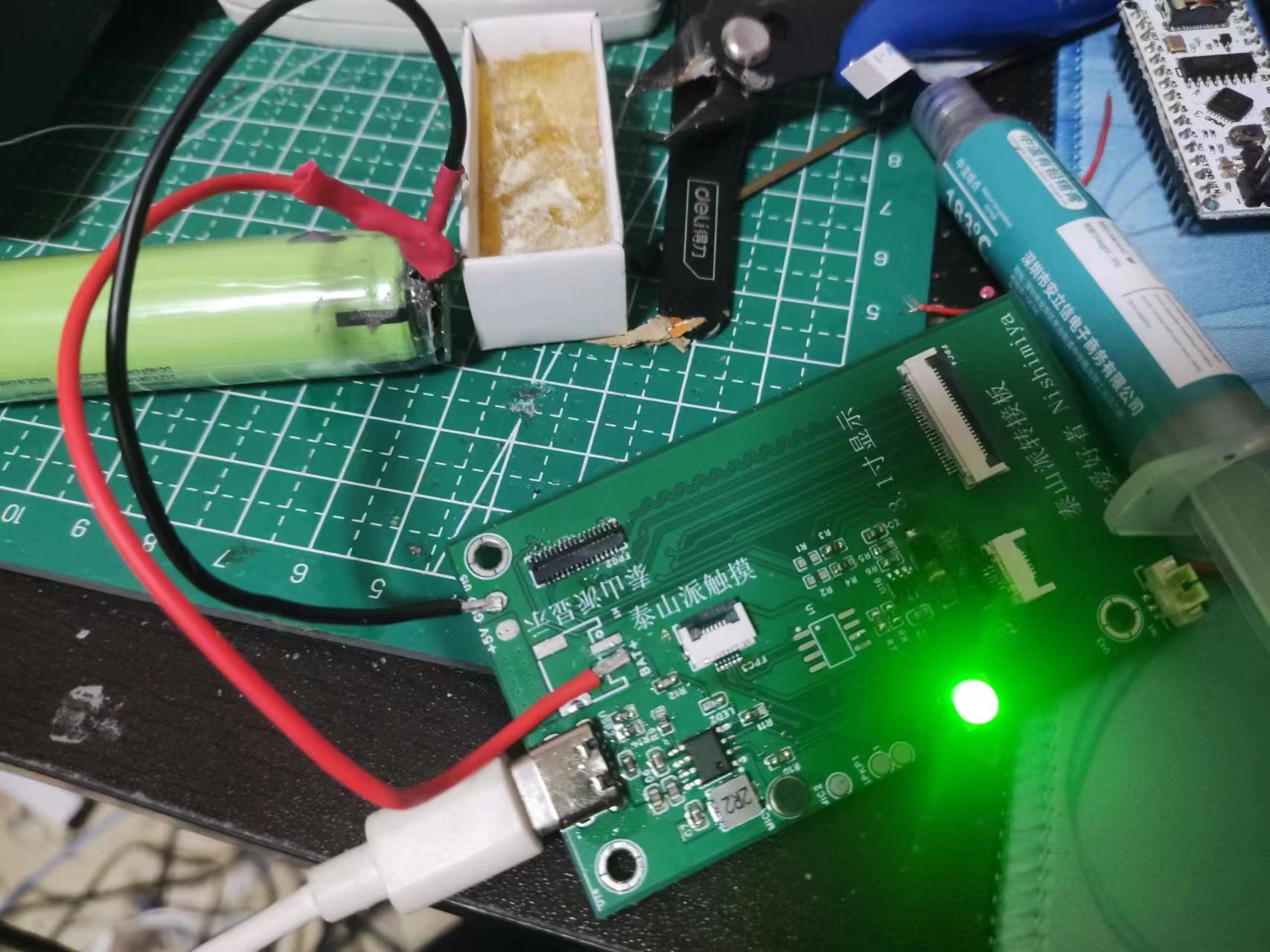

    On this basis, battery charging and discharging functions have been added, allowing for external battery connection.
     Since I only had 0603 capacitors and resistors on hand, I replaced the 0805 packages with 0603; the soldering difficulty is about the same.
The open-source code
    is based on the official LCSC tutorial, with modifications to the compilation image. Currently, it's for Android, and the logo and boot animation have been replaced.
      The Android code patch
    can be compiled according to the tutorial. Note that you don't need to `make clean` after the first compilation! Otherwise, it will
    take a very long time to compile. Make sure the virtual machine has enough memory, otherwise the terminal will crash midway. For
soldering
    , I personally recommend using a soldering station. Wu Gong has also provided soldering tutorials for the Taishanpai expansion board.
     Always check for short circuits and cold solder joints; if it doesn't light up, it's most likely due to cold solder joints.
(Image showing effect).

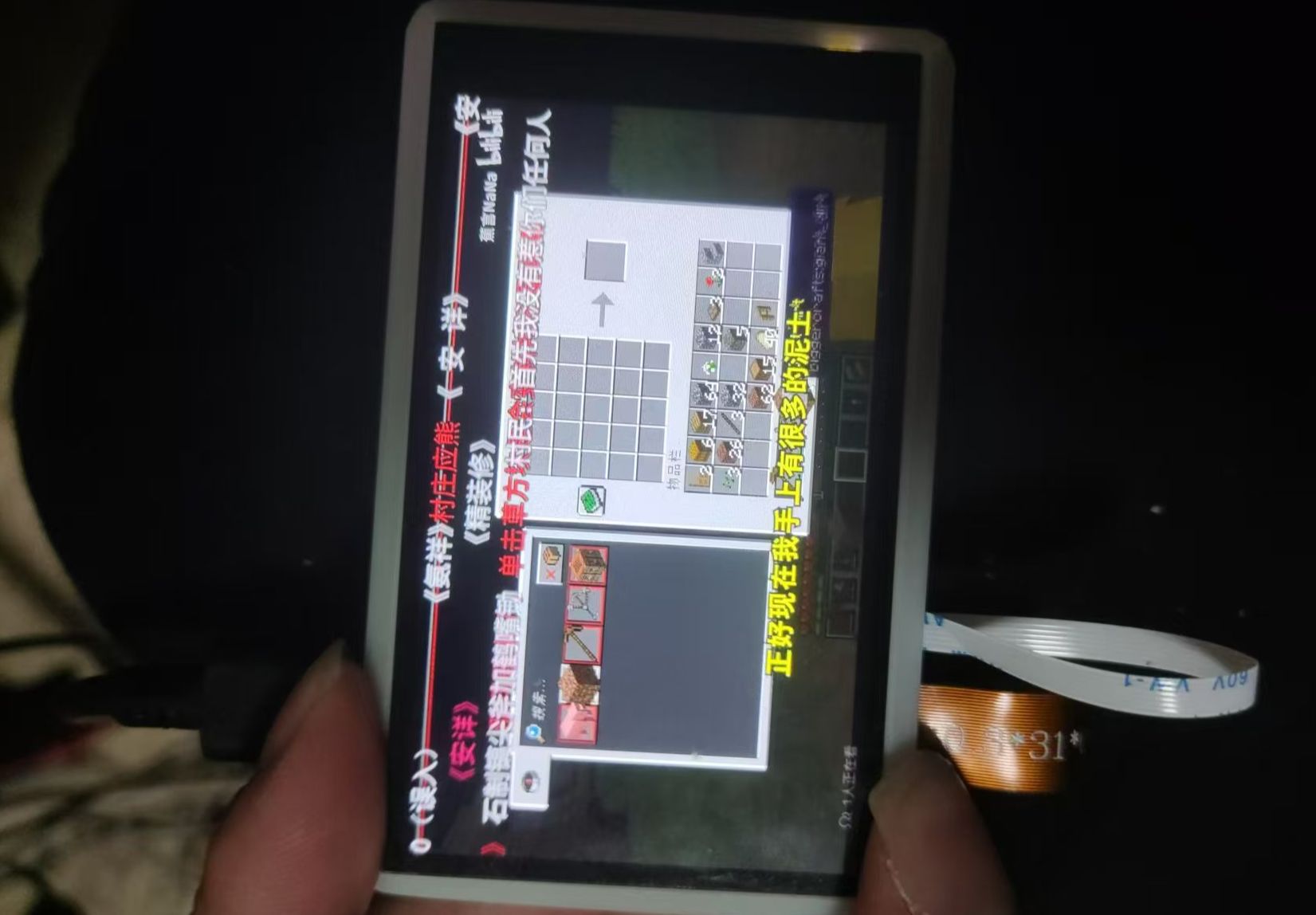

Based on the LCSC Taishanpai 3.1-inch smartphone
Lichuang Taishan School Training Camp Activities~
Functional Description:
Schematic Diagram: Based on the Taishanpai Training Camp's 3.1-inch Smartphone Training Camp activities, hardware and software design was carried out. Hardware design included the removal of the Taishanpai MIPI interface, microphone & speaker, design of onboard backlight control circuit, 3.1-inch touchscreen and 3.1-inch MIPI interface, completing the basic hardware design of the smartphone.
PCB Design Notes: The PCB design was mainly based on Mr. Wu's small phone tutorial. The main concern was controlling the differential pair trace length and
soldering issues: Manual soldering was mainly difficult on the FPC. Initially, several boards couldn't light up the screen, leading to suspicions that the screen itself was faulty. Later, the FPC connectors were soldered using a blower on the back. Finally, physical verification confirmed that no components were damaged; the problem was primarily with the soldering.
Physical demonstration: Video demonstration: https://www.bilibili.com/video/BV1VwTceZENi/?pop_share=1&vd_source=a1bee00019ba812a5a1c6ce2799547b1
Open source code: VII. Mobile Comprehensive Project - Feishu Cloud Document (feishu.cn)
Code reference Wu Gong's demonstration tutorial, hereby special thanks to Wu Gong, from zero to one, although very general, I still completed my first small project.
