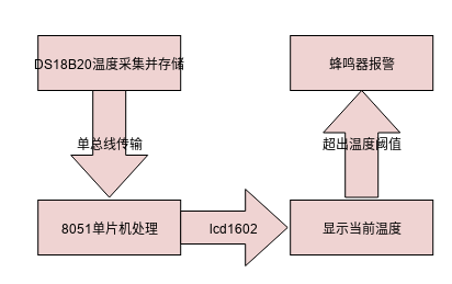

Solution block diagram: Schematic design description

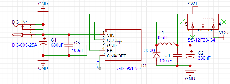

Power supply section:

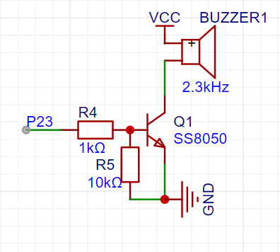

Alarm circuit:

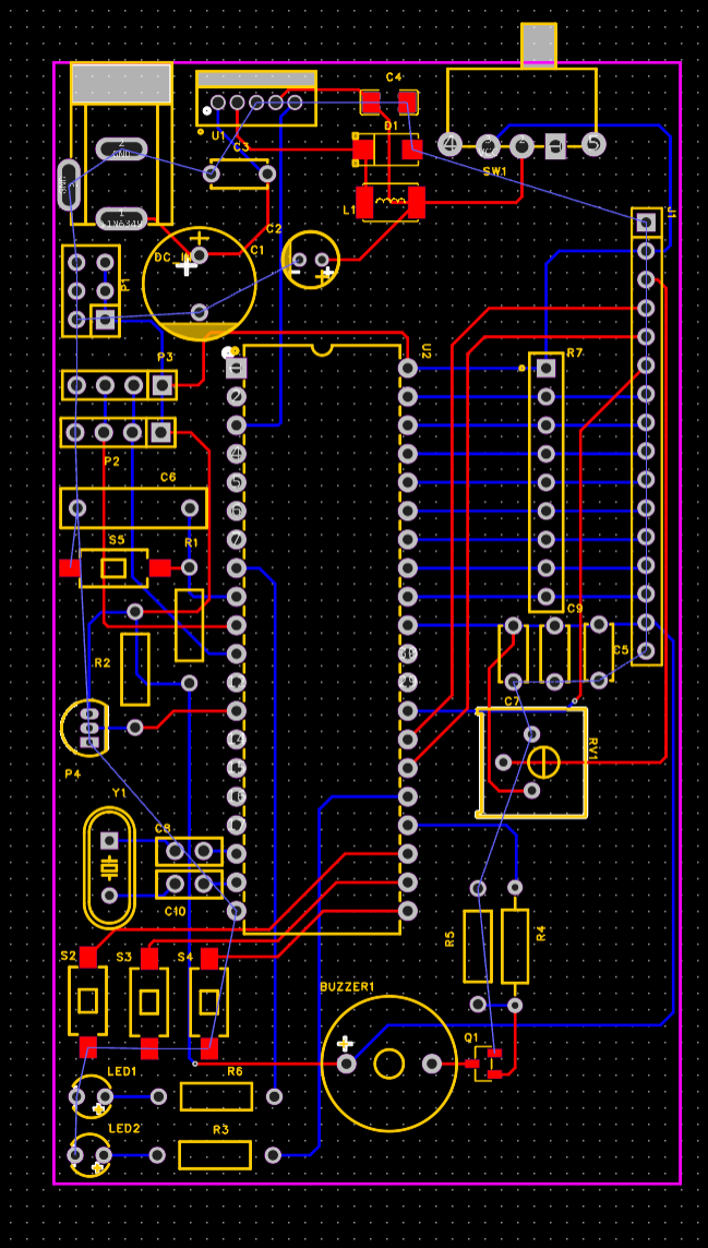

PCB design description
There is nothing particularly noteworthy, except that P0 needs to be connected to an external pull-up resistor.

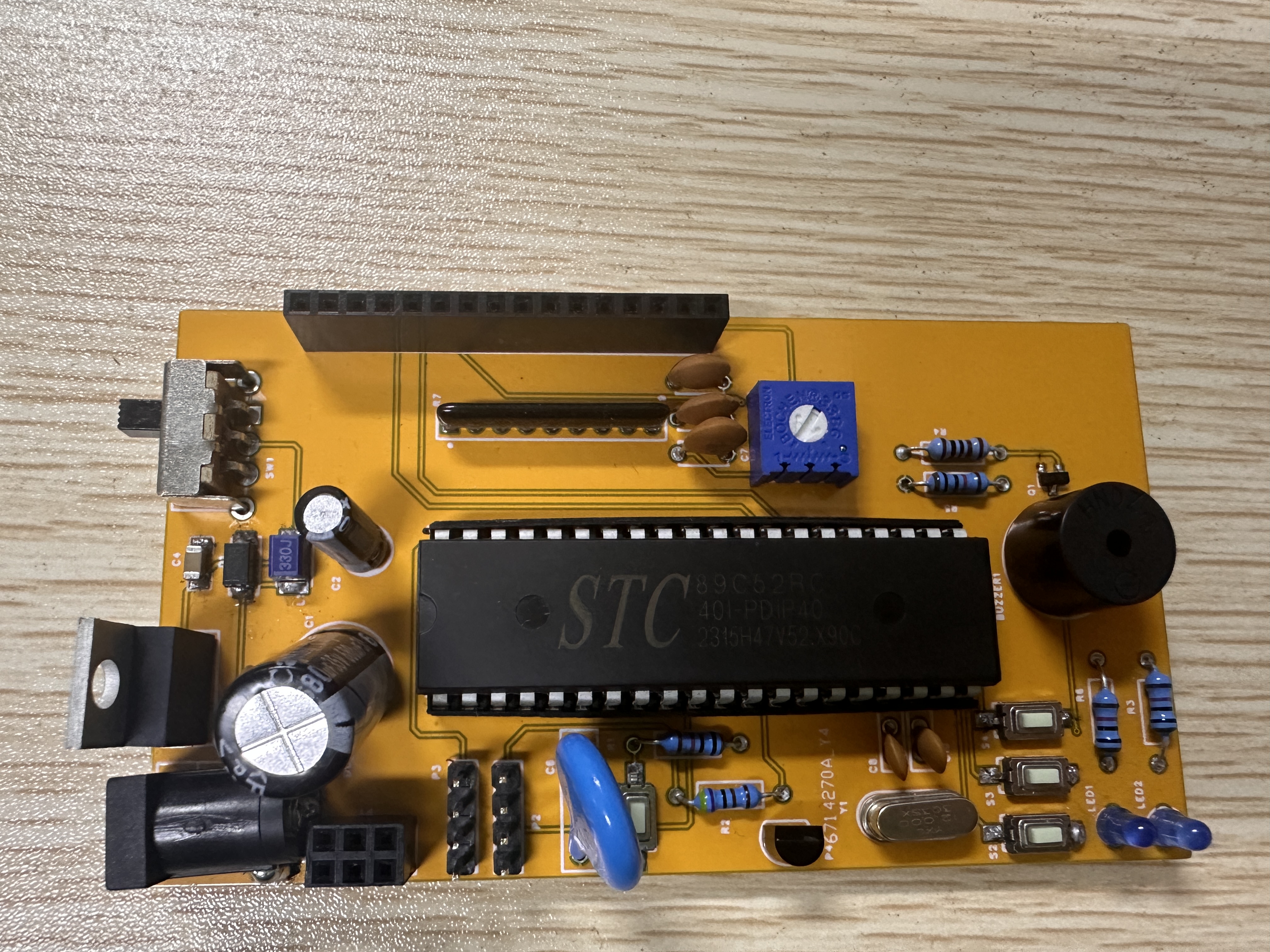

Physical demonstration
instructions: Physical pictures of the work, pictures can be captioned.
