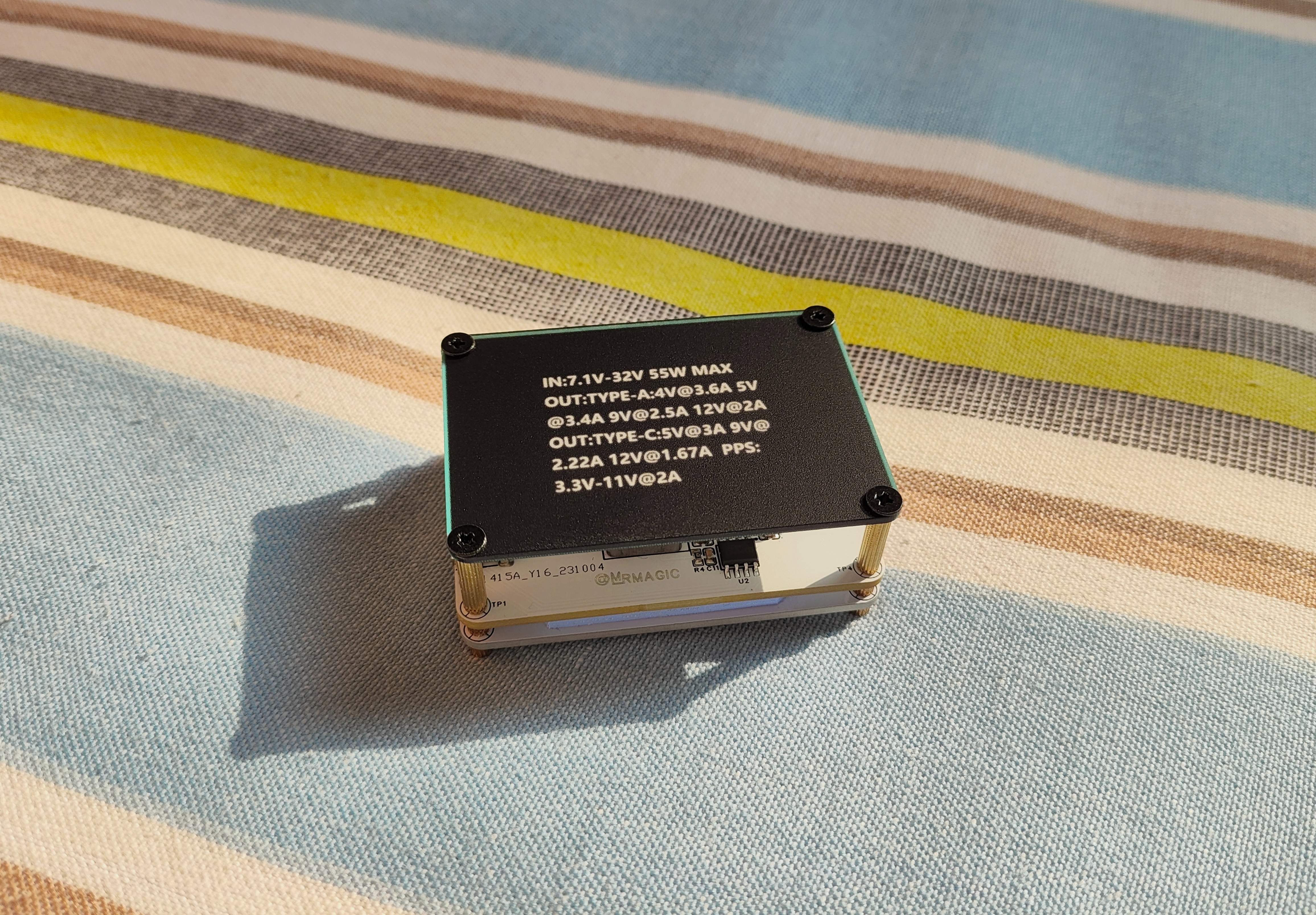

For this project
, PCB1 will be made of FR-4 material, and PCB2 (empty board) will be made of aluminum substrate. A frosted acrylic panel is recommended.
You will need 4 M2 screws (5mm long), 4 M2 double-ended knurled screw posts (11mm long), 8 M2 single-ended knurled screw posts (3mm thread, 3mm body), and one 3.5mm thick thermal pad.
Installation instructions are omitted here.
