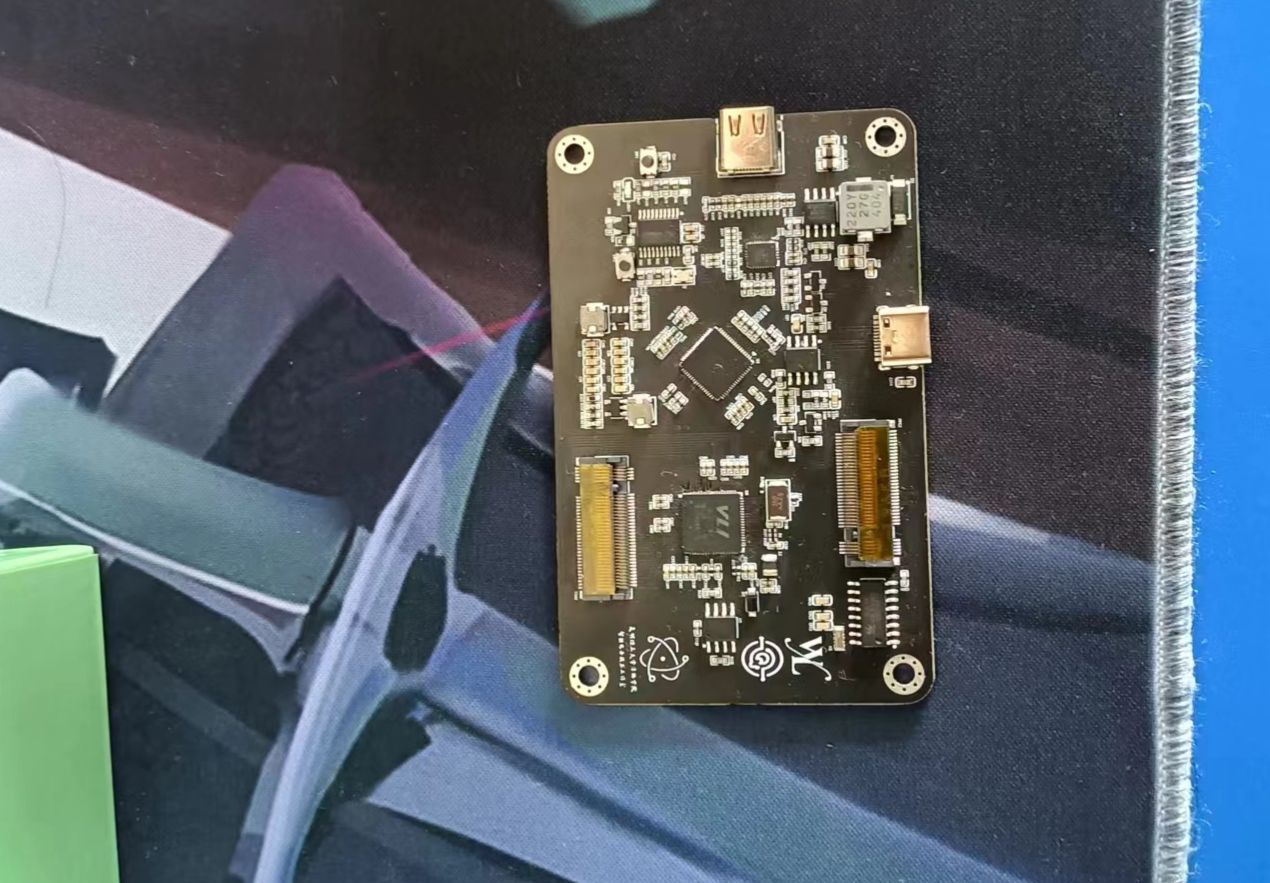

Customized multi-functional hub

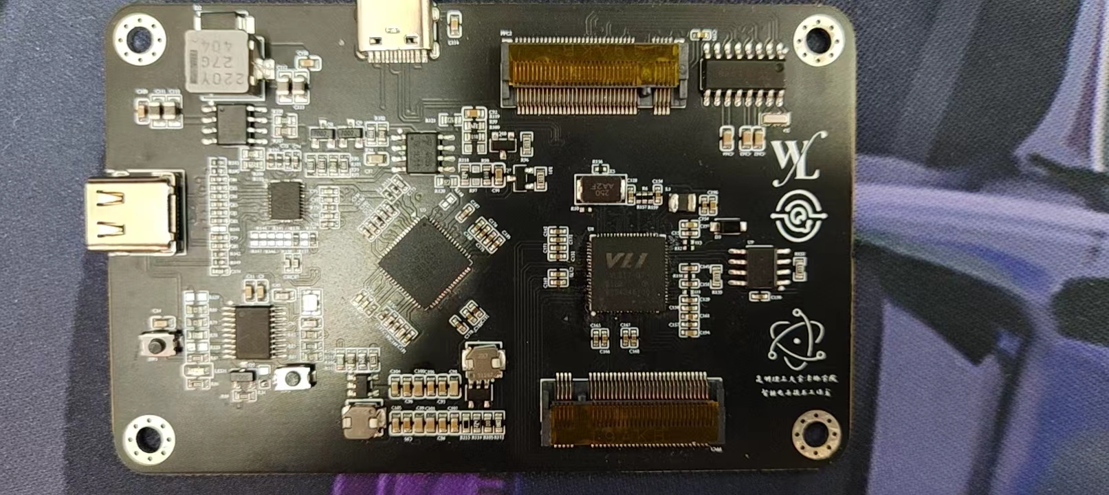

Project Description:
With
the rapid development of the computer industry, many thin and light laptops, in pursuit of extreme thinness and lightness, have cut back on numerous USB ports, retaining only a single USB Type-C port. While there are many Type-C hubs on the market, none offer personalized or customizable options. Therefore, we decided to launch a personalized, high-end, integrated, and customizable multi-port repeater. This product consists of a screen, a WS2812RGB lighting system, a USB hub, a PD 20V 5A 100W charger, a gigabit Ethernet card, a USB programmer, and other peripherals. Furthermore, it includes expandable modules, allowing for personalized expansion according to user needs, making it truly unique.

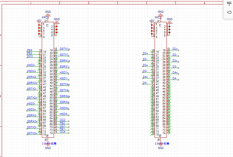

M.2 slot for easy replacement of devices with corresponding interfaces;

: Verified; main functions are available.

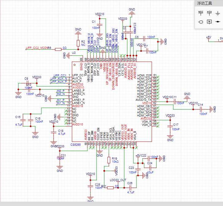

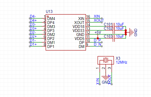

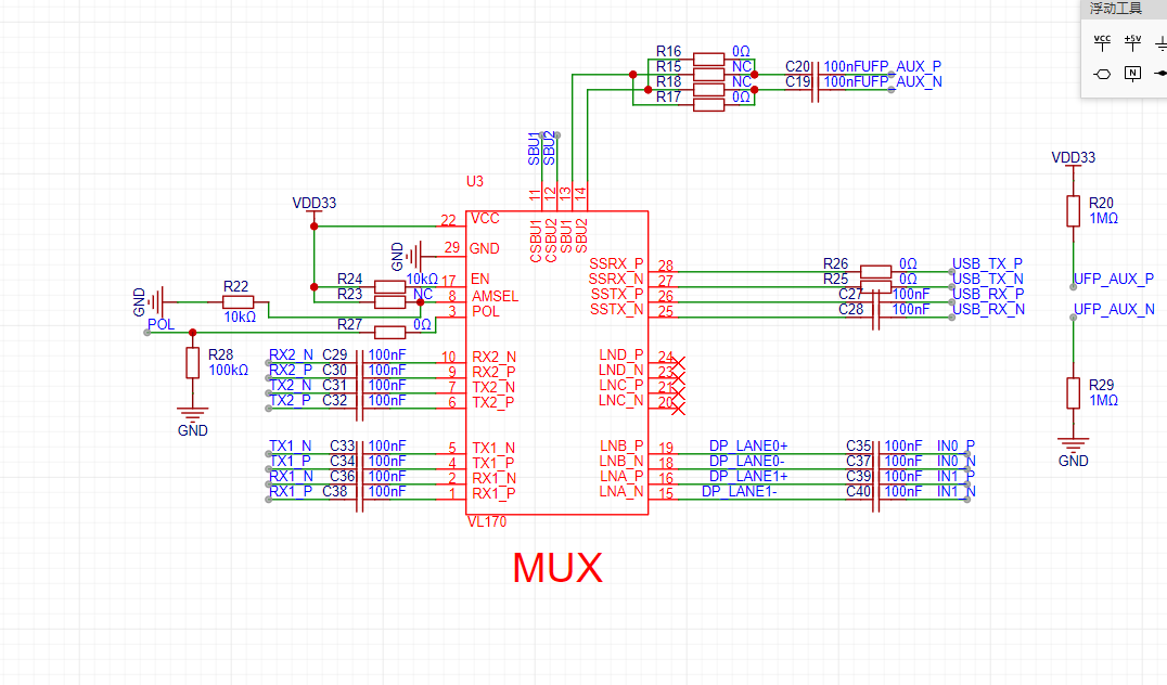

Design principle:
CS5266 main control chip, providing single USB 3.0 and PD100 support.

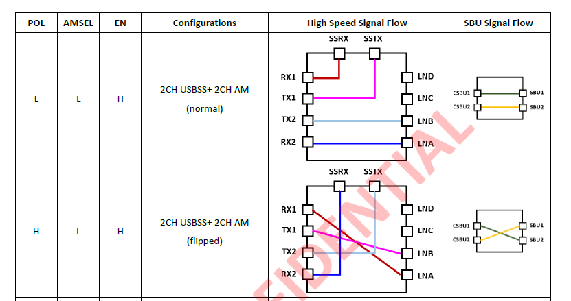

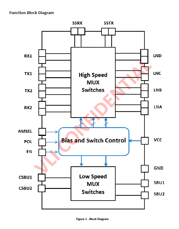

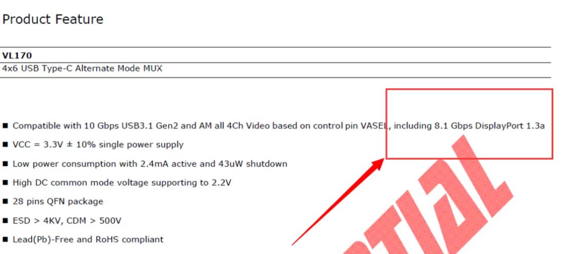

Taking VL170 as an example:
VL170 is a MUX chip used between 4-channel DisplayPort source input and 2-channel USB 3.1 host input to the USB-C connector. The MUX switch signal performance supports up to USB 3.1.

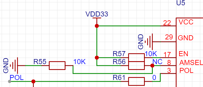

When we need to transmit video, we also need to transmit USB3 signals, so EN is H and AMSEL is L.

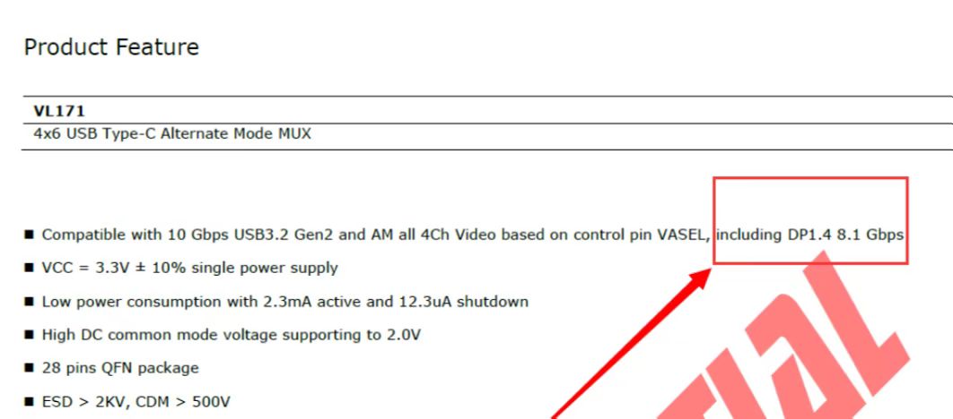

The main difference between VL170 and VL171 is that VL170 transmits DP1.3, while VL171 transmits DP1.4. The two chips are pin-to-pin.

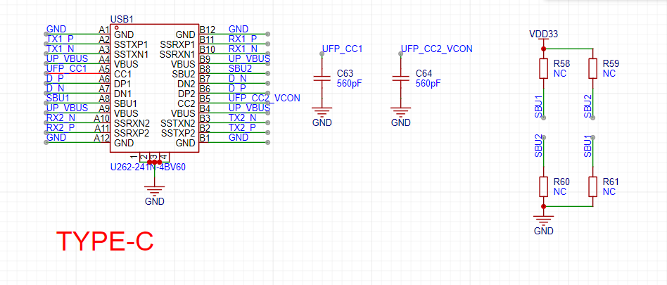

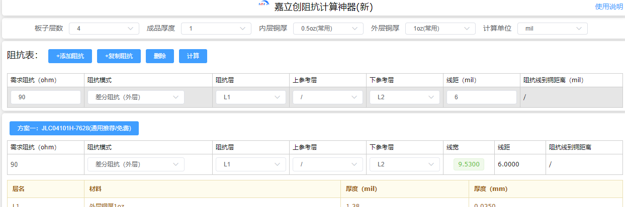

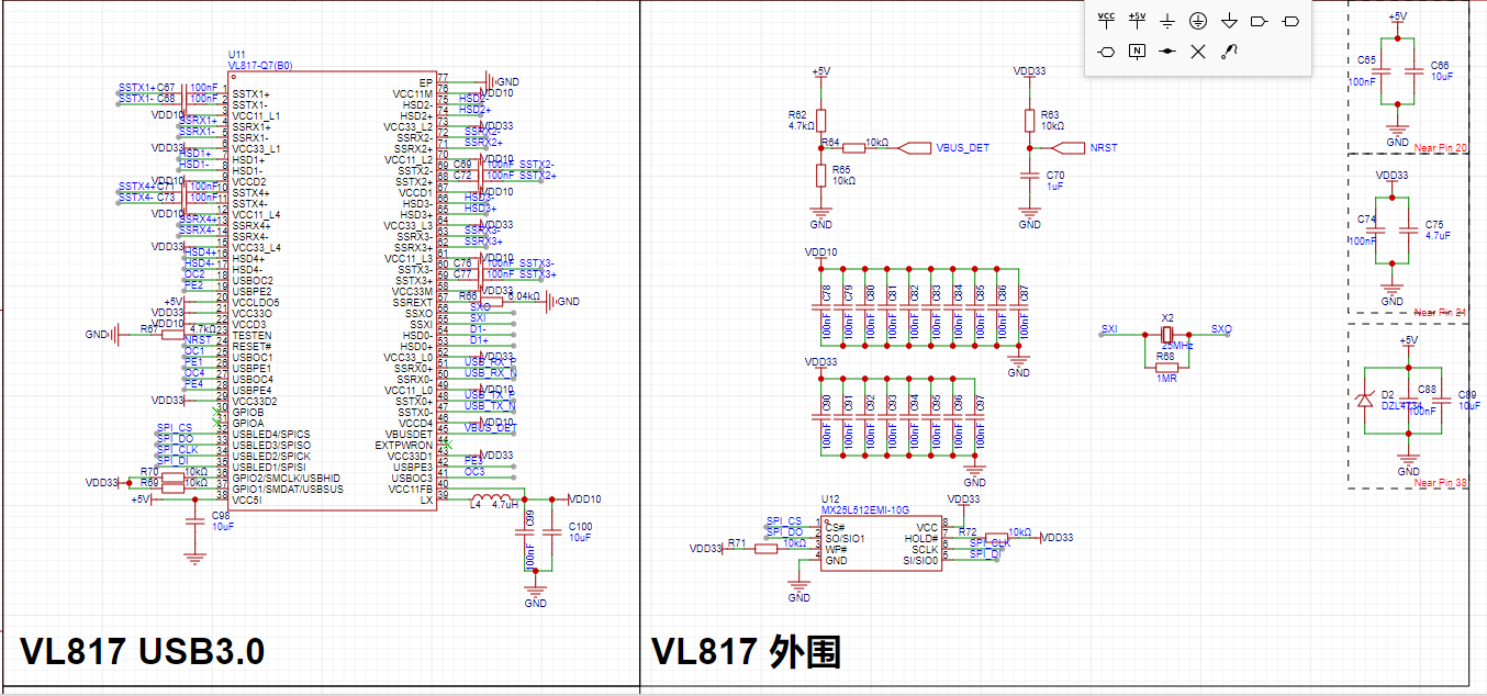

Digital 7680x4320@60Hz DisplayPort 1.1 Digital 2560x1600@60Hz DisplayPort 1.2 Digital 4096x2160@60Hz DisplayPort 1.3 Digital 5120x2880@60Hz DisplayPort 1.4 Digital 7680x4320@60Hz 4. In the MUX control logic CS526X chip, some distributed chips have GPIO5 pin that can perform full-function POL control for VL17X, including full-function Type-C reversible plug conversion. VL817 USB 3.0 expansion, USB 2.0 expansion, 3.0 expansion, and a full-function Type-C 2.0 downstream interface . The layout uses a 1.0 board thickness, four-layer board, impedance structure JLC04101H-7628. The USB section can be used with 90-ohm impedance matching. Type-C A2, A3, A6, A7, B10, and B11 signals need to be routed through USB . All USB signals are differentially spaced with equal lengths. 3.0 90R impedance matching physical demonstration design considerations: Reflow soldering is recommended during soldering. QFN packages are relatively difficult to solder, and M.2 slots are easily damaged by heat. Other demonstration videos: Demonstration videos can be uploaded as attachments. Attachments are limited to a maximum file size of 50MB. Files larger than 50MB can be hosted on other cloud storage or video websites; simply include the link here. Project attachments: Entries participating in the event must upload project-related program attachments to an open-source platform or personal code storage cloud. Attachments are limited to a maximum size of 50MB (please do not upload to the LCSC workspace, as there are restrictions).
