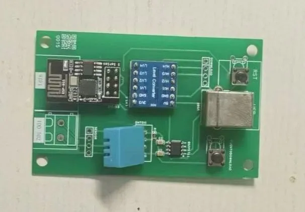

ESP01S-WIFI Wireless Temperature and Humidity Acquisition and Transmission Module
The schematic and PCB layout of the LCSC EDA Professional Edition are used

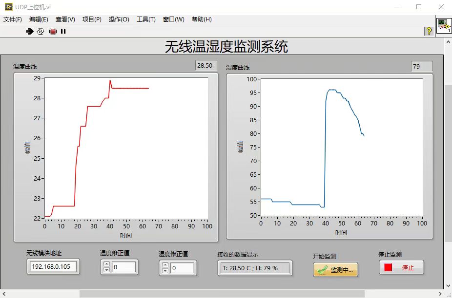

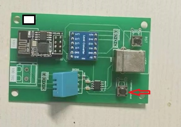

to develop the lower-level ESP01S program using Arduino programming. It employs UDP communication and automatically connects to a Wi-Fi network with the username "admin" and password "admin". Alternatively, the I/O port can be modified to download data via the download port. To download, press the "push to download" button (indicated by the red arrow). The

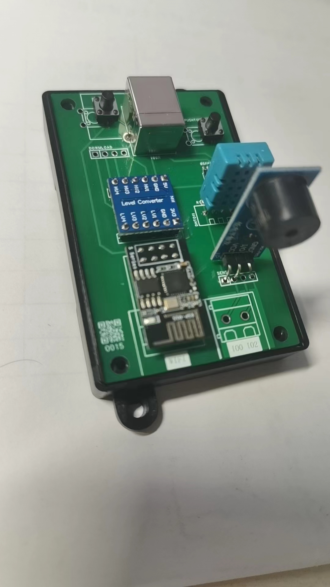

upper-level program is developed using LabVIEW programming. USB serial port power supply is also available for communication and acquiring temperature and humidity data . Both I/O ports of the ESP01S have exposed terminals for easy subsequent programming development. These two I/O ports can be connected to a DHT011 sensor and a buzzer module, as shown in the diagram above.
