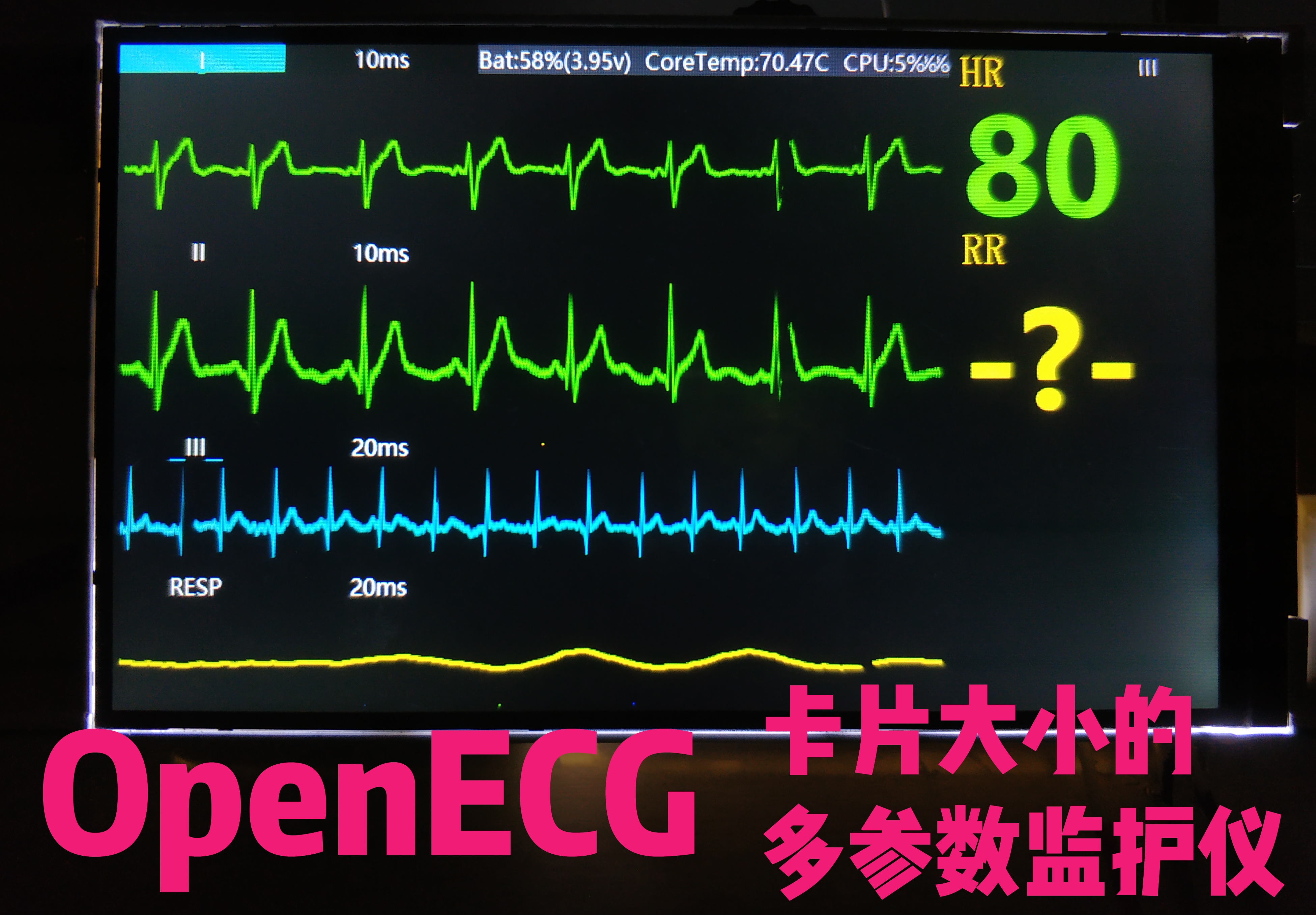

    OpenECG is an open source portable multi-parameter monitor project. The portable monitor is about 122*71*20mm in size. Although it is small in size, it has many functions. The monitor integrates an ADAS1000 to realize 7-lead ECG monitoring + RESP (electrocardiogram + respiration) monitoring. It also has an expansion interface and supports cascading. Through the expansion interface, full-lead (12-lead) monitoring, SPO2, NIPB, and even CO2, EEG can be realized.

    The monitor is different from general household products. It does not require complex graphics rendering or fine color details. Therefore, this design uses a 5-inch TFT color screen, which uses RM68120 as the main control, built-in video memory, and the main control uses analog IO to drive this screen, which simplifies the code and does not occupy too much memory resources.
     Users can operate the device through a rotary encoder and two function switches. This design takes into account the impact of harsh environments (such as rainy days) and the performance occupation of the processor, and does not design a touch screen function. In actual applications, the combination of rotary encoders and switches is sufficient to meet the operation requirements. In addition, the device is equipped with an AT24C128, which can be used to store historical parameters in order to reflect the historical trend of parameters and better understand the patient's condition.
