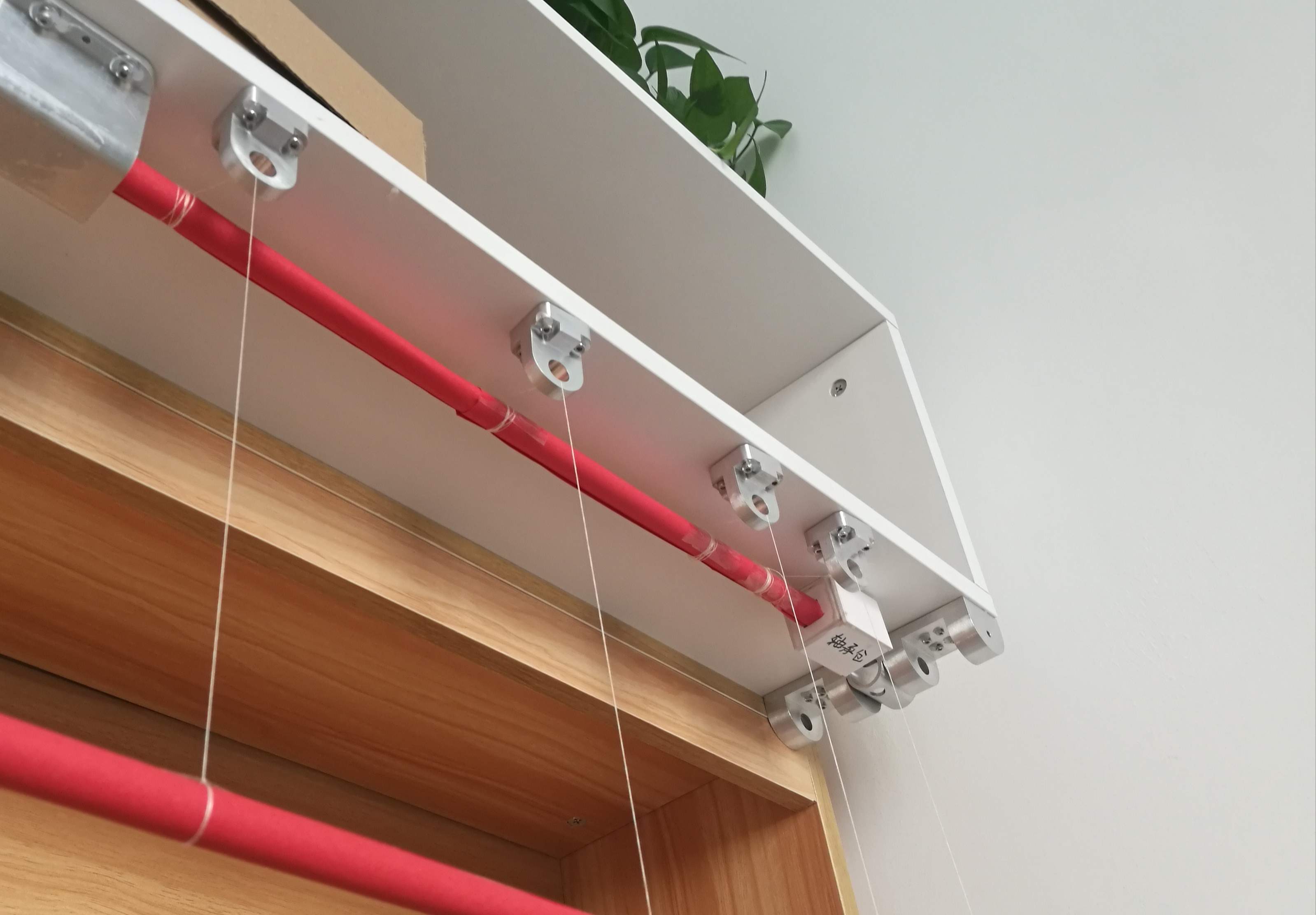

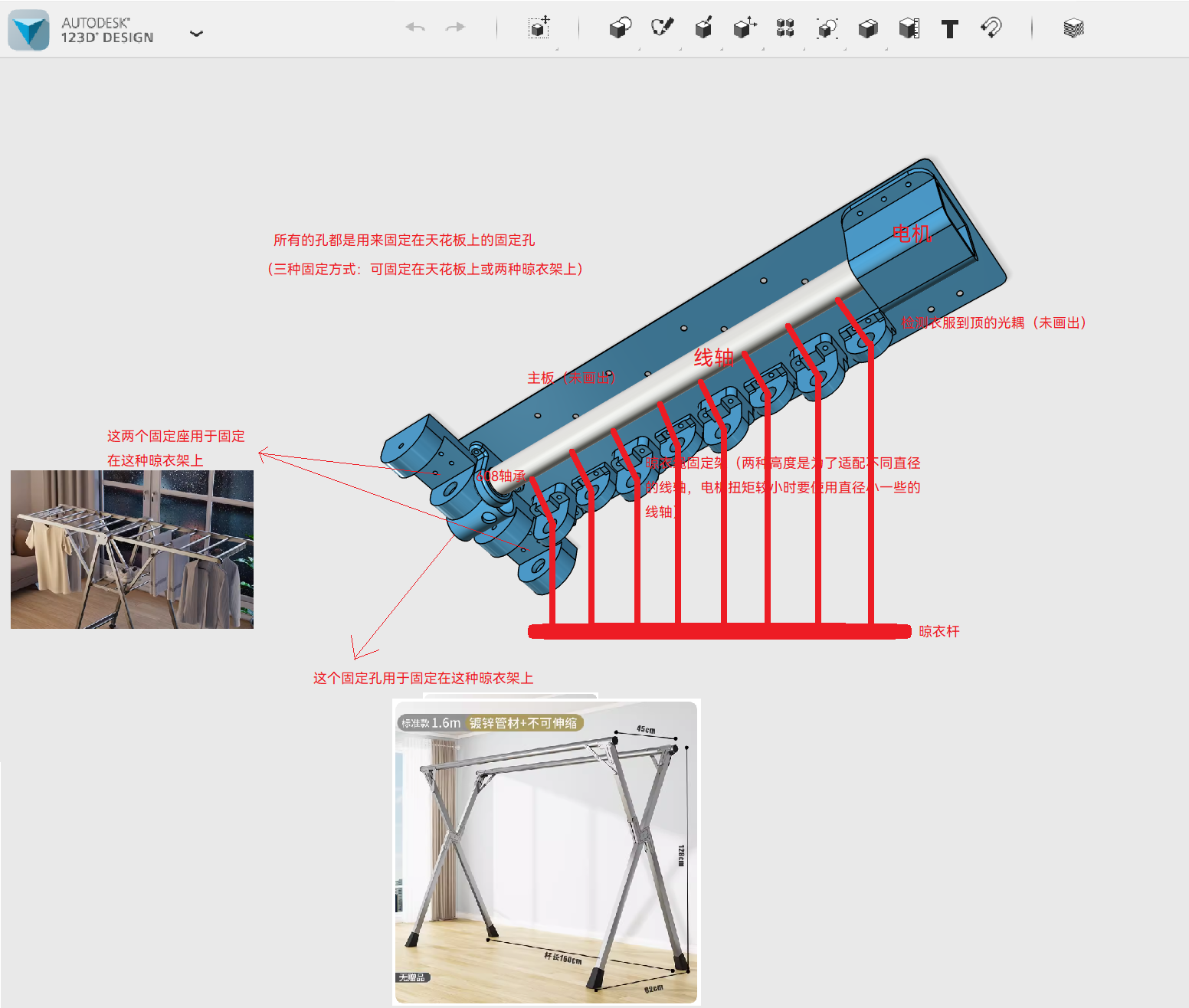

I. Structure (STP attached)
A 540 geared motor (note: with an optocoupler that automatically triggers upon reaching a certain number of revolutions) is used as the power source to drive a 3D-printed spool. The clothesline is raised and lowered via a pull-string method. The expected load capacity is 25kg. Multiple fixing methods are available: it can be fixed to the ceiling via screw holes on the base, to an existing clothesline via round holes on the side, or to an existing folding clothes rack via square slots on the side.

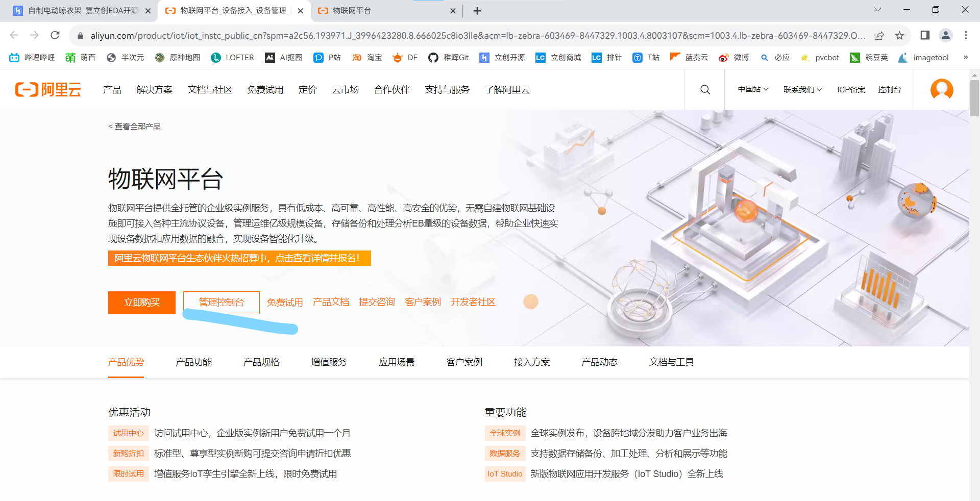

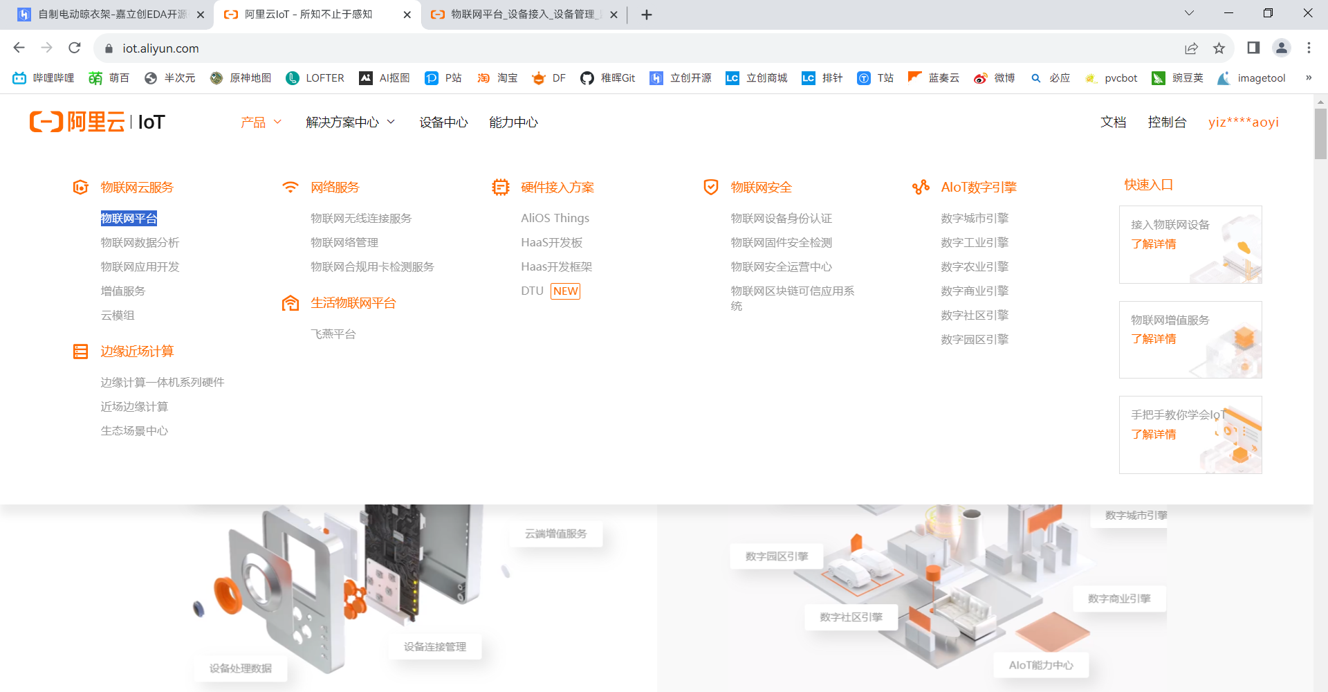

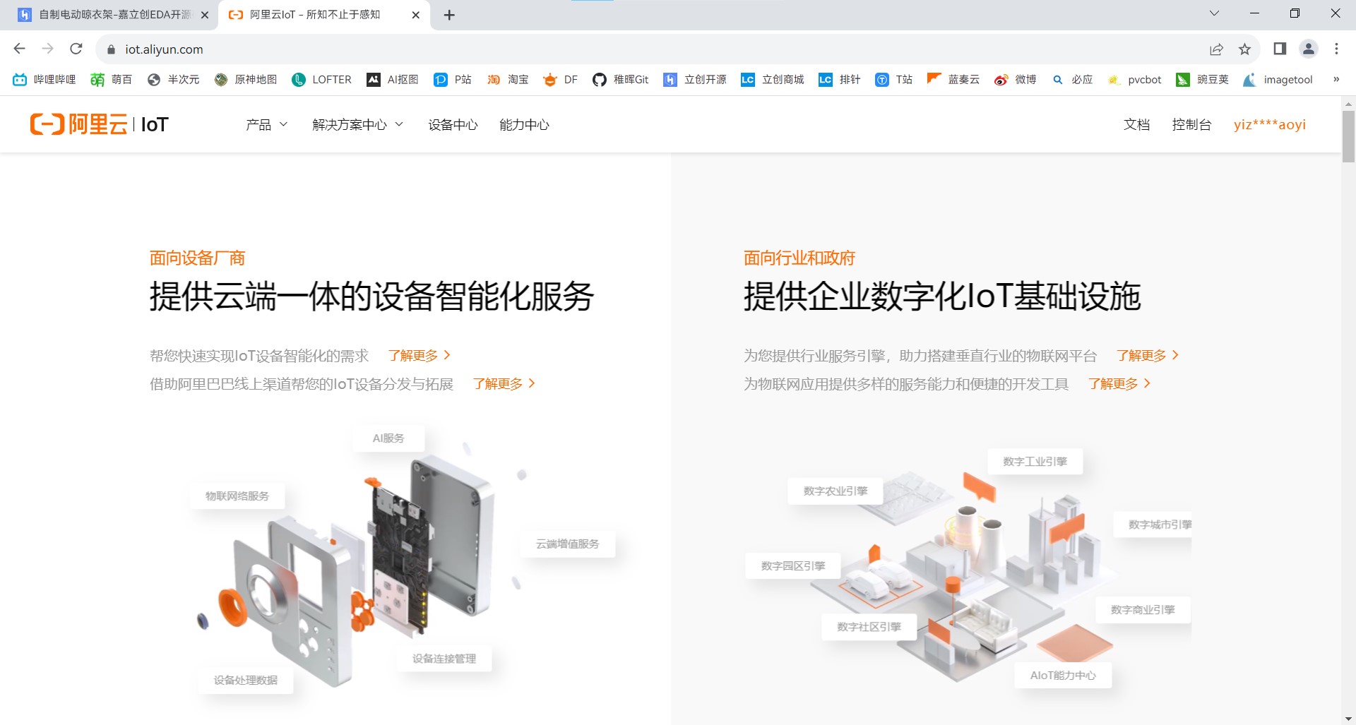

IV. Alibaba Cloud IoT Studio Registration Method
Open your browser, enter the URL https://iot.aliyun.com, enter the Alibaba Cloud IoT interface, and follow the instructions to complete registration and real-name authentication.
Click to enter the IoT platform
, select to activate IoT services, and follow the prompts until the service is successfully activated. Click on the management console to enter the console.

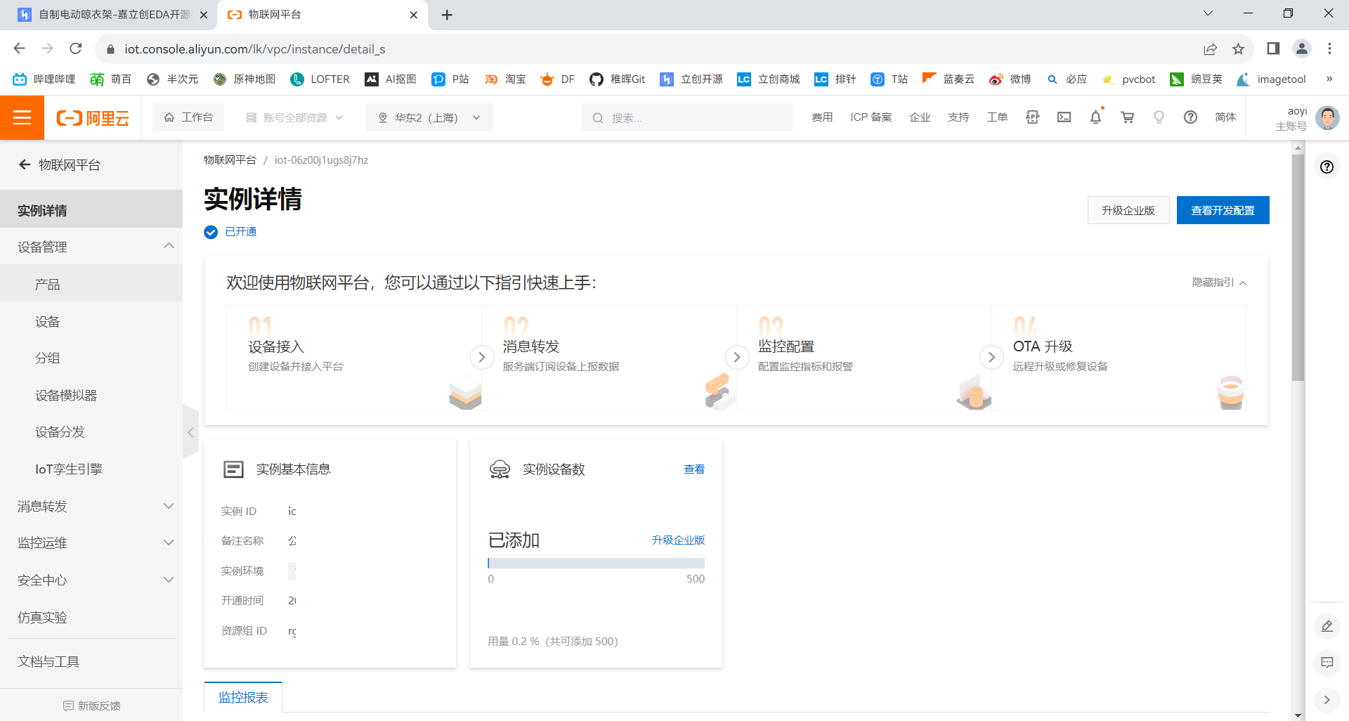

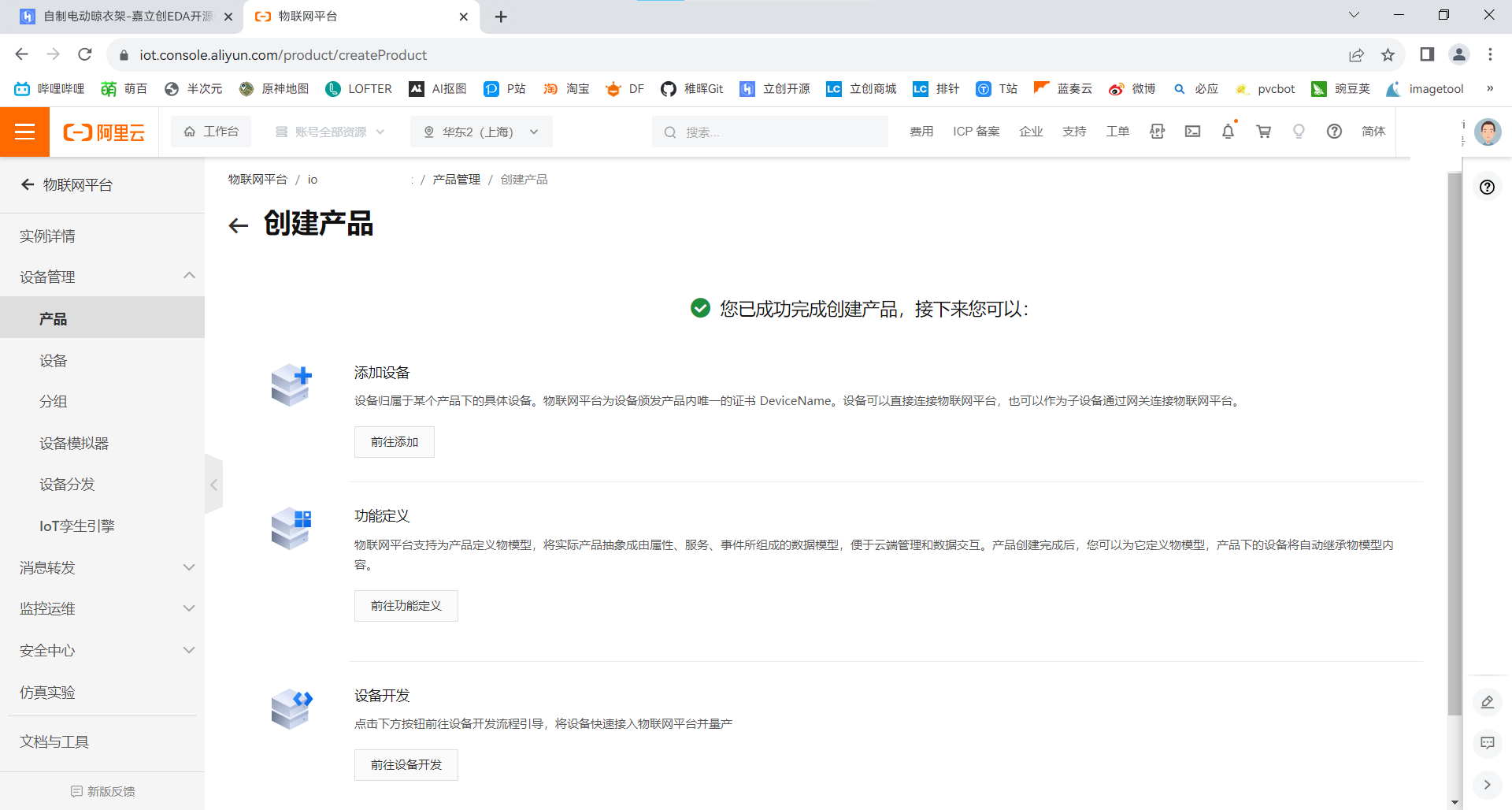

Users can complete the creation of products and devices, as well as the development of corresponding services, in this console. All steps in this tutorial are related to this console.

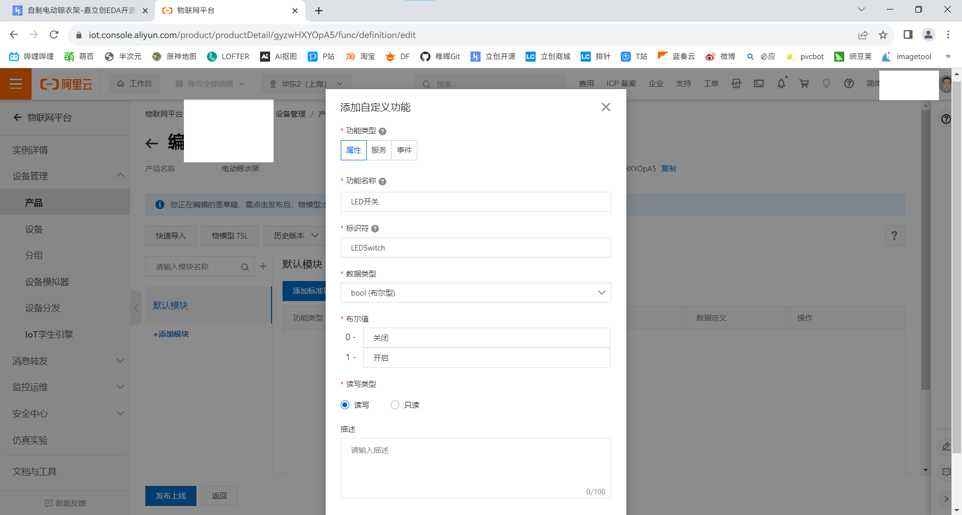

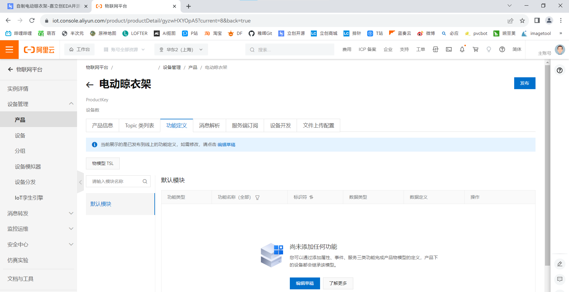

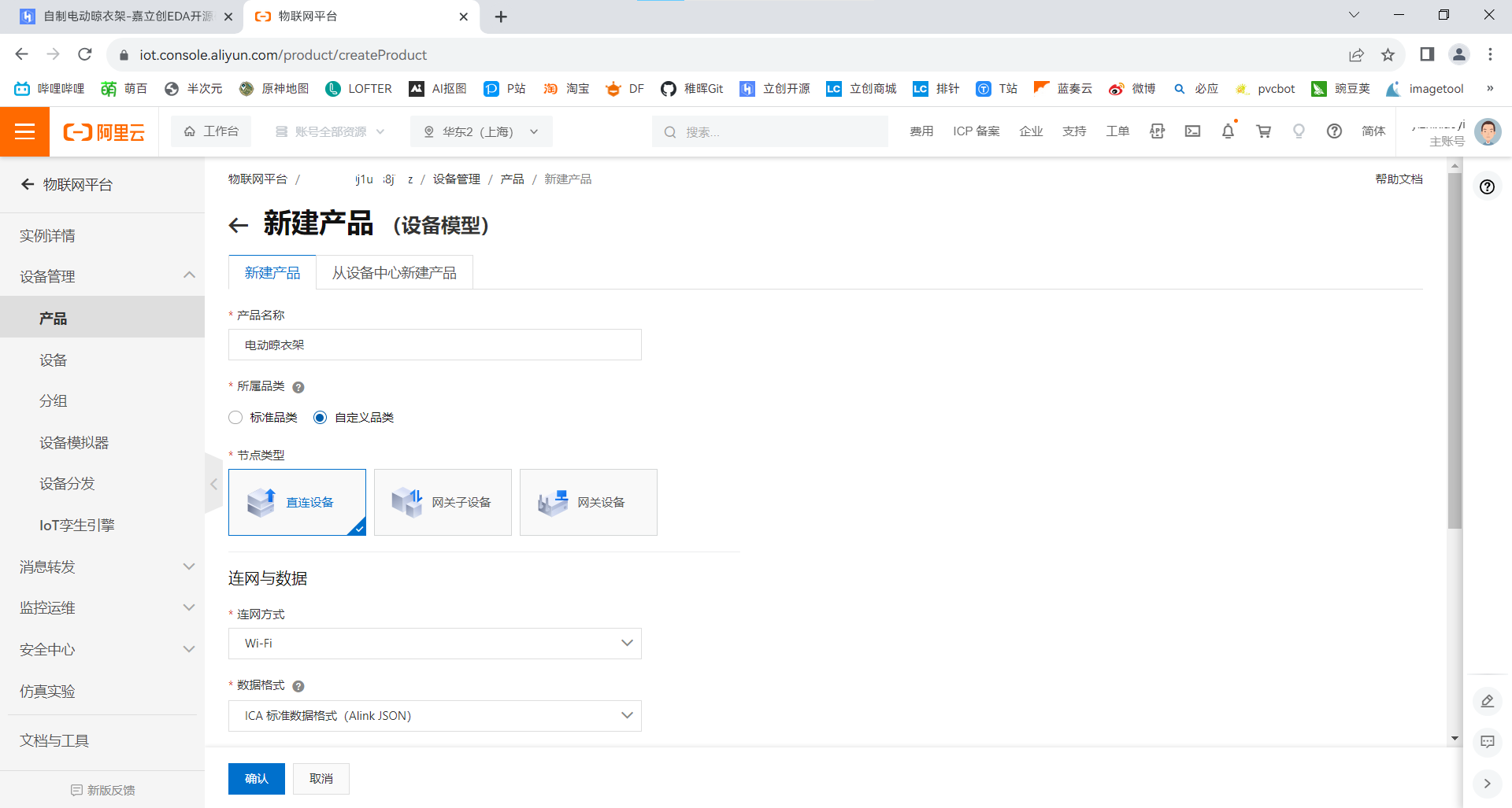

Enter the example (service) you just created, create a new product,

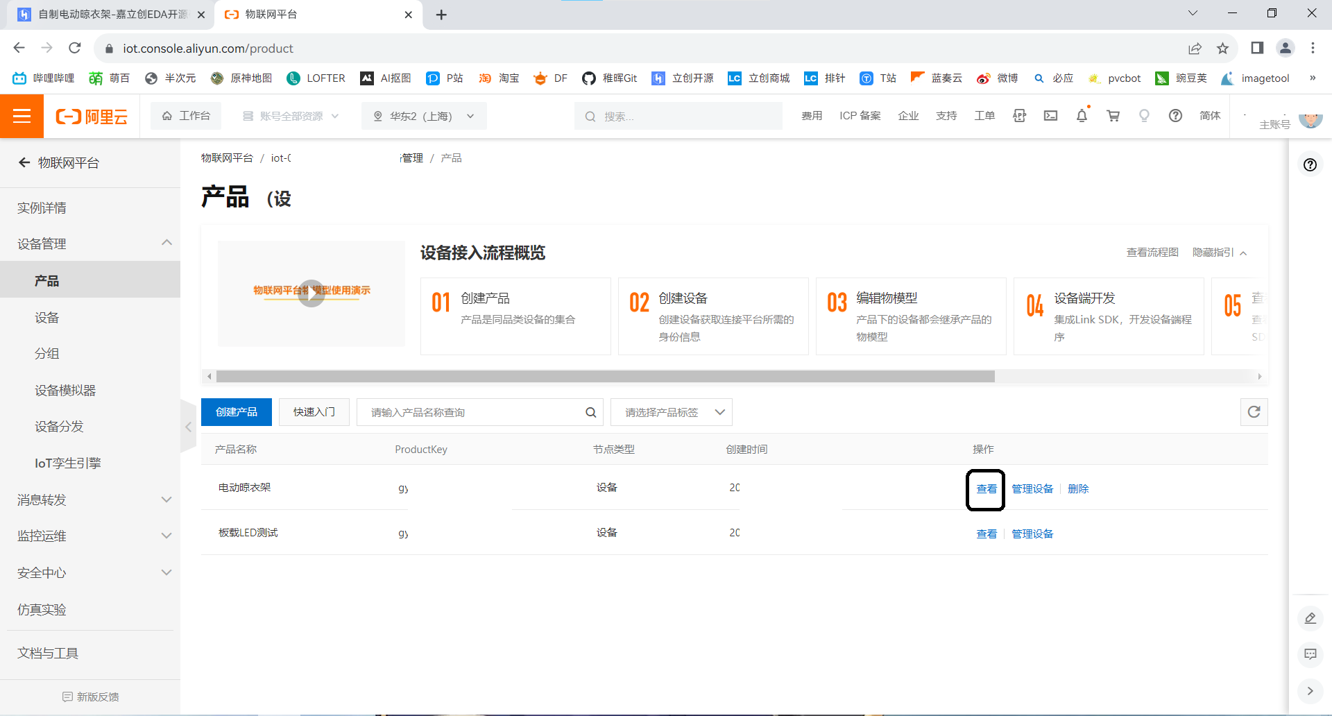

and then click on Product - View
Function Definition.

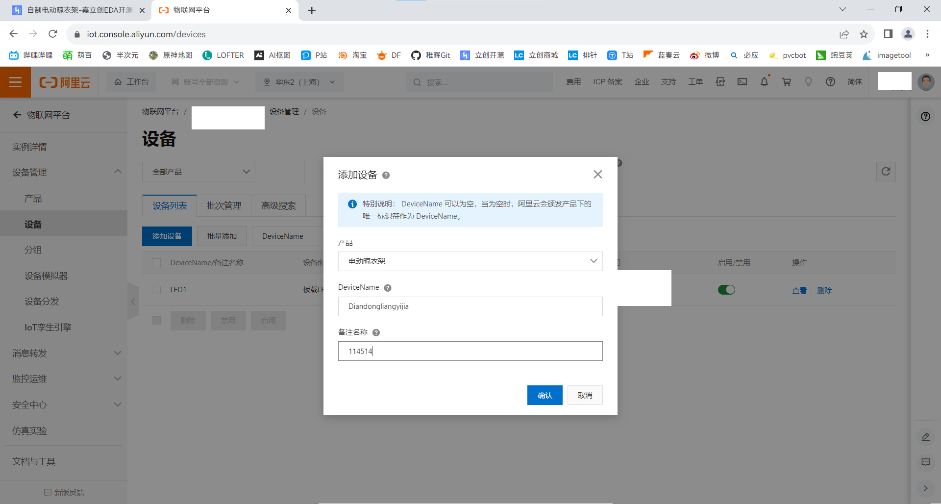

Click on Device on the left - Add Device.

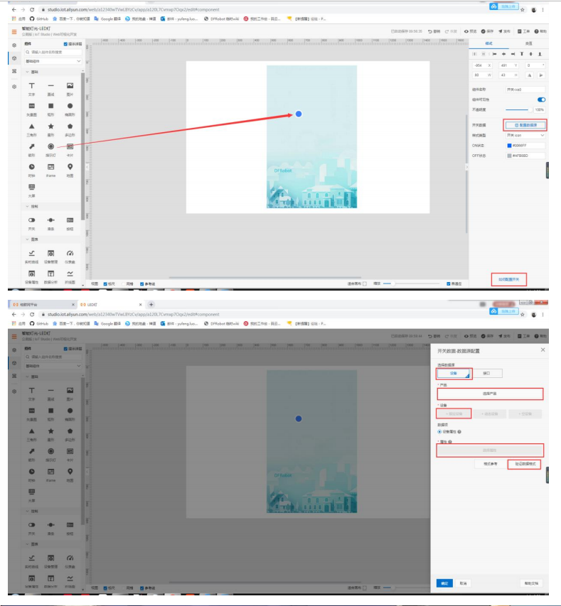

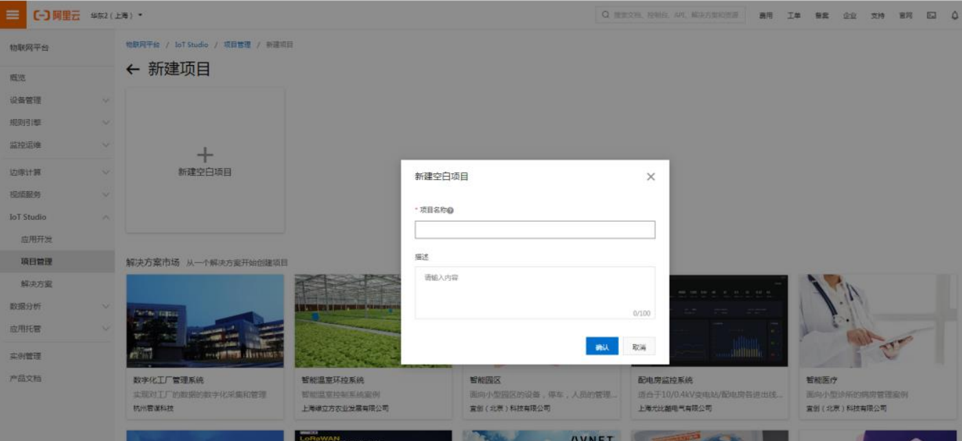

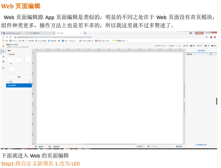

Enter https://studio.iot.aliyun.com/projects, create a new project

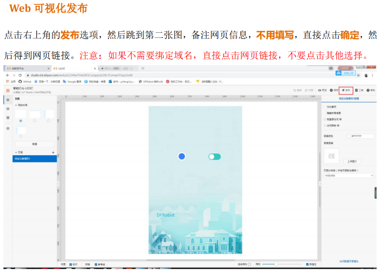

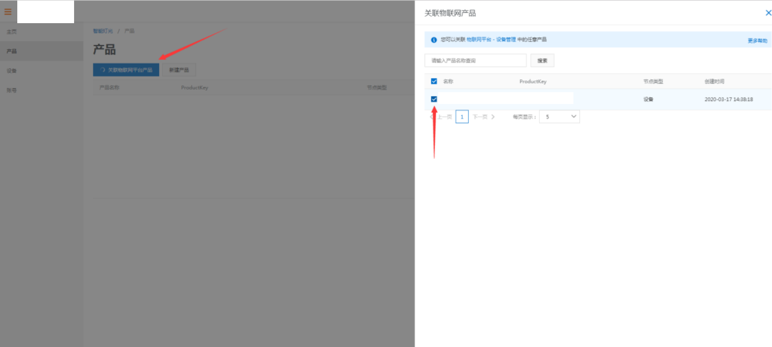

. Find the project you just created in the project list, click it, and enter the project overview page. We can import pre-created products at the bottom of the page (Note: Products already in a project cannot be imported into other projects). Click on a product in the overview page, then click on Associate IoT Platform Products. A dialog box will pop up; select the product to import into the project.

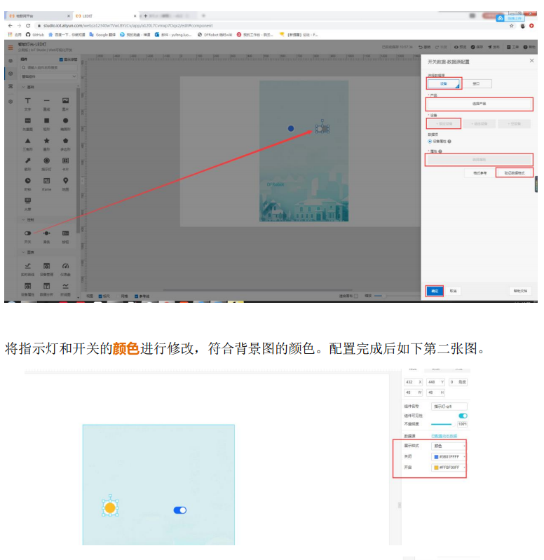

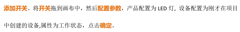

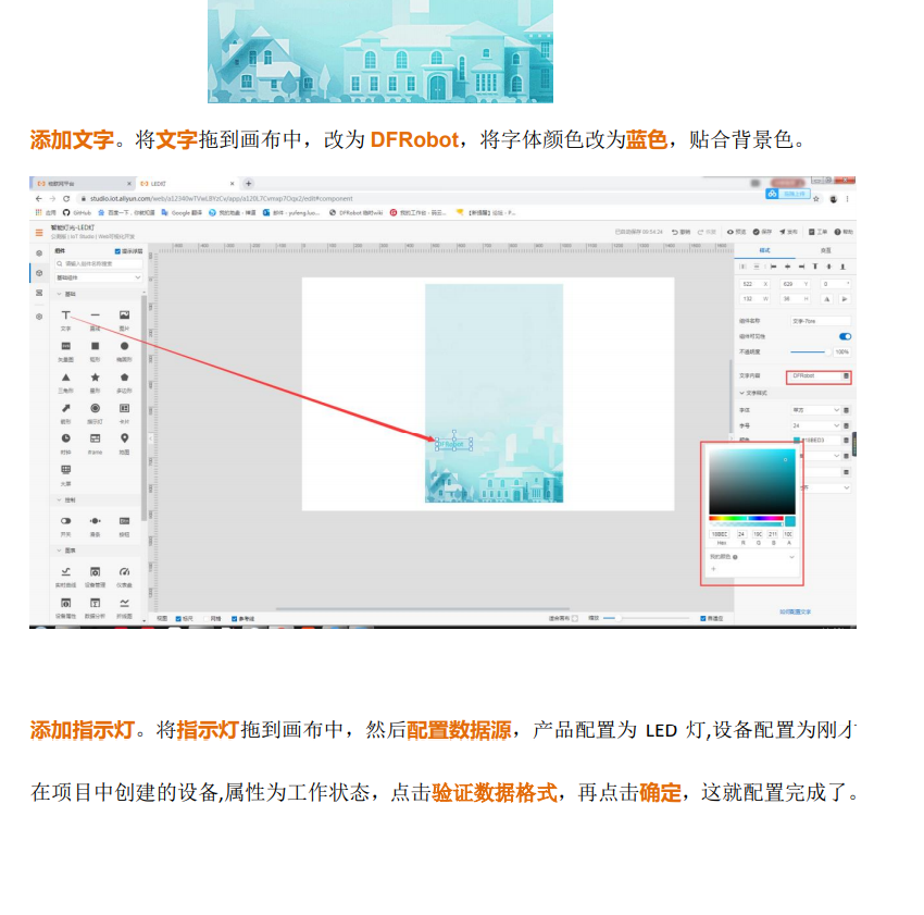

Finally, proceed with web visualization development. Here, I've directly copied someone else's tutorial.

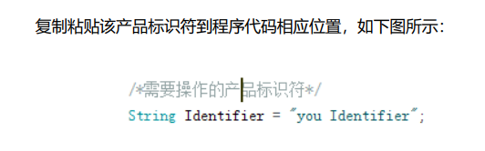

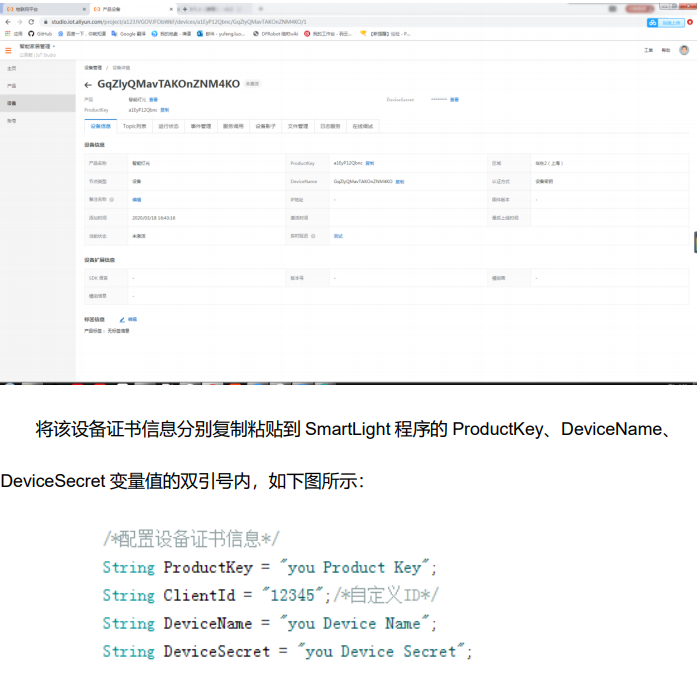

V. Code:

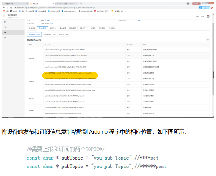

First, install the DFRobot_Aliyun library file in the attachment.
Then open the 191980.ino file in the attachment and modify the following content. Due to privacy concerns, this section uses the official tutorial.
Then upload the program.
