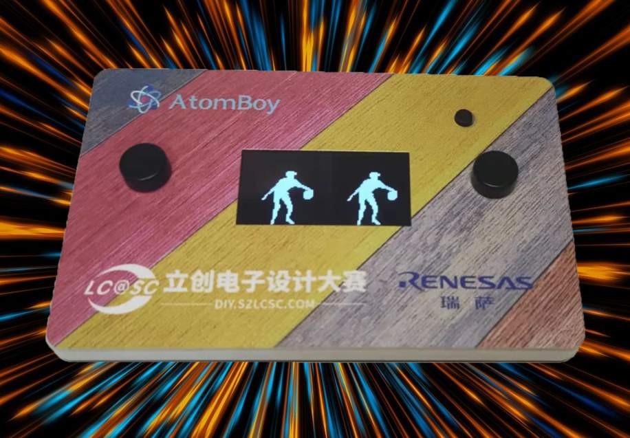

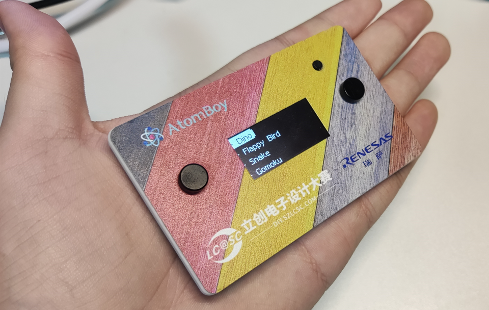

. 1. Project Function Introduction:

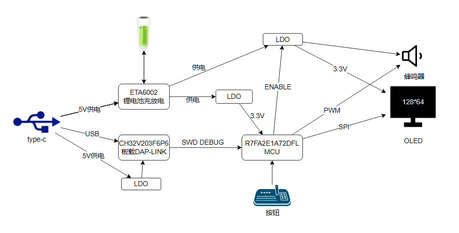

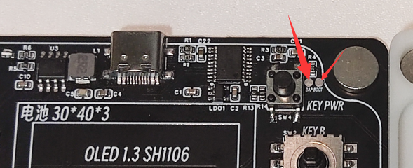

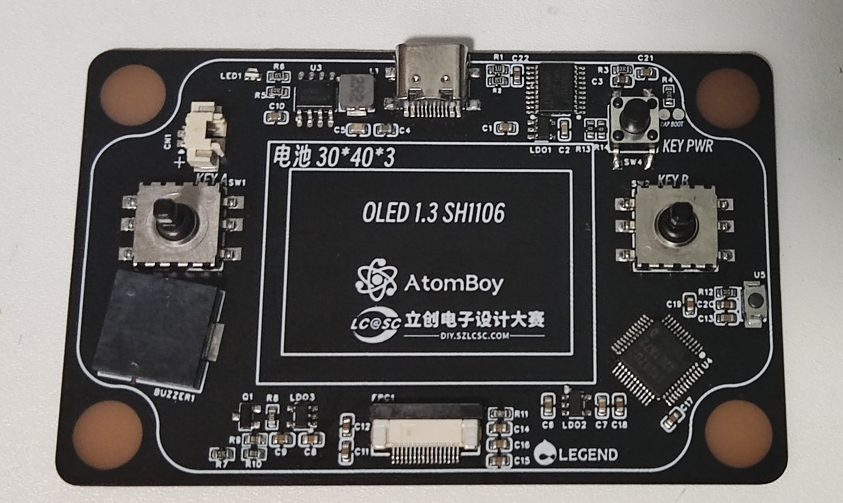

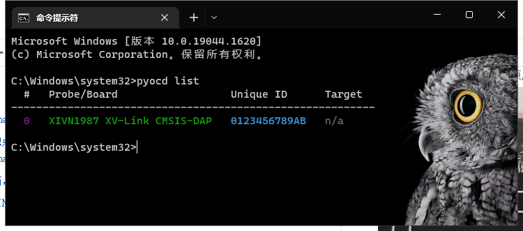

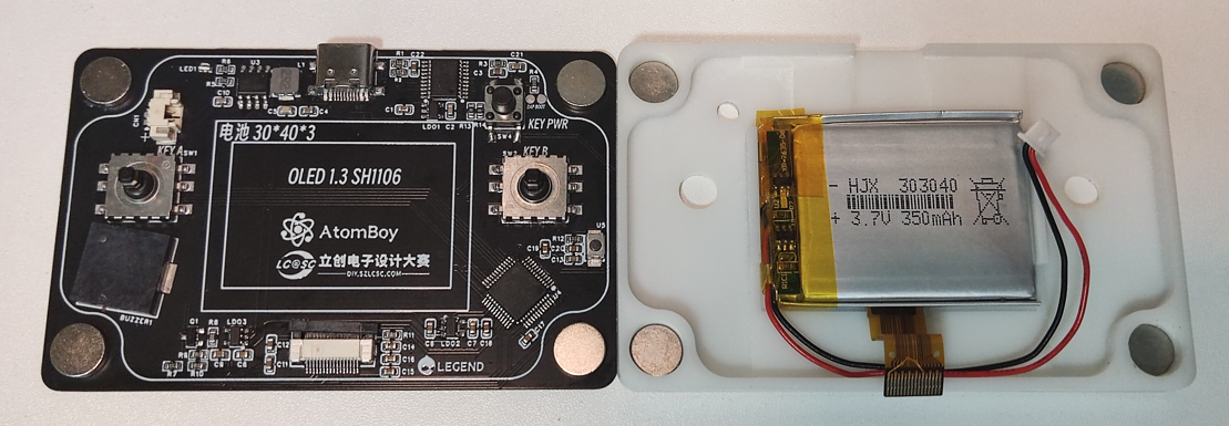

This is a credit card-sized mini game console based on Renesas MCUs, featuring a 128*64 resolution OLED screen, seven built-in mini-games, a rechargeable 350mAh lithium battery, an operating current of approximately 15mA, and a standby current of less than 100μA. It has an onboard DAP-LINK. Built-
in Games:
[x] Dinosaur Game [
x] Flappy Bird [x] Snake
[ x] Gomoku [x] 2048 [x] Space Invaders [x] IKUN Function [x] Long Standby Time [x] Saves Game Progress in Standby [x] Onboard DAP-LINK 2. Project Attributes: First time publicly revealed, original work. 3. Open Source License: The GNU General Public License v3.0 4. Hardware: The hardware is relatively simple. Current from the USB port charges the lithium battery through an ETA6002 microcontroller. The ETA6002 also handles battery discharge, which is divided into two paths: one supplies the MCU (Microcontroller Unit) continuously; the other supplies the OLED and buzzer, with the MCU controlling the corresponding LDO (Logical Design Object) to disconnect their power supply in sleep mode. Additionally, the USB port powers and exchanges data with the onboard DAPLINK, which connects to the RA (Radar Interface) microcontroller via an SWD interface. The OLED connects to the MCU via SPI. The buzzer is controlled by a transistor, with the MCU outputting a 4000Hz PWM signal. | Main Chips | Functions | | --- | --- | | R7FA2E1A72DFL | Main control MCU, M23 core 48M, 16kb+64kb | | SH1106(CH1116) | 1.3-inch OLED screen | | ETA6002 | Lithium battery charging and discharging | | ME6211C33M5G-N | LDO | | CH32V203F6P6 | daplink | Magnets are attached to the four corners of the circuit board and the panel, respectively. The 3D printed interlayer is held in place by magnetic attraction. The magnetic design eliminates the need for screws on the outer shell and makes it easy to disassemble. Currently, the 3D shell cannot be exported; we are waiting for LCSC EDA to fix the bug. This bug is related to the side openings. Deleting the side openings allows exporting, but the USB port opening also disappears. The temporary solution is to manually sand it after receiving the 3D printed shell. It has been redrawn in SolidWorks; see attachment. 5. Software code acquisition: The code is hosted on GitHub: https://github.com/liux-pro/AtomBoy. Additionally, the DAPLINK firmware uses the firmware from @XIVN1987, whose open-source address is https://github.com/XIVN1987/DAPLink. This is the firmware for burning the onboard DAPLINK (this step can be skipped; the firmware in the attachment can be used directly). Download the DAPLINK code and compile the DAPLINK firmware using Mount River Studio. Download and install the WCH microcontroller programming tool . As shown in the image, select CH32 programming. In step six of the image, select CH32V203_DAPLink_aa14c15.hex from the attachment and short the DAP BOOT contact on the PCB. Connect the PCB to the computer via USB cable; the software will automatically burn the DAPLINK firmware. DAPLINK is now ready. Renesas RASC was used to generate project files based on CMake, which need to be compiled using ARM GCC. If you want to compile on your own computer, first install CMake and Ninja, then download ARM GCC and execute the following compilation command. Assuming the gcc toolchain is extracted to the root directory of drive D. ` cmake -B build -G Ninja -DCMAKE_FIND_ROOT_PATH=D:/gcc-arm-none-eabi-10.3-2021.10-win32/gcc-arm-none-eabi-10.3-2021.10/bin cmake --build build` For flashing the AtomBoy , since it has an onboard DAP-LINK, an external flashing device is not needed. Python 3 is pre-installed, and pyocd is installed via pip. After `pip install pyocd` , connect the USB to the computer and flash the program directly through the onboard DAP-LINK. `cmake --build build --target` For the flash emulator , to facilitate debugging and avoid re-flashing after each modification, an additional emulator was written so that most of the code can run on the computer. Install the msys2 environment (optional). Use msys2-mingw64 to execute `sed -i "s#mirror.msys2.org/#mirrors.ustc.edu.cn/msys2/#g" /etc/pacman.d/mirrorlist*`. Switch to a domestic mirror. Use msys2-mingw64 to execute `pacman -S mingw-w64-x86_64-SDL2` to install SDL2. Use msys2-mingw64 to execute `pacman -S mingw-w64-x86_64-toolchain`. `cmake make ninja git` to install the compiler, etc. `cd emulator && cmake -G Ninja -B build` `cd build && ninja ./AtomBoyEmulator.exe`. Use CLion . Using CLion can speed up development efficiency and avoid manually typing commands. If it's not clear, watch the video. The video demonstrates how to compile, flash, and use the emulator. https://www.bilibili.com/video/BV1Nx4y1X7iN/ Code Structure Directory ├─.github

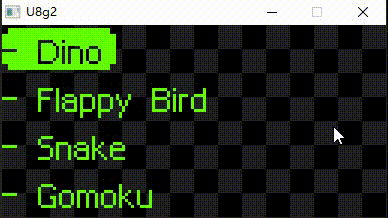

├─emulator # SDL-based simulator

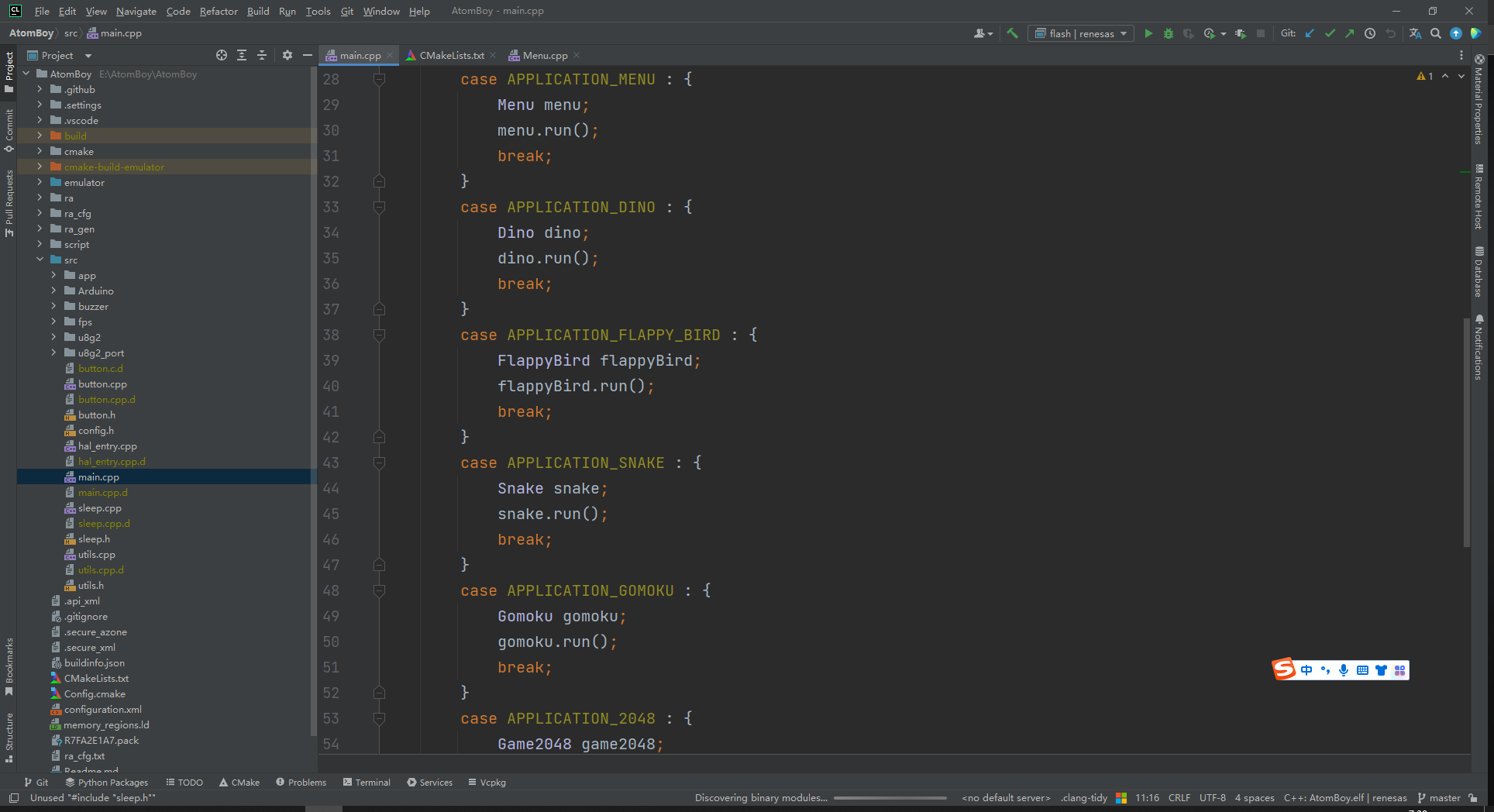

uses a timer to generate a 1ms clock source, updating the flag bit approximately every 16ms. The main loop polls the flag bit and refreshes the frame, ensuring a stable frame rate when sufficient computing power is available.
The OLED screen is driven using U8G2, and the porting uses hardware SPI.
Each button is directly connected to a GPIO, with internal pull-up enabled. The button state is updated with the screen refresh; a low-level transition of the GPIO indicates a button press. There is no debouncing. In the game, a scan function is called every frame to update the button state.
Each game (including the main menu) is considered an app. The main loop determines which app to enter based on the variable `nextApplication`, defaulting to the main menu.
Each app implements the `run` abstract method, internally using u8g2 to manipulate the screen and implement game logic. After the `run` method returns, it re-enters the main loop.
In the menu app, after selecting an item, `nextApplication` is modified and then returned; the next loop enters the selected game based on the modified `nextApplication`.

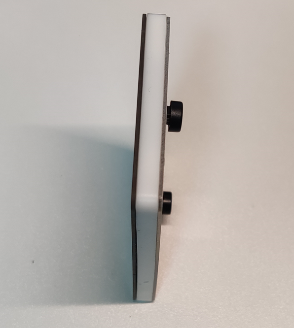

OLED driver https://github.com/olikraus/u8g2 DAPLink firmware https://github.com/XIVN1987/DAPLink Gomoku AI algorithm https://gitlab.com/nowozin/maxigoarduboy ikun animation compression algorithm https://www.quicklz.com/ (Official website is inaccessible) Dinosaur game assets https://github.com/chromium/chromium Renesas SDK https://github.com/renesas/fsp 10. Optimizable parts
The components were rearranged to eliminate components within 1mm of the battery, reducing assembly difficulty.
The USB port is now located on the left or right side, instead of the top or bottom long edges. The existing Type-C port area is too thin and lacks strength. A small iron rod could be embedded for reinforcement.
The adhesive used for the panel magnets has been replaced with AB glue, as the included 3M adhesive is insufficient for strong magnets.
The joystick is too small, making directional control difficult.
The battery level and charging status are not displayed.
