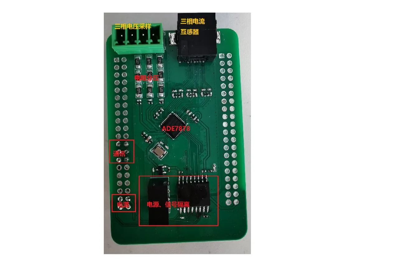

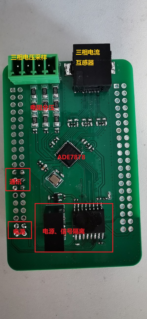

This is a three-phase power calculation expansion board based on the SkyStar development board. It uses the ADE7878 chip with isolation design to prevent strong current interference.
Voltage sampling uses resistor dividers to reduce cost while ensuring the safety of subsequent circuits through isolation.

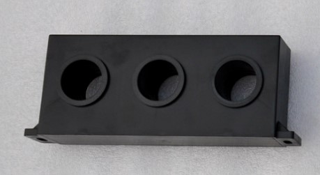

Current sampling uses an integrated three-phase current transformer with a telephone port interface.
Connection to the development board is only required via SPI and power supply.

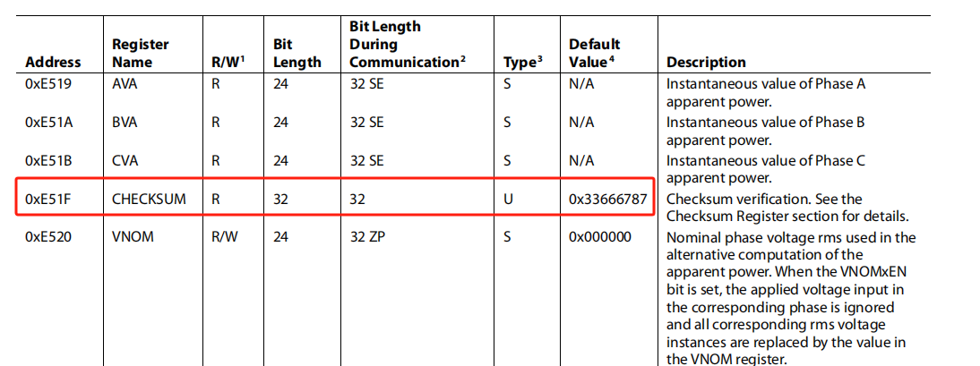

However, there is a CHECKSUM register, which, by default, has a specific value.
According to the datasheet, this register's value on the ADE7878 chip is 0x33666787.

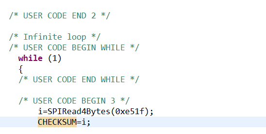

This is a 4-byte register, read using the SPIRead4Bytes function.
uint32_t SPIRead4Bytes(uint16_t address)
    union{uint8_t bit[2];uint16_t all;}tempd16;//bit[0] is the low bit
    union{uint8_t bit[4];uint32_t all;}tempd32;//bit[0] is the low bit
    tempd16.all=address;
    ADE7878_CS_L();
    SPI2_ReadWritebit(0x01);
    SPI2_ReadWritebit(tempd16.bit[1]);//high bit
    SPI2_ReadWritebit(tempd16.bit[0]);
    tempd32.bit[3]=SPI2_ReadWritebit(0x00);//high bit
    tempd32.bit[2]=SPI2_ReadWritebit(0x00);//
    tempd32.bit[1] = SPI2_ReadWritebit(0x00); //
    tempd32.bit[0] = SPI2_ReadWritebit(0x00); //
    ADE7878_CS_H();
    return tempd32.all;
Function call:
Reading results during simulation debugging:
