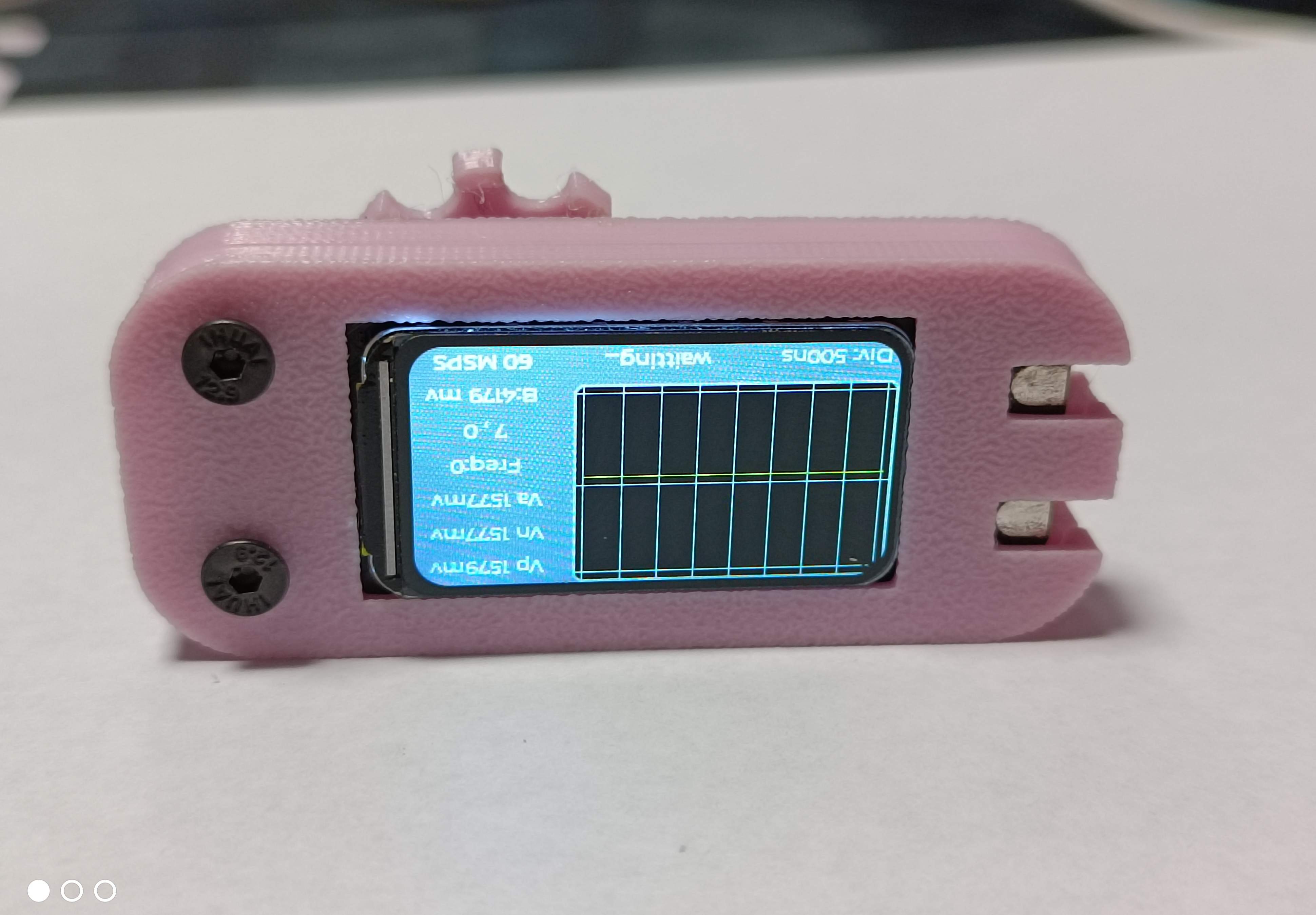

0x00: Preface
The first version was cheated by the official library. The encoder was packaged incorrectly and needed to be solved by flying the wires. After flying the wires, it felt unstable.
The battery capacity is 60mah, the specific dimensions are as follows
Case suitable for battery version
Screen parameters
1.47-inch st7789 ips resolution 172*320, the actual driver is modified to 174*322

0x02:Hardware
Main control MCU:
  • Raspberry Pi RP2040
  • Core voltage 1.2V
  • System frequency 266Mhz
ADC:
  • AD9235BCPZ-65 (Since the 65M version SMT is out of stock, AD9235BCPZ-45 is actually used)
  • Input signal range 0V - 3.45V
Screen:
  • 1.47 inch IPS TFT
  • Resolution 172*320
  • The screen is hot for unknown reasons, it may be a batch problem
storage:
  • 128Mb SPI Flash
  • Used to store firmware
  • Can store waveform files

0x04: Shell
The picture shows pink PETG printing, the material has slightly more defects due to moisture.
The knob shell used a weird method and was drawn with LCEDA.

After testing, at 266Mhz @ 1.3V, with the backlight at maximum brightness, the voltage was insufficient after about 20 minutes and it started to restart repeatedly.
Charging takes 10 minutes. There is currently a bug in the charging IC. After it is fully charged, it will constantly switch between charging and standby.
0x09:Temperature
When powered externally, the overall temperature of the screen is relatively high, and the driver chip is hot to the touch with a temperature of nearly 50 degrees.
No obvious hot spots have been found for battery power supply.
0x0A: Weight
The main body is 18g, emmm, it’s too light. The next version can add a bridge function and increase the battery capacity.
0x0B: Reminder
It is recommended that the signal source be grounded, otherwise the measurement will be inaccurate.
