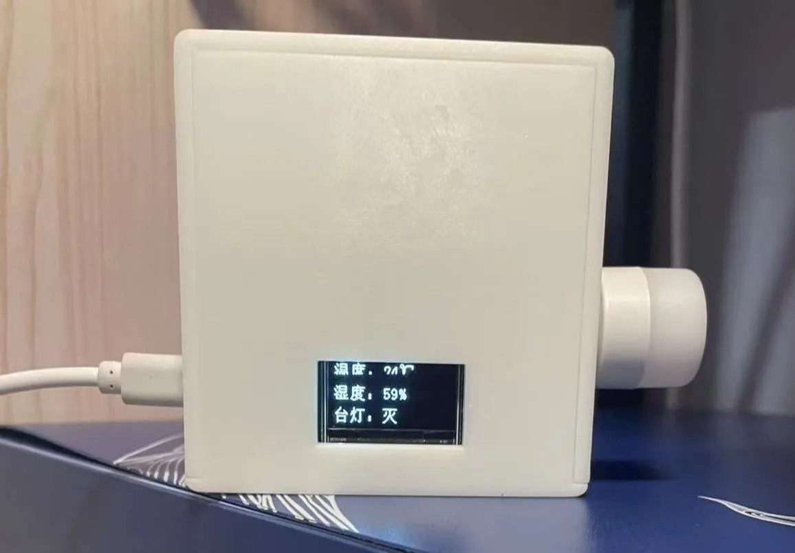

I originally planned to do more, but the recent project proposal took too long, affecting my schedule.
This project uses the Dikuoxing development board, controlling the night light via a relay. A three-pin 2.54" connector is used to connect to an external DHT11 temperature and humidity sensor module, and a six-pin connector is used to connect to an external ESP8266 (powered at 5V here; this module supports 3.3-5V).
The back also includes external pins for a photosensitive sensor, a thermal sensor, a buzzer, Bluetooth, a servo motor, and an XY joystick for future study and research.
If this project is open-sourced, I will upload a video of the process to blbl. Welcome to exchange ideas and learn together.
