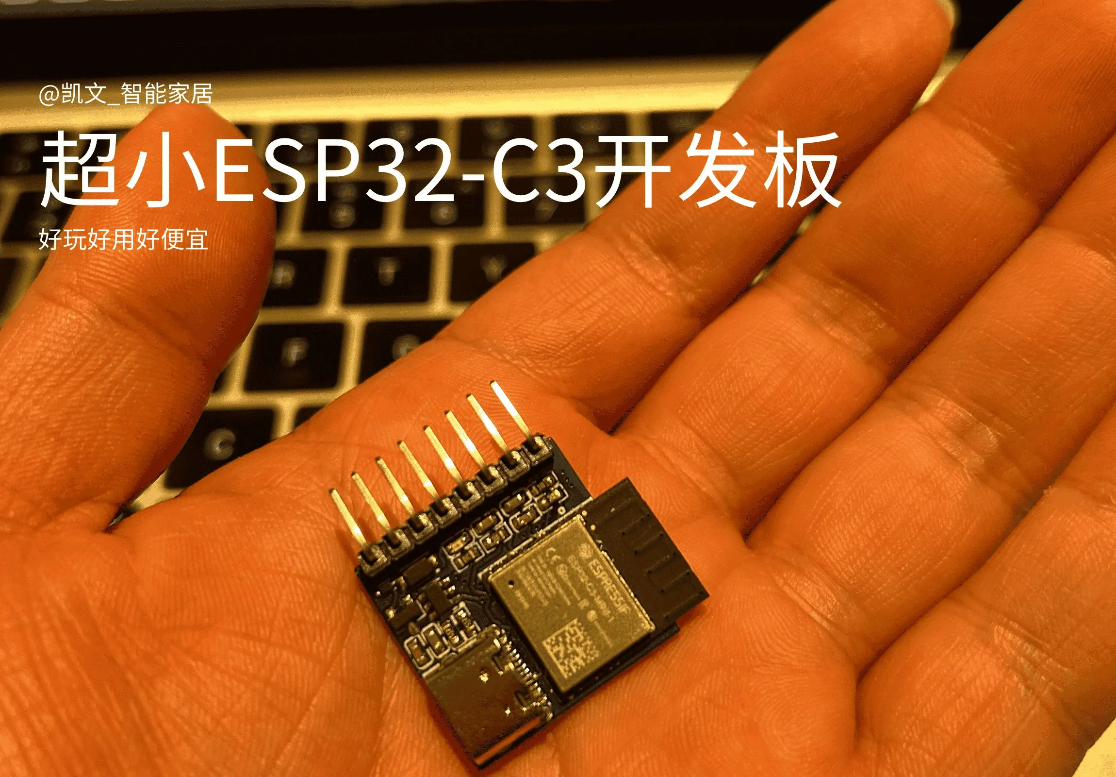

. The previous project I shared was a metering socket based on ESPhome (ESP8266). Recently, I modified an ESP32C3 to accept the Matter protocol, and also redesigned the original through-hole board (because I'm bad at soldering). I changed it to a 2.54mm pin header, which can accept both standard pin headers and bent pins, allowing the chip to stand upright!
Programming: Direct USB-C connection. The advantage is simple soldering; the disadvantage is that it can only program, not debug.
LED indicator: There is a 3.3V LED that lights up when powered on.
Pin header: 3.3V, 5V, GND, and 5 GPIOs are brought out. TXD and RXD are not brought out here; you can modify them if needed. Purpose:
I think this is quite beginner-friendly, allowing you to understand the basic routing design of ESP32C3. It also uses 0603 package resistors and capacitors, which are easy to solder. The only two difficult parts for beginners are soldering the Type-C and C3 connectors, but this is a necessary step, so just keep playing around with it.
PS1 There are some small ESD and surge protectors next to the USB port. I haven't investigated the specific principles, but everyone seems to have them (including those on LCSC's C3 development board).
PS2 My previous designs were largely based on LCSC's designs. This development board was designed according to my own needs. If you find it helpful, please give it a thumbs up! Here's a picture
of the finished product
alongside the official LCSC development board (left: ESP32C3, right: ESP32C2, top: my ESP32C3)
and a picture of my hand.
