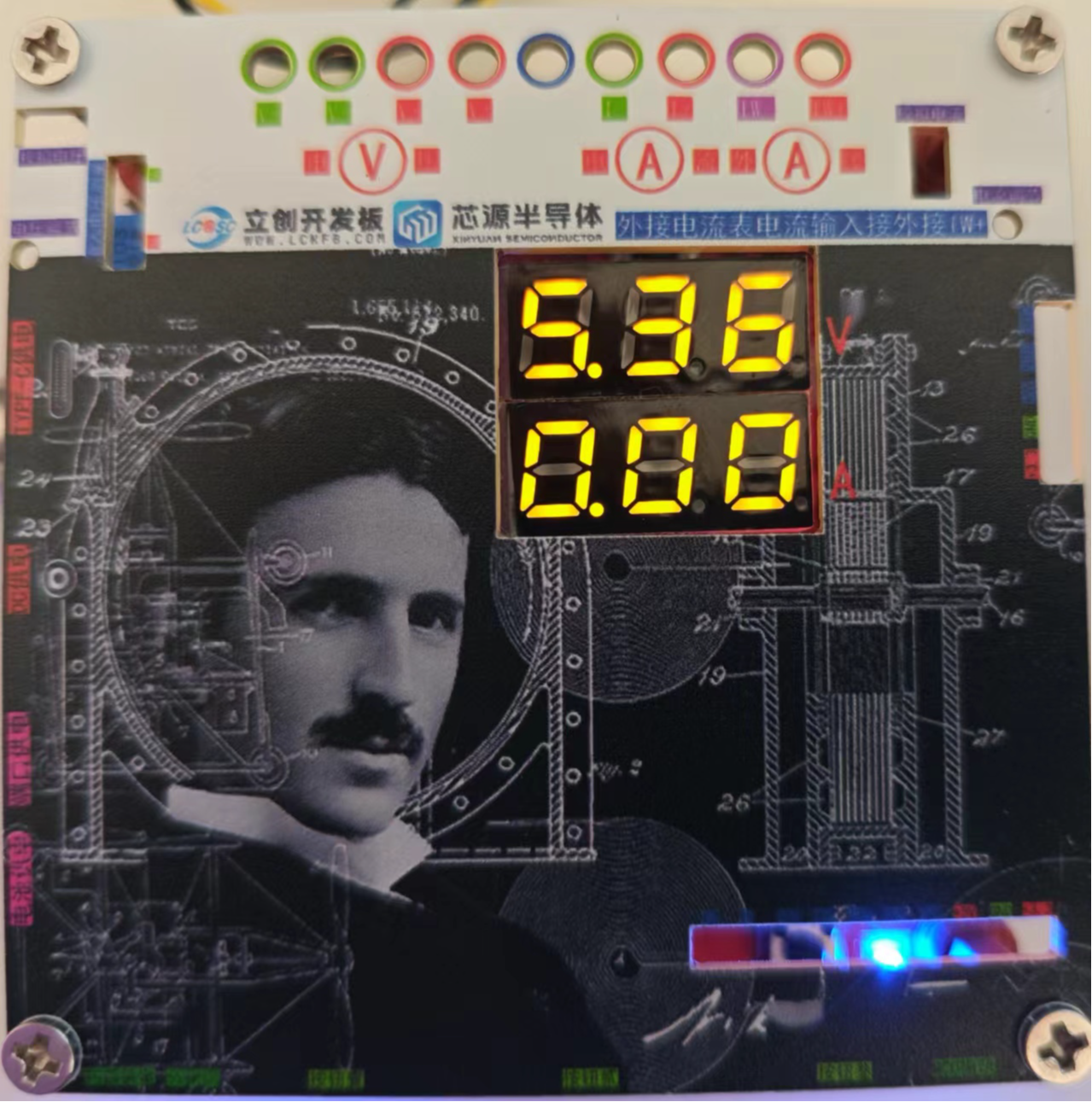

VI. Assembly Instructions:
The PCB component board and decorative cover are connected using M3 screws and M3-22MM hexagonal studs.
VII. Function Introduction:
This project can be powered by DC input and TYPE-C input, and an external power supply is also available with a reserved BAT interface.
When the input voltage measurement jumper is in the ON position, the supply voltage can be measured.
When the input voltage measurement jumper is in the OFF position and the analog voltage jumper is shorted, the variable analog voltage can be measured by adjusting the analog voltage potentiometer.
Shorting the analog current also allows for the measurement of variable current output using the analog current potentiometer.
