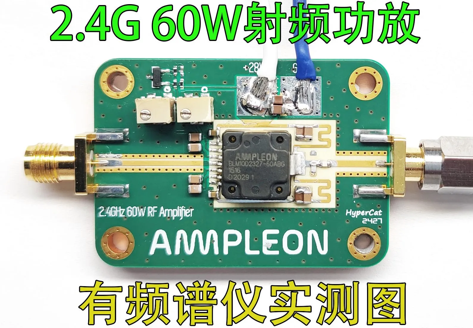

I accidentally discovered a neat-looking power amplifier tube, model BLM10D2327-60ABG. Its small size, high power, and attractive appearance appealed to me. So I made a board to play around with it.

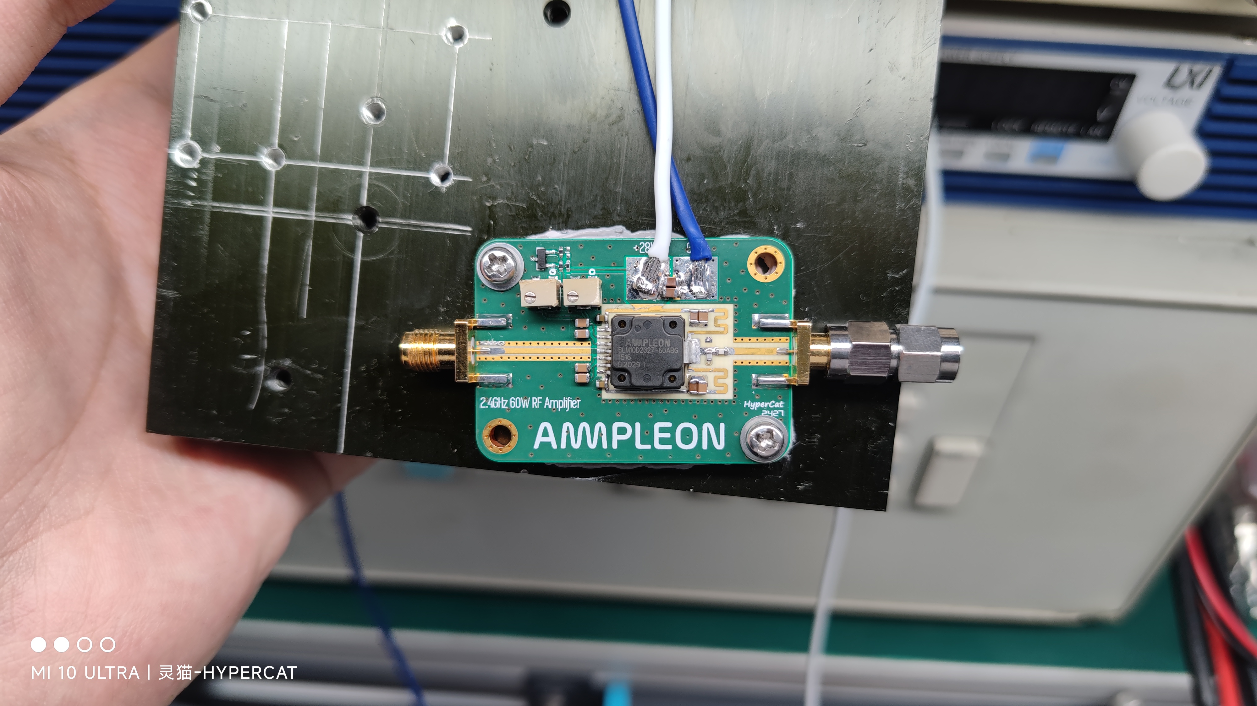

Due to the significant heat generated by the RF power amplifier, a good heat dissipation design is necessary; otherwise, it will overheat and burn out. This transistor has no mounting lugs, so it needs to be soldered to a heatsink, which also serves as grounding and heat dissipation material.
The manual also recommends soldering directly to the heatsink material.
Therefore, we need to design a heatsink base for soldering, so the material must be copper, not aluminum.

Due to the high frequency and power, the microstrip matching is designed based on the dielectric constant of the 4350. Therefore, the PCB must be made of Rogers RO4350B 0.508 board material, not FR4, otherwise there will be mismatch, severe overheating, power reduction, and in severe cases, chip burnout.
The heatsink must be made of copper, machined by CNC. Copper has good heat dissipation and is also necessary for soldering.

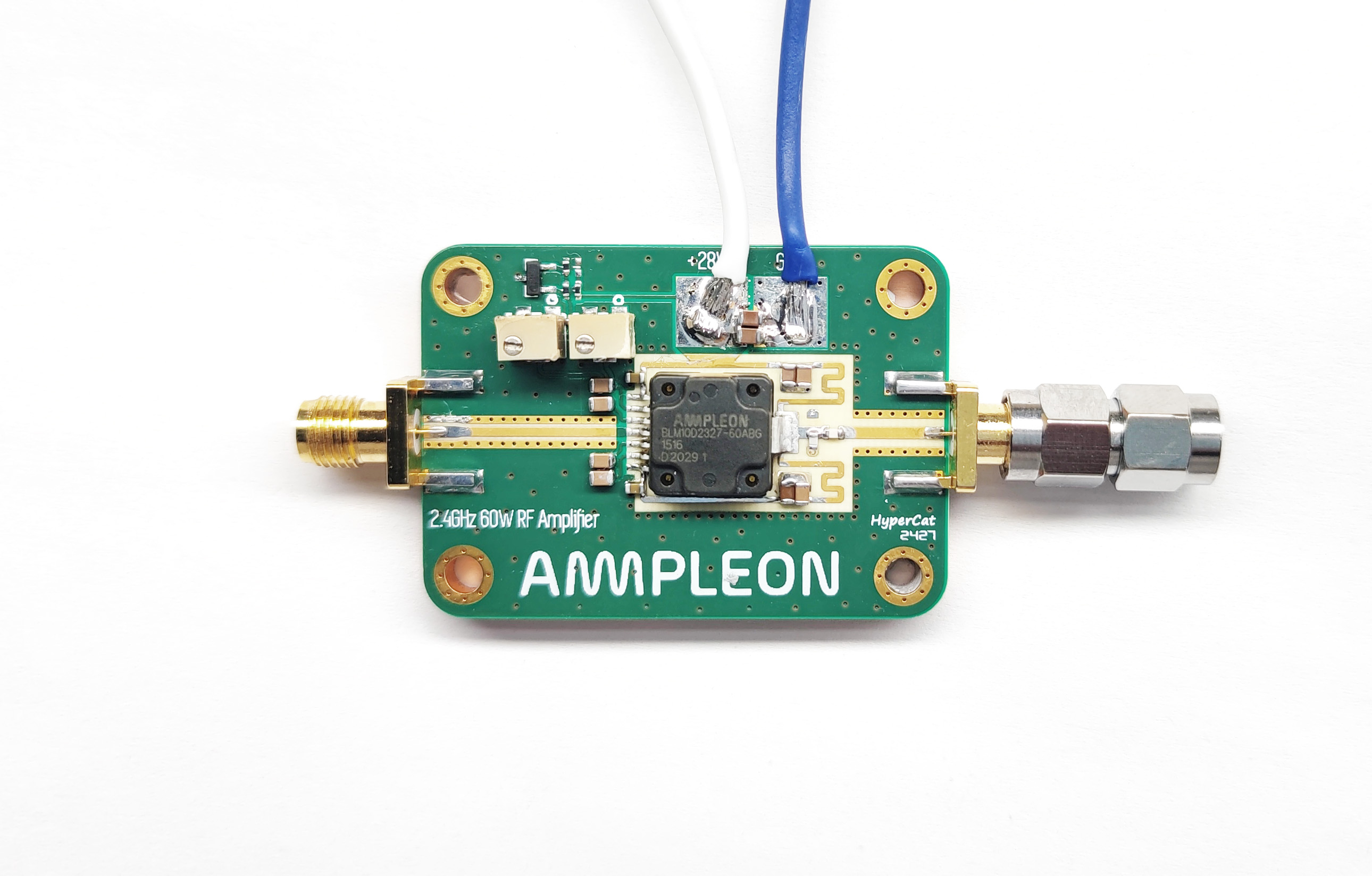

1. Finished product image after soldering:

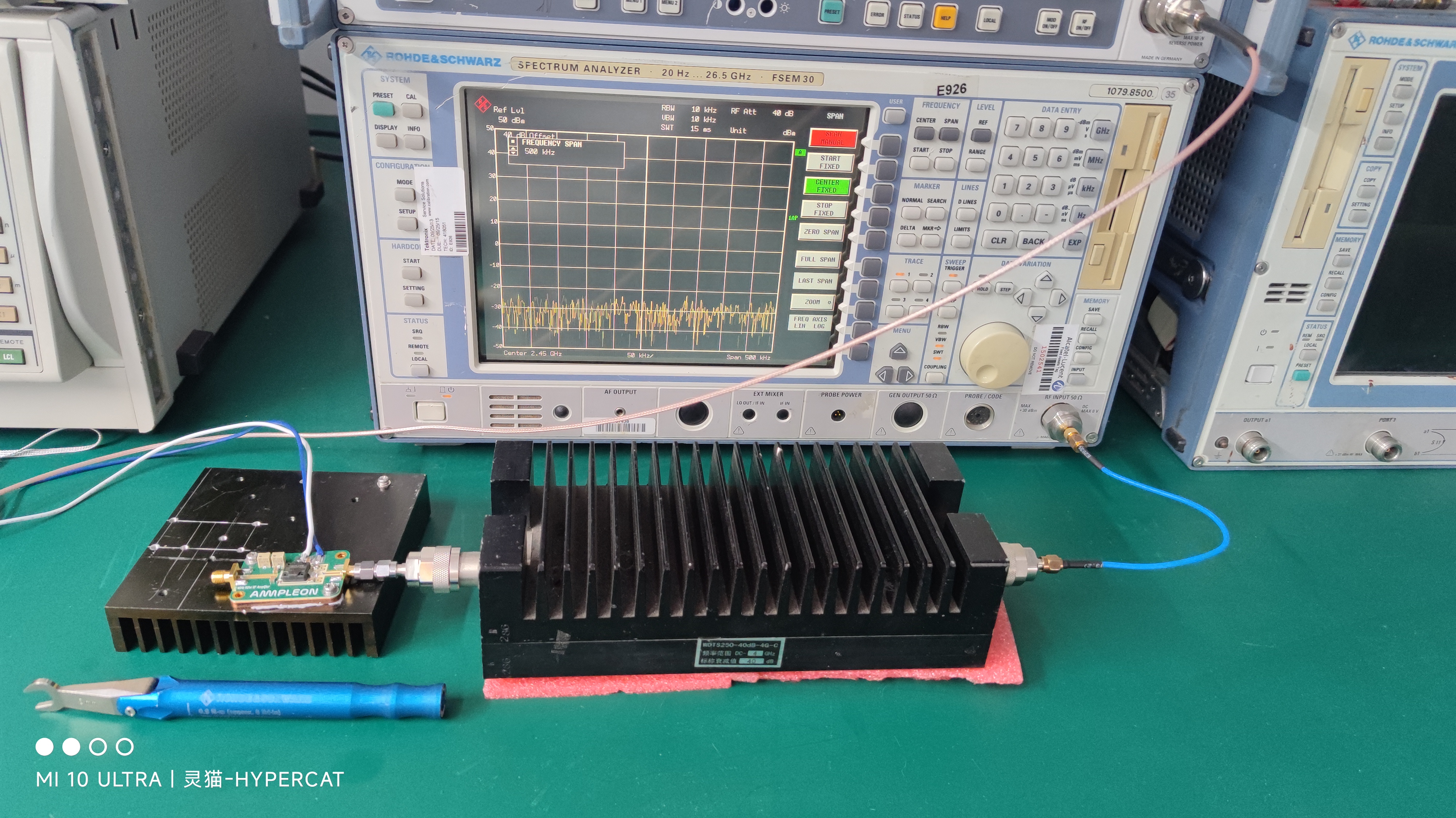

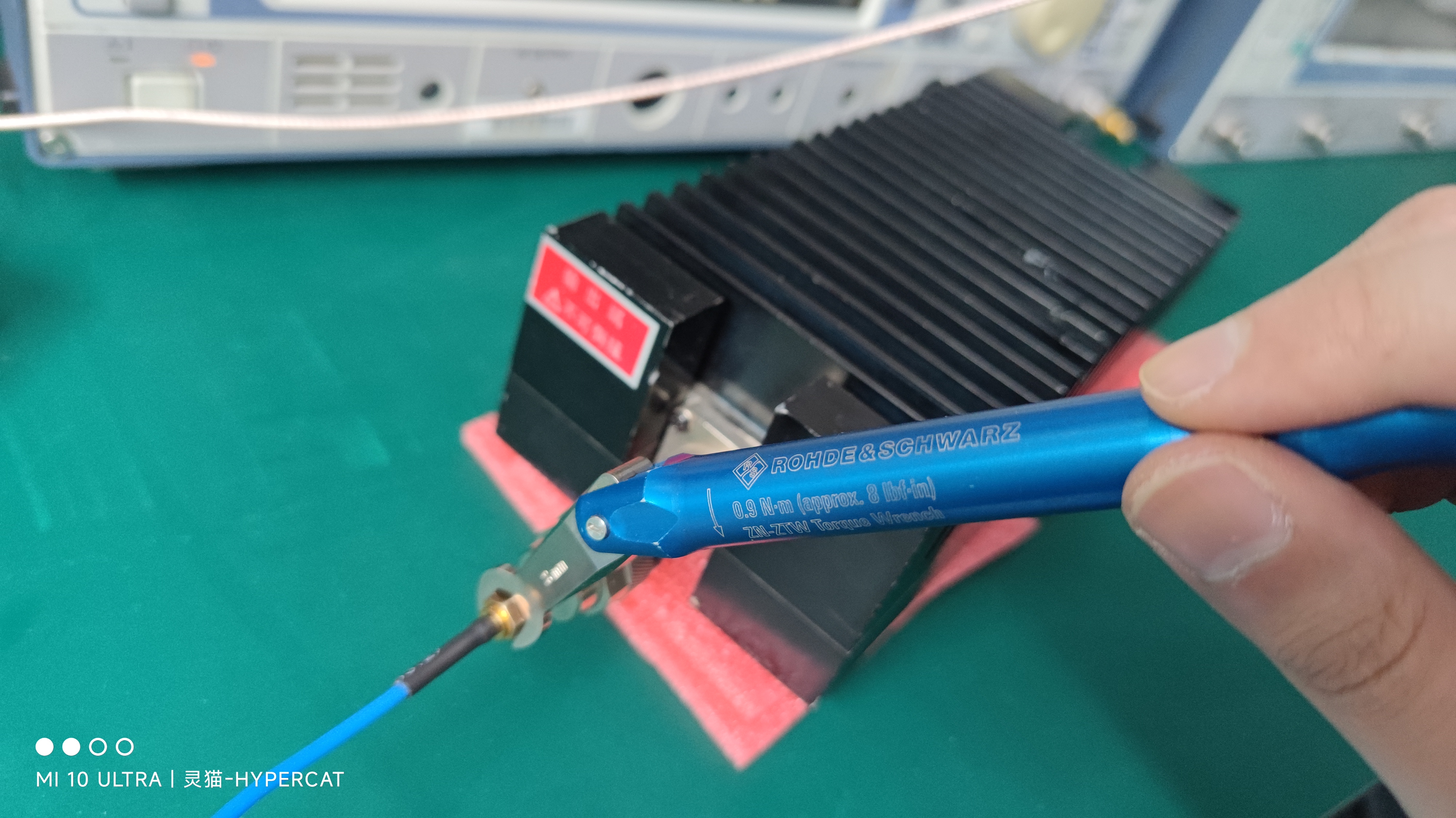

2. Assembling the heatsink and connecting the instruments:
Here, a torque wrench is needed to properly connect the amplifier board to the attenuator. Hand-tightening may not provide sufficient torque, and at this frequency and power, looseness will cause impedance abrupt changes, potentially damaging connectors or power amplifier tubes.
Gently twist the torque wrench until it bends, indicating that the torque has reached the target of 0.9 N·m. Release the wrench to allow it to automatically spring back to its original position. Remove the wrench.
The complete assembly is shown in the diagram. External 40dB 250W attenuator.

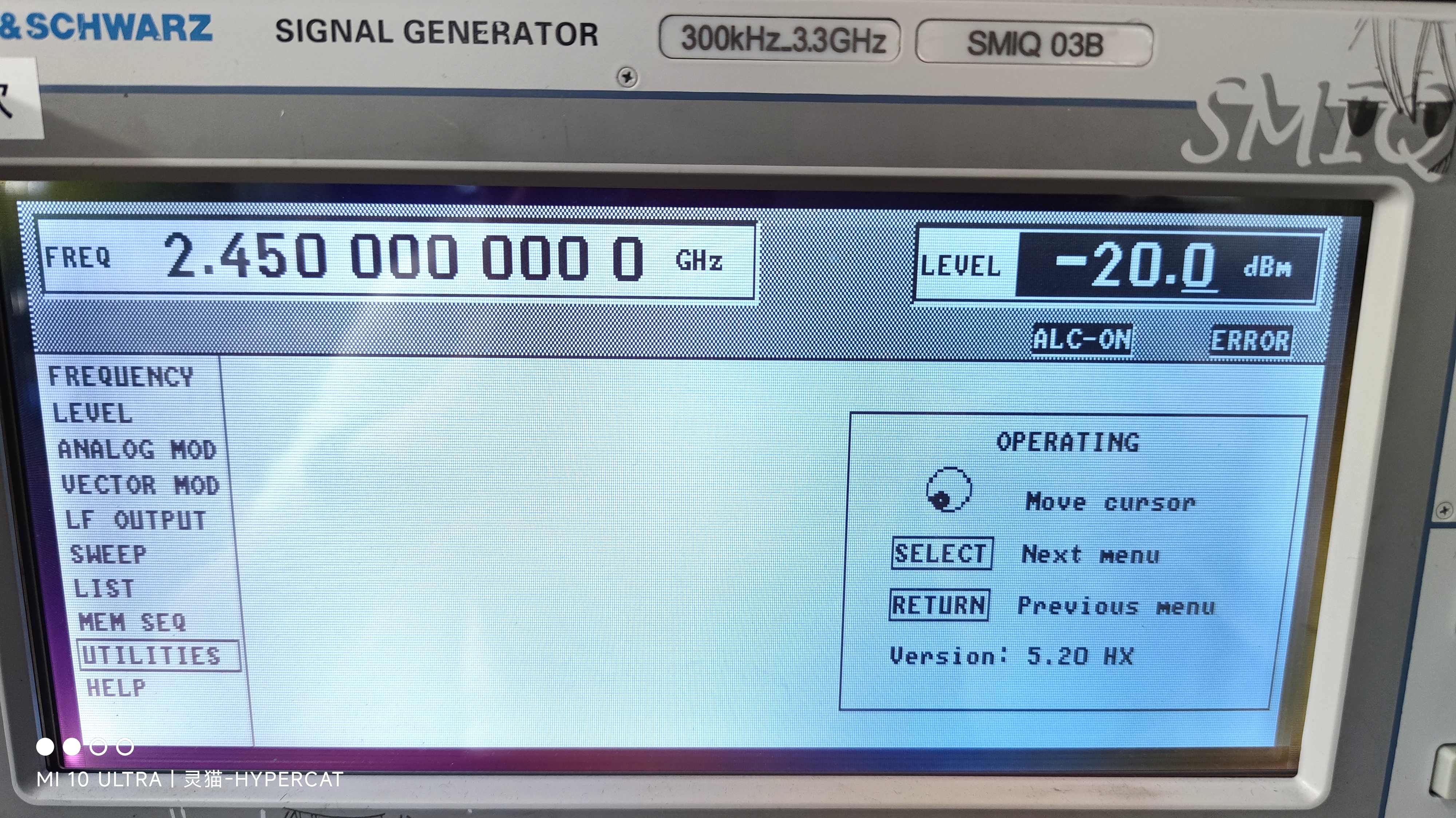

. 1. Set the signal source:
→ Output frequency: 2.45GHz (2.4G center frequency), no modulation at the point of view
→ Output power is -20dBm (to prevent over-pushing at power-on). The signal source output power will be manually and dynamically adjusted later based on actual measurement results.

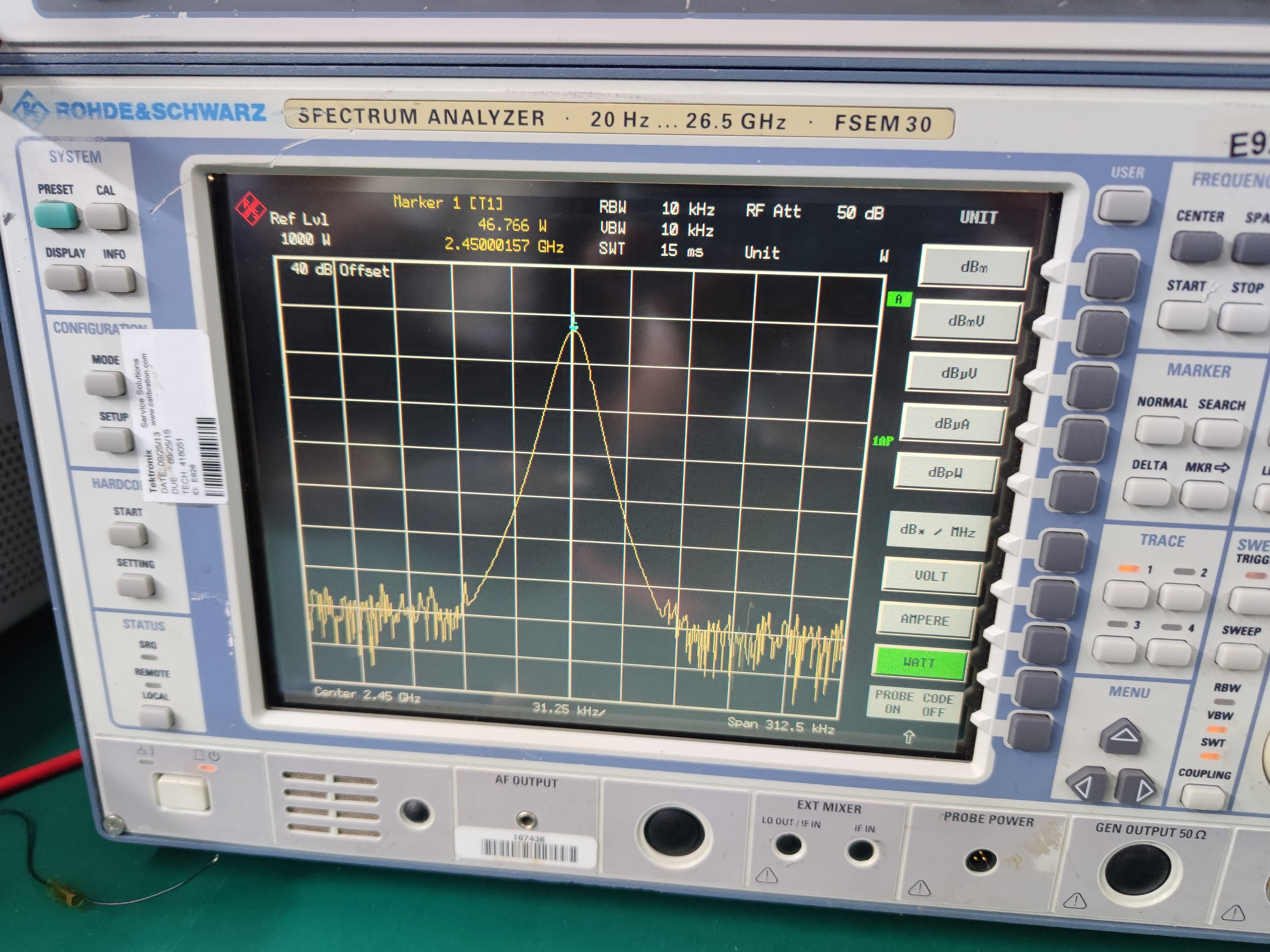

2. Setting up the spectrum analyzer:
→ Set the spectrum analyzer to CENTER: 2.45GHz. This is to place the measured spectrum peak in the center of the screen for easy observation.
→ Adjust RBW and SPAN according to the actual situation .
→ REF OFFSET 40dB (because an external 40dB attenuator is connected, the offset needs to be set here)
. → For easier power reading, we will change the display unit from dBm to W.
→ Select PEAK in MARK
as shown in the figure. The output power is approximately 47W, which is slightly lower than the 60W (pulse peak power) given in the manual. This is normal. Further adjustment of the matching should allow for a higher output.
