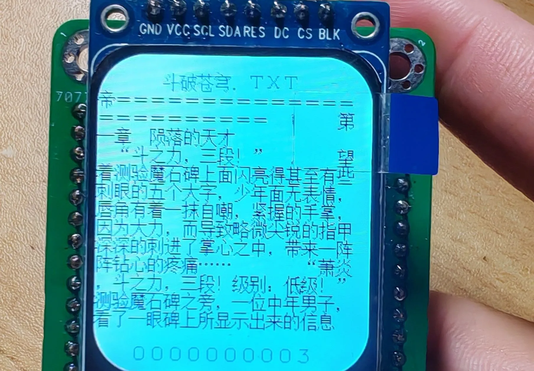

IV. Function Introduction
① Configure SDIO and FATFS file systems to read the dot matrix information of the font library and display the Chinese characters and other characters on the LCD screen.
② The used and unused capacity of the SD card is displayed in the UI (drawn by LCD interface functions), and the unit will automatically switch according to the SD card capacity
. ② When reading novels (TXT files), you can turn pages up and down using buttons without any garbled characters.

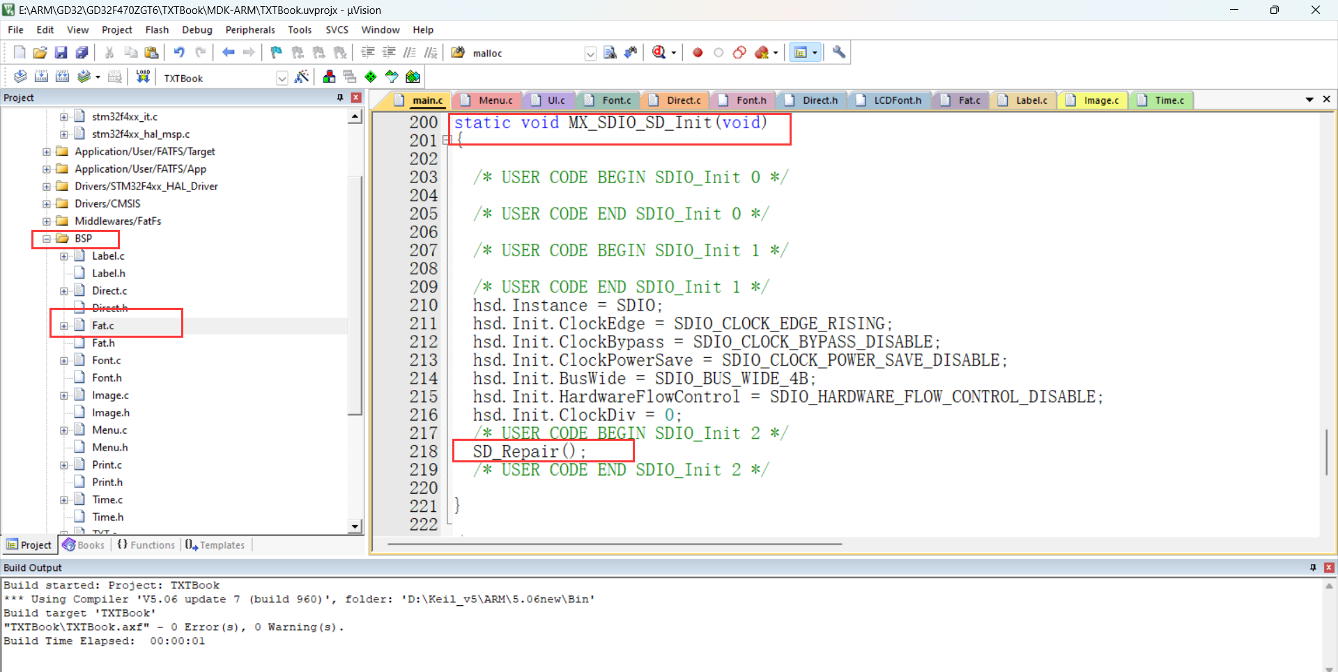

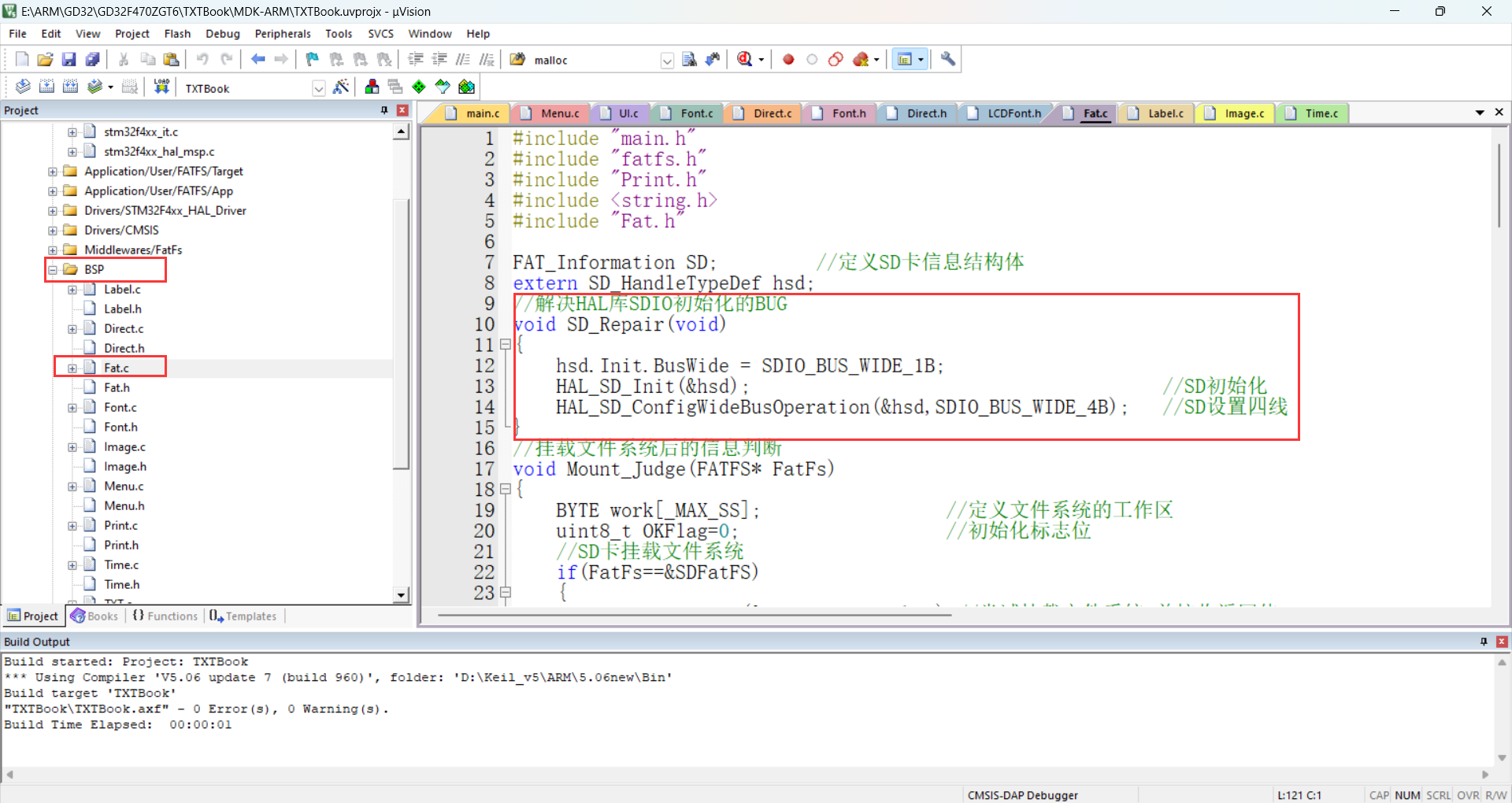

① Regarding the problem of TF card initialization failure caused by the automatically generated code when configuring SDIO using STM32CubeMx
: SDIO initialization should be initialized with one data line, but the code generated by CubeMx initializes it with four data lines, which seems to be a CubeMx bug.
Here, I encapsulated an SDIO initialization repair function to initialize SDIO with one data line and then change the data line to four to solve this problem.

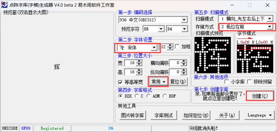

② Regarding the selection and processing of font encoding, how to display Chinese characters using the font library?
I created three font sizes: 16*16, 24*24, and 32*32.
One 16*16 Chinese character = 16*16/8 = 32 bytes;
one 24*124 Chinese character = 24*24/8 = 72 bytes;
one 32*32 Chinese character = 32*32/8 = 128
bytes. I also created seven fonts: 【仿宋】, 【黑体】, 【楷体】, 【华文行楷】, 【宋体】, 【新宋体】, and 【隶书】.
Website: GB2312 Encoding Table - Hammer Online Tools (toolhelper.cn)
Website: ASCII Code - Basic ASCII Code and Extended ASCII Code, the most complete Chinese ASCII code comparison table 0~255 (asciim.cn)

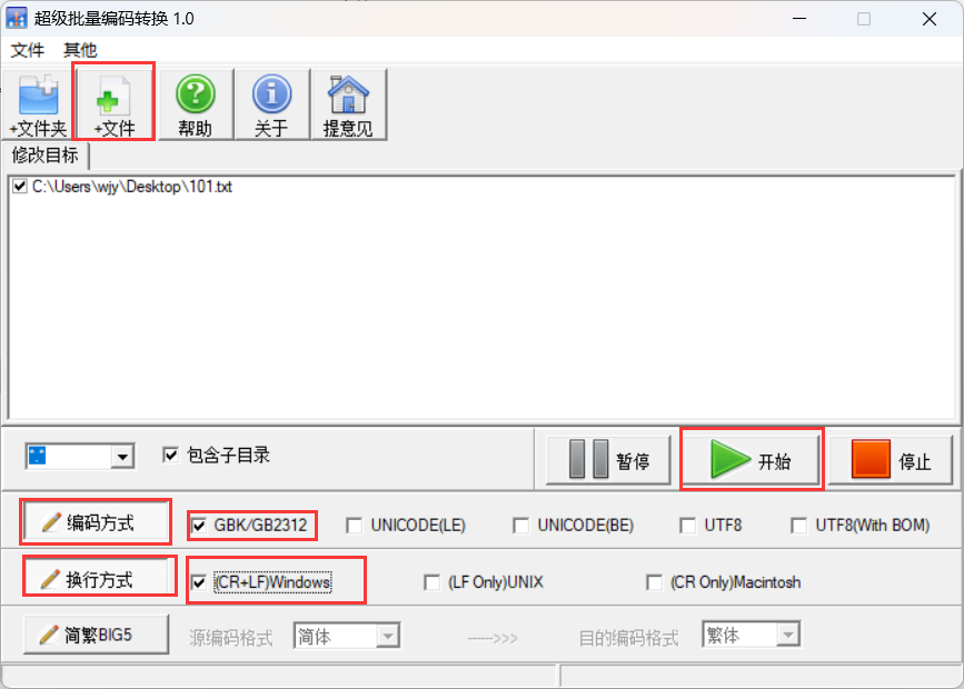

Here I've chosen the GB2312 encoding format. First, it's important to understand the GB2312 encoding format. GB2312 is a Chinese character encoding. In the GB2312 character set, both Chinese and English characters occupy two bytes. The first byte ranges from [0xA1, 0xF7], and the second byte ranges from [0xA0, 0xFF].
Novels or TXT files must be in GB2312 encoding format; otherwise, garbled characters will appear. This can be done using an encoding conversion tool
