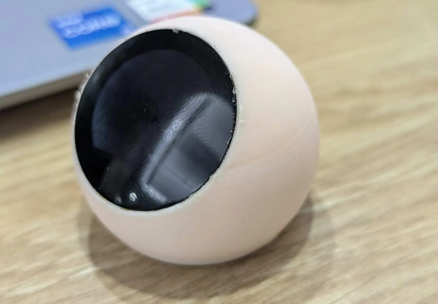

3D Shell Design:
This project is compatible with a corresponding circular FDM printed shell. The shell has a fixing slot for easy mounting of the circuit board. The cover is secured primarily by the friction of the layer textures. The shell has been verified on an FDM 3D printer.
Precautions:
Ensure the power supply voltage is 5V. Do not use other voltage values.
Device configuration address: 192.168.4.1. Please connect to the Wi-Fi network first, then access this address.
The weather API used is the Xinzhi Weather API, which is a free API. Please register on the official website to obtain the API key and enter it into the configuration address. The
clock interface may be out of sync upon initial startup; please wait a moment. Assembly Process:
The assembly process is relatively simple, requiring only a motherboard, a connecting cable, a screen, and a shell.
First, connect one end of the connecting cable to the screen.
Second, thread the cable through the shell and secure the screen with glue.
Finally, insert the cable into the shell, insert the motherboard into the limiting slot, and then close the bottom cover according to the opening.
1:
Emoji Page;
Image 2: Clock Page;
Image 3: Weather Page;
Image 4: Bilibili Page.
Attachment Description :
【TV-Lite.zip】: Program Source Code;
【firmware.bin】: Program Firmware;
【spiffs.bin】: FS File System Firmware;
【TV-Lite.SLDASM】: Combined File;
【TV-Lite.SLDPRT】: Shell Source File;
【TV-Lite_Bottom.SLDPRT】: Bottom Shell Source File ;
【TV-Lite_KEY.SLDPRT】: Button Growth Source File;
【TV-Lite.stl】: Shell 3D File; 【TV-
Lite_Bottom.stl】: Bottom Shell 3D File;
【TV-Lite_KEY.stl】: Button Growth 3D File.
Notes : For the 3D shell, it is recommended to use an FDM printer. For the OLED display, a 0.96-inch round screen
is recommended. For the buttons, it is recommended to purchase 2.5x2.5x10mm, which does not require growth.
