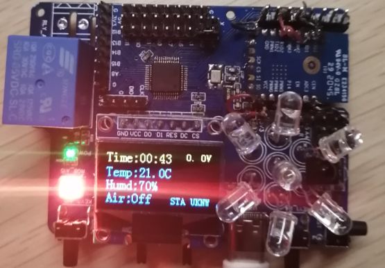

Based on the WIFI+BLE module WB3S, GD32F350 is used as the main control to realize the basic functions of the temperature and humidity sensor. In addition, there are other external expansion functions, including:
1. Infrared remote control (for remote control of air conditioners, TVs, etc.);
2. OLED display;
3. One relay (for 220V electrical switch);
4. Eight-way servo interface (for robot arm control, etc.);
5. RTC real-time clock, the time will not be lost even if the power is lost;
6. Available with TYPE-C interface for power supply;
7. It can also be powered by 3.7V lithium battery or 1.5V dry battery, and the battery voltage can be detected;
8. In addition, there are 2 user buttons, 1 RGB, and 1 power indicator light.
It integrates multiple functions into one and can flexibly adapt to IoT control in different scenarios.
2. Completion status
As of release, the following functions have been completed:
1. Basic functions:
(1) Collection and reporting of temperature and humidity.
(2) Communication between the Wifi module and the MCU, and the device is connected to Wifi and the cloud.
(3) Mobile phone interface, various parameters are displayed through the interface, and corresponding functions can be controlled by issuing parameters.
(4) GUI interface design of device-side OLED.
(5) 3.7V battery voltage detection, OLED display and App interface display.
(6) RGB light display, the Wifi module will display different colors when it is in different states.
2. Extended functions:
(1) RTC real-time clock, OLED display, once connected to the cloud, the time will be automatically calibrated, and the device will not stop timing even if it is powered off (but the error will become larger as time goes by, so time correction is required).
(2) Infrared learning, receiving infrared signals through the infrared receiving tube and transmitting the received signals. For example, the air conditioner remote control button receives the coded value of one button at a time, and then presses the button of the device to emit the learned signal (mainly used to read the infrared coded value during the debugging phase, which is commented out in the code).
(3) Air conditioner remote control (air conditioner brand: Changhong), the coded value stored through infrared learning is recorded (currently only the three buttons of power on, power off, and full automatic are recorded, and can be expanded later if necessary), which can be accessed through the App interface Control air conditioning.
3. Functions to be completed:
(1) The App interface controls the servo and then controls the light switch. The software has been implemented and the hardware has yet to be implemented.
(2) The App interface controls the relay and then controls other electrical appliances. The software has been implemented, but there are no other devices that require relays in the dormitory, so it cannot be displayed.

4. Hardware
1. Board making and welding.
2. Be sure to check the user library of Lichuang EDA when using it. I accidentally used the WB3S package backwards, so I could only install it in reverse.
3. The layout of the infrared emitting diodes is based on the one made by DL from the first Internet of Things training camp. Seven diodes require a larger current for emission, so it was later changed to five. The two extra diodes will not be removed and are only for decoration. If you need more current, you can replace the 500mA fuse with one above 1A.
