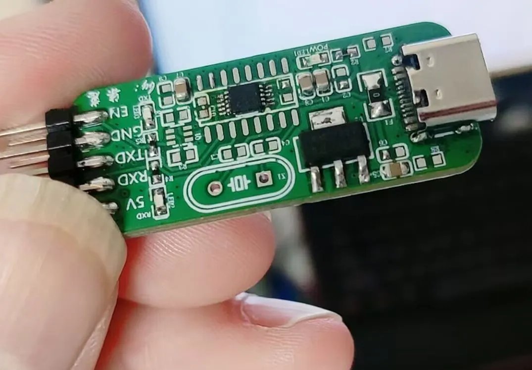

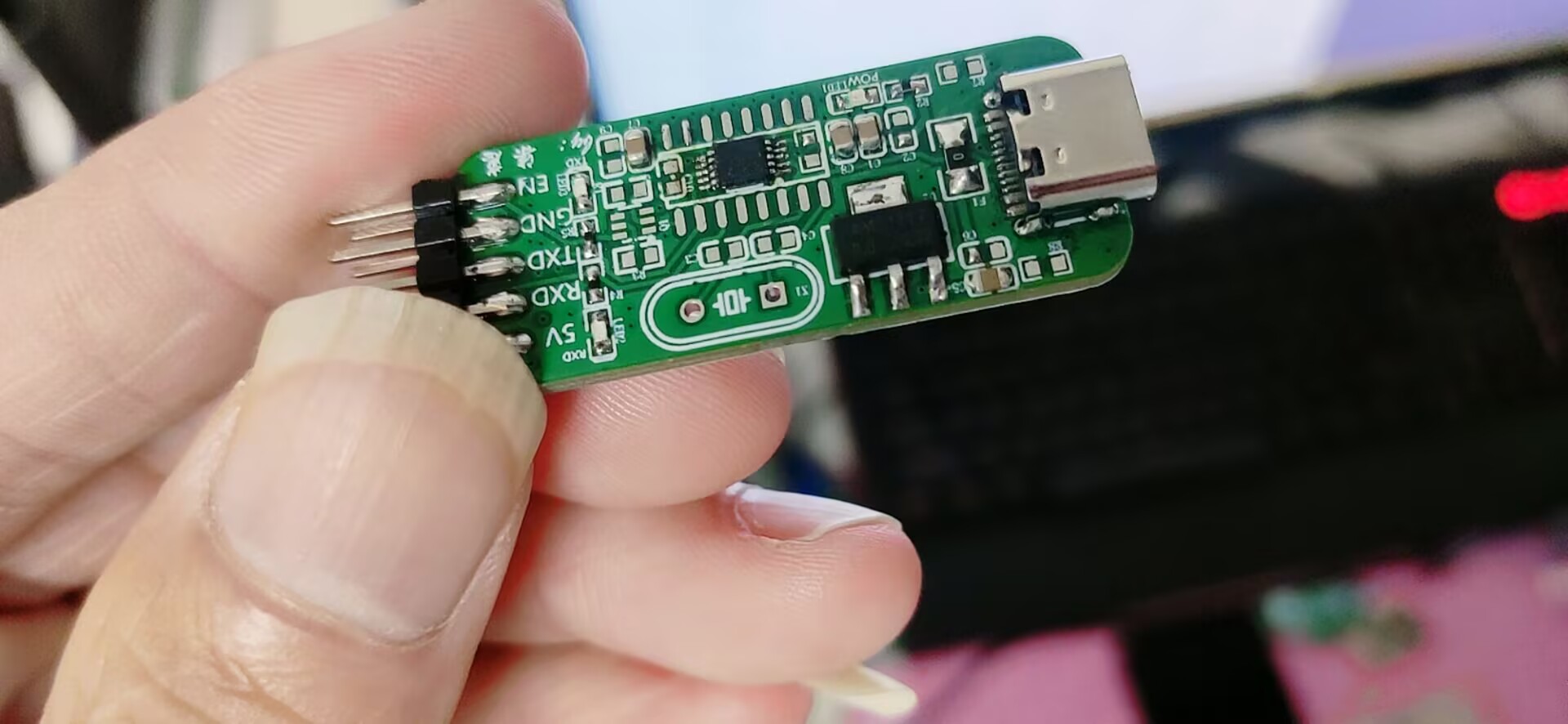

ESP32 Auto Download
CH340G CH340C CH340C serial port tool for automatic ESP32 download, multi-chip compatible design, using dual NMOS to achieve automatic download of ESP series chips.
