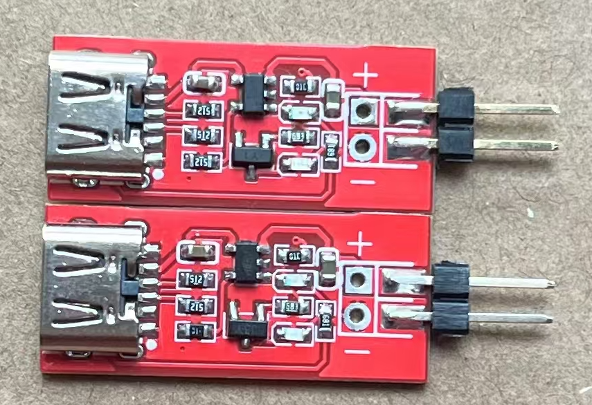

Mini Lithium Battery Charger
This charger uses a state-of-the-art Type-C interface for power input, with a red light indicating charging and a green light indicating full charge. The output uses a 2.54mm 2-pin connector for portability.

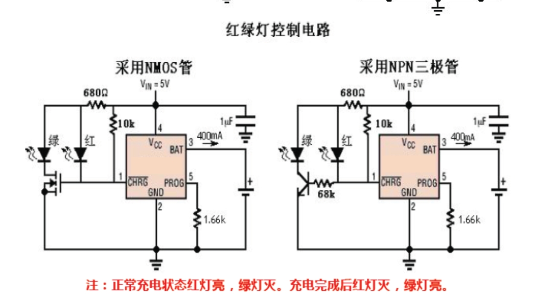

Previously, I used a single-light TP4054 charger – red during charging and green when fully charged – which felt inadequate. I found another guide on dual-light usage for the TP4054.
I used a transistor; you can try it yourself by replacing Q1 with a MOSFET and replacing R6 with a 0-ohm resistor. The transistor worked perfectly, so I won't test it.

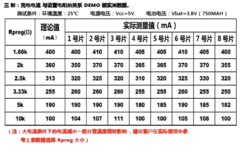

R3 is used for current regulation; please select the appropriate resistor as shown in the image. For very small batteries, use a larger resistor to prevent incomplete charging.

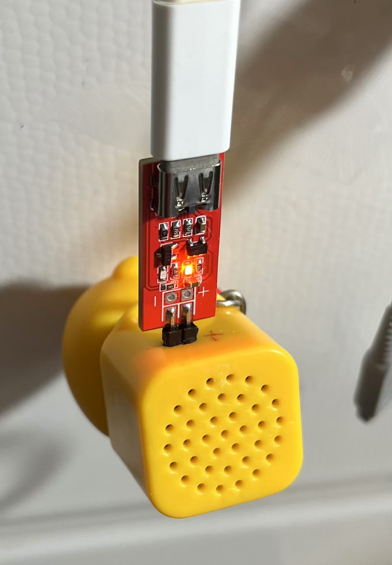

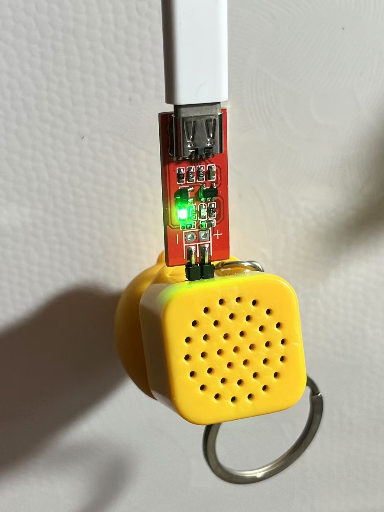

Finally, here's a picture of the charger charging.
