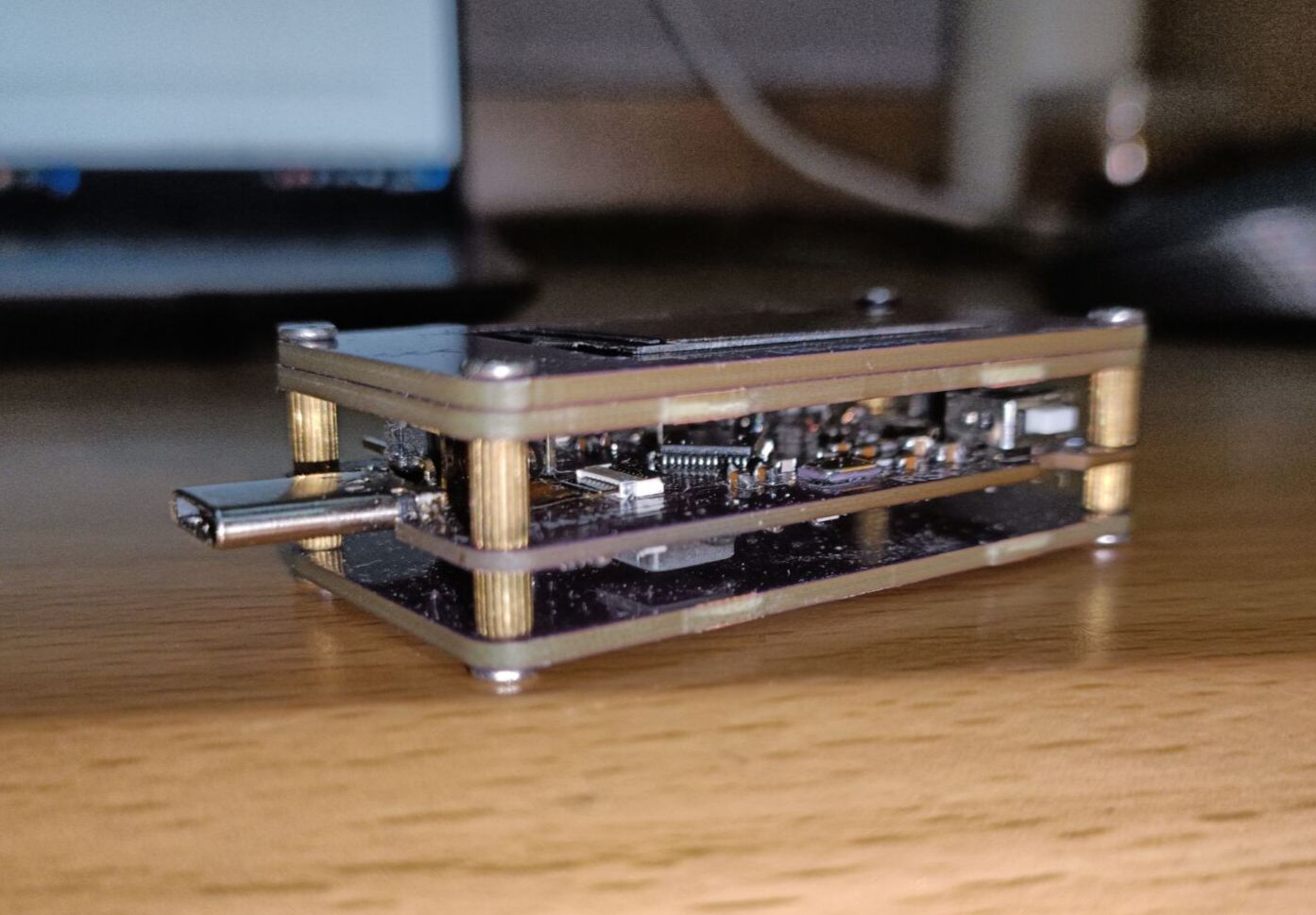

# **USB-Meter-Pro Project Description** ## **Overview** --- Lichuang Training Camp|Lichuang Electronic Design Competition Works, the work was completed on 2022/08/26. This work uses national technology N32G430C8L7 as the main control MCU. The other main components include TFT color screen, W25 memory chip, ina199 current sampling chip, DCDC step-down chip, etc. Implement current and voltage detection, voltmeter, small game console and other functions of consumer products with typec interface. The hardware design was studied with reference to many big names in the open source platform. The program was designed independently, the size is relatively small, and the appearance is acceptable. ![1.png]
