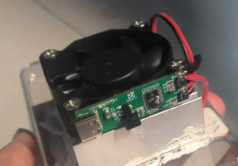

CH32V003 Mobile Phone Heatsink Control Board
1. The
CH32V003 series microcontroller is an industrial-grade general-purpose microcontroller based on the Qingke RISC-V2A core. It supports a 48MHz system clock frequency and features wide voltage range, single-wire debugging, low power consumption, and an ultra-small package. It provides commonly used peripheral functions, including one DMA controller, one 10-bit analog-to-digital converter (ADC), one operational amplifier comparator, multiple timers, and standard communication interfaces such as USART, I2C, and SPI. The rated operating voltage is 3.3V or 5V.
Advantages: High performance; low price, ¥0.7 per piece on Taobao (when I bought it, shipping was even free, now it costs only a few cents); rich peripherals, etc. (
official website link)
. 2. The design
uses a CH224K to trick a PD protocol charger into obtaining 12V voltage;
uses an LDO to step down to 3.3V to supply components such as microcontrollers;
dual PWM outputs through NMOS to independently control the fan and semiconductor heatsink;
dual operation buttons to adjust the heatsink to the optimal state;
VBUS bus voltage detection to prevent voltage drops from damaging the heatsink;
supports 2/3/4-wire cooling fan control, the 4-wire fan control hardware is not verified.

(3) Install
Cut the phone case opening to be similar in size to the heat sink; cut the copper sheet to fit your phone;
apply silicone grease and install the heat sink and semiconductor cooling chip. The side of the semiconductor cooling chip with the lettering is the cooling side, stick the copper; the other side is the heat sink .
Incorrect example: The silicone grease area is too small, the glue area is too large, and the thermal conductivity is not good.
Correct example: Apply silicone grease to the front, this time it is 7921, which is more difficult than scraping putty. Attach it to the heat sink and fix it with glue on the outside.
Wait for the glue to cure .
    3. Fix the phone case and copper sheet
    4. Apply silicone grease and install the copper sheet and semiconductor cooling chip.
Due to the small space, it is difficult to operate. I used the above "incorrect example" for installation.
    5. Attach the board to the heatsink, being careful not to short-circuit.
