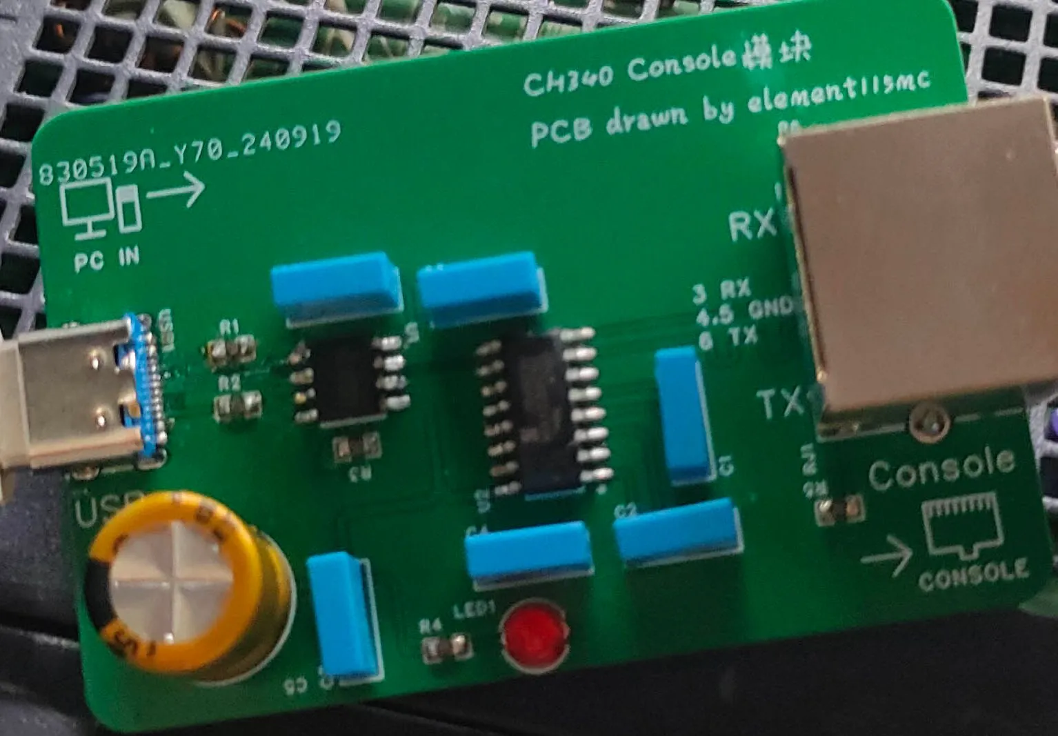

CH340 Console Module
This console communication module uses the ultra-stable CH340 solution and is compatible with Win11 systems.
The reason for making this: I bought a switch with a console port to play around with, but found that the console cables on the market were not very reliable. Those using the PL2303 solution couldn't install drivers on Win11, and on Win7, the drivers would drop frequently, requiring a restart to fix. Console cables using the FT232 solution were extremely expensive. After researching the working principle and communication levels of the console port, I decided to build my own better and cheaper console communication module.
Features: Made using the CH340N USB-to-TTL chip and MAX232, it has a simple structure, stable operation, and low cost. Only one A-to-C data cable and one network cable are needed to enable communication between the computer and the switch's console port.
Usage:
1. Prepare an A-to- C data cable... C. Data cable and a cable of length
2. Since the Console port uses RS232 level communication, which involves high voltage, hot-plugging the RS232 level port while it is powered on can easily damage the port circuit. It is recommended to first connect the module's network port to the switch's Console port using a network cable, and then use A to... 3. Connect the computer's USB-A port to the Type-C port on the module using the C data cable. 4.
After configuring SecureCRT and other software to suit the switch's communication parameters, you can communicate with the switch's Console port.
5. After completing communication, it is recommended to disconnect the USB connection first, then disconnect the physical connection of the Console port (for the same reason as point 2).

: 1. Because the Console port uses RS232 level communication, the voltage is relatively high (-9V, +9V). Hot-plugging RS232 level ports while powered on can easily damage the port circuitry. Recommended connection order: Console port → USB; Disconnection order: USB → Console port.
2. The indicator lights on the network port are only used to show the active status of the RX and TX communication lines and are unrelated to the network connection status.
3. Do not mistake this device for a USB wired network card and attempt to establish a network connection using it (if you can't even distinguish this, there's no need to be a network engineer or have a need for this module).
4. This device's network port is only allowed to connect to the switch's Console port (this is the purpose of this module's design). It is forbidden to connect this device's network port to any other device's regular network port or PoE port. [Image of the device
itself connected to the switch; image of communication results with the switch (9600 baud rate)]
