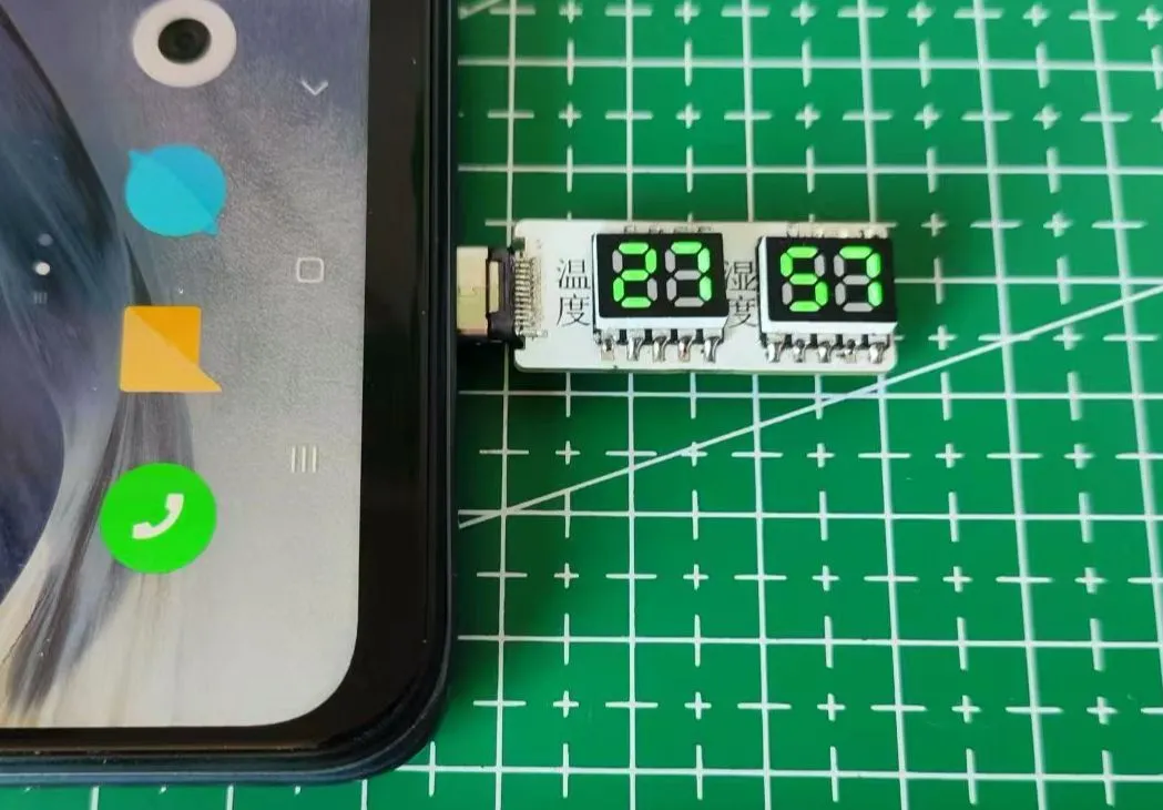

Mini Thermometer and Hygrometer
Type-C mini portable thermometer and hygrometer; microcontroller source code is attached.
07.TypeCWenShiDu.zip
PDF_Mini Thermometer and Hygrometer.zip
Altium Mini Thermometer and Hygrometer.zip
PADS Mini Thermometer and Hygrometer.zip
BOM_Mini Thermohygrometer.xlsx
