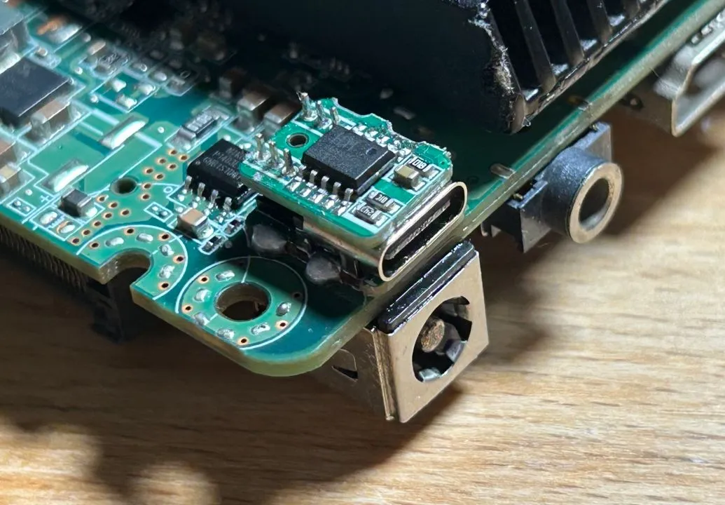

This project is based on the CH224K PD/QC decoy power module. It features non-destructive modification, small size, and compatibility with DC power sockets (as shown in Figure
C381108). Similar packages can be used for
soldering. Note
that a stacking method is required, using a 1.27 1*3P connection. The soldering technique is important, and the bottom pads should be flattened as much as possible.
Note that
the board thickness should be 1mm; if it's too thick, it won't be able to be pried open. When prying it open, use another board to clamp it from the top and bottom. Adjust the voltage selection
and the resistance value of resistor R1 in the white solder mask area as shown in the figure
. The finished product is shown in the figure.
