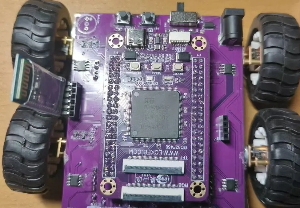

Intelligent car design based on LCSC Liangshan School
This project is
based on a smart car from the Liangshan School. It's my first hands-on project as a complete beginner.
The replica of the Liangshan School car from LCSC was made based on my own schematic and PCB. The PCB was made at JLCSC using this PCB, and the components were also purchased from LCSC's online store. It's absolutely identical, 100% accurate. The material order and PCB manufacturing records are in the attachments.
The goal is
to become familiar with the entire process of a project from its inception to completion, master hardware design and software development skills , and
learn how to use a soldering iron to solder circuit boards.
Project functions
include: intelligent car movement, differential turning,
PWM speed control,
Bluetooth control,
and car tracking.
Project parameters
include a Liangshanpai GD32 development board, essentially an expansion board.
Skills acquired include
: 1. Some board design techniques, such as how to arrange components more aesthetically and for better wiring, as well as teardrop and via designs
. 2. Some soldering techniques; through videos from LCSC on Bilibili, I learned some basic techniques, such as soldering resistors, capacitors, and transistors, and understood soldering irons, hot air guns, rosin, etc.
3. Some keyboard shortcuts for drawing schematics, which are very convenient.
4. Collaborative and systematic thinking; previously, I only learned about individual peripherals, but now I've integrated them. I felt this experience would allow me to familiarize myself with peripherals and develop systematic knowledge. However,
I encountered the following difficulties
: 1. The first problem was not being able to find the corresponding schematic for each component when drawing the schematic. This stumped me for a long time until I searched online this morning and learned that components can be packaged themselves, which solved the first problem
. 2. I used too many vias during routing. I feel my component placement is still problematic and I should pay attention to this issue
. 3. The difficulty lies in writing code. I can write individual low-level drivers, but once they are integrated, it becomes difficult and I'm completely lost. I can only look at how LCSC (Lixin Technology) writes them. I feel my comprehensive thinking is still lacking, and I should cultivate meticulous logical thinking.
4. The soldered boards look terrible; I need to practice how to solder more neatly.
5. I thought the Bluetooth host computer would require Android. Written in Studio, I didn't expect it to be directly graphical programming.
The simple demo video
has many functions, and I'm still fixing bugs.
Principle analysis (hardware description):
This project consists of the following parts: power supply, LED lighting, main control, ultrasonic circuit, Bluetooth, line tracking, ADC, and buttons.
1--Power supply circuit:
2--LED
3--ADC
4--Line tracking
5--Motor drive
6--Bluetooth and ultrasonic
circuits (these two are ready-made modules).
