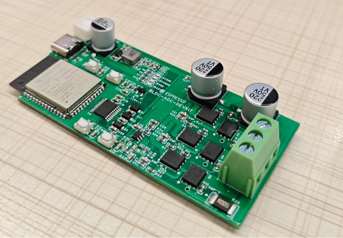

Project Overview:
This project utilizes Espressif Systems' ESP32-S3-WROOM-1 module as the system's main controller, leveraging its LEDC and MCPWM modules to drive the three-phase inverter circuit. Furthermore, the system supports integration with RainMaker for brushless motor start/stop and speed control. Based on the control principles of this solution, interesting applications such as intelligent sensorless fans can be implemented.
Supported Features:
12V voltage input
; USB and serial port
programming support; sensorless start
support; motor speed regulation
support; LEDC and MCPWM support.

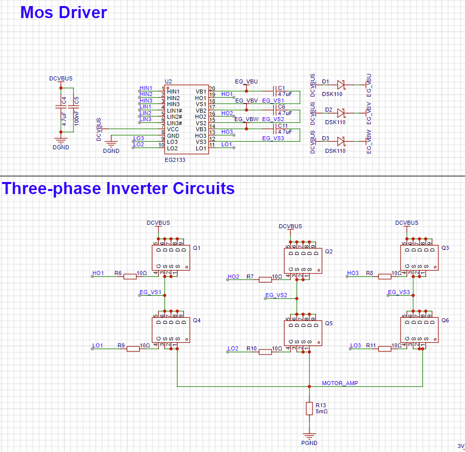

Three-Phase Inverter Circuit Driver:
This solution uses the EG2133 chip as the three-phase inverter circuit driver, internally integrating logic signal input processing circuits, dead-time control circuits, latching circuits, level shifting circuits, pulse filtering circuits, and output drive circuits.

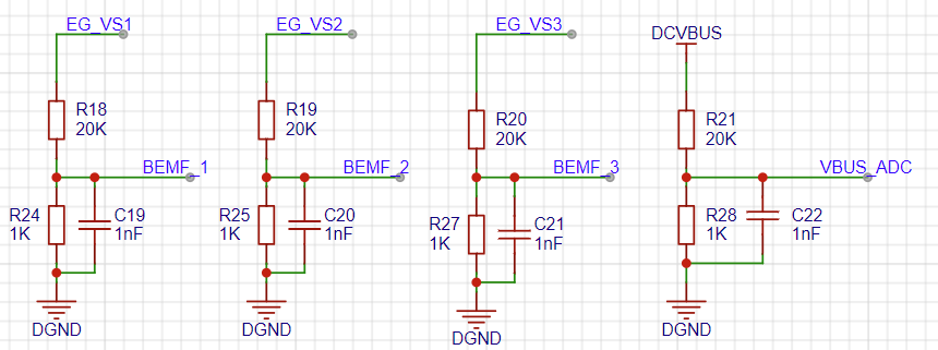

ADC Detection Principle :
The three-phase terminal voltages of the brushless motor are directly acquired through a voltage sampling circuit, and the zero-crossing point of the floating back EMF is calculated using software calculation methods. Additionally, the ADC detection method requires acquiring the bus voltage in each control cycle to determine the theoretical neutral point voltage, and comparing it with the terminal voltage of the floating phase to obtain the zero-crossing point of the back EMF.

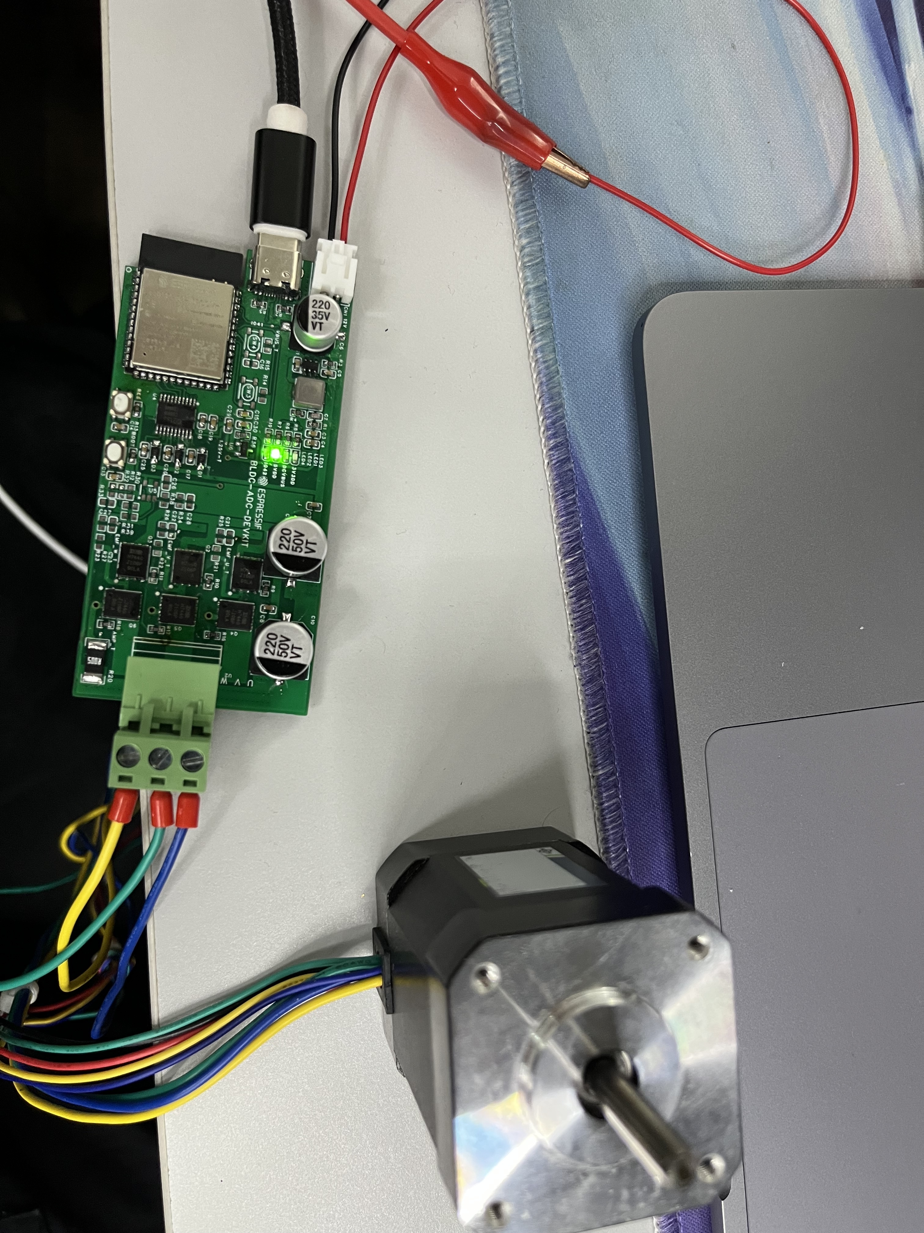

Hardware Design
and Physical Diagram:

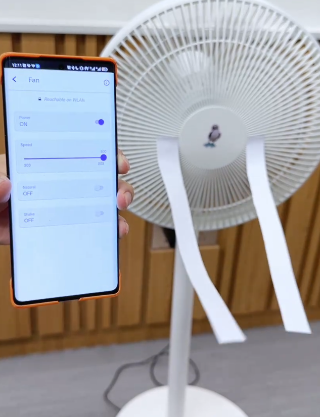

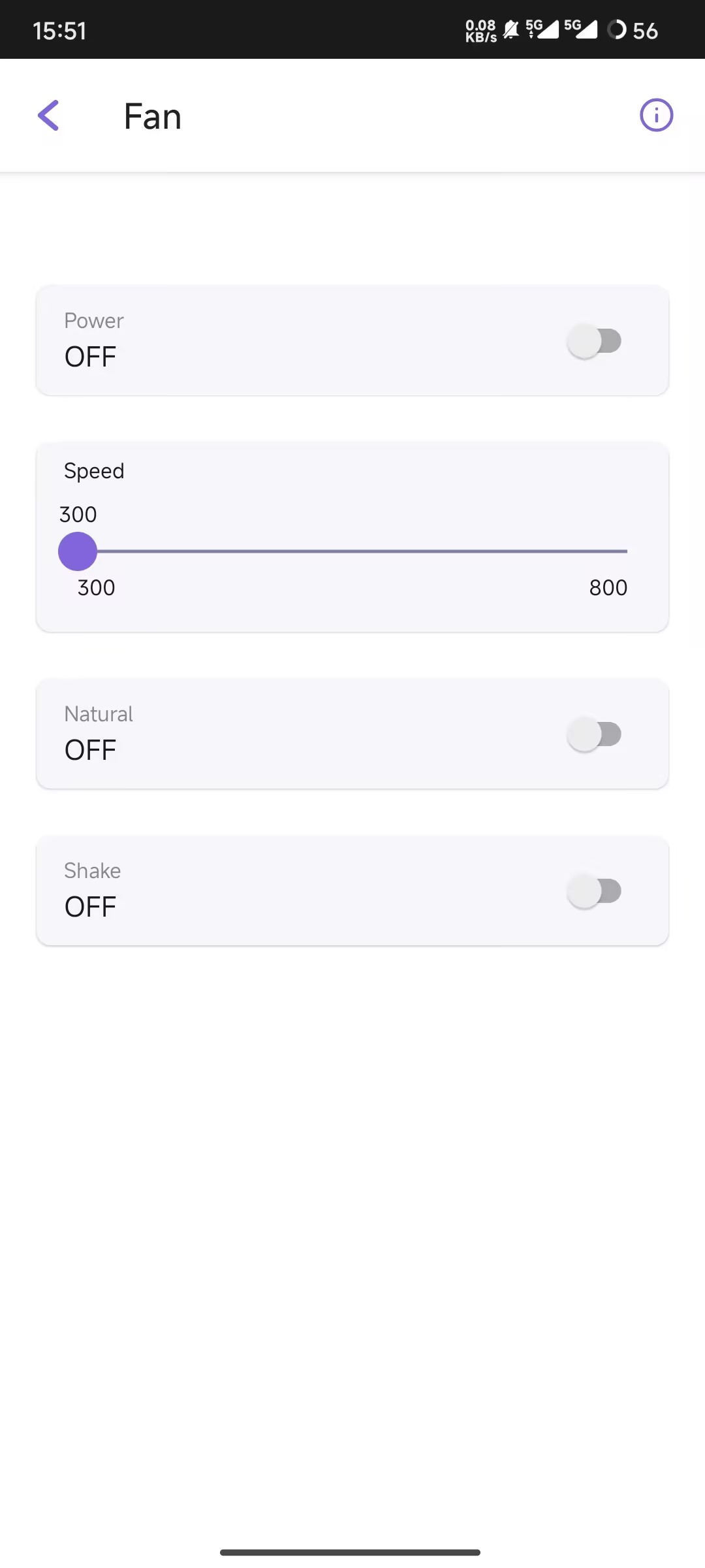

bldc_fan_rainmaker: Example of brushless motor control integrated with RainMaker. Features include
stepless speed regulation
, natural wind,
remote start/stop,
OTA,
BLE network configuration
demonstration video,
and a smart fan based on the ESP BLDC control scheme.
