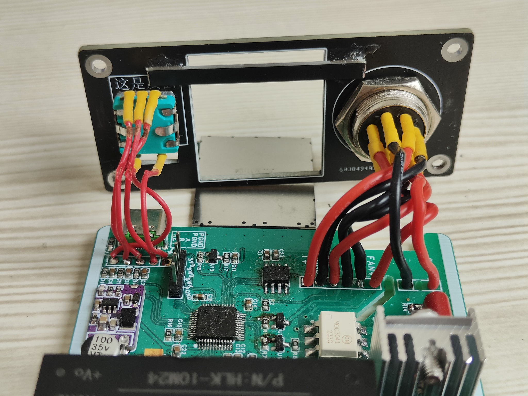

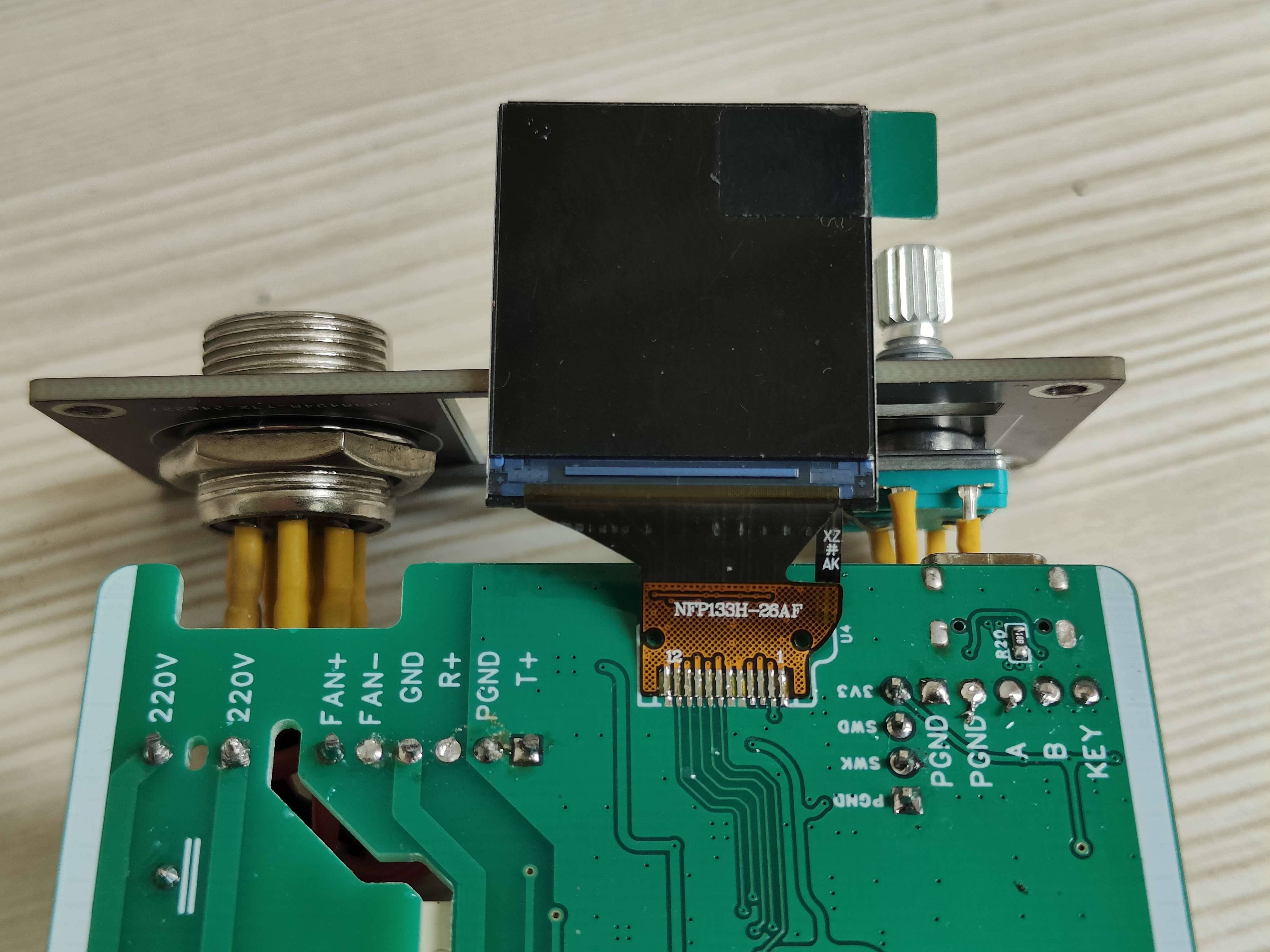

Soldering instructions:
First, solder the low-voltage components on the PCB, including the screen, rotary encoder, and aviation plug.
After burning the code, attach the hot air gun handle and power it with the programmer; the buzzer will sound once upon power-on.
Check if the screen displays and if the encoder works.
Check if the hot air gun temperature displayed on the screen is normal and if the hot air gun's operating status changes.

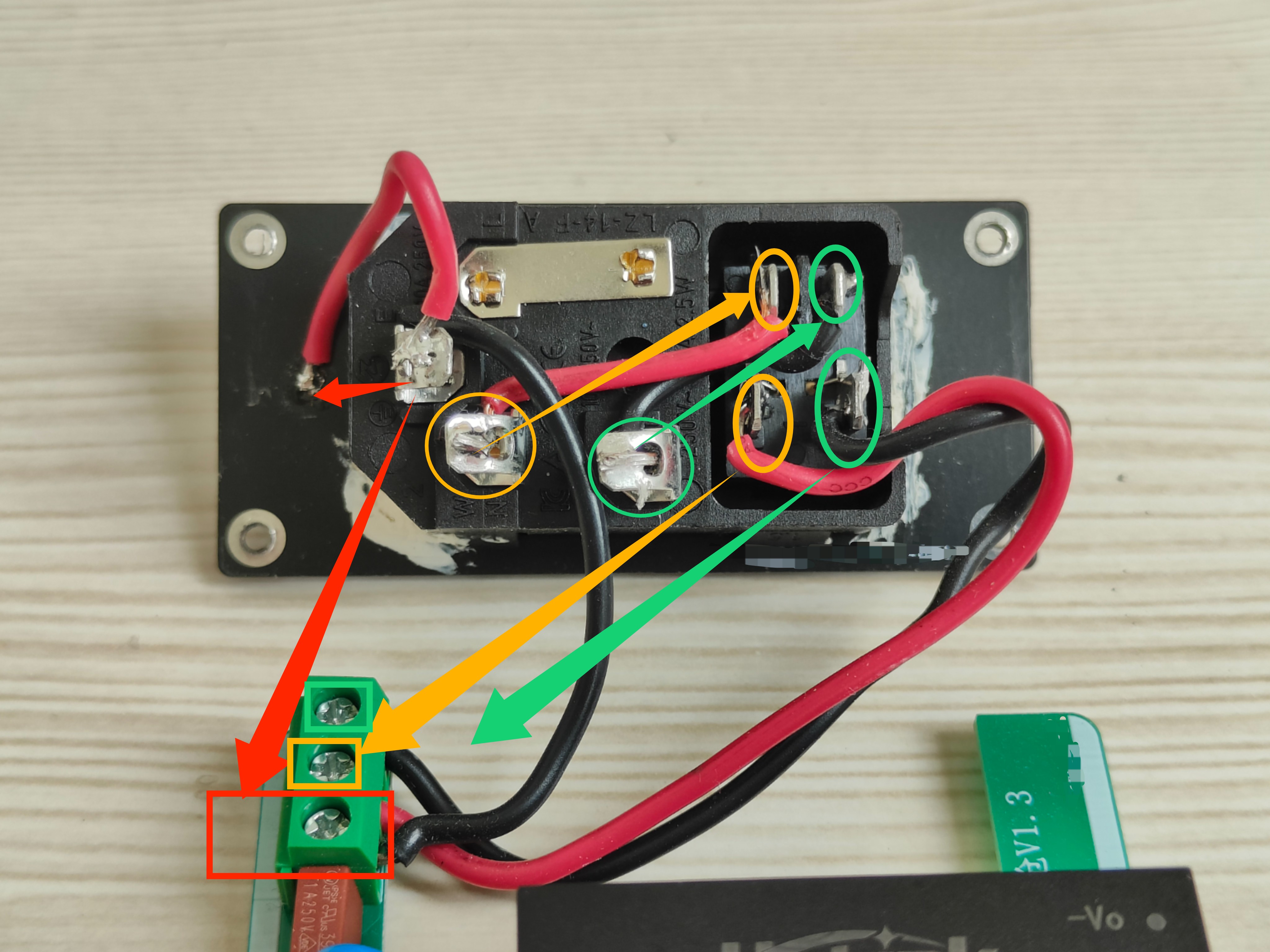

Measure the resistance at the "220V" mark on the PCB; it should be between 60Ω and 90Ω. If
all of the above is normal, then solder the high-voltage components, using 18AWG wire.
Pay close attention to the soldering order for the sockets!!!
Remember to close the cover before powering on to prevent injury from an explosion.
You can use toothpicks, popsicle sticks, etc., to hold the screen in place, then glue it in place to prevent it from falling off.

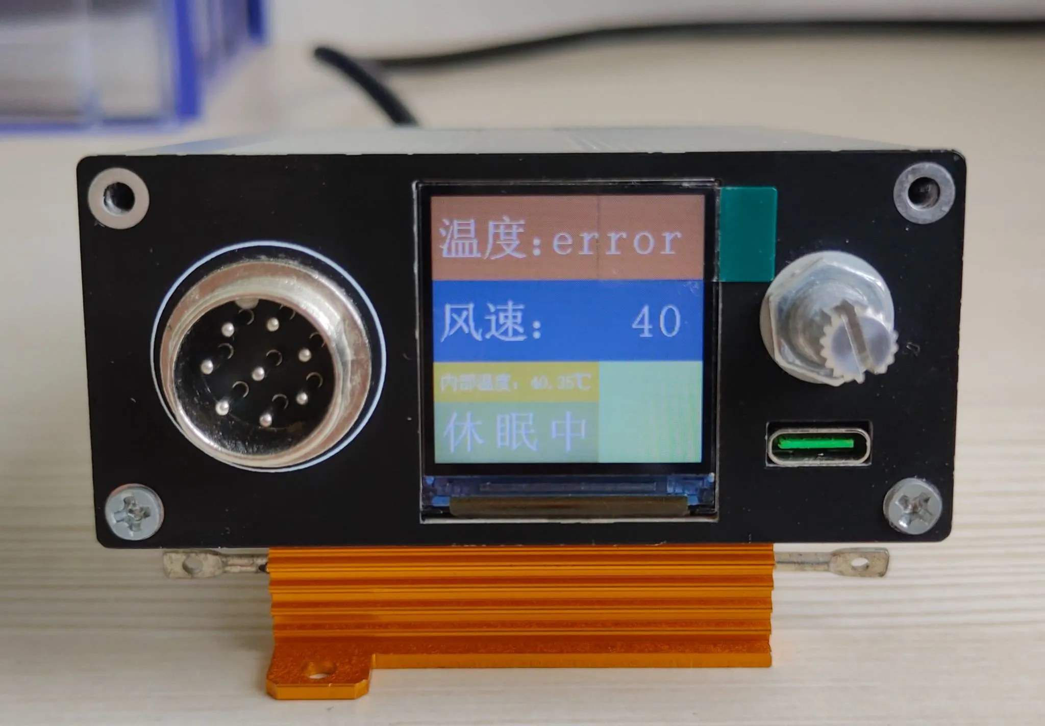

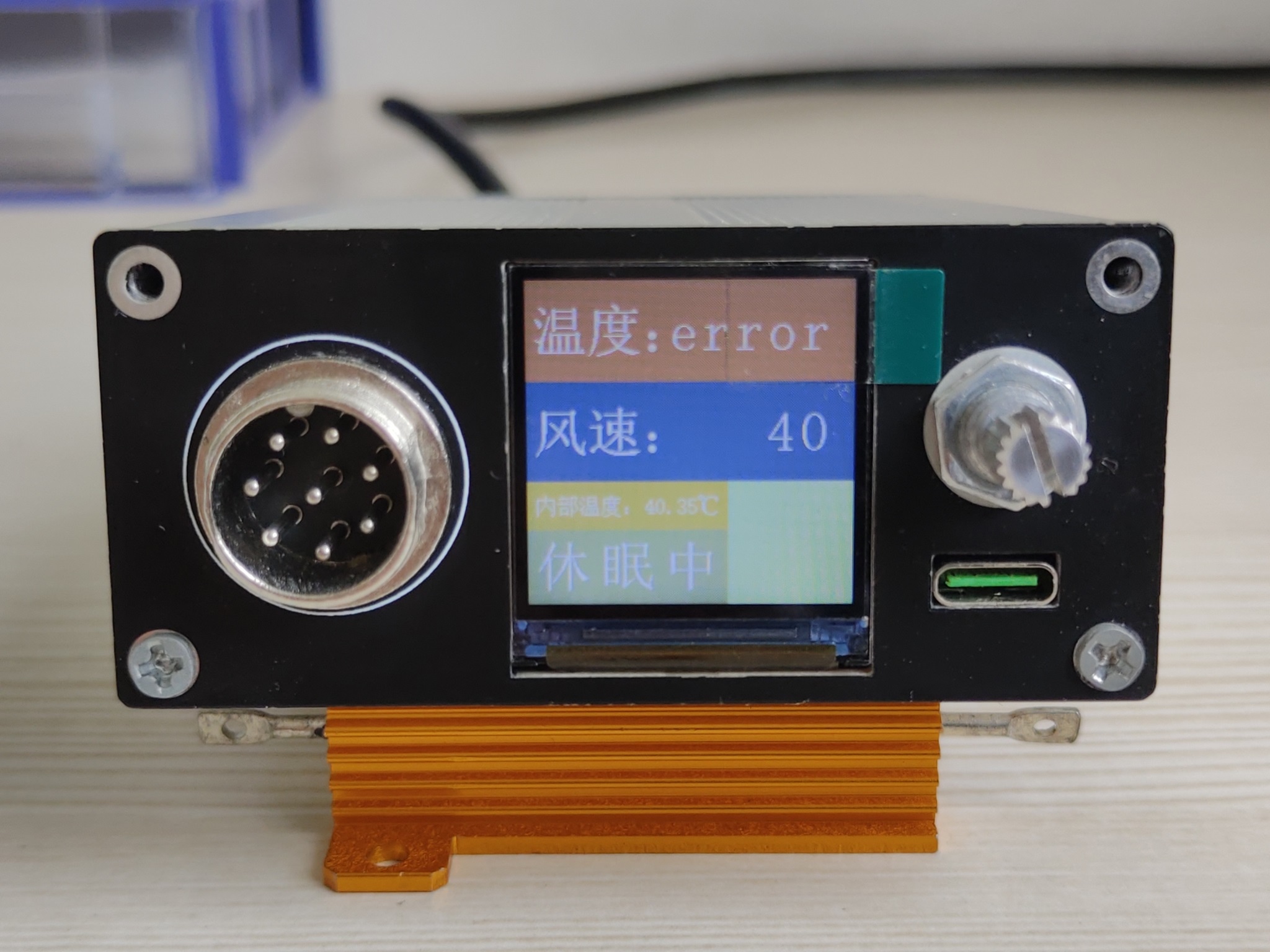

Front view:
Front panel
, rear panel,
bottom should ideally be insulated with something.

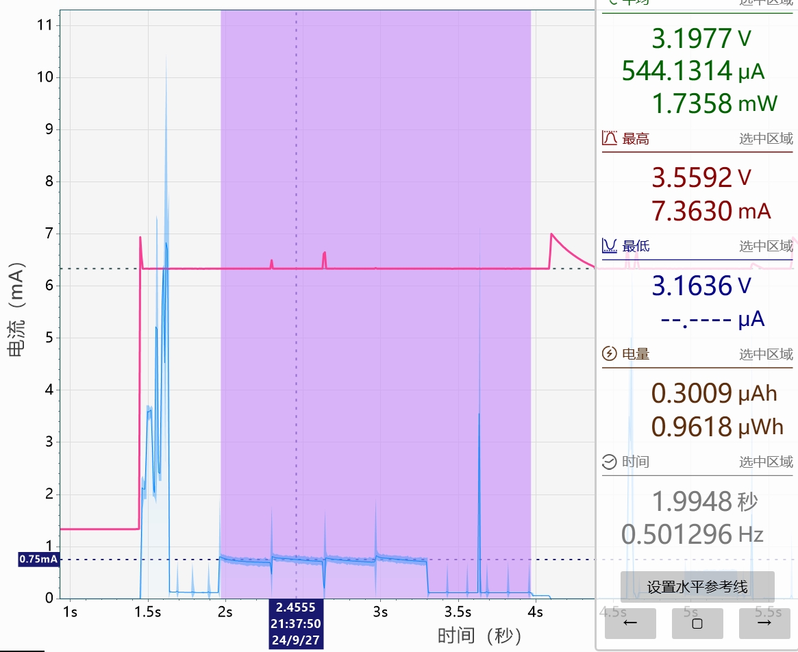

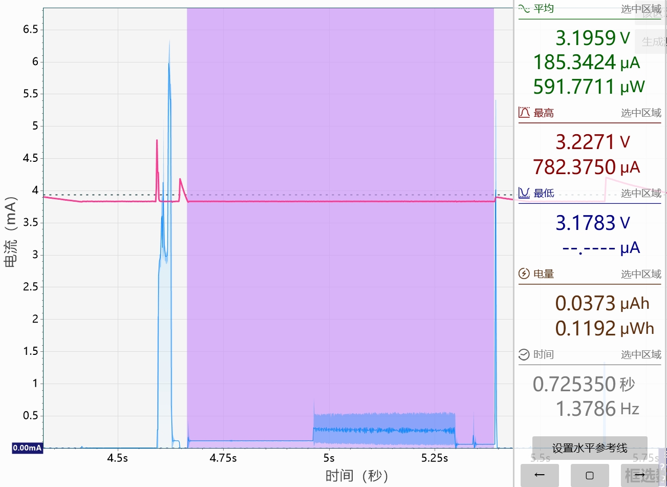

Power Consumption Analysis
Conditions: Temperature and humidity data are collected every 10 seconds, with a change interval of 0.1℃ and 1%, and data is transmitted every 1 second.
Average Beacon power consumption: 20uA. See the attached power consumption analysis report for details.

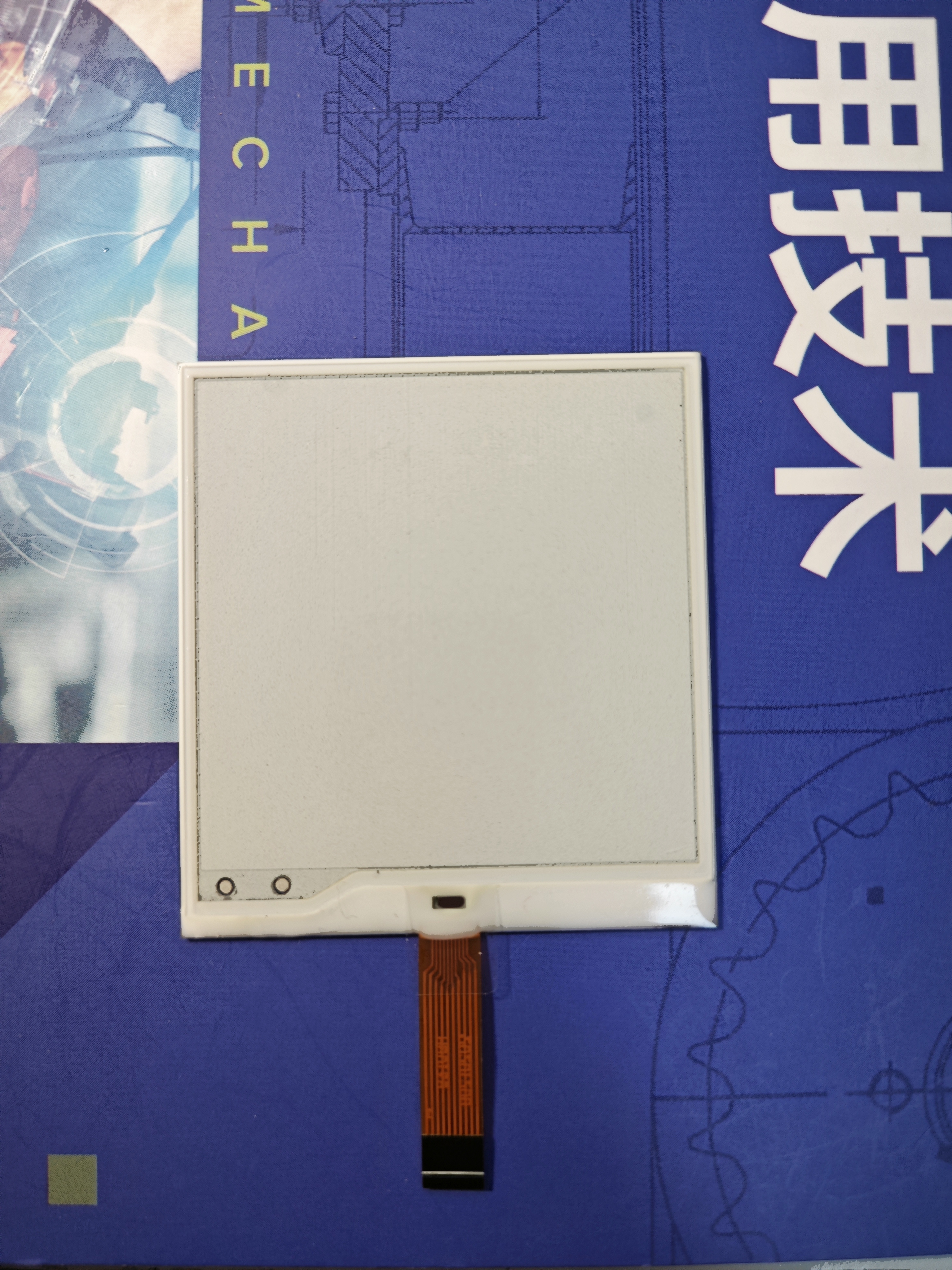

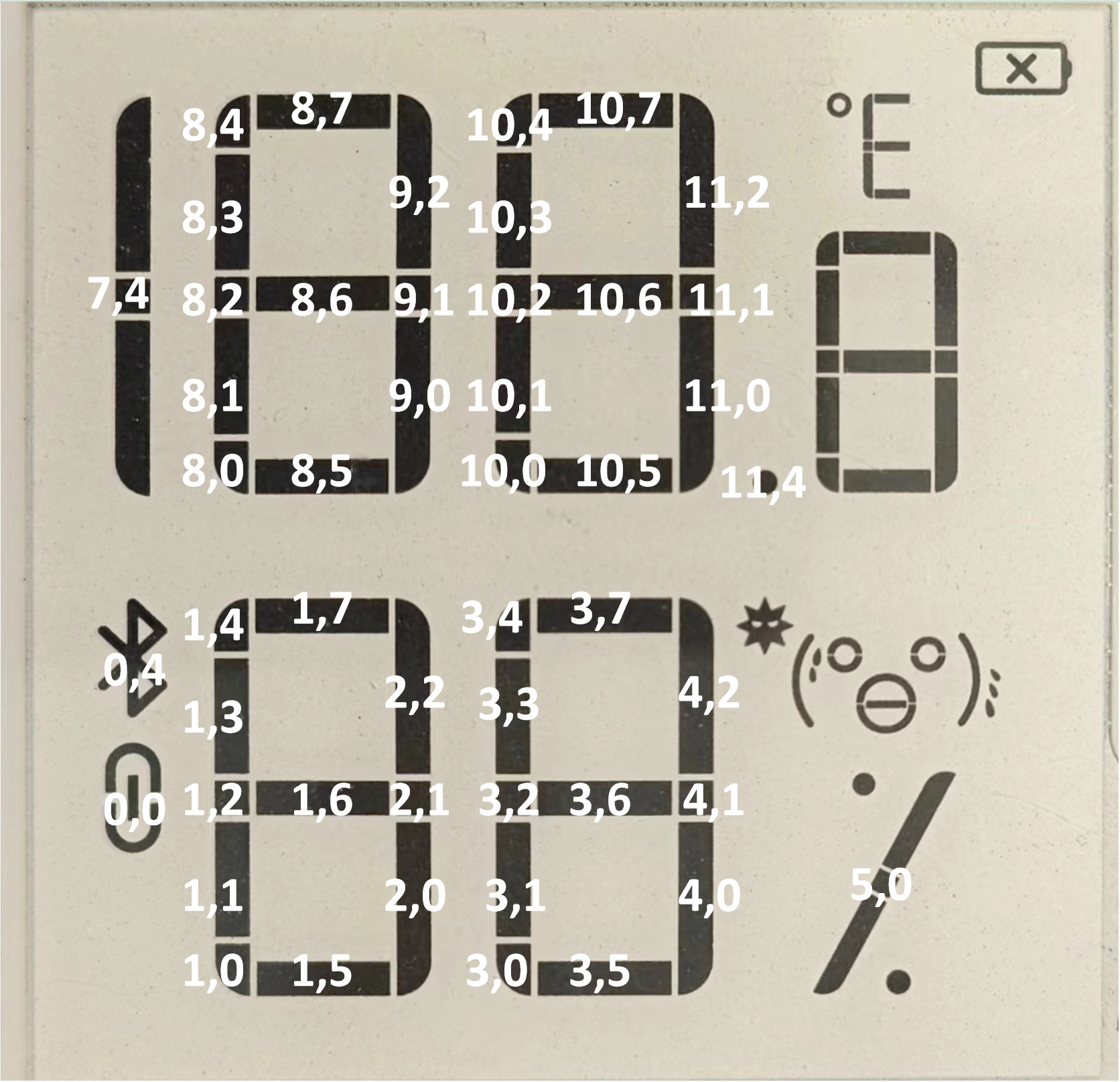

Segment E-ink Screen:
This screen displays temperature and humidity, emojis, and a Bluetooth icon. The position of each segment is marked on the diagram.
Full-screen refresh time is approximately 2 seconds, with an average current of only about 500uA. The screen requires periodic full-screen refreshes to remove residual artifacts from partial refreshes.
The partial refresh time is approximately 700ms, with an average current of only about 180uA.
The external circuitry of the e-ink screen is simple, requiring only two energy storage capacitors and no external boost circuit for the dot matrix ink bottles. The

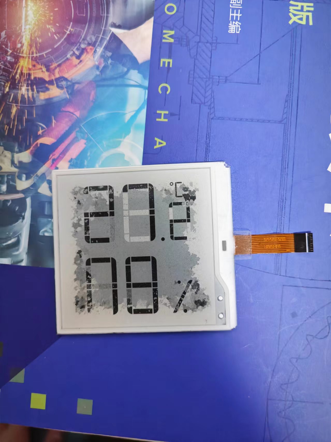

Ensure the 10-pin connector for the e-ink screen is correctly soldered and free of cold solder joints. Otherwise, prolonged incorrect commands can burn the screen, resulting in a disastrous situation like this.

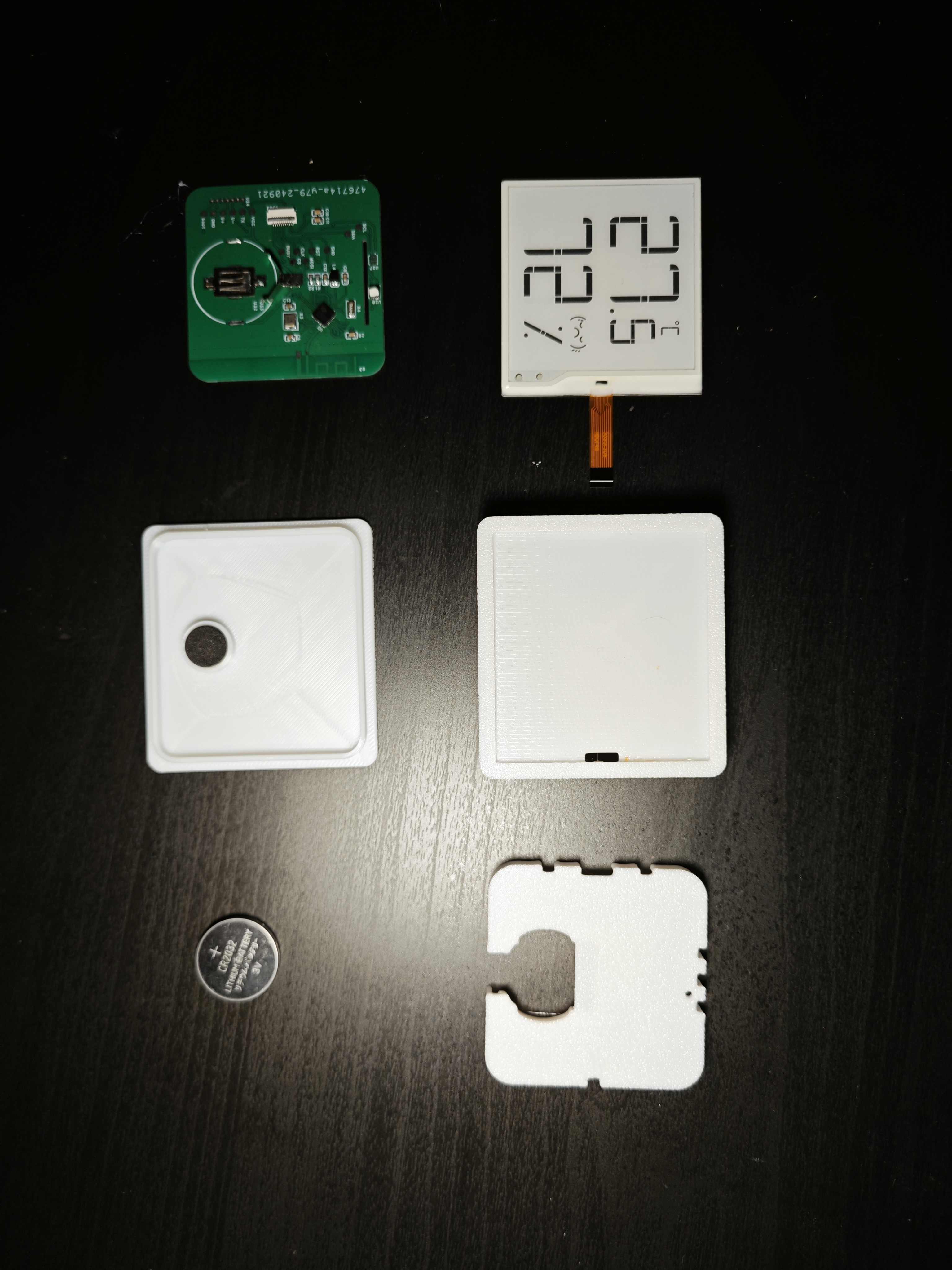

Assembly Process:

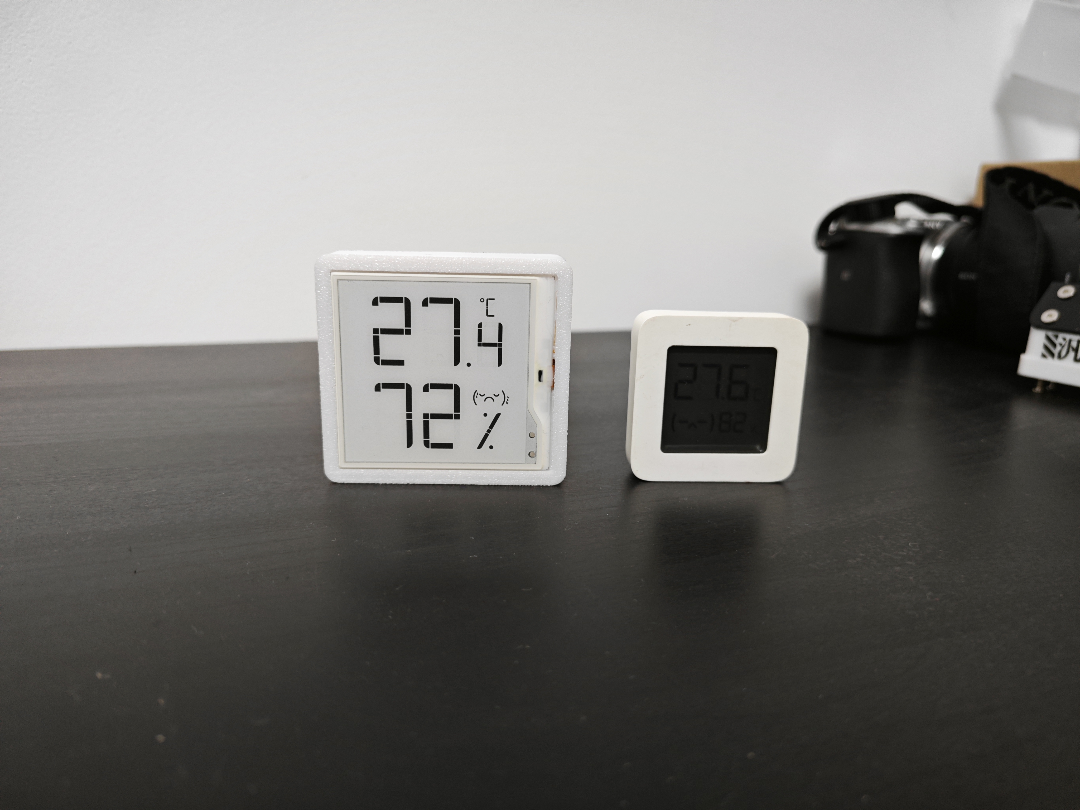

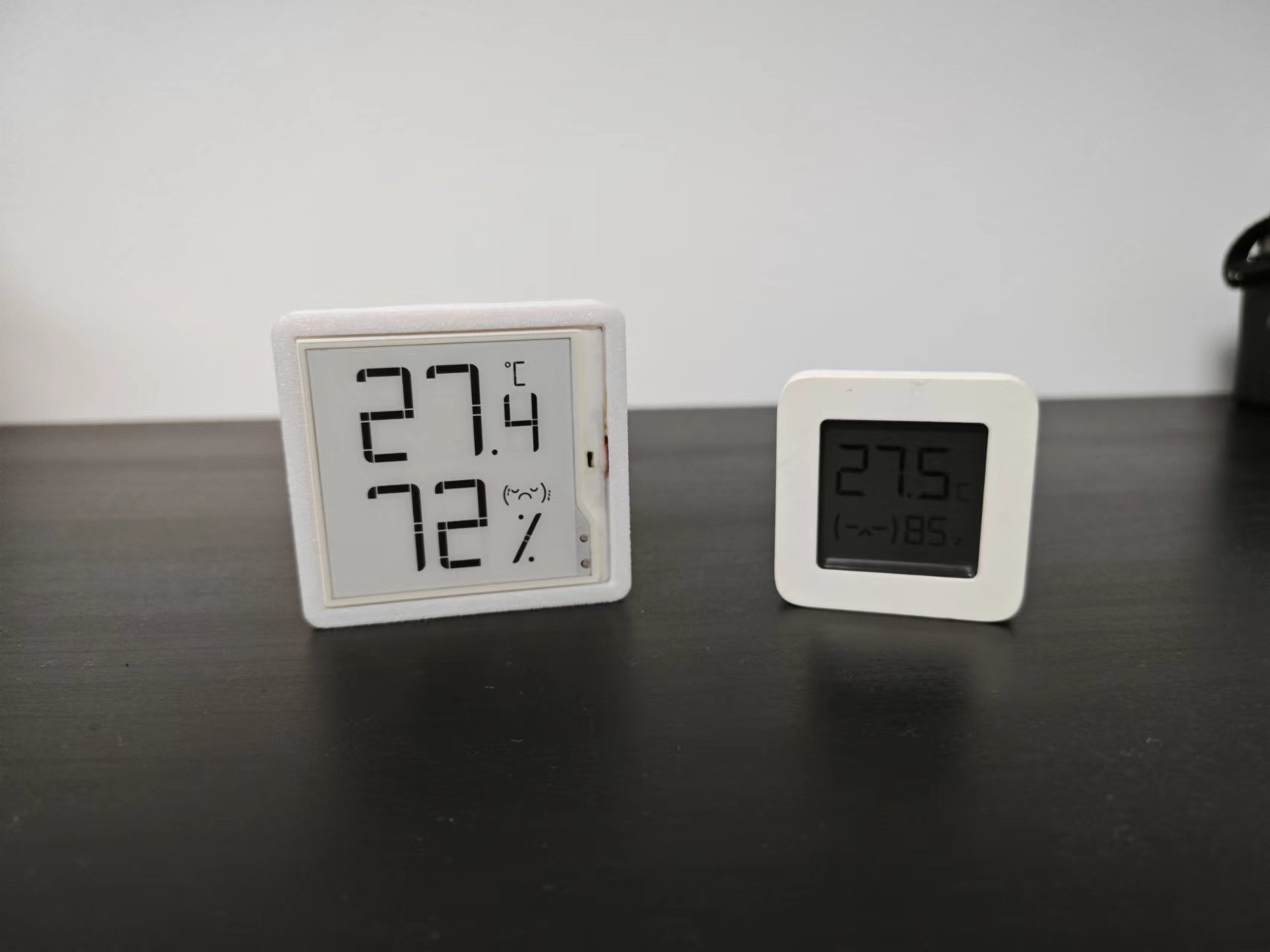

The outer shell is 3D printed, and a suspended design is used to accommodate the screen in the front panel. Different materials are recommended for the support during printing to ensure a flat screen recess. I used a PLA body with a PETG support surface.
The middle PCB clamp uses an interference fit to hold the main body in place, and the back cover uses four-sided clips. However, because it's 3D printed, the lifespan of these clips might be short.
The front panel is covered with a transparent acrylic protective e-ink screen. The acrylic dimensions are 59.8mm*55.8mm, with a 7mm rounded corner diameter and a 2mm thickness, and it can be attached with UV glue. Anyway, the 3D shell isn't expensive and can be easily disassembled. Compared to Xiaomi's LCD screen, the actual product is a complete knockout.

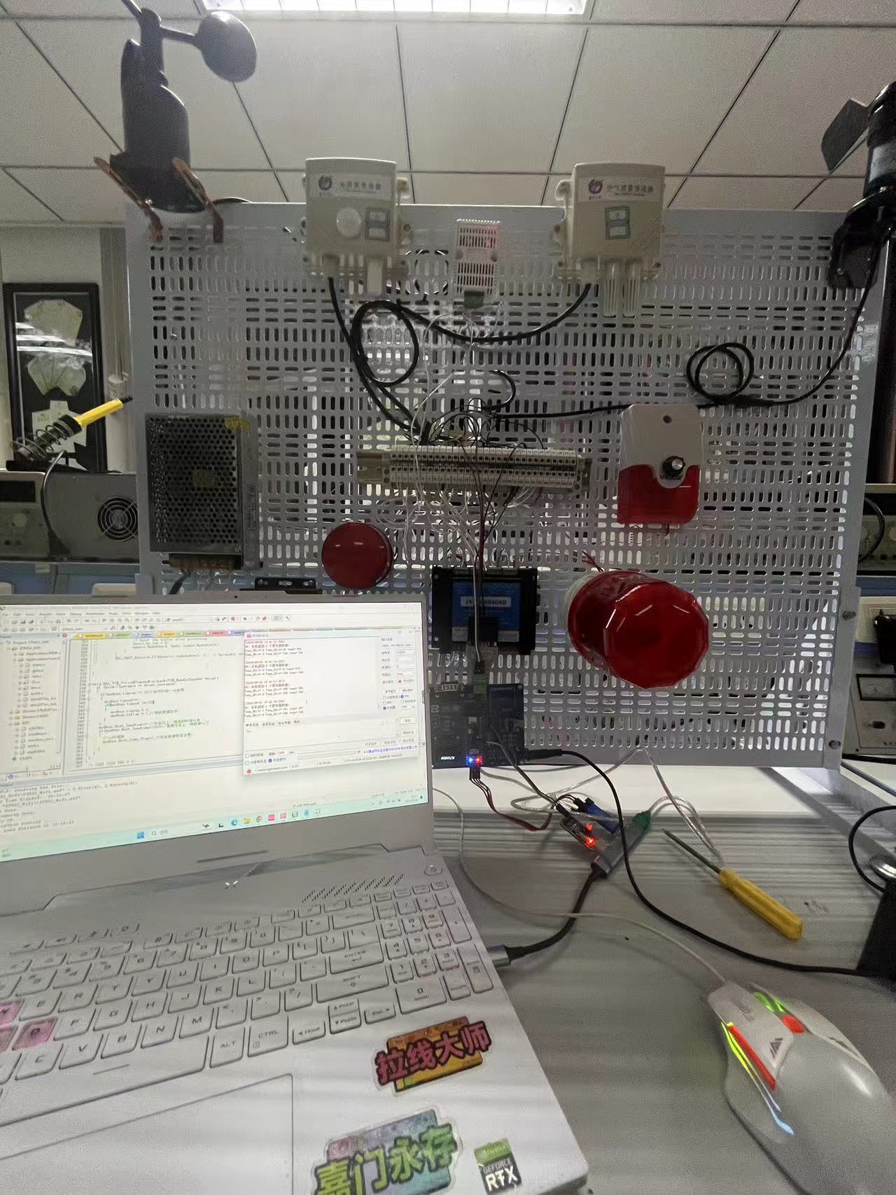

These are recent photos of debugging Modbus polling. This project will replace our current industrial gateway. The initial design purpose was that the gateway required a network cable, and it wasn't suitable for demonstration projects at the university, so we simply designed a small DTU-like design ourselves.
