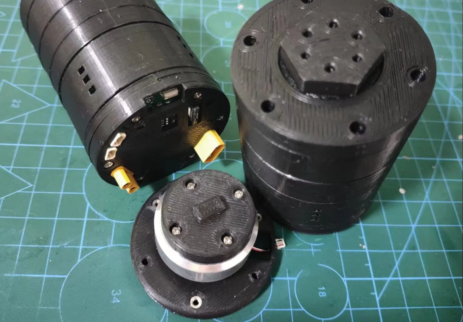

Preface:
While browsing the LCSC Open Source Plaza, I came across a project by an up-loader called "Articulated Motor Based on STM32F103" (https://oshwhub.com/blufis/stm32f103foc). I was also interested in playing with brushless motors and decided to replicate it. The replication process went very smoothly (thanks to the up-loader for the helpful links to all the materials mentioned in the article). However, I wasn't satisfied with the reduction ratio of the articulated motor. So, I found a brushless lithium-ion drill gear set on Taobao that seemed perfect, which led to the following thoughts. This is my first time writing an article, so please forgive any shortcomings.
I. Final Product

1. Purchased Components
1) Brushless Motor:
Note*: You can choose to purchase a motor with the limit switches removed to avoid further processing. If you want to save costs, you can remove the limit switches yourself. You can refer to this video: https://www.bilibili.com/video/BV1Qu4y197b8/?spm_id_from=333.337.search-card.all.click
https://item.taobao.com/item.htm?spm=a21n57.1.item.1.196f523ceookt4&priceTId=213e384f17182375364595137ec385&id=734772197083&ns=1&abbucket=3&skuId=5250189662223
2) Gear Set:
This gear set has a reduction ratio of 65. (Not calculated, so it may not be accurate) A reduction ratio of 15 can be achieved by removing gears. The clearance is a bit large, but it's acceptable for DIY, mainly because it's cheap.
https://item.taobao.com/item.htm?spm=a1z09.2.0.0.77ab2e8dC4MEGH&id=731331023966&_u=e37u5r42fe3c&skuId=5234350022380
3) Screws and nuts,
m2 30 (several),
m2 18 (several
) 4) Bearings 6703ZZ, dimensions (17, 23, 4), quantity x2
2. 3D printed parts
see attachments
: 1. Output connector cover plate 2. Bearing 3. Output adapter 4. Large size secondary output side housing 5. Gear set - secondary output planetary carrier 6. Gear set - tertiary planetary gear 7. Gear set - secondary fixed gear 8. Baffle 9. Gear set - primary planetary carrier 10. Gear set - secondary planetary gear 11. Gear set - primary fixed gear 12. Primary input side housing 13. Gear set - First stage input sun gear 14. Gear set - First stage planetary gears 15. First stage input side housing 1 16. Bearing 17. Gear set - Input gear 18. Input end fixed to the input gear 19. Motor housing 20. Reducer and motor connection 21. 3205B motor 22. Motor bracket 23. Motor drive board 24. Rear cover

The entire digging process uses a 65 reduction ratio joint to make a robotic arm, but the end effector can only drive 0.5KG. I plan to try using a ready-made 139 reduction ratio joint for the 1 and 2 axis joints.
