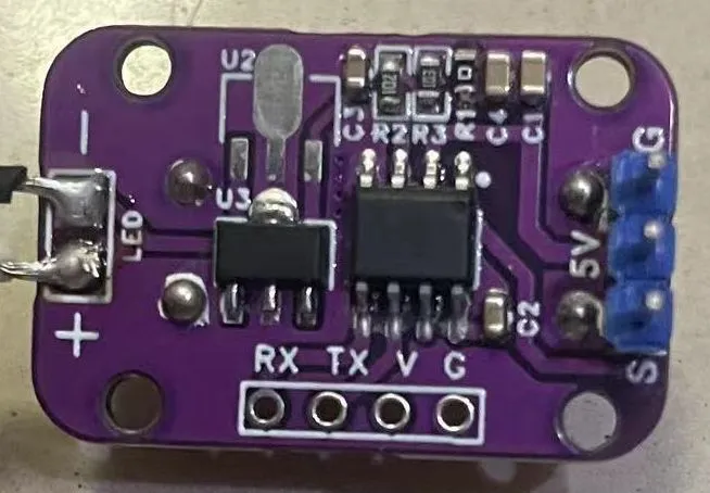

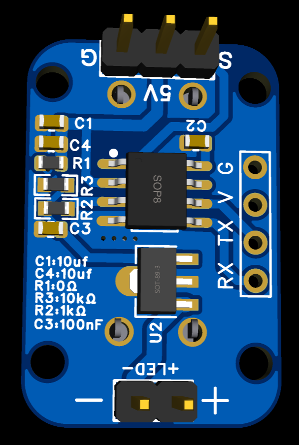

Based on Xiaoyu's handheld high-powered hair dryer MAX push-button speed controller, this project modifies
and adds a breathing light function (breathing light in standby mode, switching to high brightness when the high-powered fan is activated).

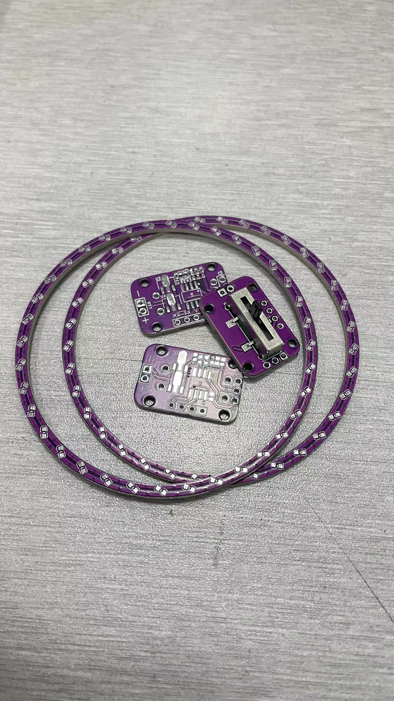

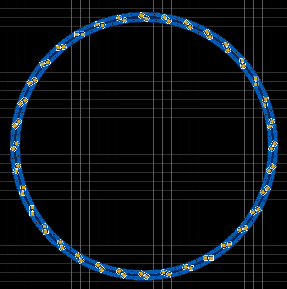

The circuit uses a common flashlight constant current driver chip: AMC7135, which has a 350mA constant current capability and is powered by the BEC output of the brushless ESC. The circuit board shown on the cover is for debugging purposes (given the current parameters of the LEDs purchased from Taobao, I only soldered one). The LED board has also been redesigned, consisting of 36 0603 ice blue LEDs connected in parallel. Please see the attached video for the actual effect.
