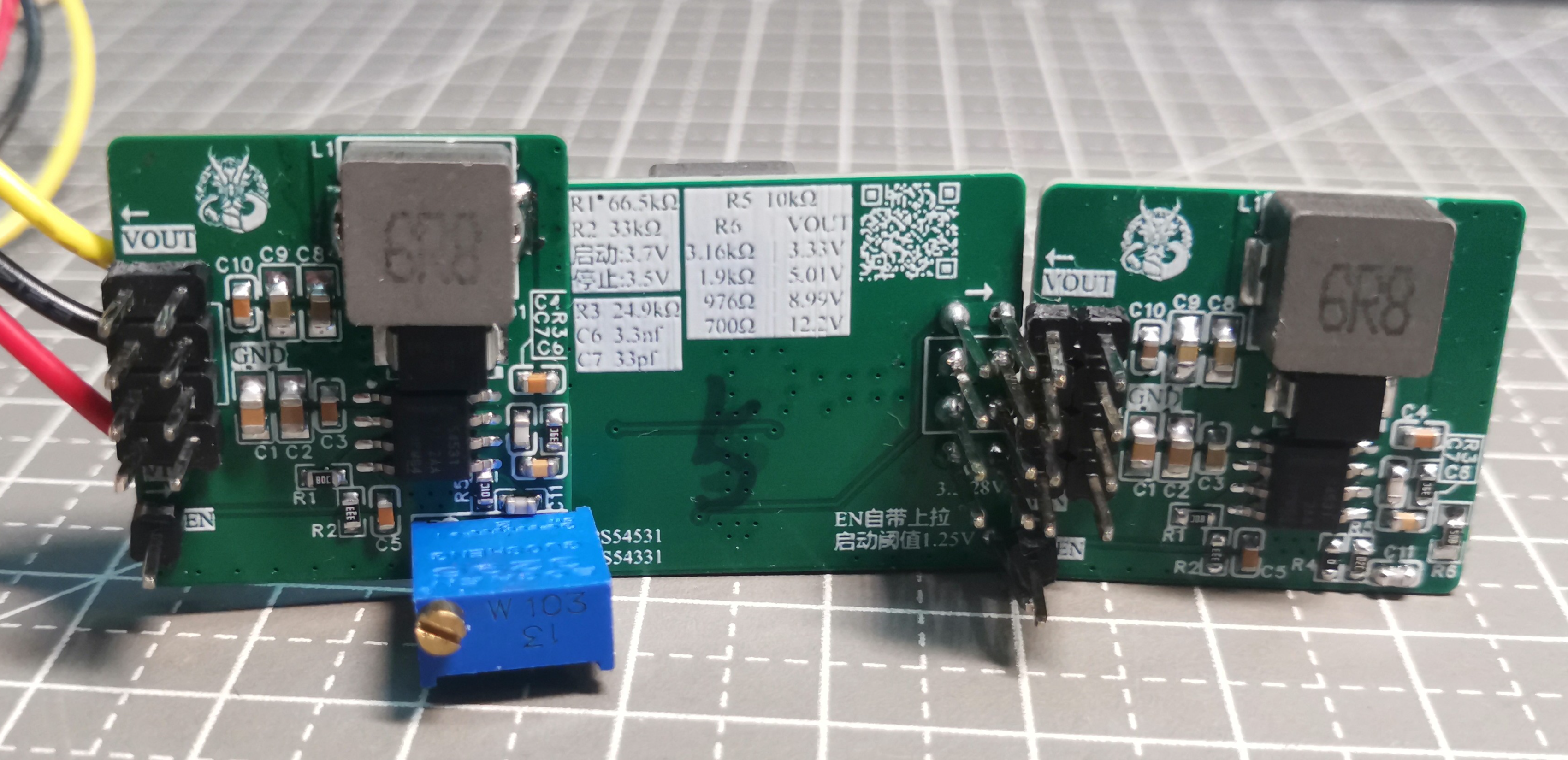

TPS54531 step-down module
Preface:
This module uses the TPS54531 asynchronous rectifier buck converter chip, compatible with other chips with the same pinout and functions, such as the TPS54331. A
smaller 54531 module design is already available on this site: https://oshwhub.com/fanghaoling/tps54531-dian-yuan-mo-kuai.
However, I don't need a very small size, and my previous attempt to use a half-hole connector failed. Therefore, I redesigned it based on Tang's 54331 design and the layout in the datasheet, adapting it to my needs, and also added a version using adjustable resistors.
Tang's videos are available for those interested .
PS: The datasheet can be viewed in conjunction with the 54331 datasheet, which is available in Chinese.
PPS: This chip seems to have low efficiency; at 12V to 3.3V, the efficiency is close to 80% at 1A output. I haven't tested other chips, so I don't know their efficiency levels.

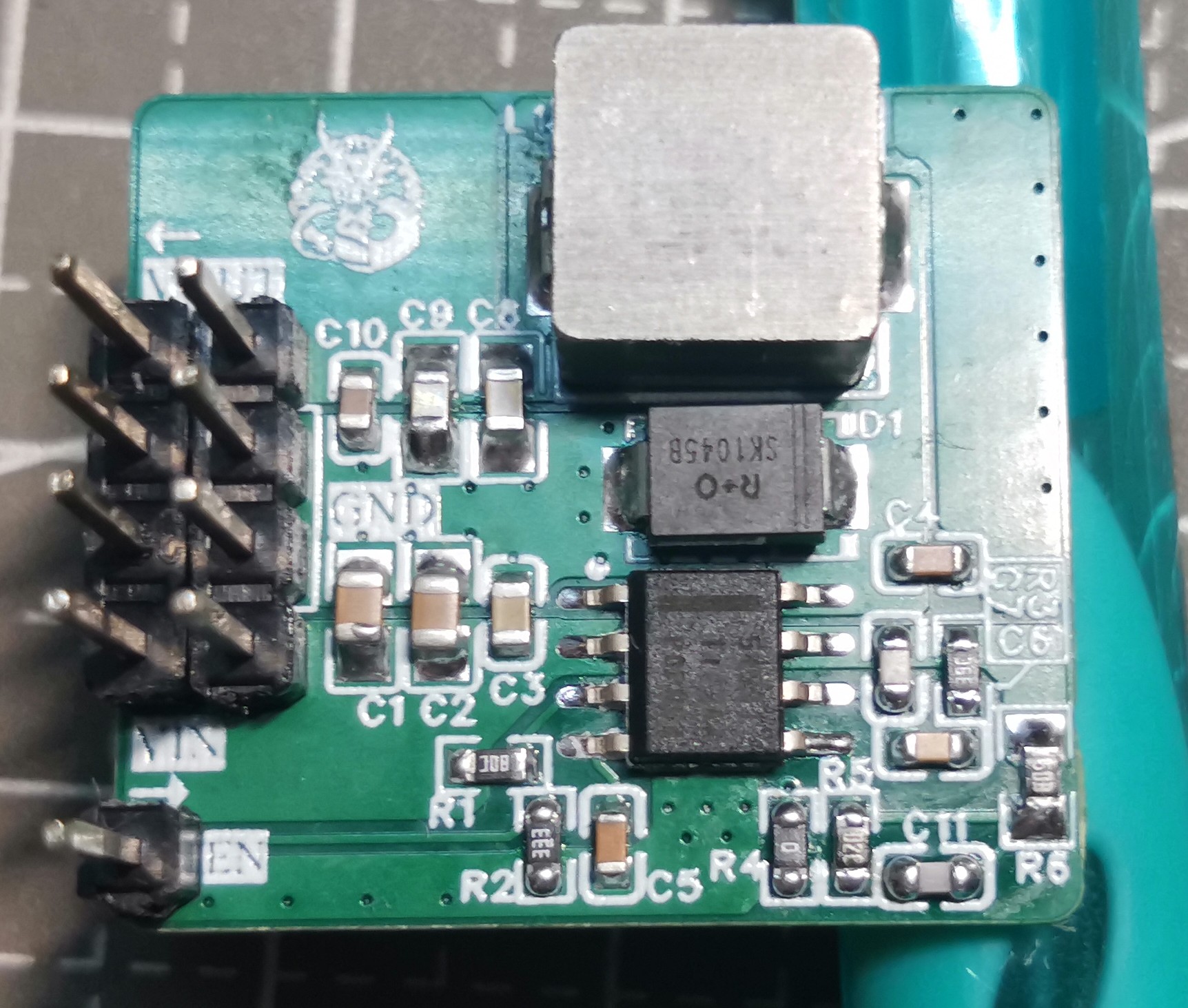

Important Notes:
The input capacitors may require larger capacitance. During testing (12V step-down to 5V, maximum output around 3.4A), although the output ripple remained low, the input ripple exceeded 900mV, far exceeding the 300mV stated in the datasheet. Using two 10uF + 47uF capacitors in parallel improved the input ripple.
The datasheet states that the 54531 can output 5A current, but it generates significant heat above 3A. For high-current applications, it is recommended to modify the PCB, increase the area, use larger connectors for input and output, and add heat dissipation.
The stable output voltage has an upper limit depending on the input voltage; component selection will affect this limit. With the components I used, the maximum output was 9V with a 12V input and around 3.6-3.7V with a 5V input. Therefore, it is impossible to power a 3.3V microcontroller with a lithium battery (I originally wanted to choose a wide voltage range, supporting both lithium batteries and PD). (This is a 28V step-down chip. Results...)
Avoid touching the voltage feedback interface and inductor with your hands during use, as this will increase ripple and even cause voltage fluctuations. Please test the effects of contact with other objects yourself.
Do not reverse the input and output pins! Reversing them under load will burn the chip; I haven't tested reversing them under no load (it will kill you if you try).
Please pay close attention to the capacitor's withstand voltage! In
the finished product diagram,
if not needed, the components connected to the EN pin and slow-start pin can be left unconnected. C11's function is not described in the datasheet; based on other chip datasheets, it is speculated to optimize transient response. It is generally a pF-level capacitor; please choose based on your experience, and it is generally not necessary to connect it.
The required capacitor and resistor values ​​for some commonly used voltages are marked on the schematic diagram. You can also use the attached table to calculate them (my professional knowledge is insufficient, and the calculation results are for reference only).
Below is the standard non-adjustable voltage version:
Below is the adjustable voltage version:
When soldering the adjustable resistor in the direction shown in the diagram, clockwise increases the resistance (decreases the voltage), and counterclockwise increases the voltage. If a very small output voltage is not required, a 10kΩ adjustable resistor can be selected. The
test

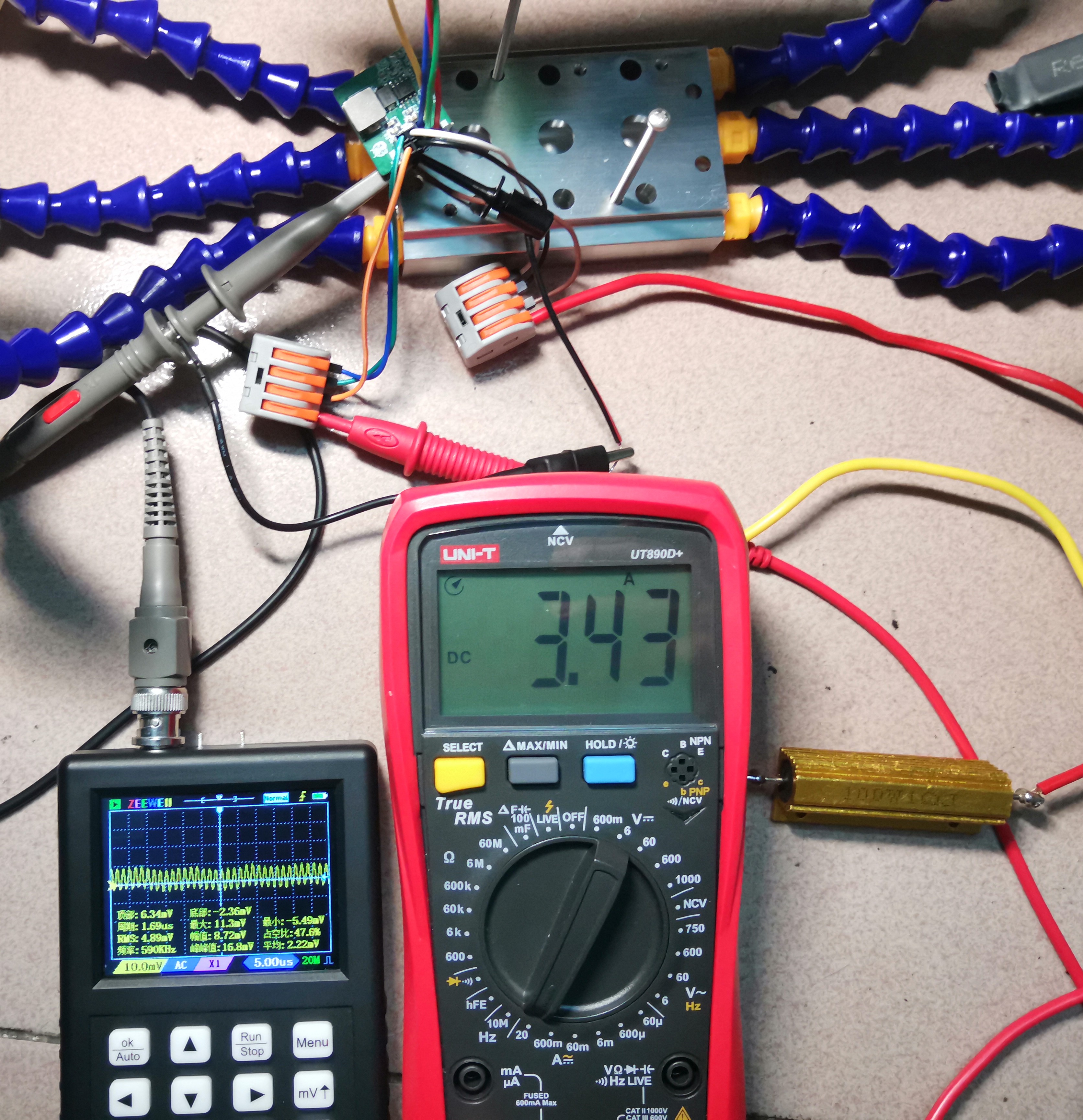

conditions were rudimentary and are for reference only.
With an input of 12V and outputs of 5V and 3.3V, using a resistor as a load, the maximum tested output current was 3.4A. The output ripple was generally below 20mV, with a maximum of less than 30mV. Higher currents would cause significant heat generation, so further testing was not conducted. Because the probe did not use a spring-loaded pin, the actual ripple is theoretically even smaller.

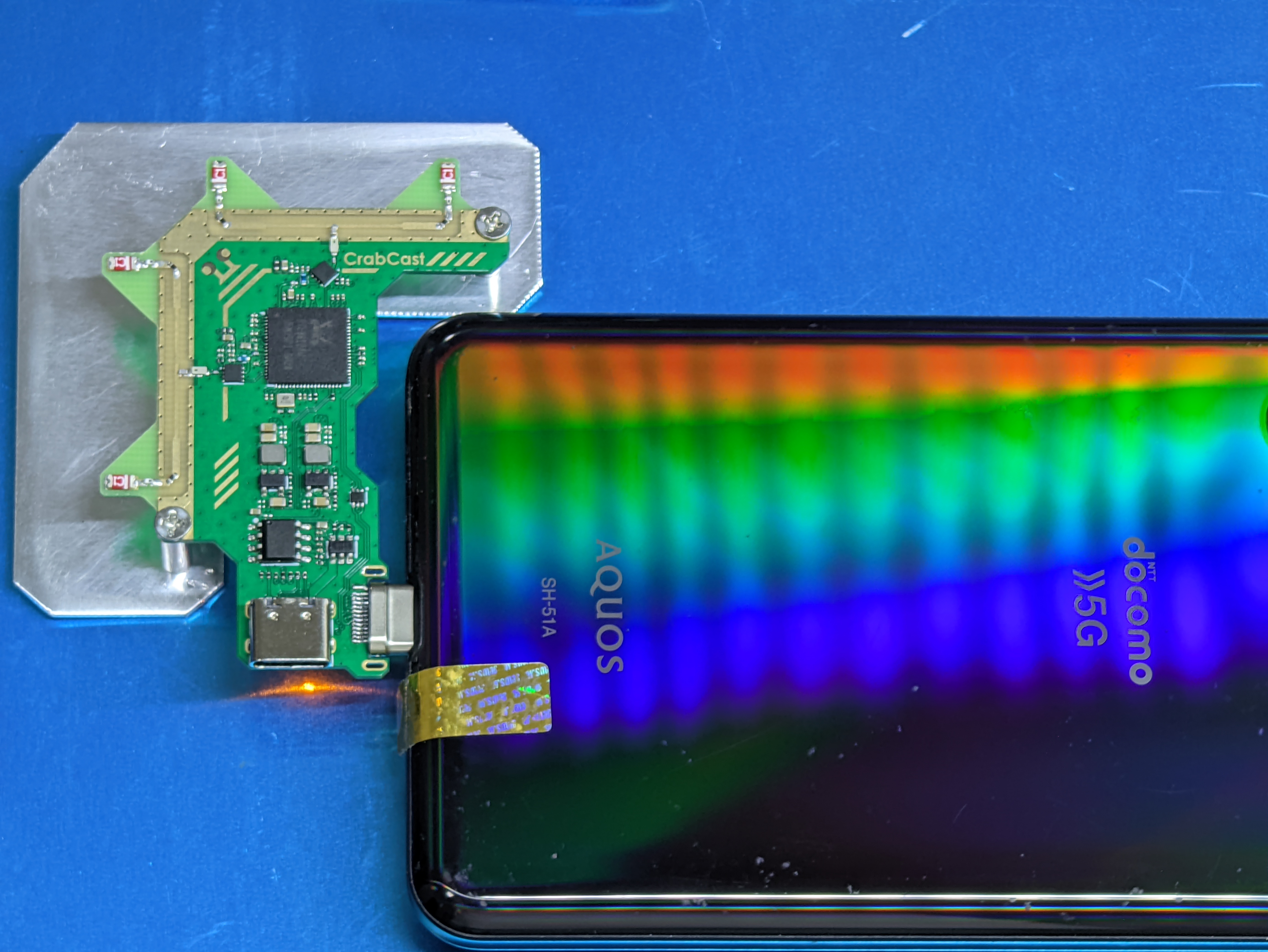

CrabCast V1.0
The RTL8812AU+LNA 5GHz band only receives signals from directly plugged-in mobile phone network cards.
Foreword:
This design is for tinkering, learning, and technical exchange only.
No guarantees are made regarding the final effect.
Production use is not recommended.
The author will not be responsible for any losses incurred.
It is not recommended to build without a VNA, although this may not be necessary in practice.
Chip inconsistency may be poor, and your final result may differ.
Regarding the antenna, since the manufacturer does not provide more information (and is unlikely to), the array effect is entirely based on guesswork and mental testing. Of course, my own testing has shown some effect, but there are no guarantees.
The antenna is a religious subject; I respect and tolerate your beliefs, and I hope you can accept that others are different from you. Thank you.
The wiring is a random drawing; please be gentle.
Open source license: CC BY-NC-SA 4.0 (NC = Non-Commercial).
The crabs on the back are the actual Crab™ logo; please do not misuse this logo when replicating.
My board is purely a personal project for educational purposes and does not involve any commercial use. If it still infringes on your rights, please contact me to remove the silkscreen from the board.

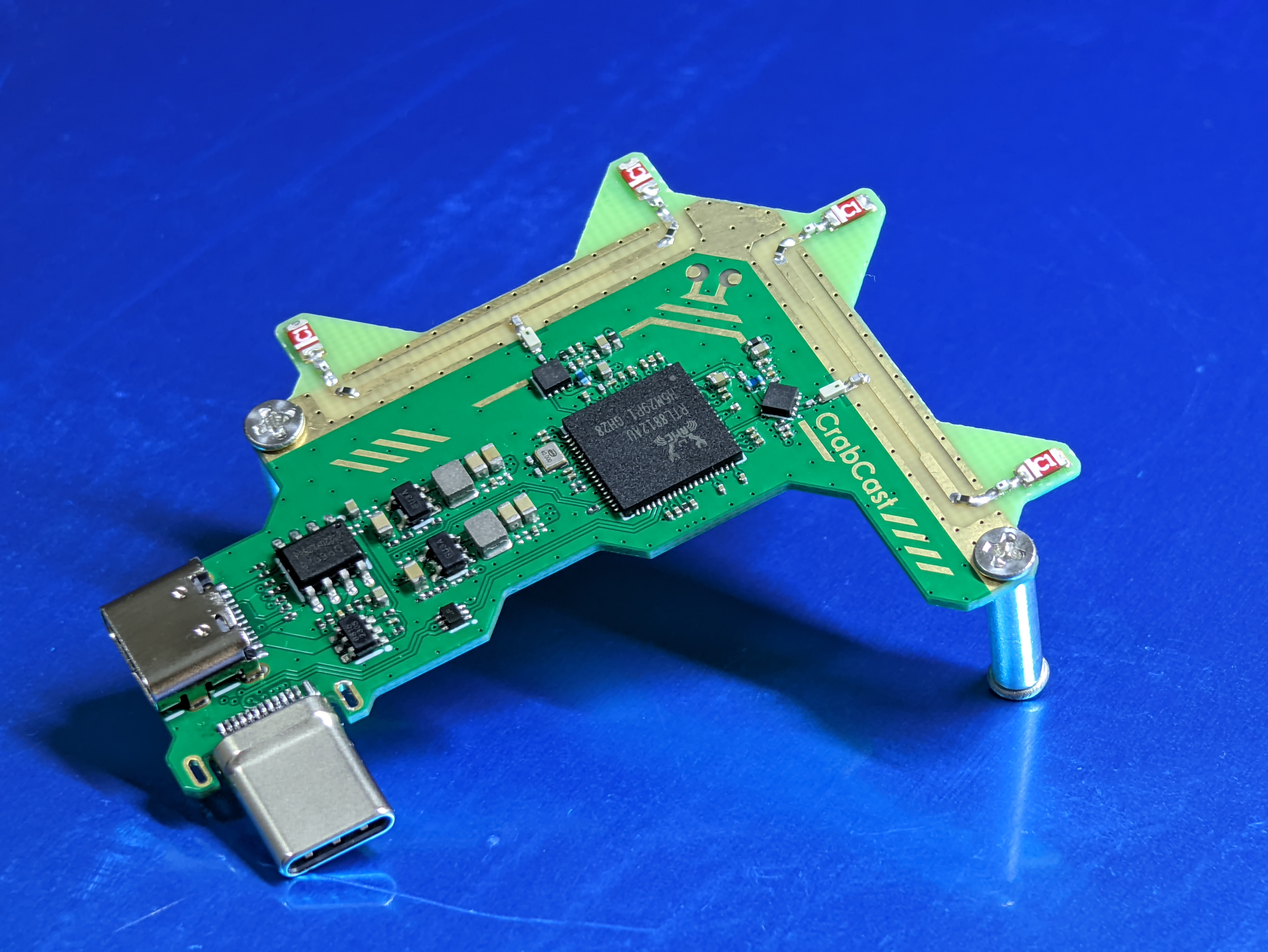

What is this
RTL8812AU pure receiver network card?
Its design goals are: 1. No external antenna required; 2. Small size, direct connection to a mobile phone without causing poor interface contact due to excessive weight; 3. Decent reception performance and slight directionality; 4. Can power the phone and also (slowly) charge it; 5. Cost should not be too high.
RF front-end: 5.15~5.85GHz bandpass filter (I used LCSC C2442150, for reference only, but it can be replaced) + QPL9503 LNA, 2 sets in total; does not support 2.4G band.
Antenna: OA-C01, 2 pieces per channel combined (4 pieces in total), two channels RX 90° placement, optional external reflector.
Data: Type-C male connector for direct connection. Power
supply: Another Type-C female port supports 5W input for simultaneous use and charging, with chip-based automatic PD role switching.
PCB/BOM
: JLC. 4-layer 7628 (the one you can get for free), 0.8mm total thickness, immersion gold, remember to select the 20% impedance option. Place the QR code in the designated position on the front, below the USB box. Order
components according to the component values ​​in the schematic. You can order from LCSC Mall/Taobao. Some components can be replaced yourself depending on your understanding of the circuit. For
dual PMOS, you can choose a similar Rdson model, since this board only has 5V. If they are out of stock, you can find a model to replace it with
RTL8812AU. It's best to buy an efuse chip without data (brand new?). If it has data, it may affect the LNA enable control. If you unfortunately buy one with data, then refer to the software settings/driver modification/Realtek documentation for programming, etc.
I bought a used one from here. I bought an empty efuse chip for RTL8812AU from here in early September 2024. This is for reference only, and I make no guarantees.
All capacitors marked TBD in the schematic are the kind that... can be used without soldering, and soldering them on the power supply will make it cleaner... If you're soldering, I recommend soldering several capacitors of varying sizes that you have on hand. For
the Type-C male connector, you can apply two blobs of solder to the adjacent pads to increase strength.
Besides the components shown in the schematic, if you need a reflector to slightly increase directivity, you'll need to buy some aluminum plates, cut and drill holes yourself, or draw a PCB of a suitable size with only copper plating, and fix it with M2 screws and studs (reference range: approximately 9mm~12mm, adjust according to actual conditions). See the image below;
the RTL8812AU generates considerable heat. You can
use it with a heatsink
. It's a receiver-only network card, so it can't be used as a regular Wi-Fi network card.
Compared to a standard RTL8812AU network card, since efuse is likely empty, you may need to modify some parameters to make the driver work correctly.

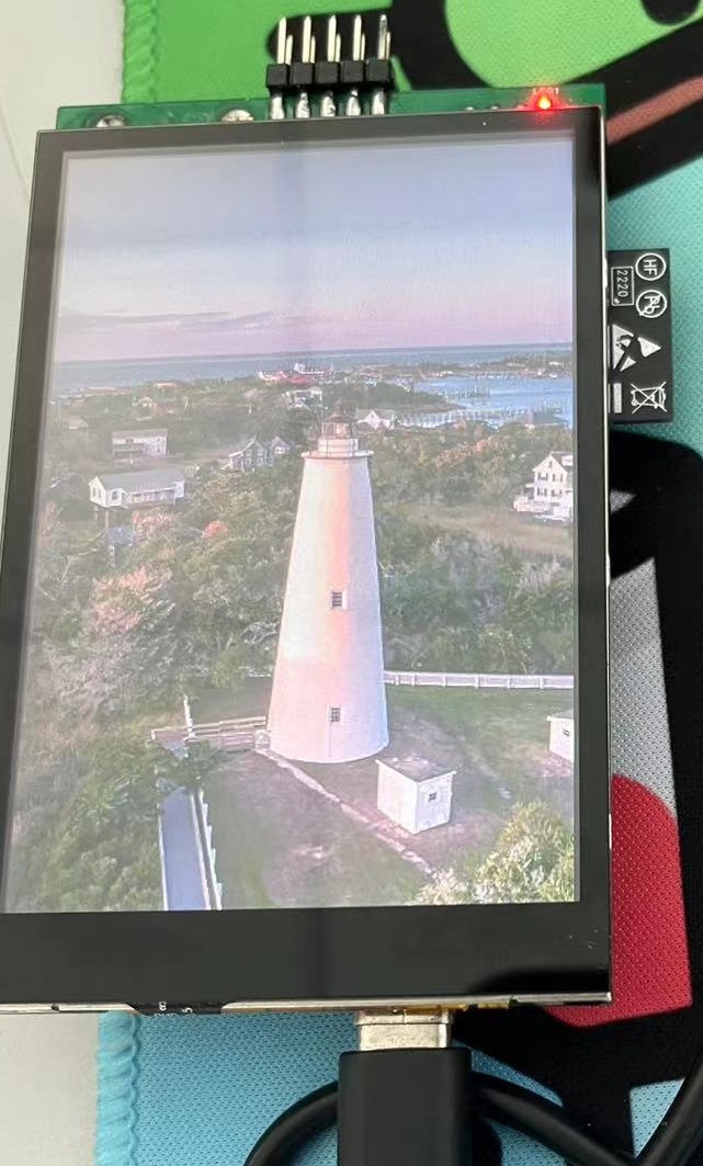

The ESP32-S3 desktop terminal features a 3.5-inch IPS screen with 16-bit driver and capacitive touch support. It is equipped with an INMP441 omnidirectional microphone module and a MAX98357 audio amplifier chip for audio processing.
Project Overview:
The ESP32-S3 desktop terminal features a 3.5-inch IPS screen with capacitive touch support.
It utilizes an INMP441 omnidirectional microphone module and a MAX98357 audio amplifier chip for audio processing.
It can retrieve and display or play audio data such as weather and time from the network.
Project Functions:
Network Interaction (Internet Connection),
Screen Display (Bing Wallpaper)
, Audio Playback (Under Development).
Project Parameters
: This design uses a 3.5-inch IPS screen with 16-bit driver and LVGL display.
The INMP441 omnidirectional microphone module is used for audio processing.
The MAX98357 audio amplifier is used for sound playback.
The ESP32-S3's built-in USB port can be used to develop USB devices such as flash drives.
Developed using Arduino,
the developed functions include: Wi-Fi networking, Bing wallpaper display, and USB
flash drive functionality. Functions to be developed include: internet radio, offline CD/DVD burner, etc.
