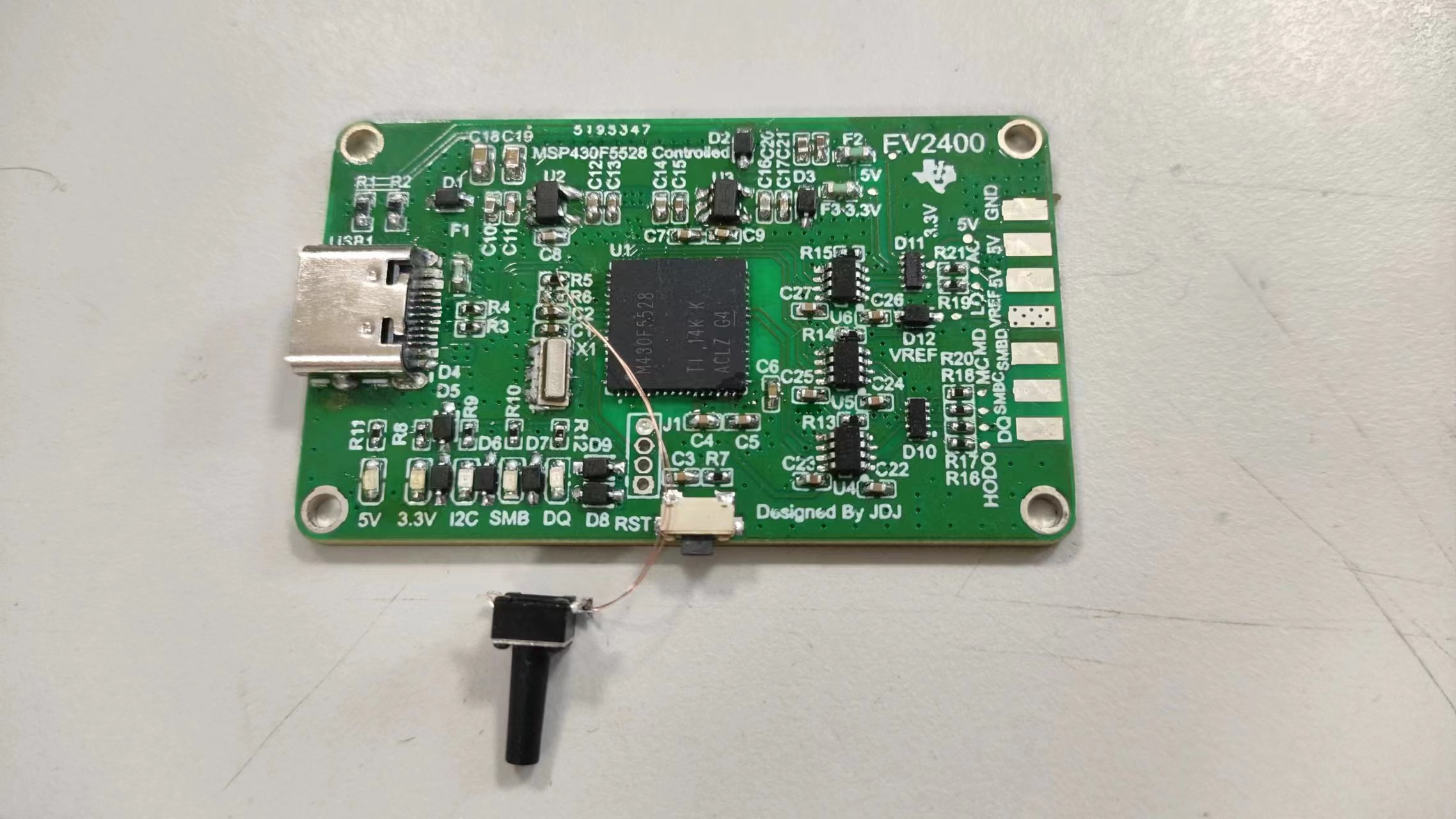

(Note: Some people online have also found that the F5528 (average price around 10 yuan) can be used as a substitute, and there are related solutions. However, I have verified this myself. I bought four chips from different stores, and they either didn't have the core voltage, the crystal oscillator didn't oscillate, or they could only be flashed but couldn't run. There were too many bad products. I spent 40 or 50 yuan on chips but didn't get a single usable one. It's better to just go for the 5529; at least genuine ones are easier to find.) (I'm begging for a reliable source so I can finally put a perfect end to this board that I've been working on for two weeks.)
24/9/20: The 5528 version is now complete and open source. Open source address: [Verified] EV2400-Lite based on F5528 [Not recommended for replication] -
It's important to note that using the LCSC open-source hardware platform (oshwhub.com) with the 5528 is not recommended due to the high cost of genuine products and the prevalence of refurbished and

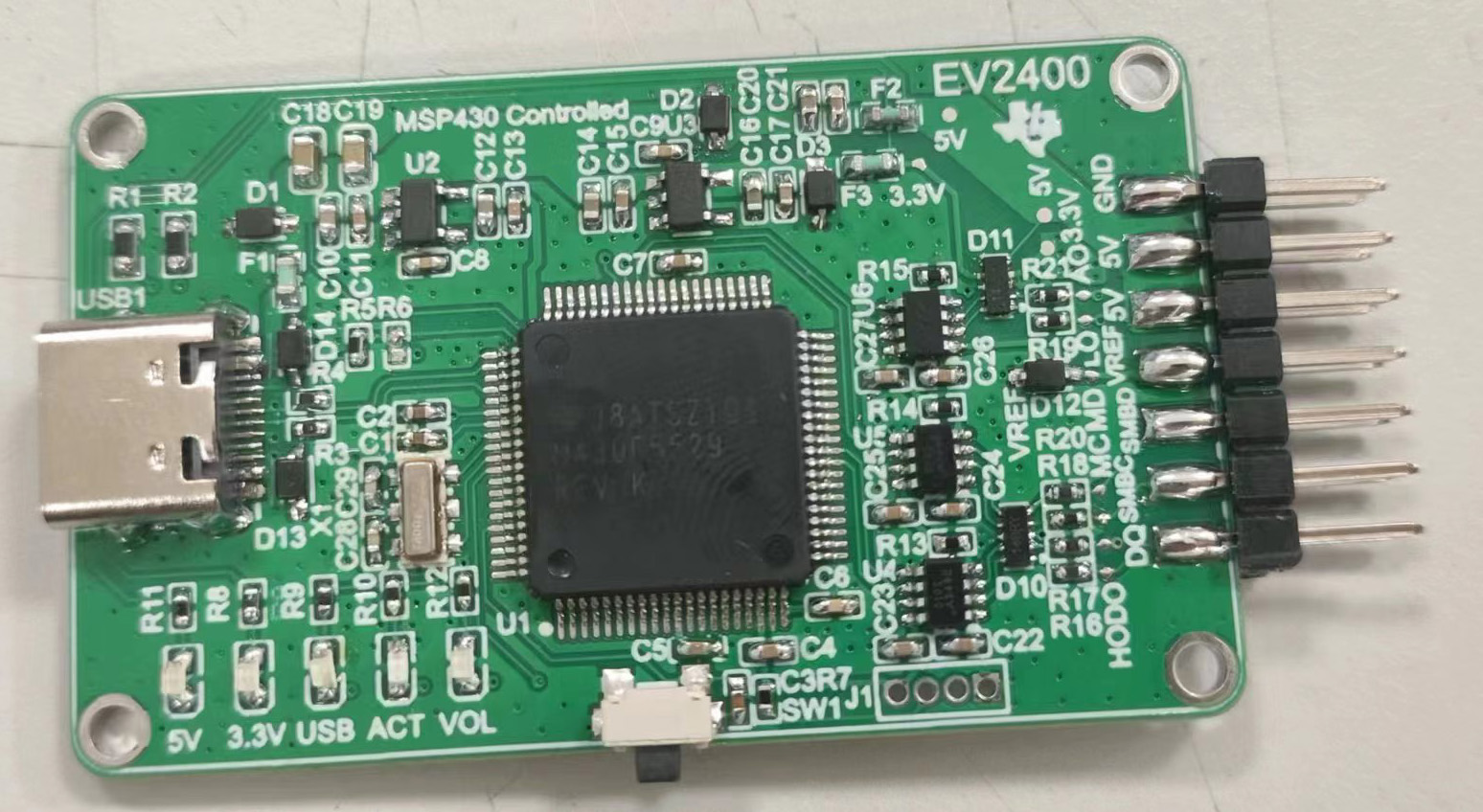

2. PCB Design:

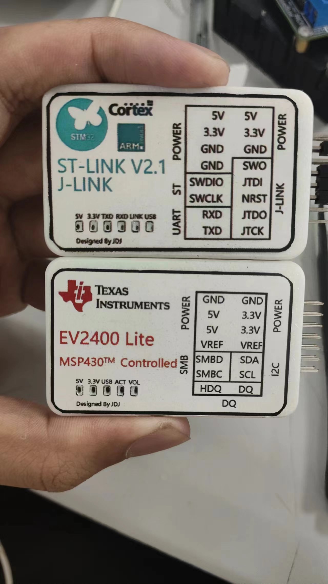

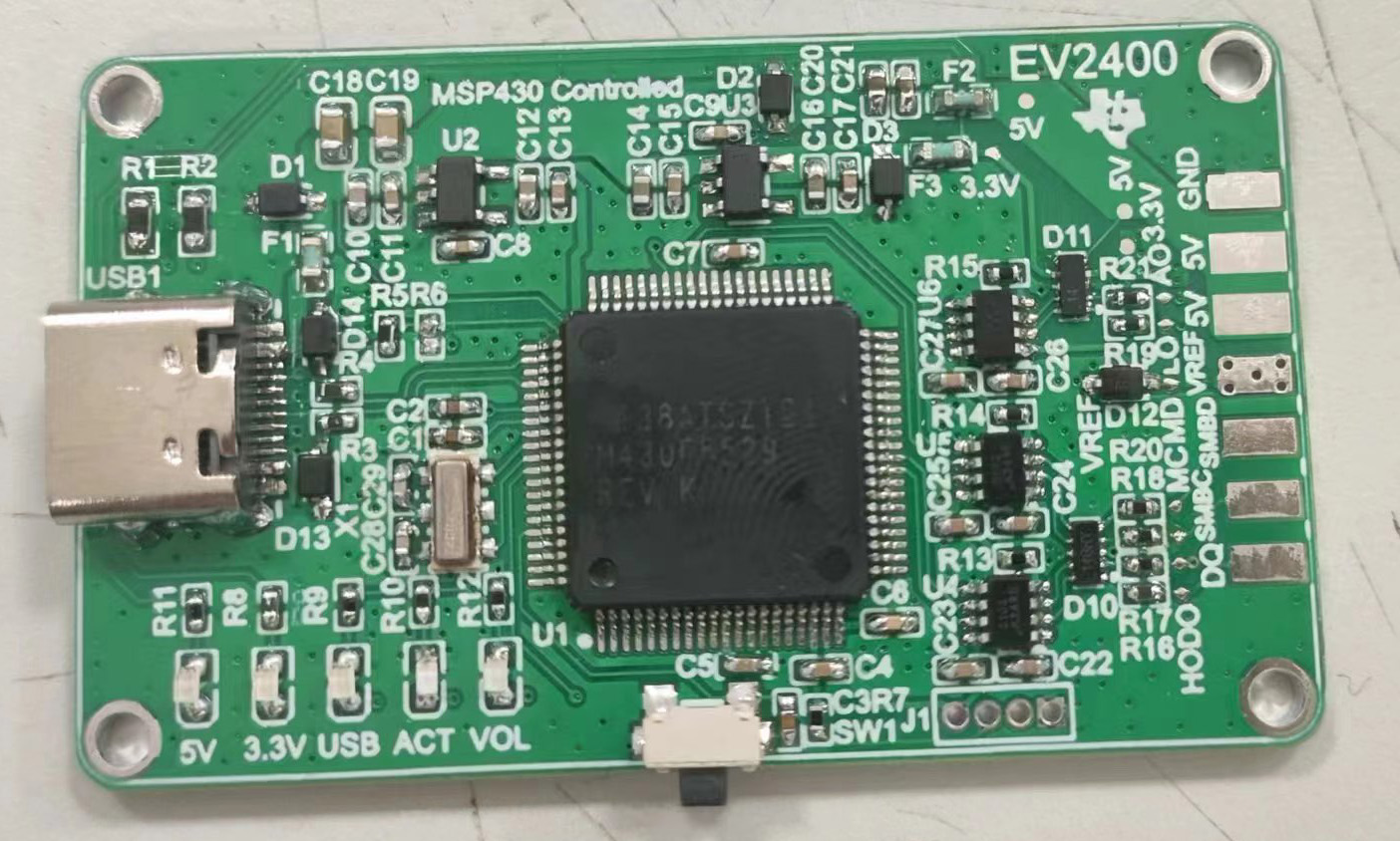

           The same board type as the previous ST-LINK was used, so the outer shell file only needed minor modifications to be usable (actually, it's just laziness []~( ̄▽ ̄)~* (slacking off,
so satisfying!)). The direct-output design means the USB socket, debugger, and debug cable form a straight line, taking up less space. (If you're interested in that ST-Link, here's the link.) ((As an aside, while browsing the MSP manual recently, I found some tutorials from TI on porting STM chip programs to MSP series microcontrollers—stealing ST's talent, haha!) It's true that red and blue are a perfect match! ヾ(≧▽≦*)o)
Since the 3.3V power supply is mainly used as a reference level this time, an LDO was used instead of a DC-DC converter to provide 3.3V.
3. Soldering & Debugging & Assembly:
          There's not much to say about this. Component selection and soldering are basic skills. Anyone who uses this equipment should be proficient in these areas, so I won't presume to teach you. (Here are two pictures of the soldered components:)
However, I still need to mention a few things about component purchases:
MSP430F5529IPNR purchase link: MSP430F5529
level conversion chip purchase link: RS0102YH8
protection diode array: TPD4E05U06DQAR
The above components are just my purchase channels, provided for your DIY convenience only. I do not guarantee the lowest price links, and only indicate that the components were usable at the time of my purchase. This is not an advertisement.

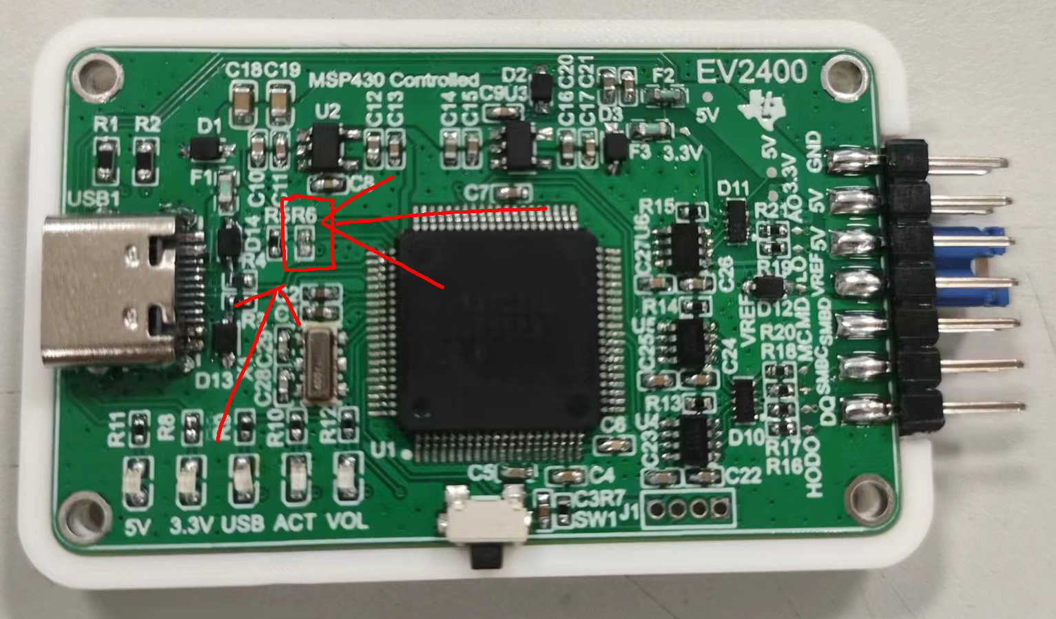

Debugging – Firmware Download (Important!!!)
        If the chip you receive is new, it will not have any internal program. If it is a salvaged chip, it will have unnecessary program. You can't just buy an eZ-FET to download the program just to build an EV2400, right? No worries, TI provides an even more convenient method – downloading via the MSP430F5529's USB-BSL mode.
        In simple terms, this mode is equivalent to redefining the pins used for SWD in STM32. To download a program again, you can only do so by setting the microcontroller to UART download mode during a reset using the high and low levels of BOOT1 and BOOT0, and then burning the program through the UART1 port. The MSP430F5529 will detect the level of the USB-PUR pin during a reset. If it is pulled high, it enters USB-BSL mode, reports itself as a USB device, and reports its specific VID and PID. The host software detects the presence of the microcontroller by detecting the VID and PID and performs a full erase and write of the new program to the microcontroller via USB. With
        the theoretical analysis complete, here are the practical steps:
First, download the EV2400 updater from the TI website (currently the latest version is 0.32), or you can download it from the firmware section at the end of this article. After downloading, as shown in the image: Right-click and select "Run as administrator." After installation, a "TI" folder will appear on your C drive. Locate the folder named "EV2400Updater-0.32" inside. The first file in the folder contains our programming program . However, if you directly open it, you'll find that it says it doesn't find the EV2400. This is normal; our EV2400 hasn't been programmed yet. We need to pass parameters to this program so it knows to program a chip that doesn't have a program yet. Right-click the program, select "Create Shortcut," then right-click the created shortcut, click "Properties," type a space after "Target," and then enter "-s." Click " Apply" and then "OK." Now, plug your soldered EV2400 into the computer. Use tweezers to short-circuit the two shorting points shown in the diagram (the two ends of silkscreen R6). Then, and this is crucial: while maintaining the short circuit, press the reset button. Release the reset button and immediately remove the tweezers. You should hear a device connection beep on the computer, but no new device will appear in Device Manager, indicating that the computer has recognized the chip. Double-click the shortcut you just created. The software should then indicate that it is erasing, and the computer should emit a device pop-up beep. After the software finishes running, re-plug the chip or press the reset button. The computer should emit another device insertion beep, and all three blue LEDs should light up, indicating that the programming is complete. (Note: If you short-circuit the tweezers to R6 for an extended period, the computer will also emit a device insertion beep and display an unknown device message. This is normal and can be ignored; simply start the process from the beginning. It is not a hardware or chip issue.)

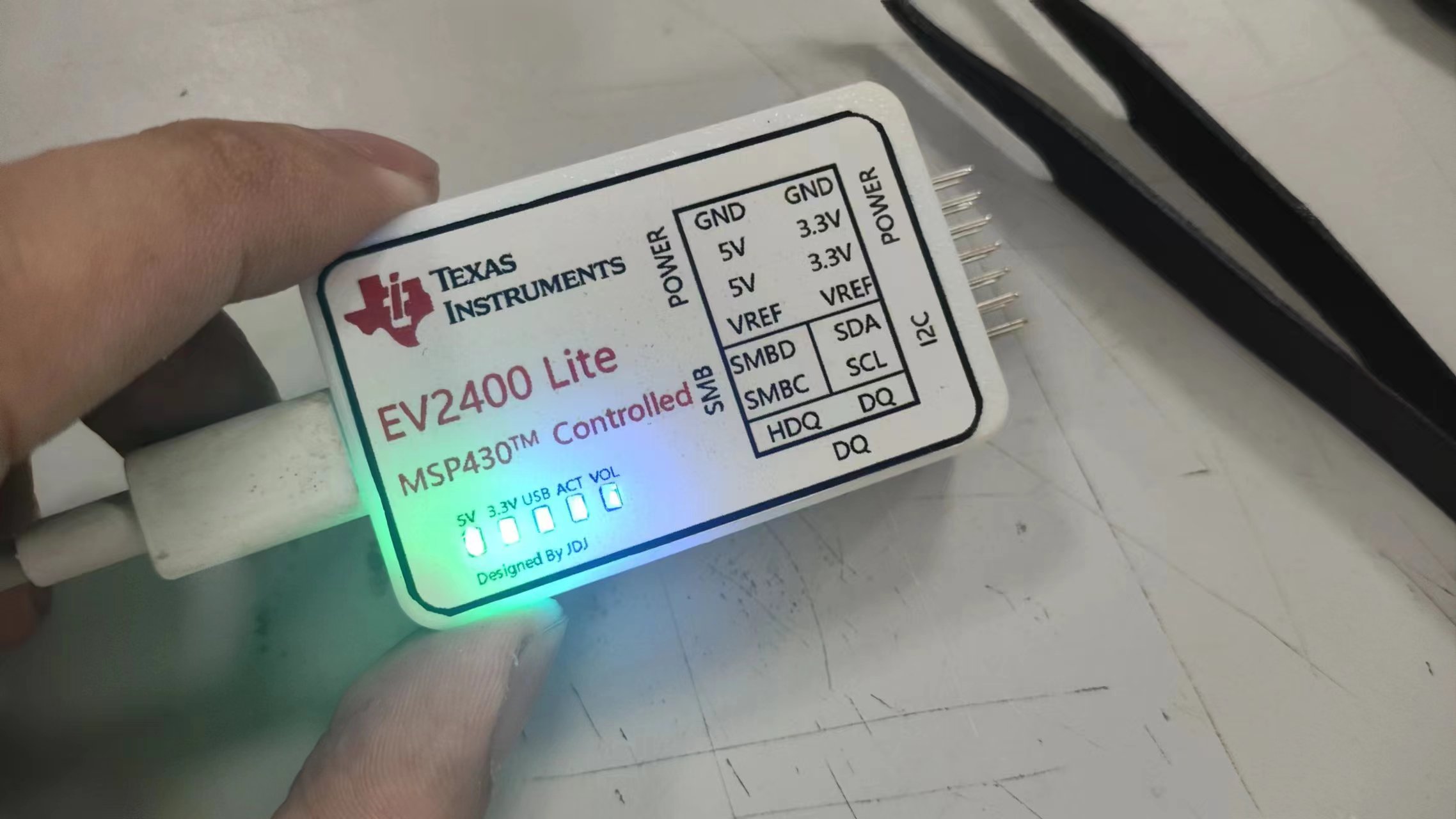

Next, download the BQStudio installation software from the official website or the attached file. After installation, insert the EV2400 with the software pre-programmed. Open BQStudio. It will ask you to select the target chip to debug; choose any one. Once inside, the top left corner will display the currently connected debugger and its software version, as shown in the image. OK, the EV2400-Lite setup is now complete. Go ahead and enjoy unlocking the battery OR the grueling debugging!

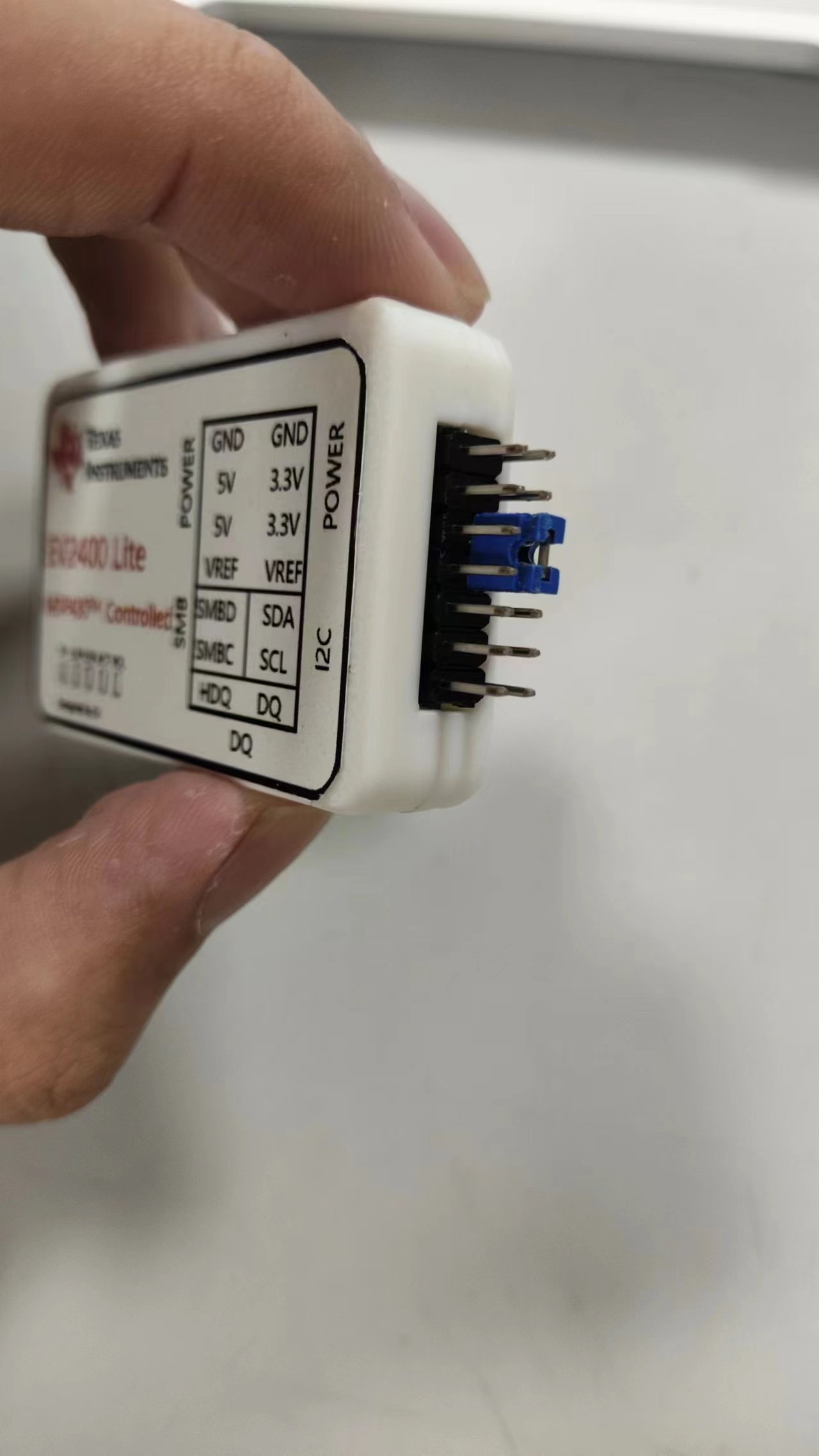

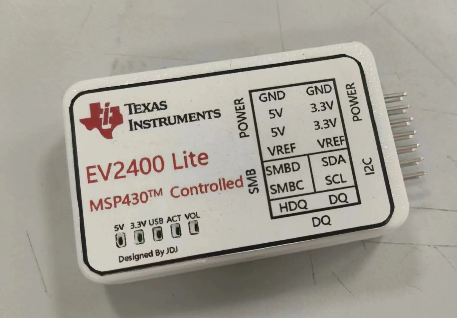

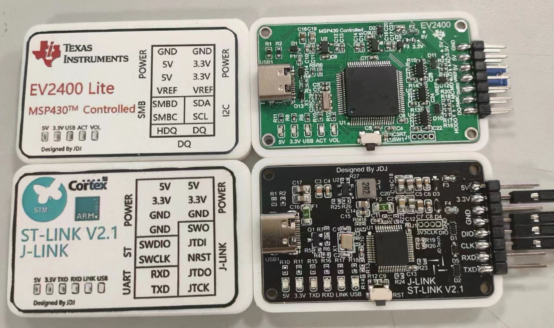

Shell Assembly:

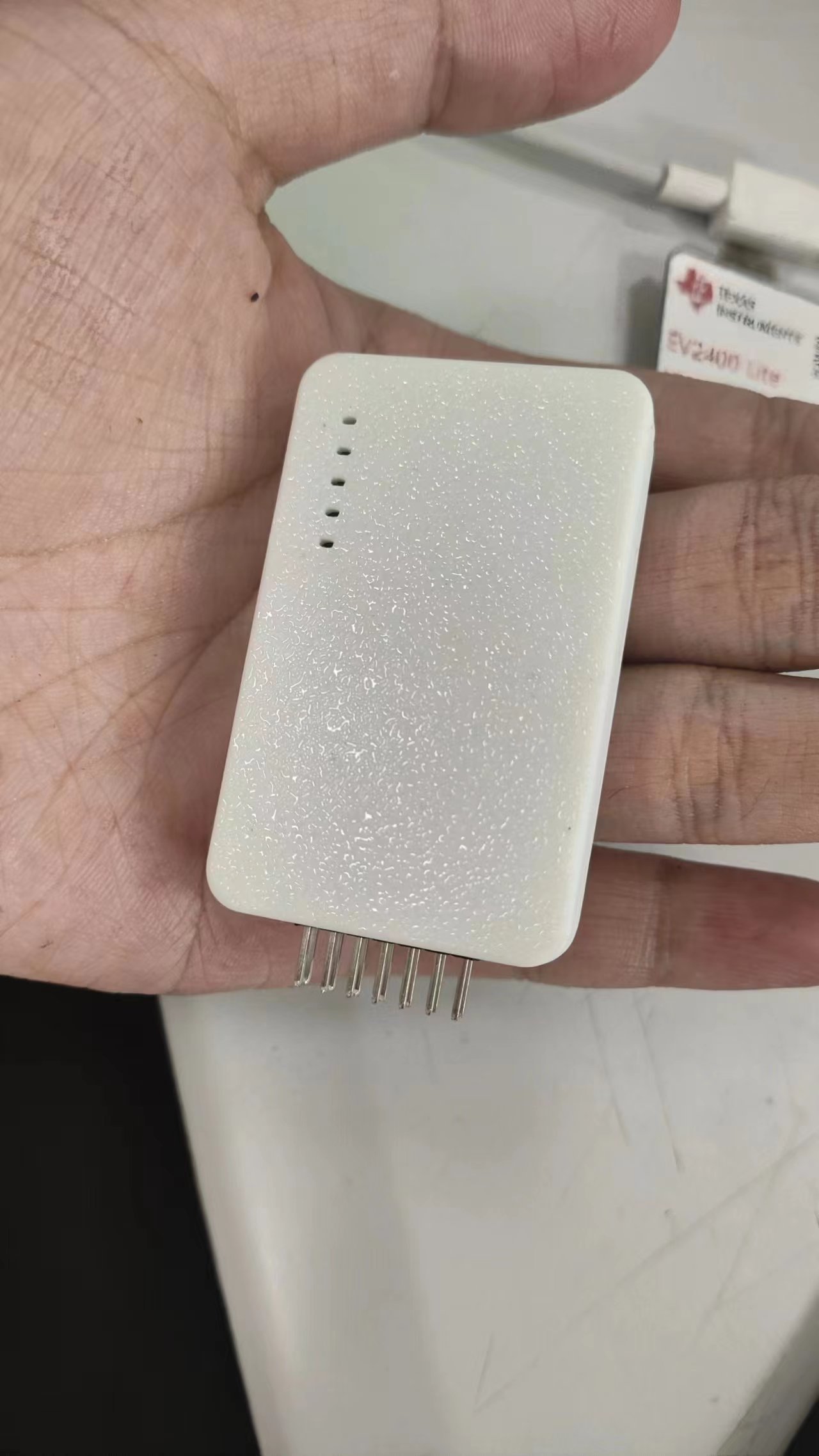

        If you don't want your debugger to be exposed, usable shell files are provided in the attachment. It is recommended to use an FDM 3D printer with a 0.2mm nozzle (0.4mm is also acceptable). Use a soldering iron to insert an M2 thermoforming nut with an outer diameter of 3mm and a height of 3mm, and use it with an M2_8mm countersunk screw. For specific instructions, please search for "3D printing thermoforming nut". I won't go into details here. A diagram is also included. Find a print shop and have them print the diagram at a size of 32*52mm (note the units!!!), then attach it to the top cover. That's it!
(This light is so bright, haha. A larger current-limiting resistor or a black casing for printing would probably be better.)
(The image is slightly smaller because I told the seller a specific size, but she still chose automatic scaling to fit. (Laughs, if you can scale it however you want, guess why I told you a fixed size?))
