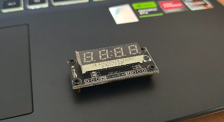

TM1637 - Digital Tube Module
Physical image of the TM1637-based digital tube module :

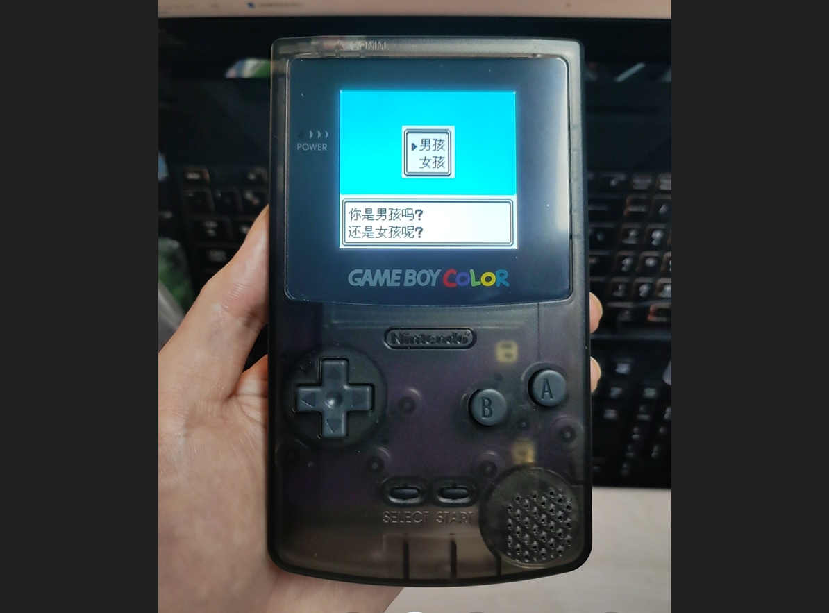

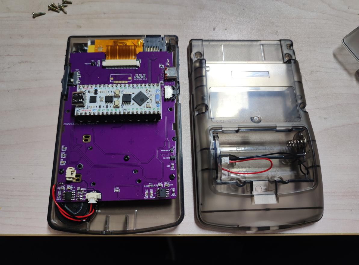

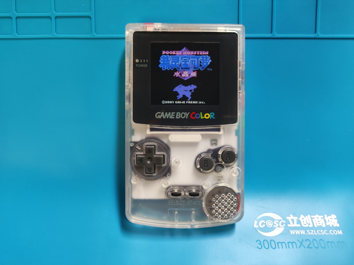

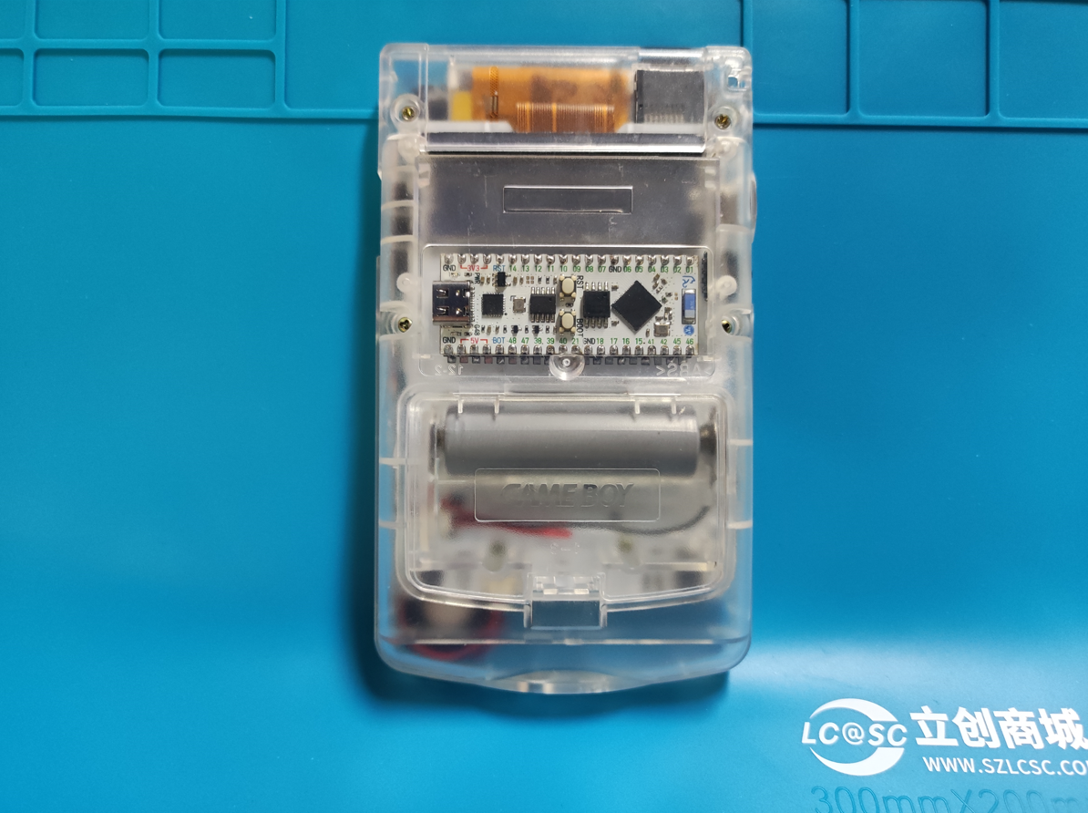

Retro handheld game console based on LCSC ESP32S3R8N8 development board
Handheld game projects suitable for beginners to recreate and get started
Retro Handheld Game Console
- Fun and Replicable.
Utilizing the LCSC ESP32S3R8N8 development board, this console
boasts high replication and reusability.
Fewer components reduce soldering, and the board can be easily removed for debugging and testing in other projects.
- Affordable :
It features a commercially available injection-molded shell,
offering a comfortable grip, a variety of color options, and an affordable price.
The motherboard is smaller than 10x10cm,
and most components, except for peripheral parts, are from LCSC's monthly special offer brands, supporting every passion.
- Open
System: Employing Retro-Go (https://github.com/ducalex/retro-go),
both software and hardware are open-source, allowing for unrestricted use.

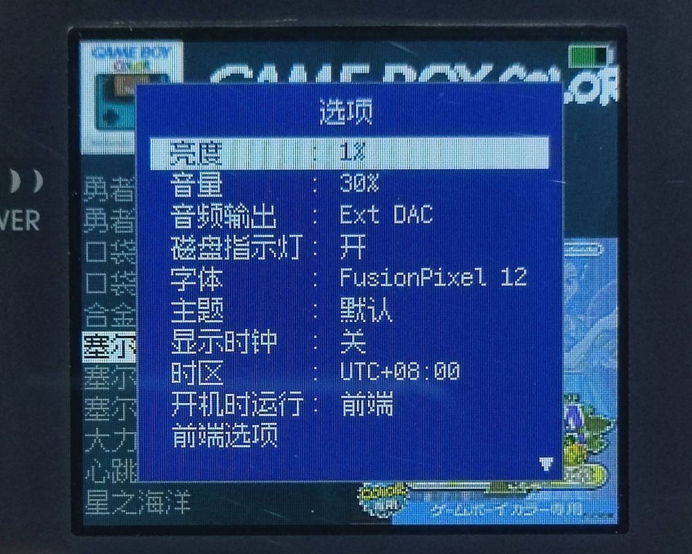

240719 Update:
Added recommended screen links and screen stands (attachments).
Completed missing reference components.
Added motherboard (power-on status follows power on/off).
- 240709 Update:
Added Chinese language support and localized the menu. (Attachment section)
Supported range [0000 - FFFF]
(Open source font library and character statistics: https://github.com/TakWolf/fusion-pixel-font/blob/2024.05.12/docs/font-info-12px-monospaced.md)
(PCB unchanged)
 The material and component list is at the bottom. For more tutorials, please join the QQ group: 971882968
Firmware burning :
Download the burning software and burn the attached img file. You can also compile
the official tutorial yourself: https://lceda001.feishu.cn/wiki/WruJwIsP8iZy4yk8KBxccZtrnSf

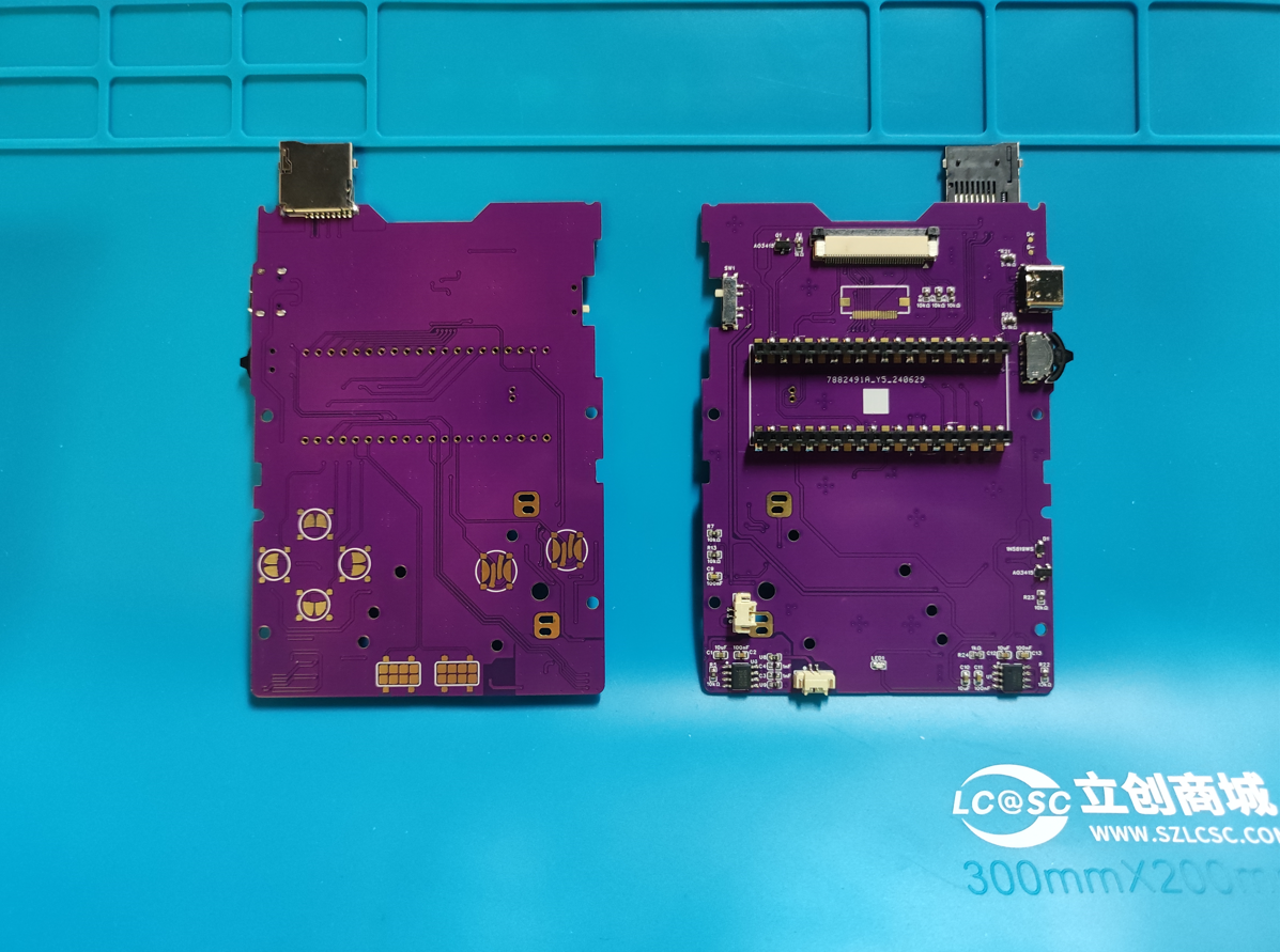

PCB
board thickness 1mm,
number of layers 2
