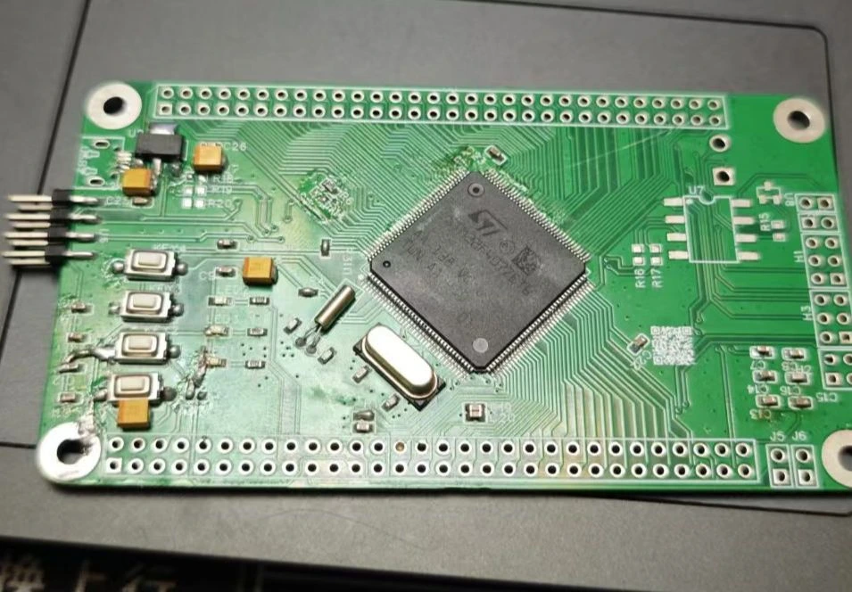

FOC motor drive board
The FOC control board,
based on the STM32F407ZGT6, is a low-cost FOC (Field-Oriented Control) driver control board that combines high performance with scalability. Specifically, it focuses on the outreach and expansion of I/O ports, USB interface, and CAN interface: The STM32F407ZGT6 has abundant I/O resources, including 114 I/O pins, which can be configured as inputs, outputs, interrupts, or analog functions as needed. To maximize its scalability, it is recommended to bring out
all unused
I/O ports via headers or connectors, allowing for the connection of various peripherals such as sensors, servos, and LEDs according to project requirements.
Pin configuration: Configure the input/output modes, pull-up/pull-down resistors, interrupt triggering methods, etc., of the pins appropriately according to the needs of the peripherals.
Expansion board design: Design an expansion board that connects to the main control board via slots or headers, allowing users to easily plug and unplug different functional modules as needed.
USB interface outreach and expansion:
The STM32F407ZGT6 supports USB OTG functionality and can be configured for device mode or host mode. To enhance the communication capabilities of the control board, it is recommended to bring out the USB interface and provide the following extended functions:
Virtual serial communication: Implement virtual serial port functionality through the USB CDC (Communication Device Class) protocol, facilitating data communication and debugging with PCs or other devices.
USB device identification: Configure device descriptors in the firmware so that the PC can correctly identify and install the corresponding drivers.
USB host mode: If the control board needs to connect multiple USB devices (such as mice, keyboards, USB flash drives, etc.), it can be configured to USB host mode, and corresponding interface circuits and drivers can be designed.
CAN interface outreach and expansion:
The STM32F407ZGT6 supports CAN bus communication. By bringing out the CAN interface, high-speed and reliable communication with multiple devices can be achieved:
Adding CAN channels: Although the STM32F407ZGT6 itself only has one CAN interface, multi-channel CAN communication can be achieved through expansion chips (such as SN65HVD230, etc.).
CAN interface isolation: To enhance the system's anti-interference capability, isolation circuits, such as optocoupler isolation or magnetic coupling isolation, can be added to the CAN interface.
CAN Network Design: Design the CAN network topology according to application requirements, including bus and star topologies, and configure terminating resistors and filtering circuits appropriately.
Other Expansion Suggestions
: Power Management: Design a stable power supply circuit to provide appropriate voltage and current to the control board and peripherals. Consider adding power filtering and overvoltage/overcurrent protection circuits to improve system stability and reliability.
Debugging Interface: In addition to the USB interface, provide an SWD (Single Wire Debug) or JTAG interface for easy program downloading and debugging using a debugger.
Button Interface: In addition to the above interfaces, provide some button interfaces to facilitate the design of different functions.
In conclusion, the low-cost FOC driver control board based on STM32F407ZGT6 should fully consider its high performance and scalability during design and expansion. By reasonably introducing and expanding key resources such as I/O ports, USB interfaces, and CAN interfaces, the applicability and flexibility of the control board can be greatly improved.
