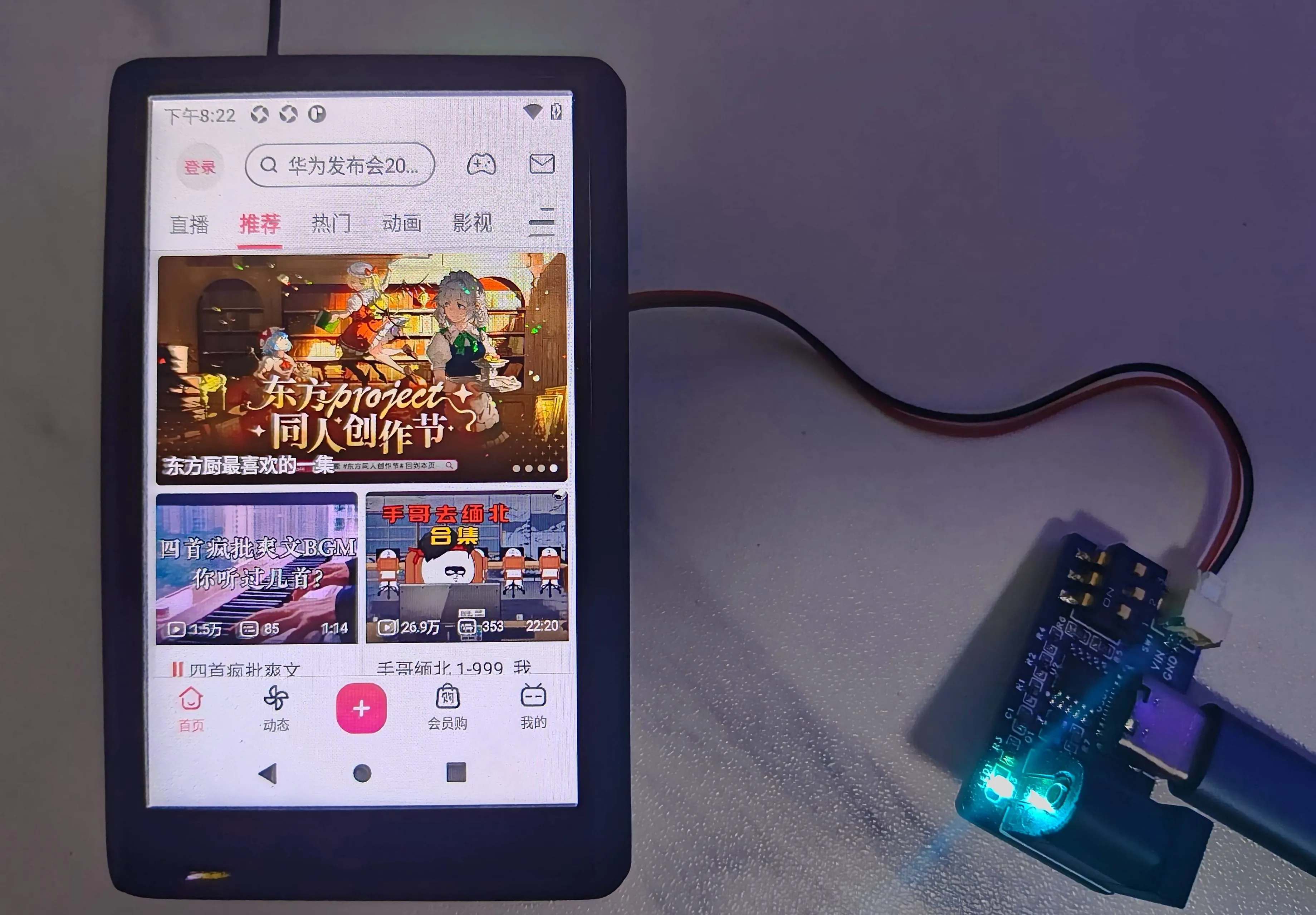

Taishan School Mini Mobile Phone
LCSC Taishanpai Project Information Link: https://wiki.lckfb.com/zh-hans/tspi-rk3566/
Project Introduction:
A small mobile phone based on the LCSC Taishanpai project, using Rockchip RK3566 as the main control chip. The Taishanpai version is 2+16G. The system is Android.
Project Functionality
: Using the Android system, it can access apps like a tablet, and includes a speaker and microphone. It uses the onboard Wi-Fi chip to connect to Wi-Fi.
Project Parameters
: Memory: 2+16G
System: Android
Screen: MIPI Screen
Principle Analysis (Hardware Description)

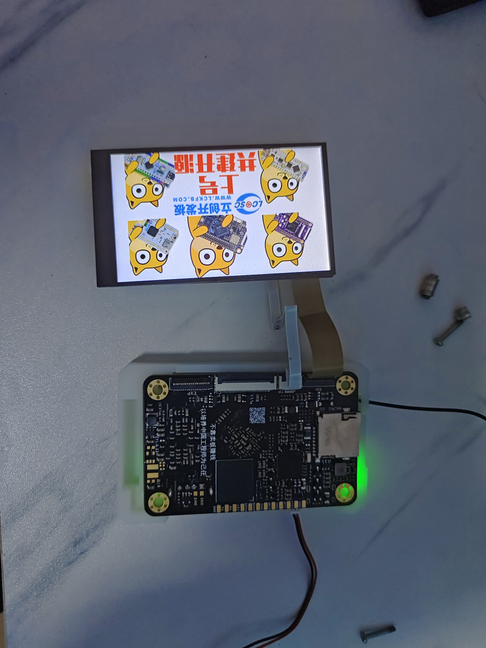

: Screen Part: The purchased MIPI screen is inconsistent with the MIPI interface on the Taishanpai board, so an adapter circuit needs to be designed to ensure that the screen and its touchscreen can display and function normally. The screen backlight can be selected from the MIPI interface or the onboard boost circuit; it is recommended to use the onboard boost circuit.
Speaker and Microphone: Connected to the Taishanpai via spring-loaded pins.

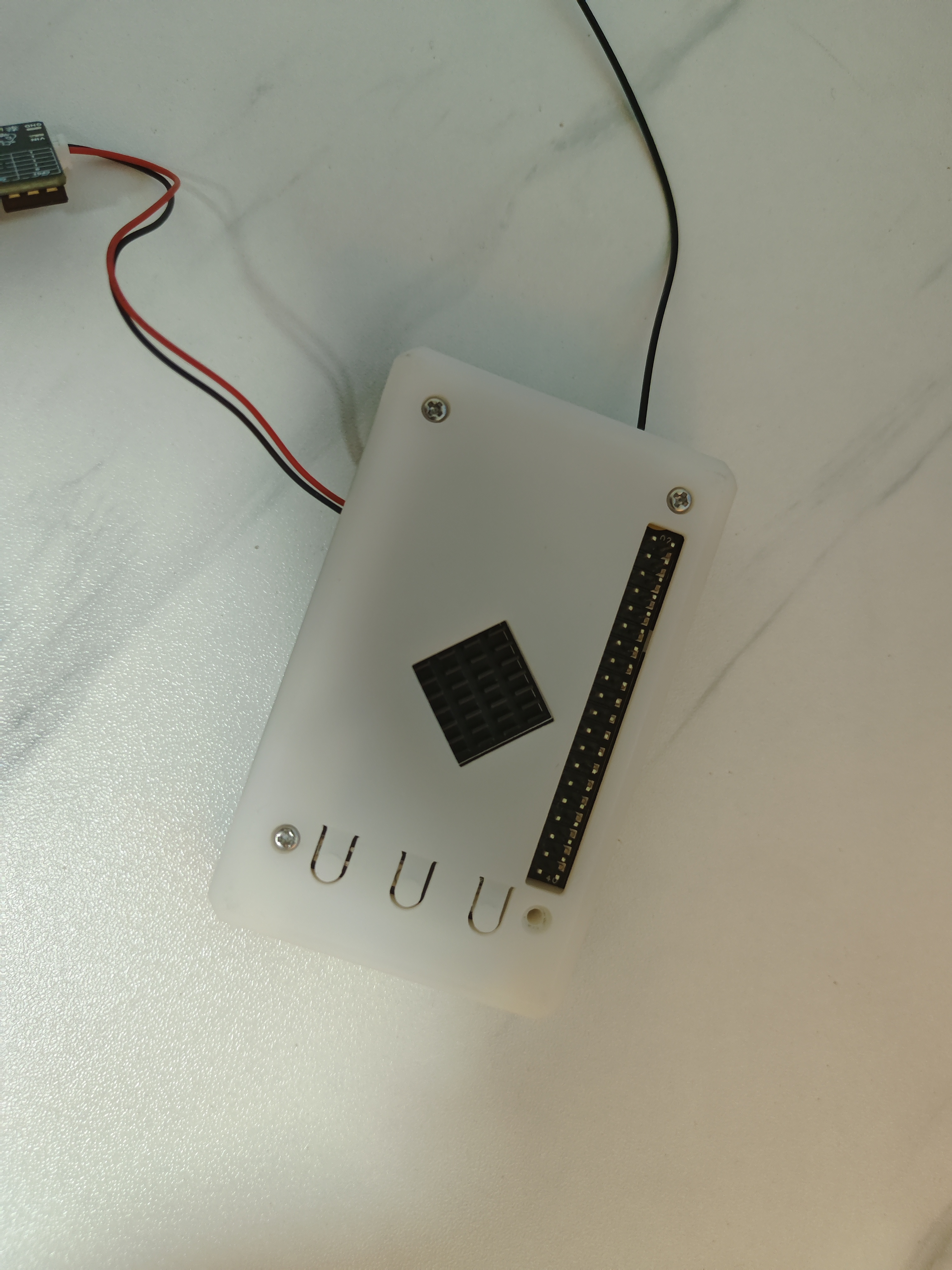

When soldering the joints with a soldering iron, be sure to secure them first.
The actual product image
shows a hole cut out for heat dissipation.
