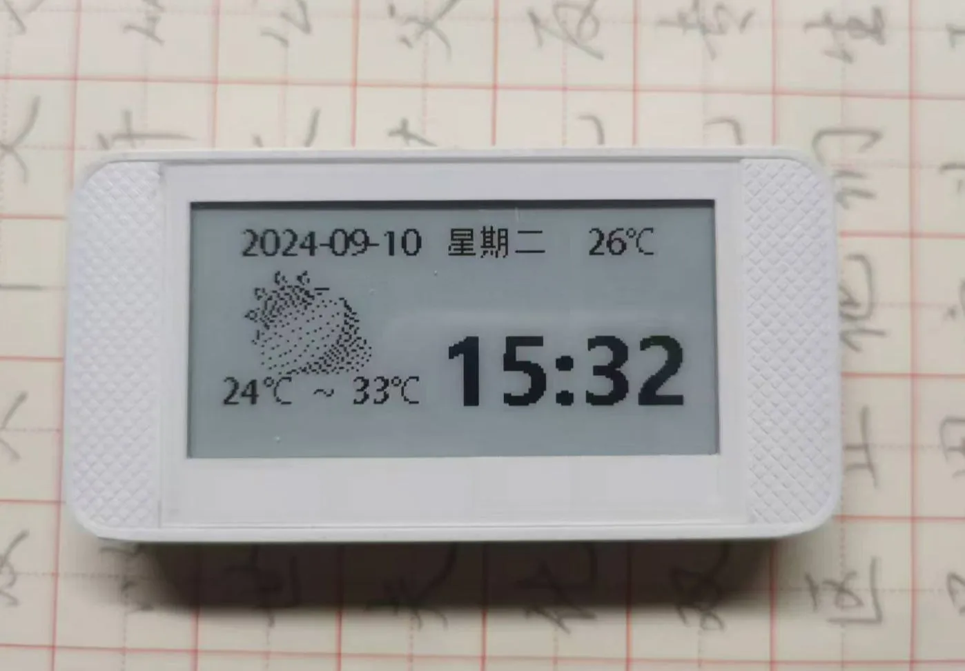

The main control chip is ESP32-C6-MINI, used to connect to WiFi and obtain current weather and temperature changes. Before use, you need to pre-set the WiFi name (preferably without spaces, otherwise it won't connect), WiFi password, and location to obtain the current temperature and time.
The built-in AHT20 sensor detects the ambient temperature and humidity, providing a more accurate representation of perceived temperature and humidity.
The display uses an e-ink screen with a simple interface and low power consumption. Icons are sourced from the internet; the image is shown below.
The charging section uses a TP4056 charging/discharging chip to meet charging needs; the battery can be selected according to your requirements.
The casing can be designed to match the size of the e-ink screen price tag. The overall effect is shown below:
