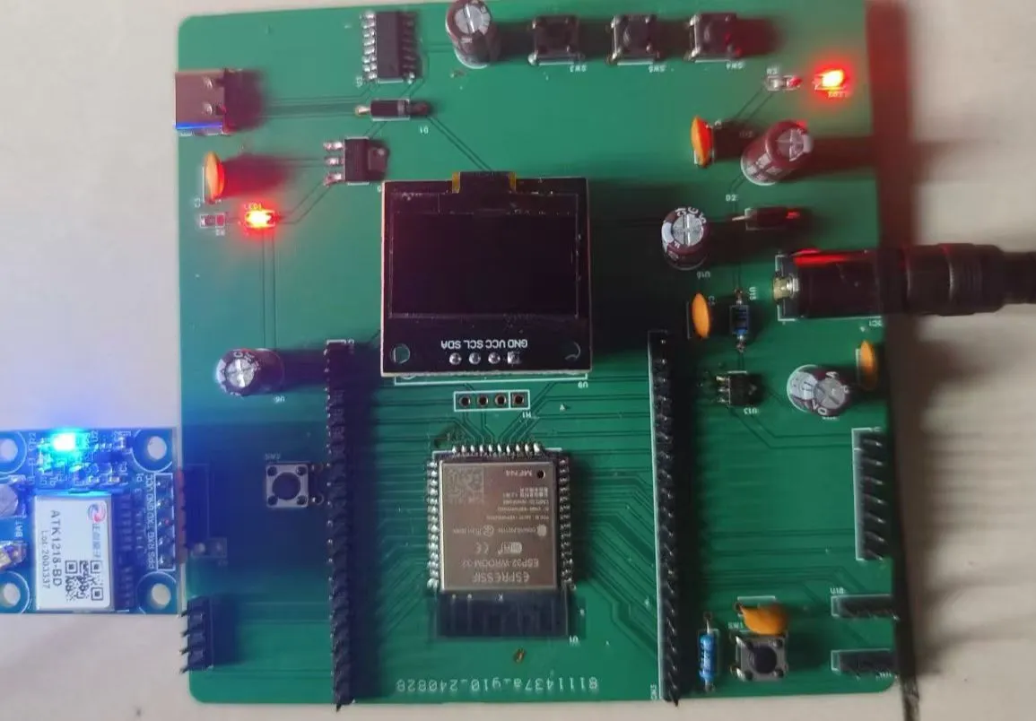

ESP32-based networked portable audio playback and positioning device
1. Hardware Design:
The DC 12V power supply circuit uses the TL431 as the voltage regulator chip, and a filter capacitor is included to manage the current.
During actual use, it was found that the 250mA output current of the TL431 chip was insufficient to power numerous modules. Therefore, a three-way power supply was adopted, requiring the use of a voltage regulator chip with a larger output power capacity.
Type-C was considered for power supply and debugging, with an AMS1117-3.3 for 5V to 3.3V conversion and a CH340C for USB to serial port circuit design.
External module access:
The button
circuit uses an external debugging pin header.
This open-source project consists of two boards, an older and a newer one. The newer version is an improved board developed after issues were discovered during debugging.
Note: This project uses Platform.io for programming.
