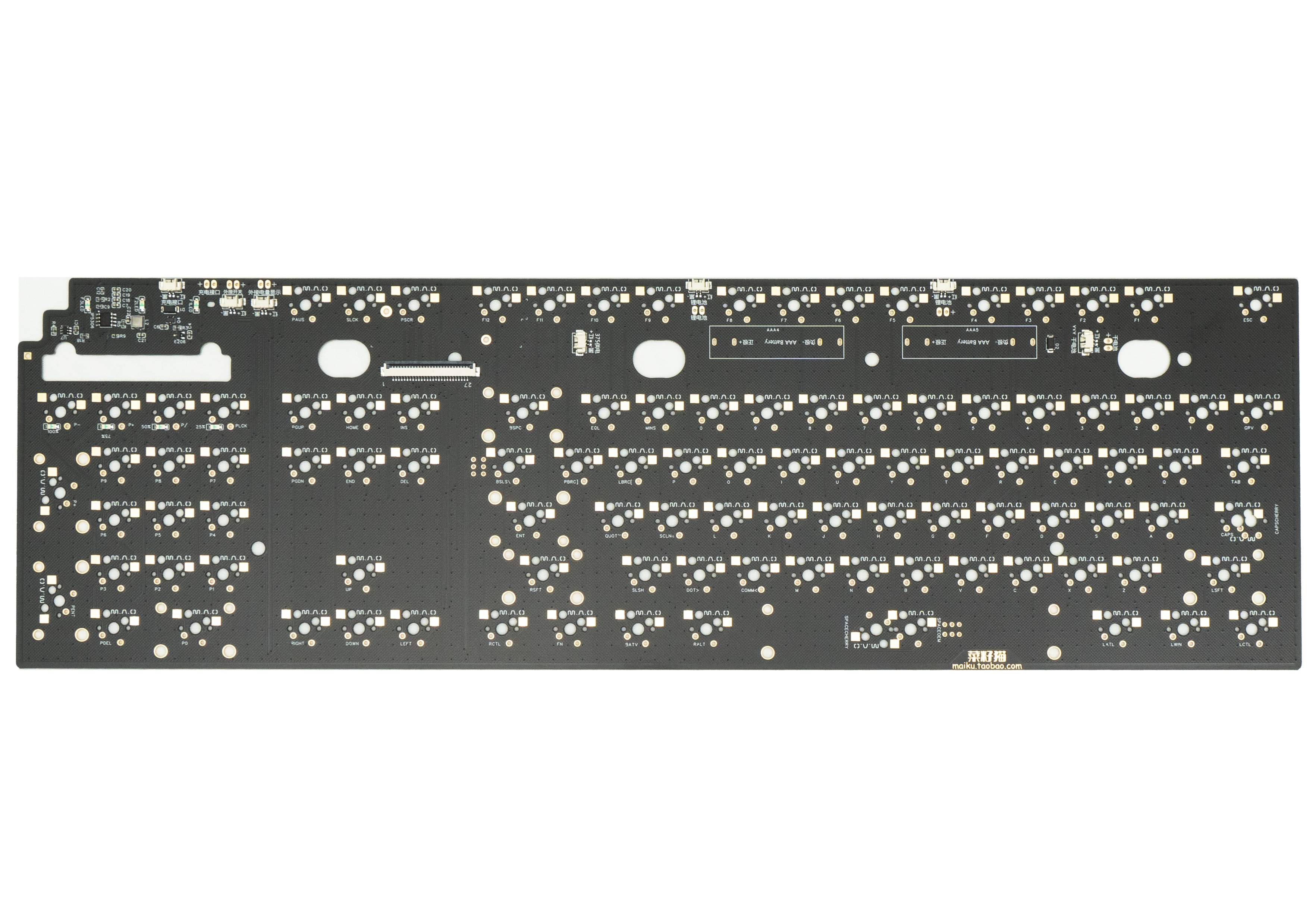

Cherry G80 modified with K375S Unifying dual-mode PCB

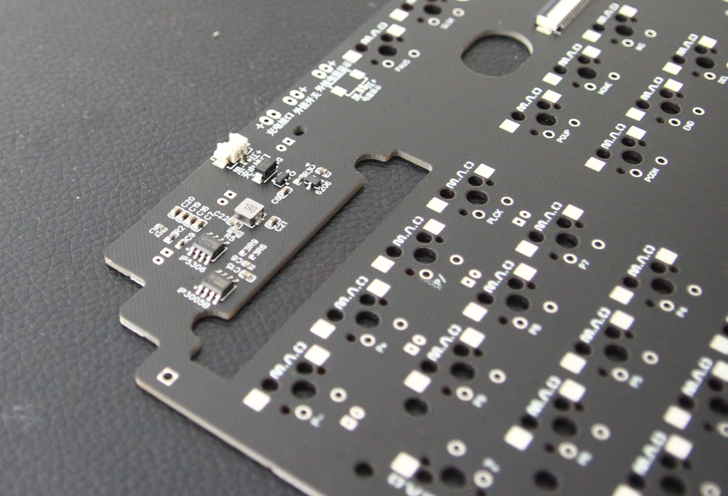

This early version of the K375S main controller was modified to use the PCB
onboard charging module of a Cherry G80-3000.
It features overcharge and over-discharge protection
, two slide switches (one for the spacebar and one for the down
switch), requiring keycap removal for activation, and one external switch. It uses a 1.25mm pitch female connector and can be mounted on the casing using an 8mm self-locking switch soldered with 1.25mm pitch wire.
The battery-powered portion is negligible. This PCB
uses a 1.25mm pitch lithium battery connector, supporting up to four lithium batteries. A single 18650 3000mAh lithium battery can typically provide over a year of standby time, so having more seems unnecessary.
