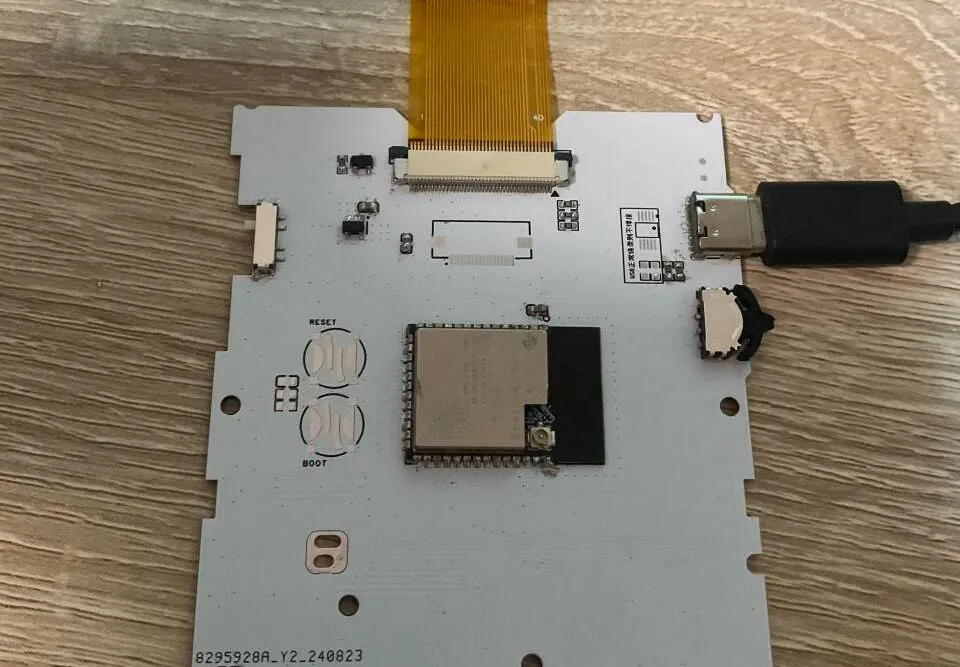

C19 handheld console based on ESP32-S3 (compatible with GBC casing)
This project is a branch of @蕉色幻想's project: A Retro Handheld Game Console Based on the LCSC ESP32S3R8N8 Development Board.
This project aims to achieve a lower cost, therefore cheaper modules are chosen and the header chip is omitted.
Three power supply versions are provided: LDO ASM1117, ME6217C; and DC-DC SY8088.
Regarding materials, please refer to the main project for screen and casing materials; only the modules and power supply (top left corner) differ.
Firmware details are also available in the main project.
This project supports direct USB programming; programming tutorial: Upgrade Device via USB
. This project will not be updated except for hardware bug fixes.
