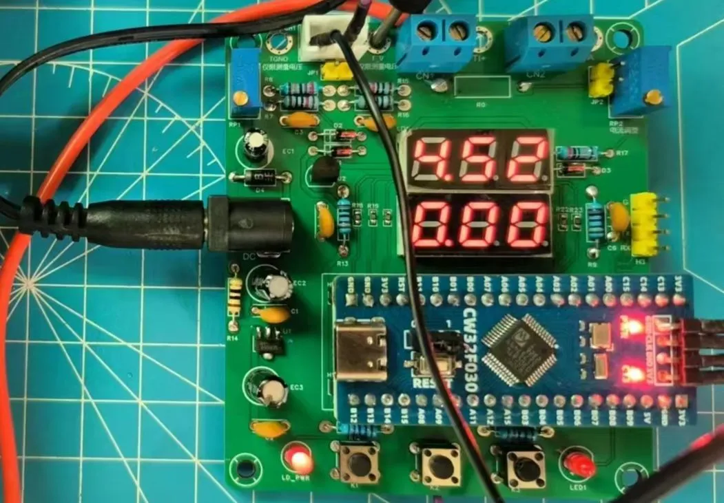

The CW32 digital voltmeter and ammeter combines ADC technology with circuit measurement principles, accurately converting analog voltage and current signals into digital displays for easy reading and analysis by electronic engineers.

1. Power Supply Circuit: This project uses the SE8550K2 as an LDO (Low Dropout Linear Regulator).

MCU Selection:
This project uses the CW32F030C8T6 MCU.

Voltage Sampling Circuit
: A voltage divider circuit is used to achieve high voltage acquisition, capable of acquiring 100V. The voltage divider resistor is designed as 220K+10K, therefore the voltage division ratio is 22:1 (ADC_IN11).
4. Current Sampling Circuit:
A low-side current sampling circuit is used for current detection. The low side of the sampling circuit shares a common ground with the development board's meter interface. The sampling current designed in this project is 3A, and the selected sampling resistor (R0) is 100mΩ. 5. Digital Tube Driver 6. Indicator Lights

III. Button Functions
K1 key is used to switch display modes. K2 key sets the parameter value in the corresponding mode and saves it to FLASH. K3 key returns to mode 0.
Mode 0: Displays normal voltage and current values ​​(the upper row of digital tubes displays the voltage value *.V or .*V automatically switches, the lower row displays the current value, _.**A).
Mode 1: Voltage 5V calibration value setting. The upper row of digital tubes displays 5.05. The next row displays the current voltage value as _.V or ._V. In this mode, the multimeter should be set to 5.00V when measuring the measured position. Pressing the K2 key will calibrate the current value to 5V.
Mode 2: 15V voltage calibration setting. The previous row of the digital display shows 5.15. The next row displays the current voltage value as _.V or ._V. In this mode, the multimeter should be set to 15.0V when measuring the measured position. Pressing the K2 key will calibrate the current value to 15V.
Mode 3: 0.5A current calibration setting. The previous row of the digital display shows A.0.5. The next row displays the current current value as _.**A. Pressing the K2 key will calibrate the current value to 0.5A.
Mode 4: 1.5A current calibration setting. The previous row of the digital display shows A.1.5. The next row displays the current current value as *.**A. Pressing the K2 key will set the current value to 1.5A
