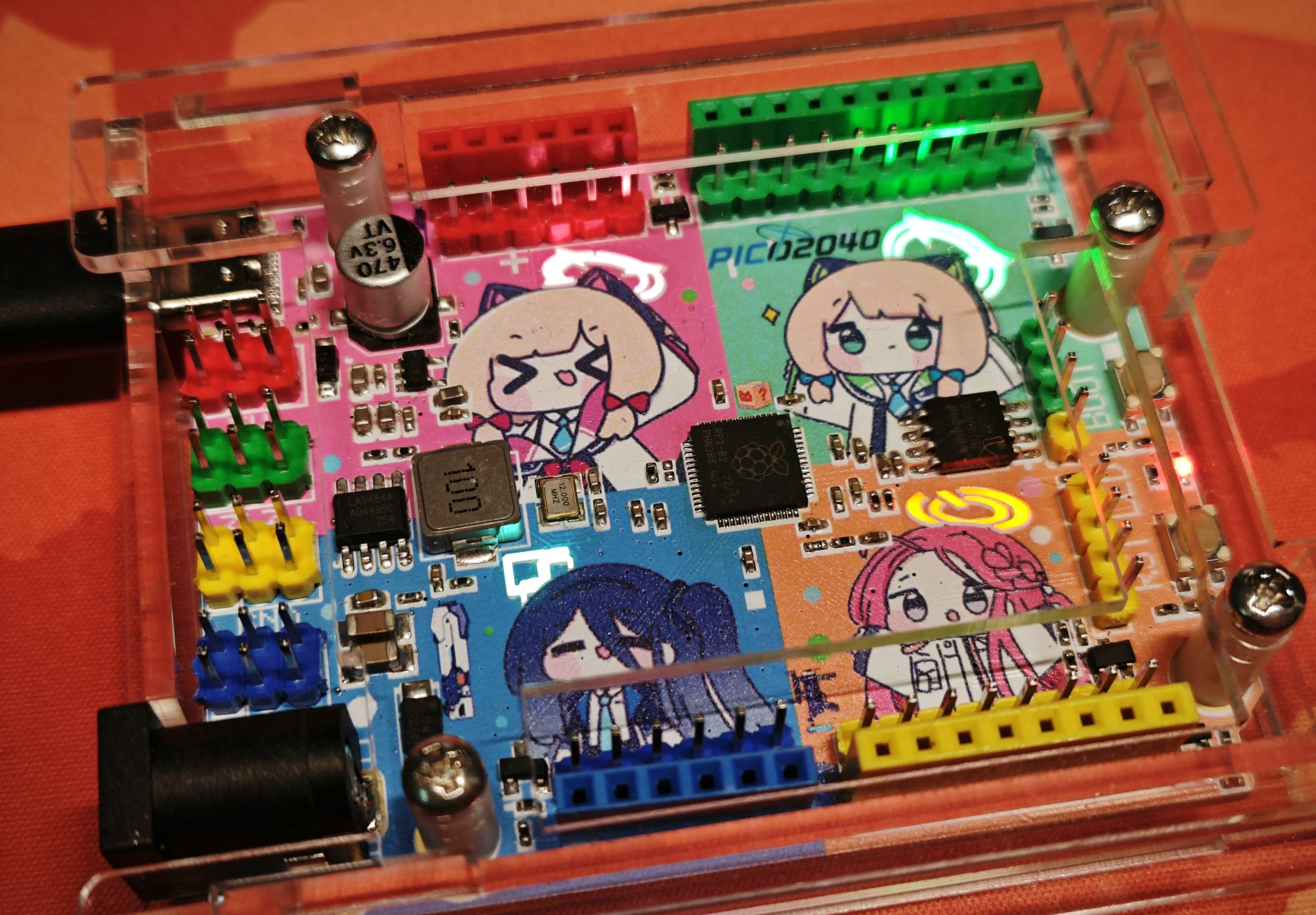

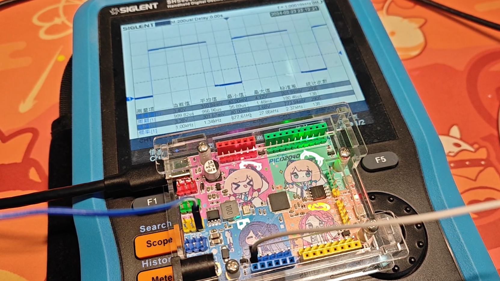

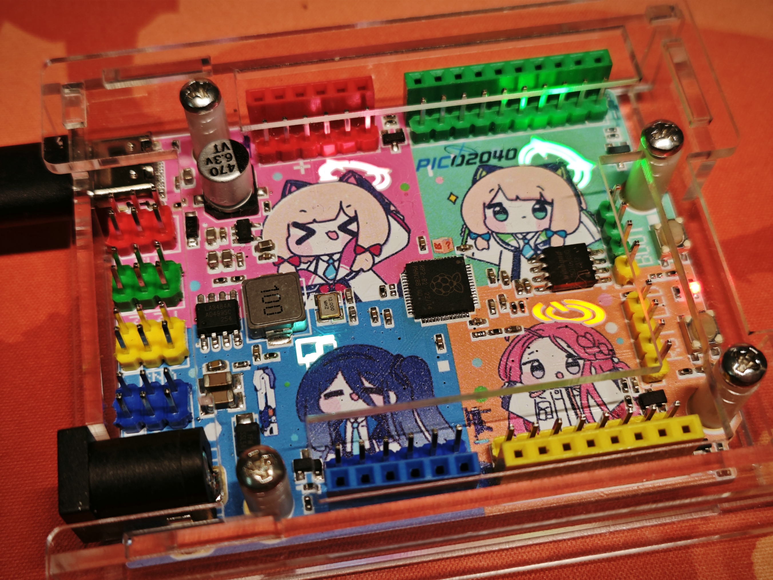

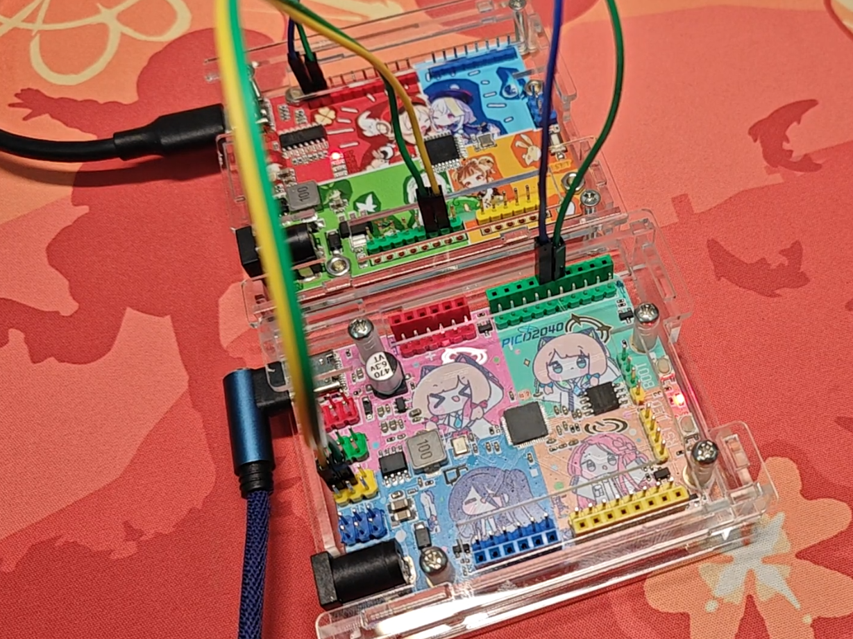

1. Introduction: This
is a color silkscreen development
board It features a built-in halo light for four small characters from the game development department.

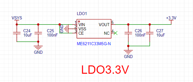

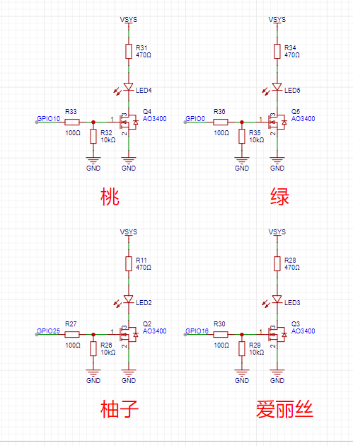

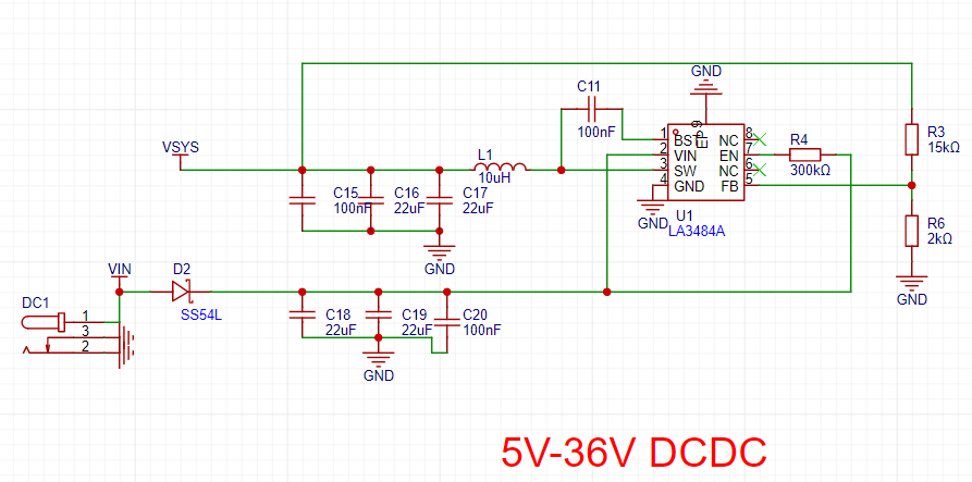

2. Schematic Diagram
: The schematic shows the most basic system.

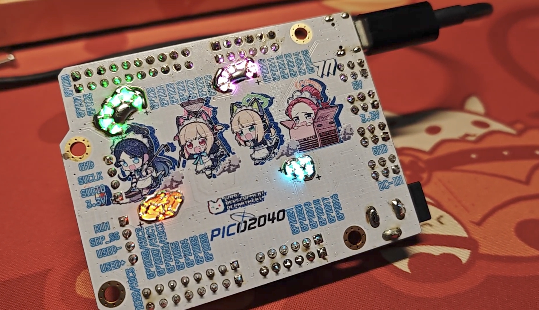

GPIOs 0, 10, 16, and 25 are led out to the halo lights.
The LEDs on the back are reversed and surface-mounted . The colors are
pink, emerald green, blue-white, and orange.
The DC-DC converter uses the domestic Jingyi LA3484, and the
LDO is the domestic Weimeng 6211.

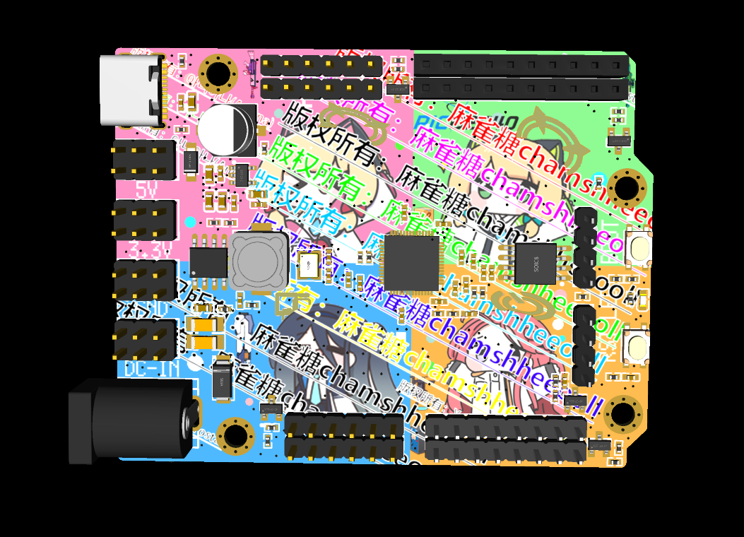

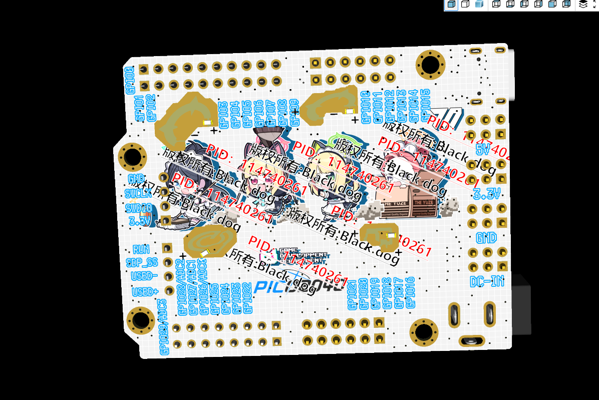

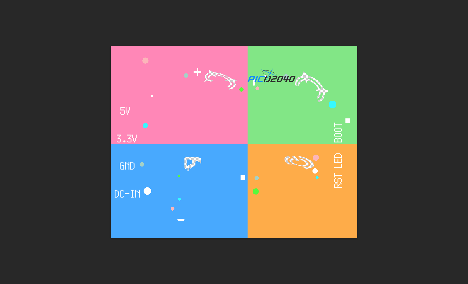

3. Color Silkscreen
: JLC color silkscreen technology is used on both sides .

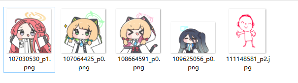

The original color silkscreen
files are available in the PSD file. Images are from Pixiv artists:
The following materials were used
: Top layer:
PID: 107030530 Artist: chamshheeooll
PID: 107064425 Artist: chamshheeooll
PID: 108664591 Artist: chamshheeooll
PID: 109625056 Artist: chamshheeooll
PID: 111148581 Artist: 아니아나 (Aniana)
Base layer:
PID: 114740261 Artist: Black dog
Please abide by the open source license and do not use it for commercial purposes!

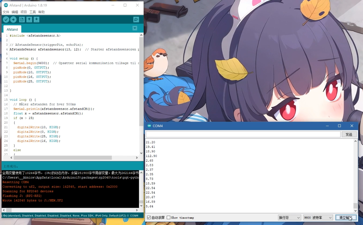

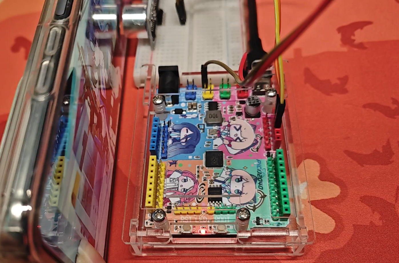

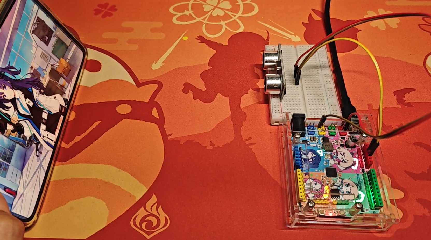

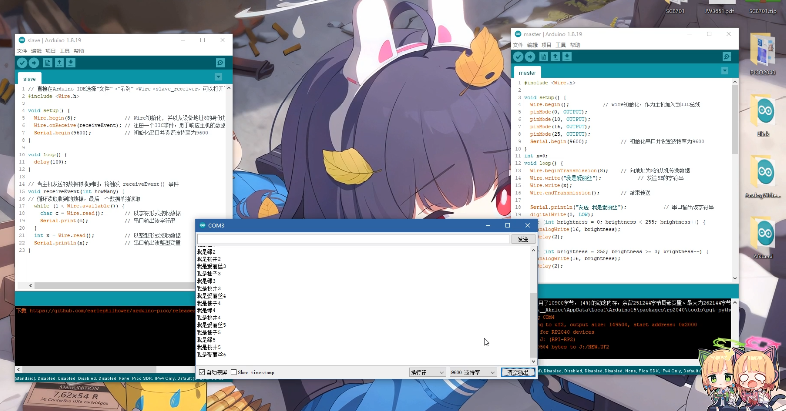

4. Usage Example
4.1 IIC Communication
Programming Host Slave
IIC receives the sent information and lights up the corresponding light
4.2 Email Mom's Defense War
Uses ultrasonic SR04 for distance measurement, light off when the distance is small, light on when the distance is large
4.3 PWM

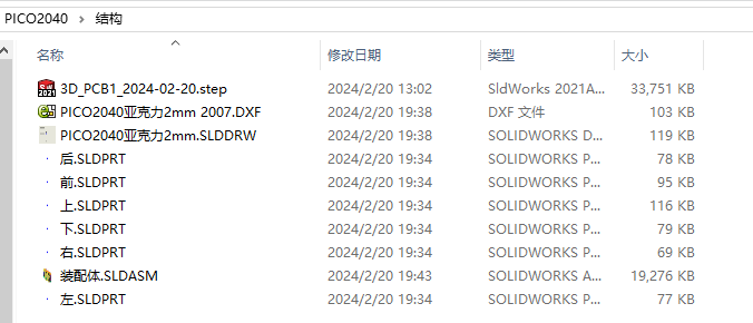

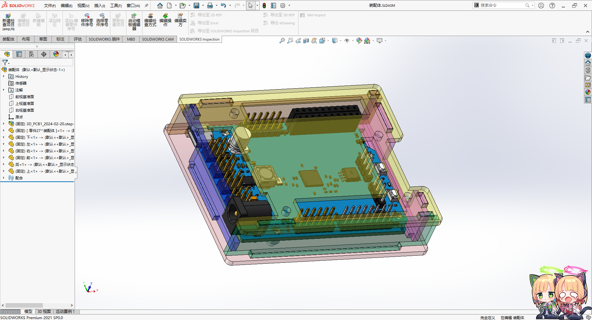

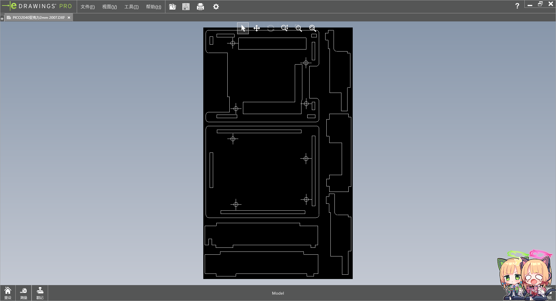

5. Acrylic Shell
Uses SW to draw
2mm thick acrylic
See the attached structure. 7z
has a file that can be ordered directly: PICO2040 Acrylic 2mm 2007.DXF
Assembly parts are as follows:
Name
Quantity
3.2*5*9 Plastic spacers
3.2*5*3 Plastic spacers
M2.5*20 Screws
M2.5 Nuts
