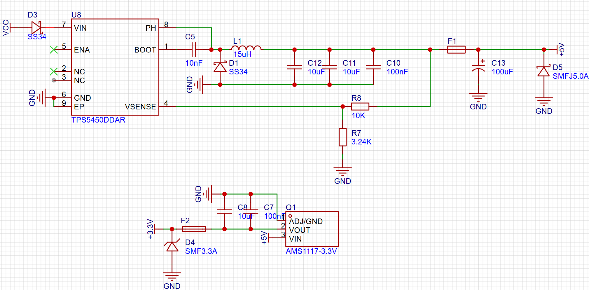

1.1 Power Supply Circuit
An LDO (Low Dropout Linear Regulator) is used as the power supply. Considering that most voltmeter products are used in industrial scenarios with 24V or 36V power supplies, this project selected the SE8550K2 with a maximum input voltage of up to 40V as the power supply. The main reason for not using a DC-DC step-down circuit to handle the large voltage drop is to avoid introducing DC-DC ripple interference during the design process; a secondary reason is to reduce project costs.

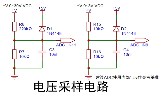

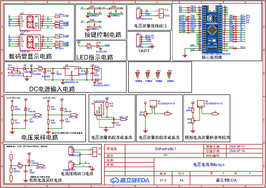

1.2 Voltage Sampling Circuit
The voltage divider resistor in this project is designed to be 220K + 10K, therefore the voltage division ratio is 22:1 (ADC_IN11).
The voltage divider resistor selection
is designed to measure the maximum voltage value. For safety reasons, this project uses 30V (the actual maximum display can be 99.9V or 100V).
The ADC reference voltage is 1.5V in this project, and this reference voltage can be configured through the program.
To reduce the power consumption of the sampling circuit, the low-side resistor (R7) is usually chosen as 10K based on experience.
Then, the high-side resistance of the voltage divider resistor can be calculated using the above parameters.
The required voltage division ratio is calculated, i.e., the ADC reference voltage. The input voltage is designed; using known parameters, 1.5V/30V = 0.05 can be calculated.
The high-side resistance is calculated as the low-side resistance/voltage division ratio; using known parameters, 10K/0.05 = 200K can be calculated.
A standard resistor is selected: a resistor slightly higher than the calculated value of 200K is chosen. We usually choose E24 series resistors; therefore, in this project, 220K, which is greater than 200K and closest to the calculated value, is selected.
If, in actual use, the voltage to be measured is lower than 2/3 of the module's design voltage (66V), the voltage divider resistor can be replaced and the program modified to improve measurement accuracy. The following example illustrates this:
Assuming the measured voltage is no higher than 24V and other parameters remain unchanged,
calculations show 1.5V/24V = 0.0625, 10K/0.0625 = 160K. 160K is a standard E24 resistor and can be directly selected, or a higher value 180K can be chosen with some redundancy.
If, in actual use, the voltage to be measured is higher than the module's 99V design voltage, a different resistor can be selected. To achieve a wider voltage measurement range, one can choose to replace the voltage divider resistor or modify the reference voltage. The following example illustrates this:
Assuming the measured voltage is 160V, the solution is to increase the voltage reference to expand the range.
Given that the voltage division ratio of the selected resistor is 0.0145, we can calculate 160V * 0.0145 = 2.32V using the formula. Therefore, we can choose a 2.5V voltage reference to achieve the increased range (increasing the range will reduce accuracy).
Considering the potential fluctuations in the measured power supply, a 10nF filter capacitor is connected in parallel with the low-side voltage divider resistor to improve measurement stability.

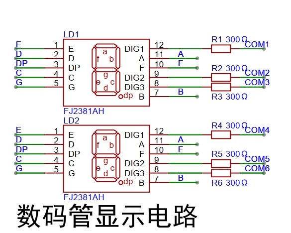

1.3 The display circuit
uses digital tubes as the display unit.
Two 0.28-inch three-digit common-cathode digital tubes are used as the display devices. Compared to a display screen, digital tubes have better visibility in complex environments. Depending on the actual usage environment, smaller current-limiting resistors can be used to achieve higher brightness. Furthermore, digital tubes have better mechanical properties and are not as easily damaged by external forces as display screens. They are widely used in industrial and other applications requiring stable and reliable operation. From a development learning perspective, it's easier to learn electronic measurement principles and related development in a more targeted way.
In this project, after actual testing, the current-limiting resistors (R1~R6) of the digital tube were configured to 300Ω. The corresponding brightness, whether for red or blue digital tubes, showed good legibility and was soft and not glaring.

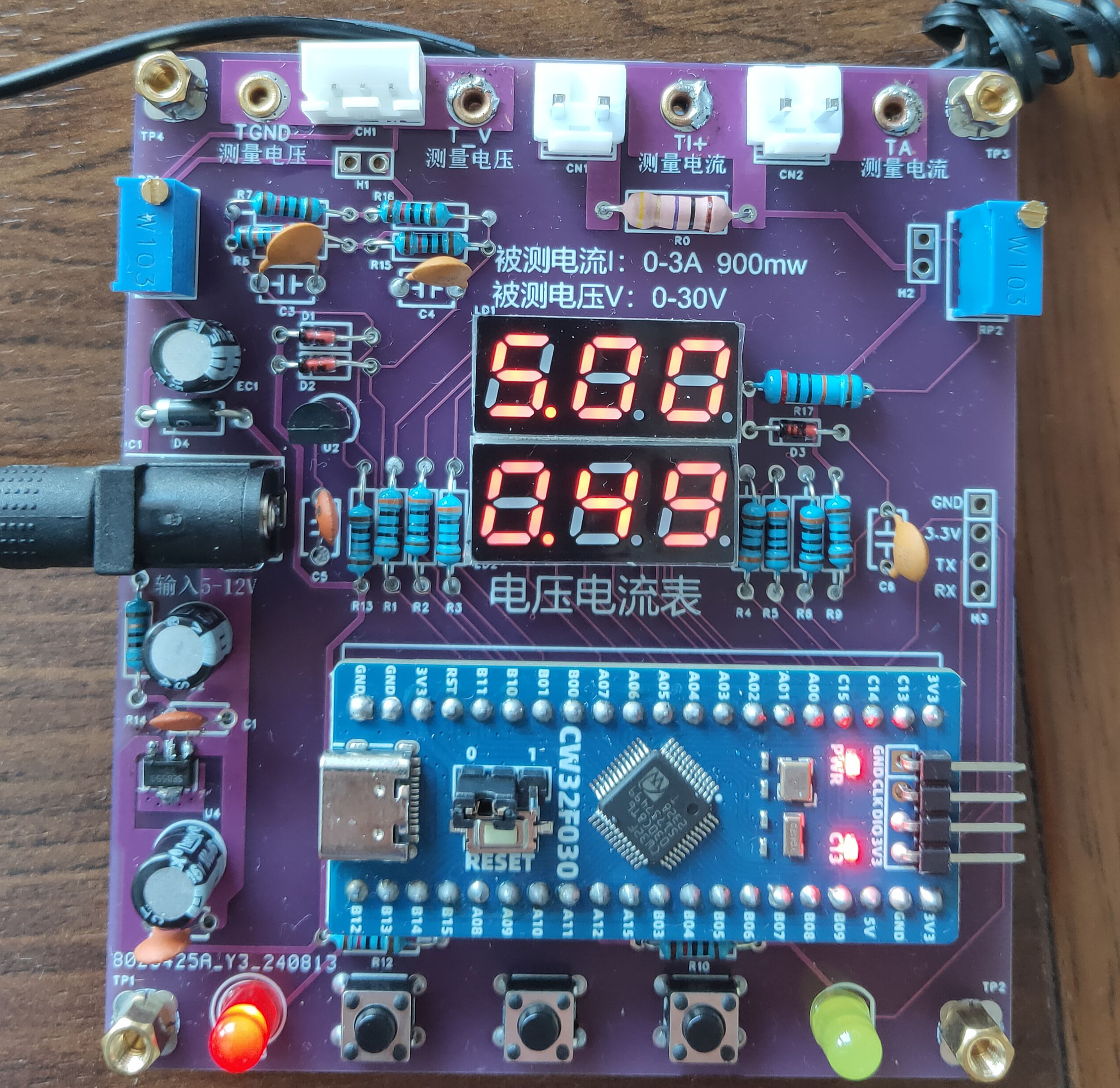

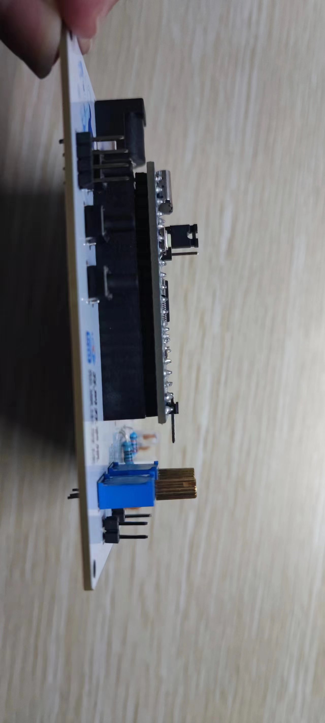

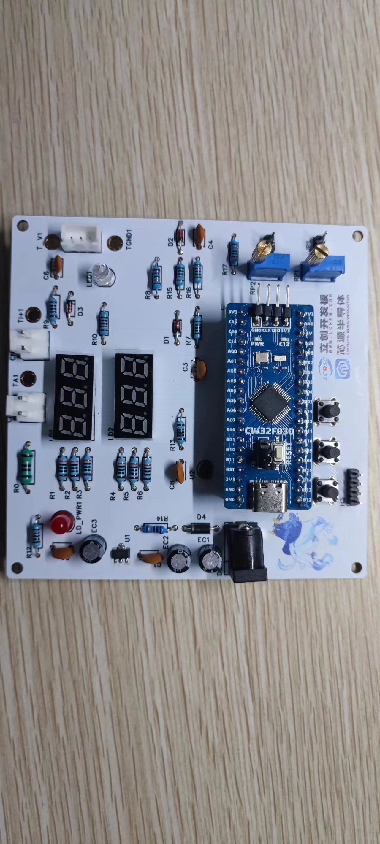

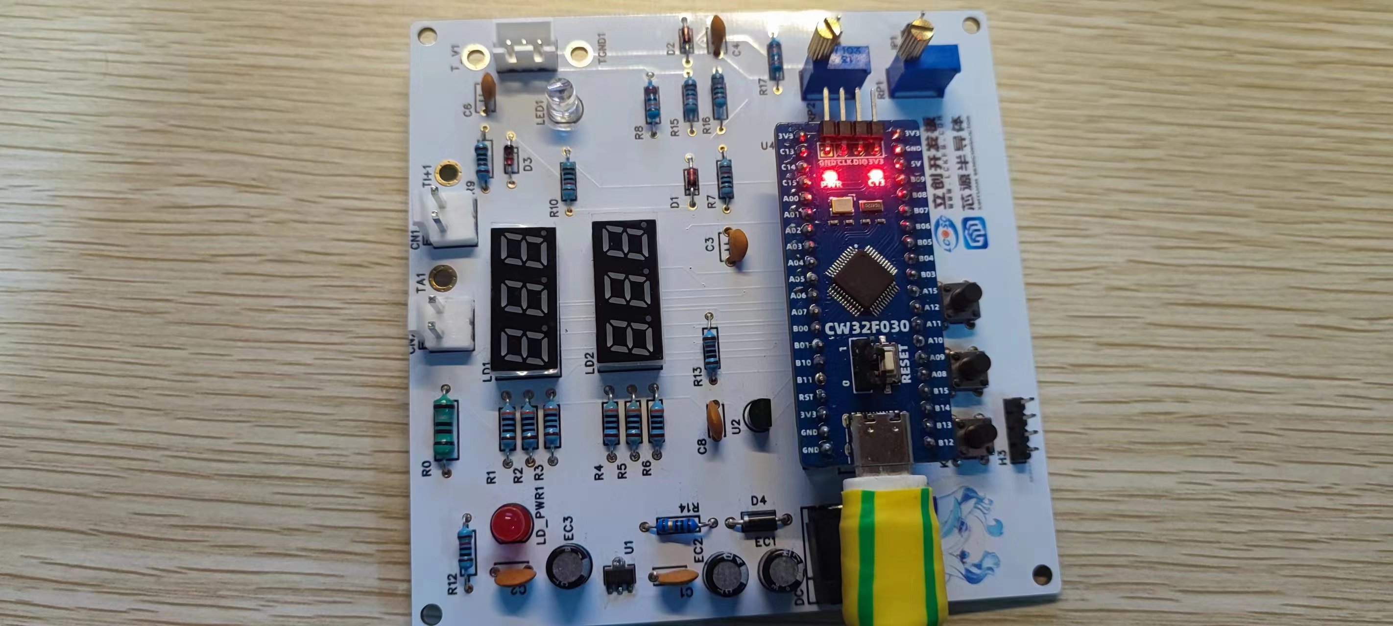

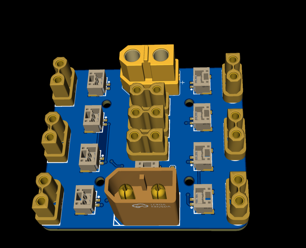

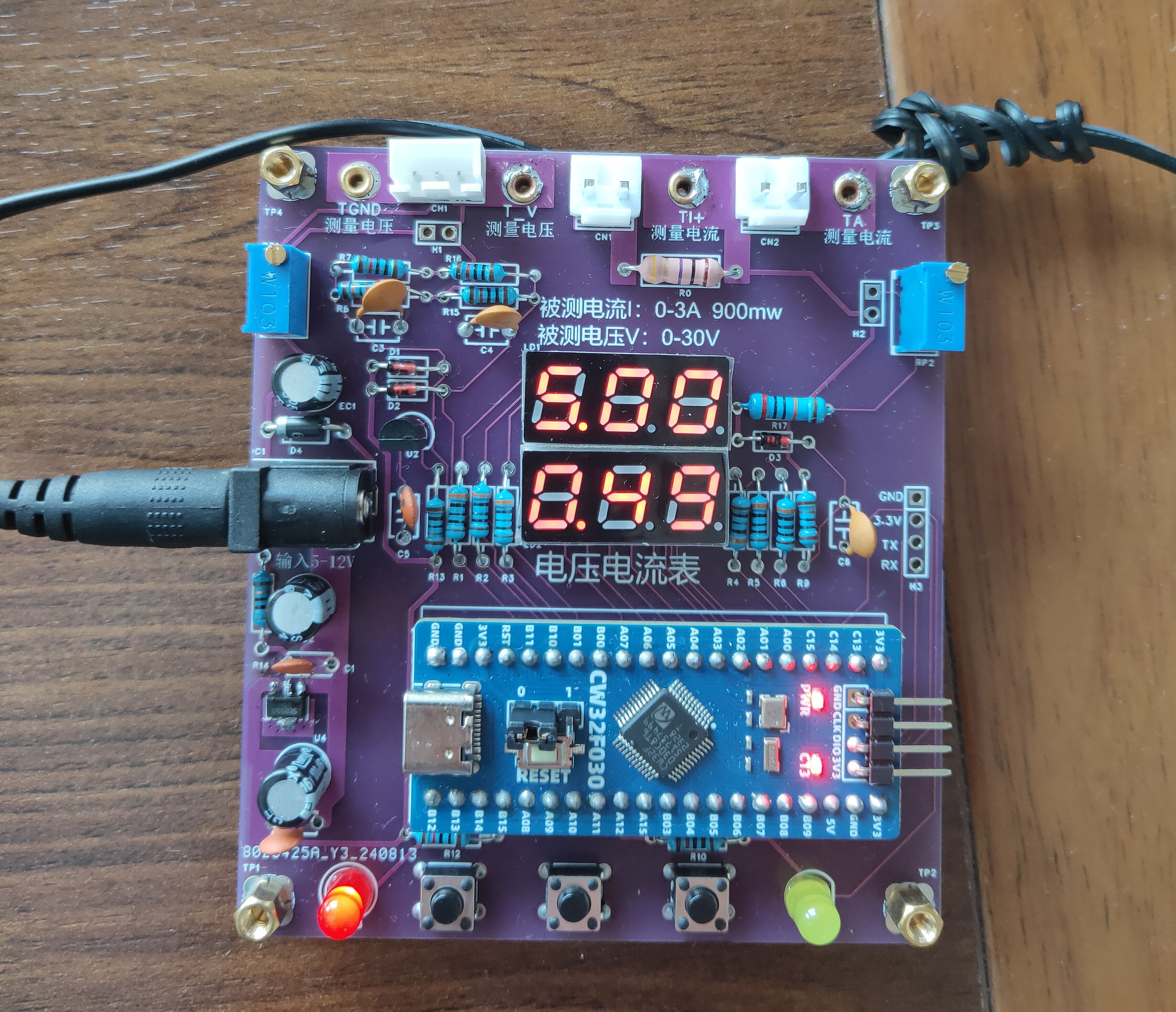

Project Overview:
This project utilizes the LCSC CW32F030C8T6 development board to create a voltmeter and current meter. It can detect voltages from 0-30V and currents from 0-3A. Using the CW32 MCU enables high-precision measurements because the CW32 chip has an internal 12-bit high-speed ADC and a built-in reference voltage, allowing for better and more convenient voltage and current detection.
Application Scenarios:
In everyday electronic circuit use, it's often necessary to measure voltage and current. This voltmeter and current meter is compact and small, only the size of a palm, making it easy to carry. It can be powered by the power supply being tested, eliminating concerns about power outages. It's a great helper for home and travel.
Project parameters:
The voltage measurement section uses two voltage sampling ranges: one for a wide range of 0-30V and the other for high-precision 0-3V.
The power supply section provides a measurement range of 0-3A.
It also features onboard analog voltage and current measurements to meet its own voltage and current calibration requirements.
The display mode can be modified using three onboard buttons, and voltage and current calibrations can be performed.
Caution: Do not solder R0 during the experiment!

CW32-based voltage and current meters
LCSC CW32 Voltage and Current Meter Training Camp Open Source Project
An ADC (Analog-to-Digital Converter) is an indispensable key component in electronic systems. It converts continuous analog signals into digital signals, enabling digital processing and analysis. ADCs play a crucial role in signal conversion, measurement and data acquisition, control system input, and communication and signal processing. Their widespread application promotes the intelligent and precise control of electronic equipment across various industries, and is one of the key factors driving modern technological progress. A digital voltmeter and
ammeter   combines ADC technology with circuit measurement principles, accurately converting analog voltage and current signals into digital displays for easy reading and analysis by electronic engineers. This device not only improves the accuracy and efficiency of circuit measurements but also helps engineers better understand circuit behavior, making it a powerful tool for electronic design and troubleshooting, and playing a vital supporting role in the work of electronic engineers. In product applications, digital voltmeters ensure the accuracy and safety of circuit design, while also providing strong support for product quality control and subsequent maintenance.
Learning to design and build a digital voltmeter and ammeter is highly beneficial for improving one's professional skills. This digital voltmeter and ammeter project covers multiple aspects, including microcontroller circuit design and implementation, signal acquisition and processing circuit design, user interface development and optimization, and product appearance design. It integrates knowledge from multiple fields such as electronics, microcontroller programming, circuit design, and industrial design. Considering the learning pace and knowledge absorption capacity of beginners, we have specially launched this introductory-level digital voltmeter and ammeter project, which is very suitable for beginners in electronics and those who want to learn more about microcontroller applications. This project has the following highlights:
it adopts a core board plus expansion board design concept and uses plug-in components, making learning simpler and exploration more in-depth;
the core board uses the domestic Wuhan Xinyuan Semiconductor CW32 as the main controller, while also being compatible with other similar development boards; however, the CW32 has advantages.
The project is highly comprehensive and practical, and after completion, it can be used as a desktop instrument;
the project has abundant learning materials, including circuit design tutorials, PCB design, code programming learning, and training for engineers' debugging skills.

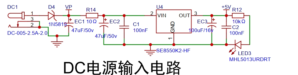

1. Power Supply Circuit
LDO (Low Dropout Linear Regulator) Selection
![image.png] This project uses an LDO as the power supply. Considering that most voltmeter products are used in industrial scenarios with 24V or 36V power supplies, the SE8550K2 with a maximum input voltage of up to 40V was selected as the power supply. The main reason for not using a DC-DC step-down circuit to handle the large voltage drop is to avoid introducing DC-DC ripple interference during the design process, and the secondary reason is to reduce project costs.
Package Selection
From the table in the datasheet screenshot, it can be seen that compared with the 280℃/W of the SOT23 package, the 165℃/W of the SOT89 package has better heat dissipation capabilities (Thermal Resistance, Junction-to-Ambient).
The basic principle of almost all LDO devices is the same when designing circuits. Therefore, the reference significance of this diagram is not very high. What often differs is how C1 and C2 should be designed. If your LDO has EN (enable), you also need to consider the design of the enable pin to ensure that the chip works normally. In addition, some LDOs have adjustable outputs, which have a dedicated pin (adj) that requires the configuration of corresponding external resistors to achieve the specified output voltage.
The most crucial aspect of LDO peripheral circuit design is the capacitor design.
The capacitors surrounding the LDO play a critical role in the circuit, primarily in the following ways:
Filtering: The capacitors surrounding the LDO, especially the input capacitor, can effectively filter out ripple interference from the preceding power supply.
Improving load transient response: The output capacitor plays a vital role in improving load transient response. When the load current changes drastically, the LDO has an adjustment time. During this time, the output capacitor acts as a temporary power supply, providing the necessary current to the circuit and preventing the output voltage from being pulled too low. A larger output capacitor value can further improve the LDO's transient response to large load current changes.
Phase compensation: For adjustable output LDOs, the capacitor connected in parallel with the upper resistor (R1) (called the feedback capacitor CFB) provides leading phase compensation, increasing oscillation margin and improving load transient response. Returning CFB and R1 to zero contributes to loop stability.
Oscillation Prevention: Proper capacitor configuration helps prevent oscillations in LDO circuits, ensuring stable circuit operation.
Ripple Suppression: Capacitors in LDOs also help improve the power supply rejection ratio (PSRR), reducing the impact of power supply noise on circuit performance.
Startup Inrush Current Control: Input capacitors act as temporary power supplies for startup inrush currents during LDO startup, preventing the input voltage from being pulled down and affecting the stability of the preceding power supply.
Summary: Capacitors surrounding the LDO play important roles in filtering, improving load transient response, phase compensation, oscillation prevention, ripple suppression, and startup inrush current control. Proper configuration of these capacitors ensures the stability and performance of the LDO circuit.
If you carefully review the datasheet, you'll find detailed suggestions and references, as well as layout design recommendations. This avoids engineers performing complex theoretical calculations.
Figure 7
shows a notable use of electrolytic and ceramic capacitors in parallel, one after the other, in my power supply design. When electrolytic and ceramic capacitors are connected in parallel, they can be "high-low matched," resulting in good filtering performance in both high-frequency and low-frequency regions. Electrolytic capacitors filter low-frequency interference, while ceramic capacitors filter high-frequency interference; combining the two achieves better filtering results.
In practical electronic products, the main function of electrolytic capacitors in parallel with ceramic capacitors is to achieve high and low frequency filtering and coupling through their complementary characteristics, thereby improving circuit performance, stability, and anti-interference capabilities. This parallel connection method is widely used in electronic devices. For
reverse connection protection,
considering that high-voltage reverse connection can cause irreversible damage to the module, the voltmeter power supply circuit uses a series diode scheme for reverse connection protection.
Figure 8
Note: This project uses a series diode for reverse connection protection because the power supply voltage of this device is usually higher than 5V, and the 0.7V voltage drop of the diode will not affect the power supply. When the power supply voltage is low, due to the low overall power consumption of the project, the measured power supply current is low (20mA). Due to the unique structure of the Schottky diode D4 (1N5819), compared with general switching diodes, its VF is lower; as shown in the figure below, the voltage drop is approximately within 0.2V.
In conventional circuit design, using a reverse parallel diode + series fuse can also achieve the purpose of reverse connection protection and circuit protection.
The additional use of a series small resistor (10Ω)
in this project for voltage division reduces the problem of excessive heat generation in the LDO due to the large voltage difference under high voltage conditions. Furthermore, it utilizes the principle that the series 10-ohm low-power resistor has low overcurrent, acting as a low-resistance fuse, providing overcurrent or short-circuit protection. (The reason the resistor acts as a fuse is that, under overcurrent and heating conditions, it is 99% open-circuit, and rarely short-circuit. Its fault analysis dictates that it is primarily an open circuit—that is, it burns out, not short-circuited.)
The series small resistor (10Ω) also reduces the peak value of the power-on surge, preventing excessive surges from damaging the LDO.
If electrolytic capacitors are not used, a small series resistor (10Ω) can also prevent resonance between the wire inductance and the ceramic capacitor during hot-plugging. Because ceramic capacitors have very low ESR, the damping in the LC network is minimal, resulting in high gain at the resonant point. Adding an external resistor to provide damping can suppress this gain.

: Voltage Sampling Circuit.
This project uses a voltage divider circuit to achieve high-voltage acquisition, designed to acquire up to 100V; the current configuration acquires voltages from 0-30V.
Figure 5
shows that the voltage divider resistors in this project are 220K+10K, so the voltage division ratio is 22:1 (ADC_IN11).
is based on the maximum measured voltage. For safety reasons, this project uses 30V (the actual maximum can be 99.9V or 100V).
The ADC reference voltage in this project is 1.5V, which can be configured through the program.
To reduce the power consumption of the sampling circuit, the low-side resistor (R7) is usually selected as 10K based on experience.
Then, the high-side resistance of the voltage divider resistor can be calculated using the above parameters. The
required voltage division ratio is calculated as follows: ADC reference voltage: Design input voltage, which can be calculated using known parameters as 1.5V/30V=0.05.
The high-side resistance is calculated as: Low-side resistance/voltage division ratio, which can be calculated using known parameters as 10K/0.05=200K.
A standard resistor is selected: A resistor slightly higher than the calculated value is chosen. The calculated value is 200K. We usually choose E24 series resistors, therefore, in this project, we choose 220K, which is greater than 200K and closest to the calculated value.
If, in actual use, the voltage to be measured is higher than the module's 99V design voltage, a different resistor can be selected. To expand the voltage measurement range, you can choose to replace the voltage divider resistor or modify the reference voltage. Here's a case study:
Assuming the measured voltage is 160V, we can choose to increase the voltage reference to expand the range.
Given that the voltage division ratio of the selected resistor is 0.0145, we can calculate 160V * 0.0145 = 2.32V using the formula. Therefore, we can choose a 2.5V voltage reference to expand the range (increasing the range will reduce accuracy).

[ Image 2 ] [Image 3]

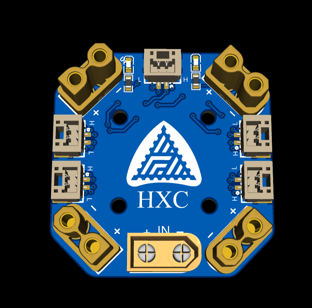

Design Concept:
Although the DJI Type A development board boasts powerful performance and has been validated in competitions for many years, its high price, difficulty in repair, high learning curve, and long development cycle have always troubled us.
Therefore, we designed this development board using the ESP32 S3 as the main controller and utilizing as many low-cost and common components as possible, keeping the cost below 50 yuan while achieving 80% of the functionality.
One CAN channel (with transceiver chip),
maximum 26V power input (can be powered by TB48S battery),
maximum 5V 3A step-down output,
seven GH1.25-4P customizable interface types (configurable as UART, I2C, etc.)
, ten GPIO pin headers for direct-plugging servos,
two programmable LEDs,
one SBUS/DBUS interface (receiver interface),
six XT30/CAN motor interfaces
, 5V and 3.3V motor interfaces with fuses and TVS protection.
All components are located on the front for easy soldering.
Hole positions and dimensions are completely consistent with DJI development board A type. Sample programs and code repositories:

Power Supply:
VCC is stepped down to 5V via TPS5430. 5V is stepped down to 3.3V via AMS1117.

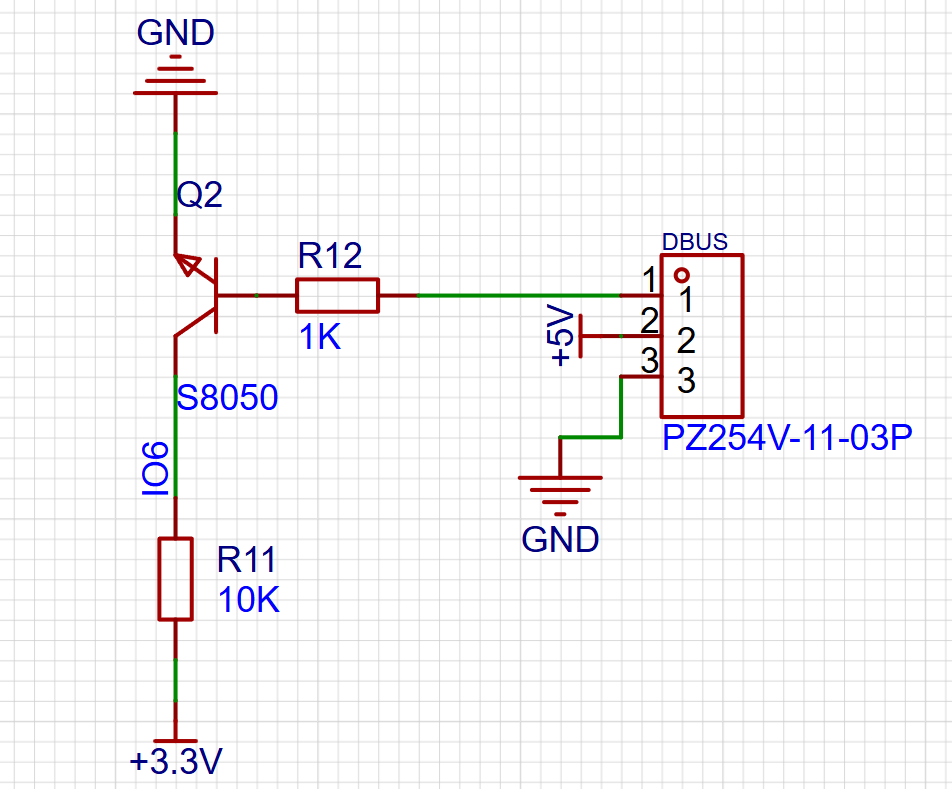

The SBUS/DBUS
standard level inversion circuit uses the common S8050 transistor
