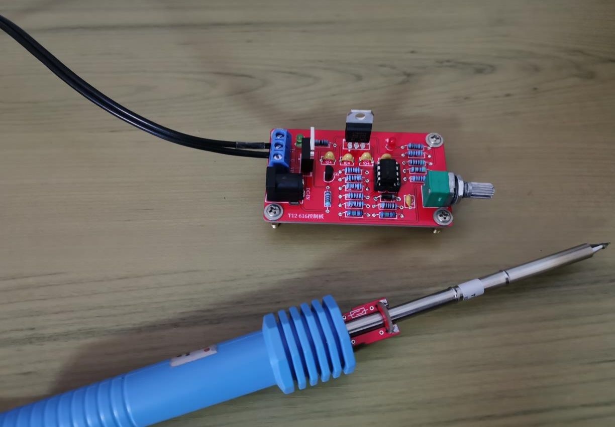

T12 control board
Thanks to shuo502 for open source, https://oshwhub.com/shuo502/t12-kong-zhi
replaced all the patch components with plug-in components on the original schematic diagram. There were originally a bunch of plug-ins, so don’t waste them!
The control board is powered by a laptop power adapter. It can melt tin in about 10 seconds, which is much faster than the original external heating type. The potentiometer controls the temperature. The higher the temperature, the faster the U5 diode flashes.
参考设计图片
