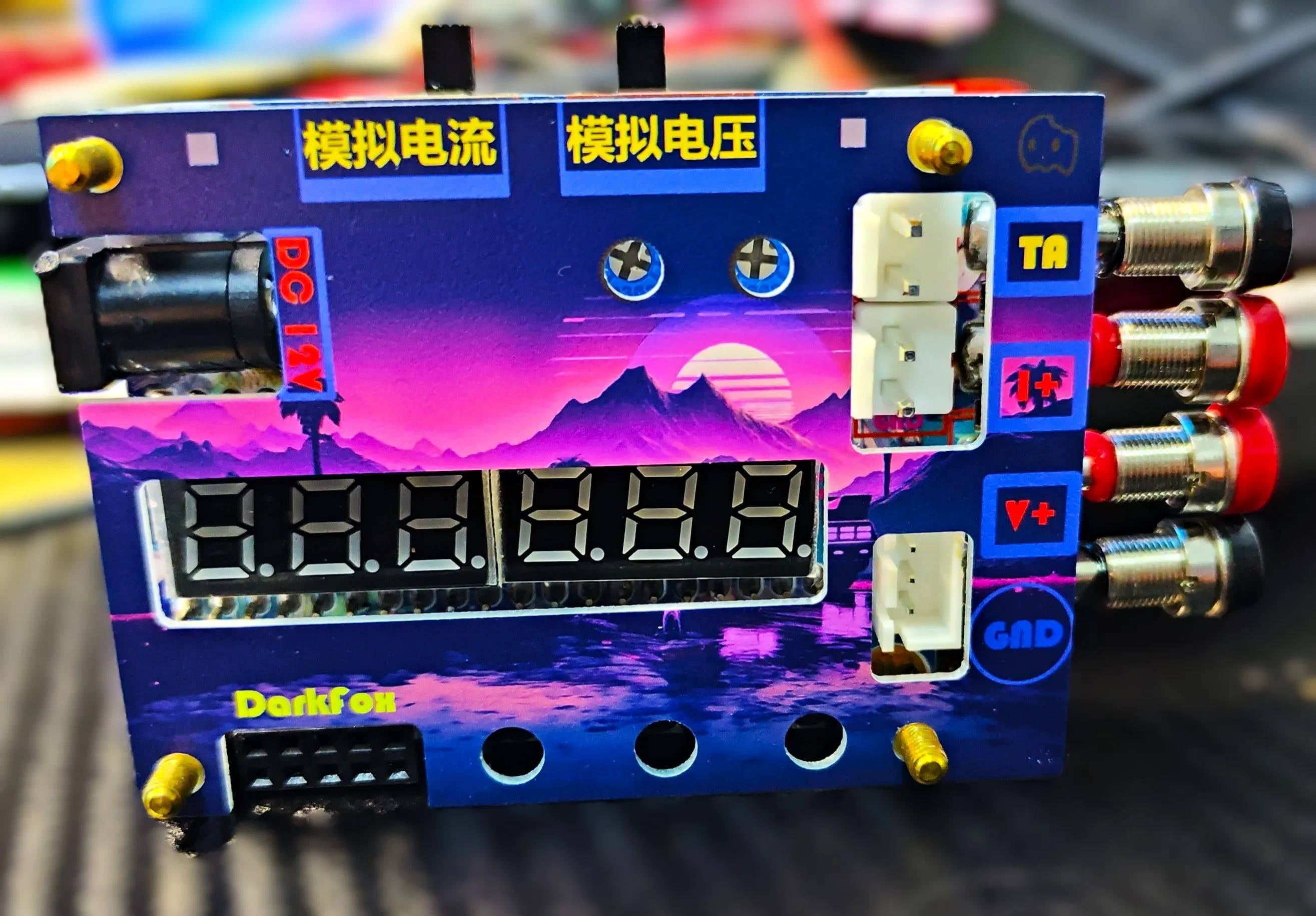

LED power indicator and operation indicator physical verification
: Voltage verification:
I only have a small USB adjustable voltage source on hand, so I used it with a power bank for testing;
because this small USB voltage source costs only a few dollars and the reading is inaccurate, we used a regular multimeter as a reference;
after connecting the cables, we can see that the readings are basically consistent;
Current verification:
I don't have a current source on hand, so I used a voltage source and an LED to form a rough constant current source; under low current conditions, the accuracy of this USB power source is slightly higher, because my cheap multimeter doesn't have a current measurement mode, so I used this as a rough reference; we can see that the parameters are basically consistent;
verification is now complete;

the panel design was designed
because it was my first time using JLCPCB's panel service, so there were some things I didn't understand, and therefore I designed three different panels;
the Miku and
Hatsune Miku versions were designed because I didn't quite understand the impact of the transparency parameter, so at 80.80% transparency, you need to be very close to see the display effect clearly, so it is recommended to use a more transparent or cutout panel for easier observation of the digital tube;
The WuKong version of the
Wukong version has a hollowed-out central display area. Unfortunately, I couldn't find Black Myth materials at the time, so I used Dragon Ball materials instead (not for commercial use). This version was to test the dark effect of LCSC panel printing;
Vaporwave <<<
Vaporwave style theme; the dark tone makes the warm-colored characters have high contrast. If the above two effects are not good, at least there is a usable one; fortunately, LCSC panel quality is very good, and all three can be used.
