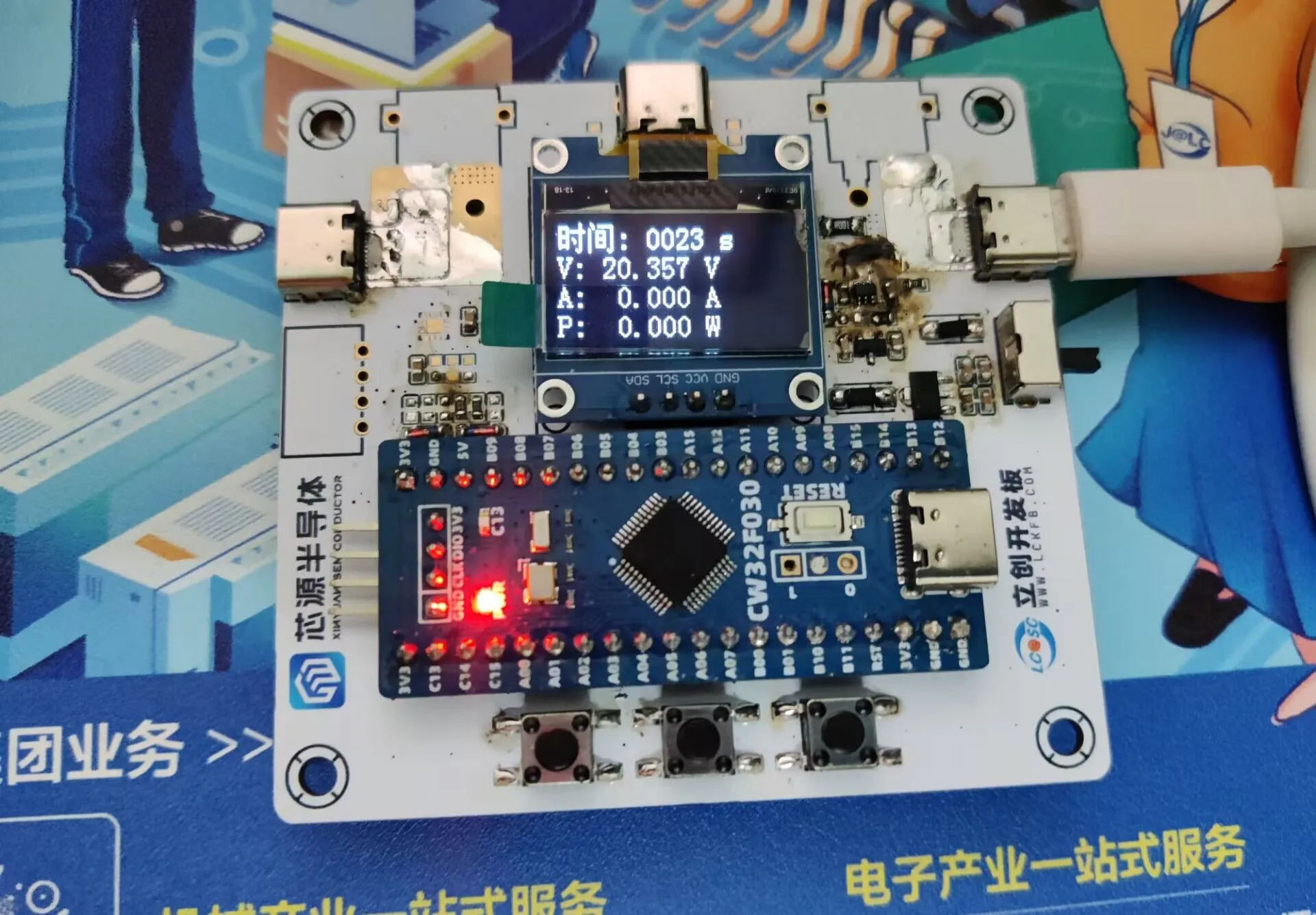

CW32 Voltage and Current Meter
1. Input/
output interfaces: Type-C and XT30 interfaces are used.
2. Power supply
: LDO (SE8550K2) is used to regulate the power supply to 5V, supporting a maximum input of 35V.
3. Voltage measurement:
Resistor voltage divider is used, followed by ADC sampling.
4. Current measurement
: INA199 amplifies the voltage across the sampling resistor and supports bidirectional current.
5. PD spoofing:
FUSB302 is used for PD spoofing, communicating via I2C
. 6. Display:
0.96-inch OELID screen displays voltage, current, power, etc.
7. Actual product image .

Hardware Instructions:
Shorten the pin headers and solder them onto the CW32. Solder other components
on top , soldering the CW32 last (a lesson learned the hard way). Pay attention to the positive and negative terminals of the button battery holder.
Solder the OLED pin headers first, then solder the OLED, and
finally solder the CW32
. Shorten the boot pins and solder them together.
Attach the model buttons to the buttons .
Shorten the length of the toggle switch and
assemble it flush with the panel. The complete assembly is shown in the image. The design wasn't fully considered; there weren't enough DuPont wire connectors, so they were directly soldered onto the board.
Software
Code: The code uses the official example, only modifying the pins to add automatic sleep alarm and vibration wake-up.
